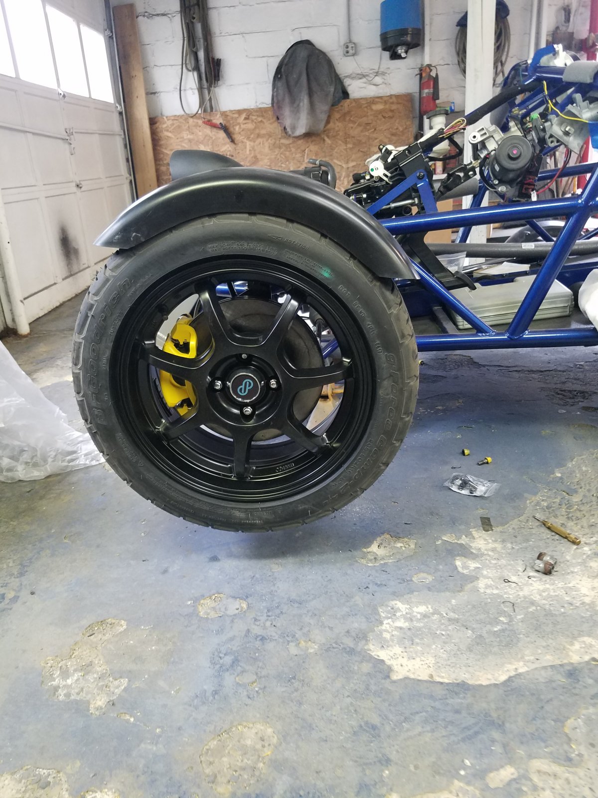

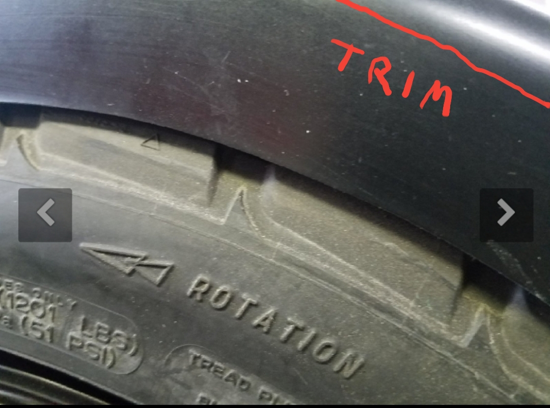

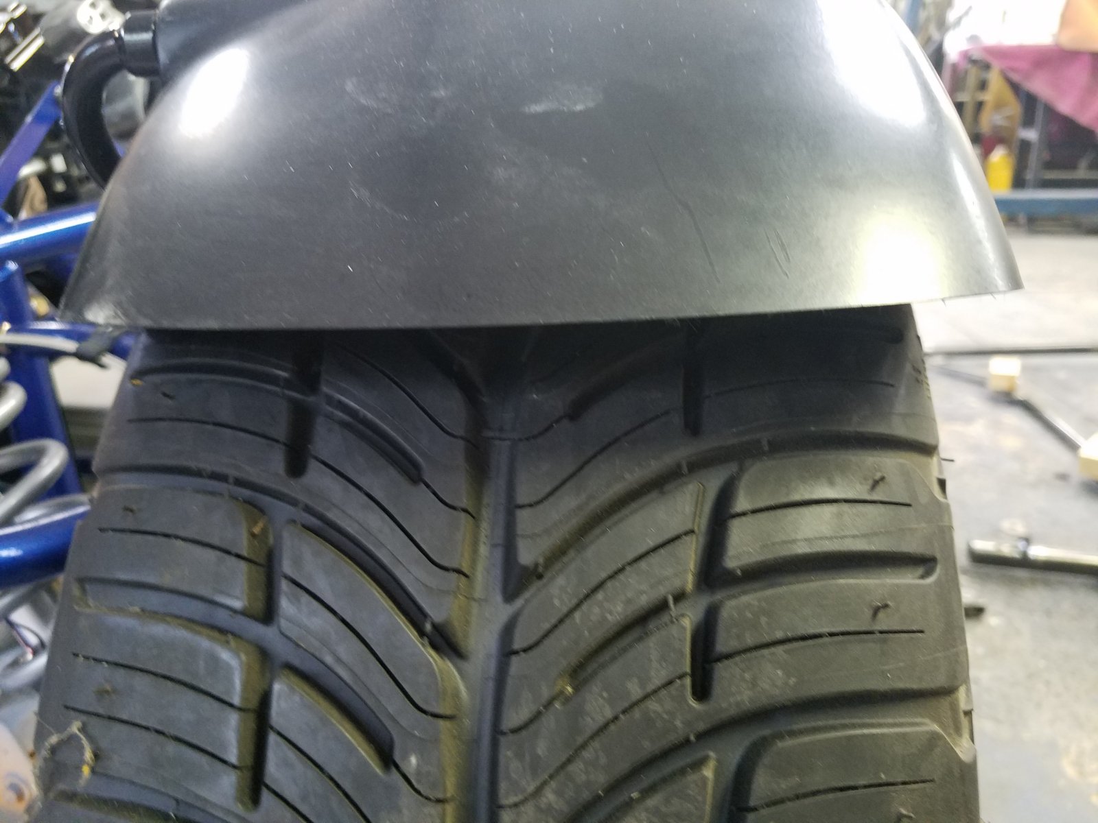

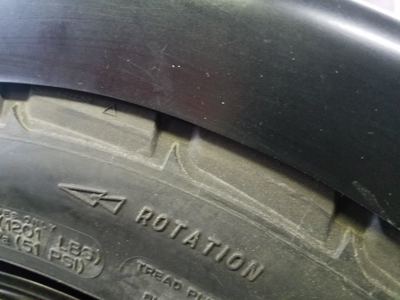

Just a note my front fenders will not clear my wheel and tire combination. Hers I had the adjusted all the way up they still rub. It looks like I will be trimming the sides or adding about a inch of width to them. I am running 205/50R-16. the wheels are 16x7 with a +38 offset. They are centered in the fender just not wide enough
You will need to trim them up to the start of the radius. This will allow them to clear 205's.
