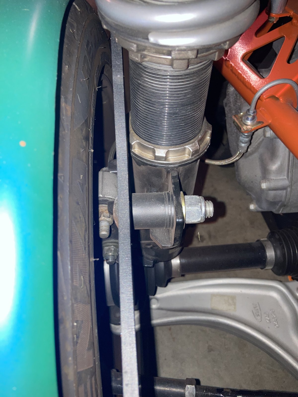

Anyone have a rear sway bar with the rear fenders? With my wheel offset I needed about 1 3/16” spacer to get the fender squared on the tire. The cobalt end link will not work...

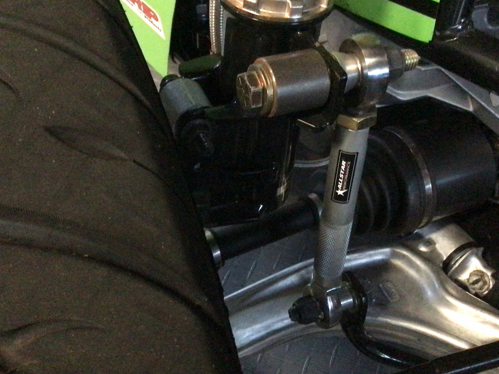

Anyone have a rear sway bar with the rear fenders? With my wheel offset I needed about 1 3/16” spacer to get the fender squared on the tire. The cobalt end link will not work... View attachment 28608
The bolt I am using is 7/16". Did you drill out your fenders and setup to 1/2"? The reason I ask, I'm having issues finding heims and linkage rods that will work in 7/16".
If you can remember, can you share the details in your setup?

Sorry I missed your question earlier , I been busy cutting up my Donor ( ALL DONE ) I will go out to the shop here shortly and see if I can find the parts in KLM receipts where he ordered it from . Zoom

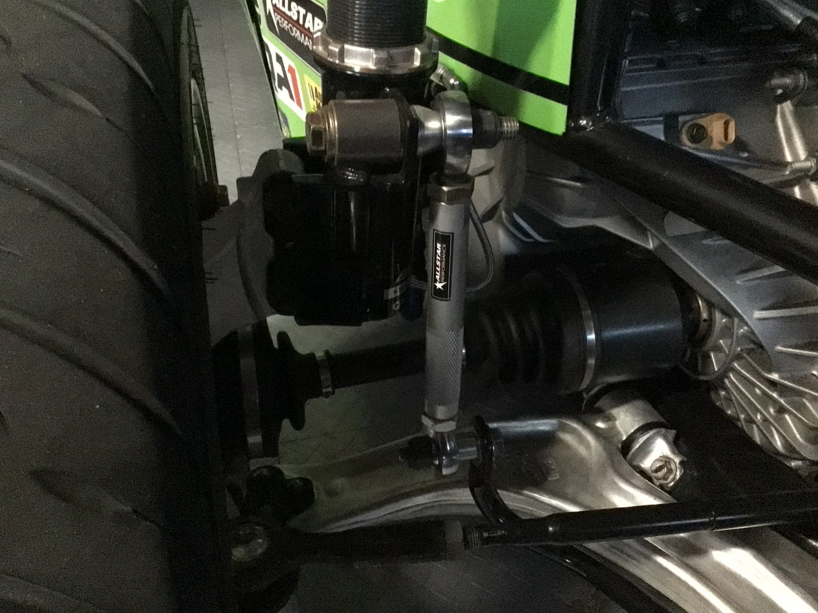

I had been considering this as an option to the problem i had as well of wanting to retain the sway bar while also installing the fenders.
Thanks for pointing out the sizes... since I'm here anyone have any advice on who sells the components??
