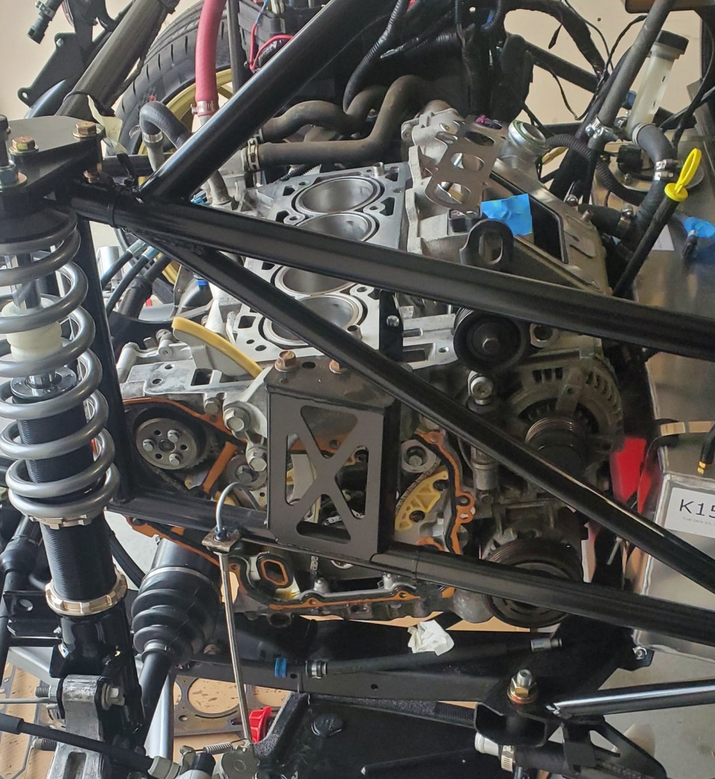

P
Turns out you can do it quite easily keeping the engine mounted. At least for an LSJ. I drained the oil and engine coolant. Then took the air intake and supercharger off. Took the top bolts of the intake out that attach to the head. Took the timing cover off, removed the tensioners, and then cam sprockets and then finally the head came off. I didn't have to remove the engine mounts or drain the HX loop either.

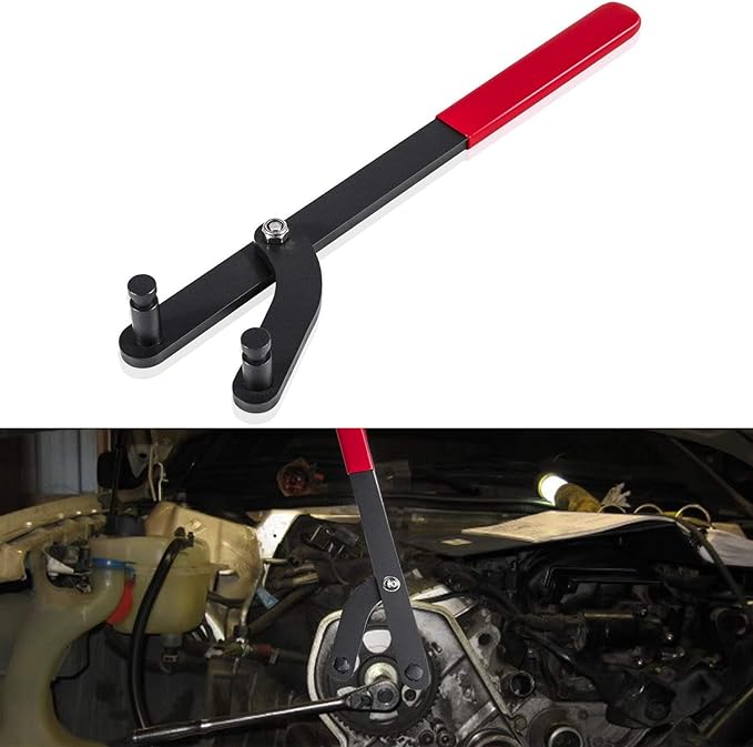

P
I used a tool that has pins that insert into the holes in the balancer, it's universal and adjustable. I think I got it off amazon for $20 maybe. It's basically a long metal bar with a pin on the end and then it has a second bar connected 6 inches from the end that can be adjusted so you can fit both pins.
