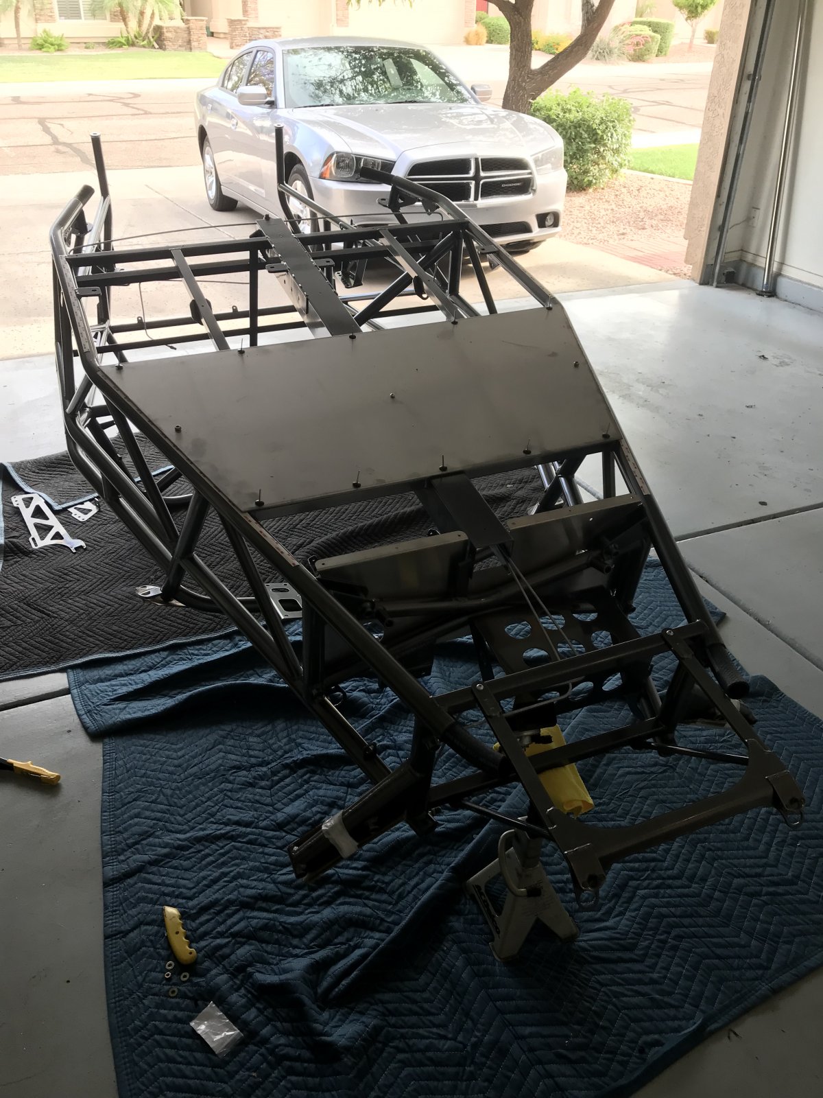

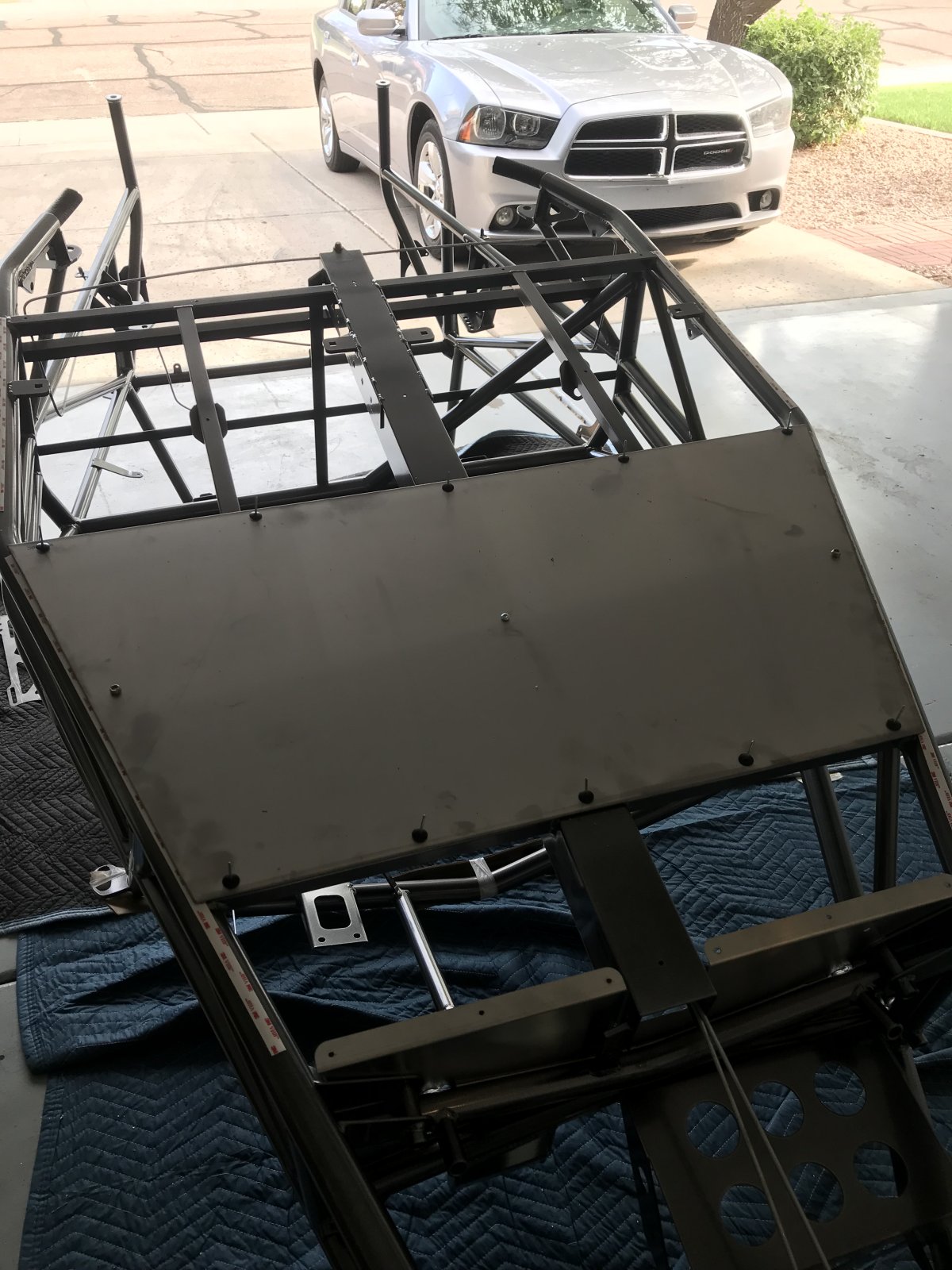

So I made an extra floor piece out of some 10Ga SS plate. I will also used some high strength SS rivets to attach it, along with the 1/4” bolts. It should strengthen this area significantly. It will go on the underside of the aluminum sheet provided.

I have also read the opposite, that some people had the floor sag in this area, and it felt like it could use a little beefing up. I am an owner of a metals fabrication shop and design walkways and cover plates all the time, so from that school of thought, I thought it needed something extra there. I didn’t spend any extra money. I had the plate already. My labor and time into it I feel was well spent and honestly was only a few hours. To me this mod will have been well worth the very little time I spent to make it happen.

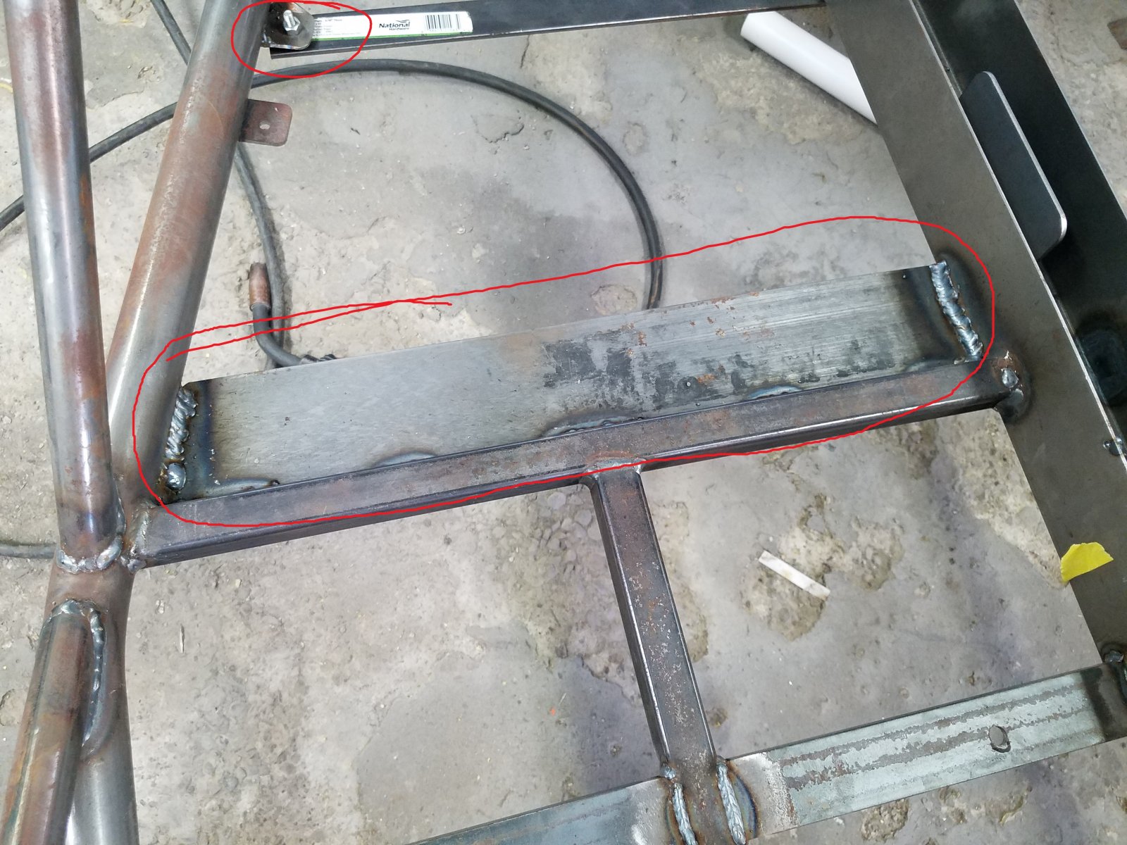

Done some mods to my frame to strengthen the floor area for my piece of mind (added a bar, cross connectors, seat plate) and also installing a “from the top” bolt in aluminum floor vice the bottom mount sheet metal.
Will post pics in my build log when complete.....won’t need “the speech” (lol...), but rather sharing for just another way to build the cars. The small weight add is zero issue for the gained benefits in my mind...
