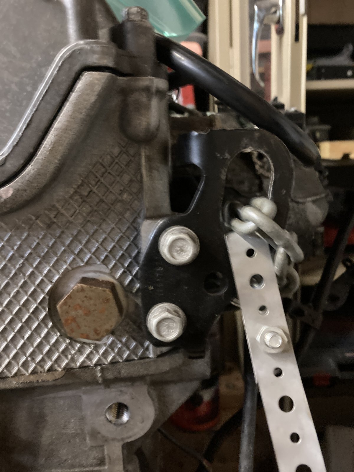

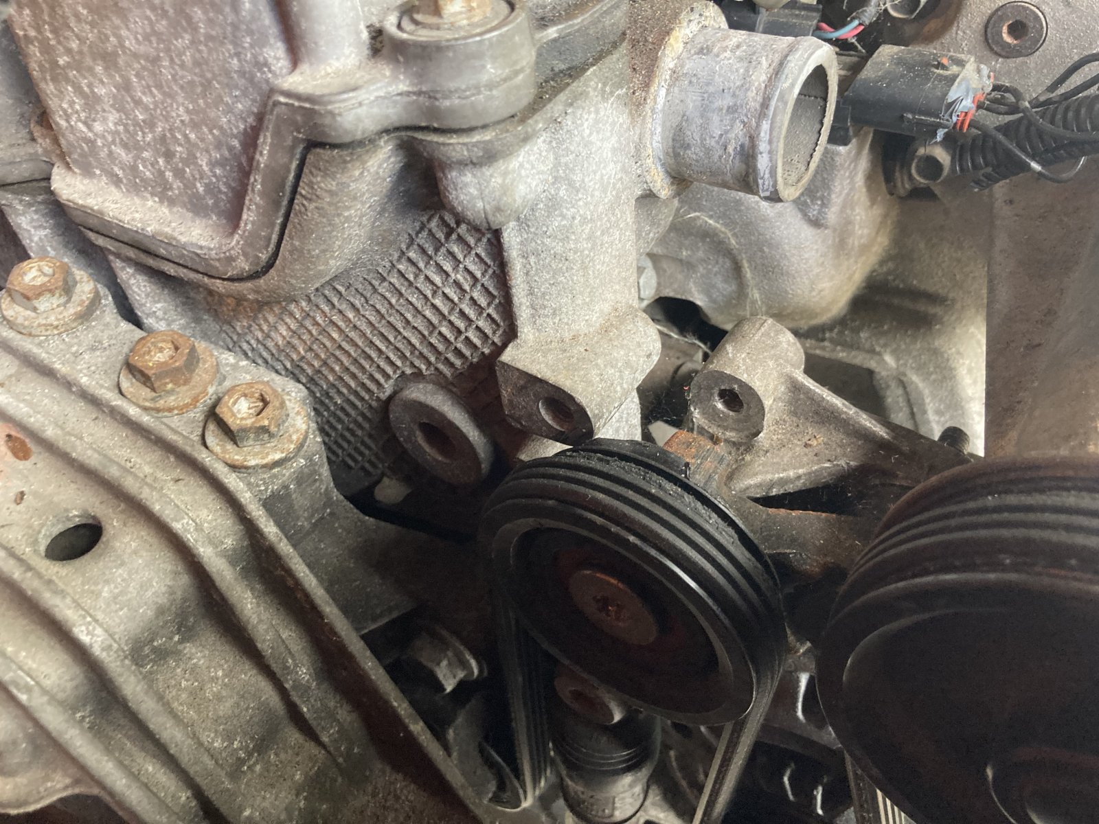

So we were attempting to figure out today where we would need to mount the hoist for dropping the engine on Monday. We have the mount on the rear right of the engine but just not the one in front. Might the aftermarket turbo be the thing that removed it. Any ideas on other ways to drop it. There are two different threaded holes that we could possibly bolt onto.

Bolts? Chains? No….
Just a strap will do…….

View attachment 34452View attachment 34453View attachment 34454

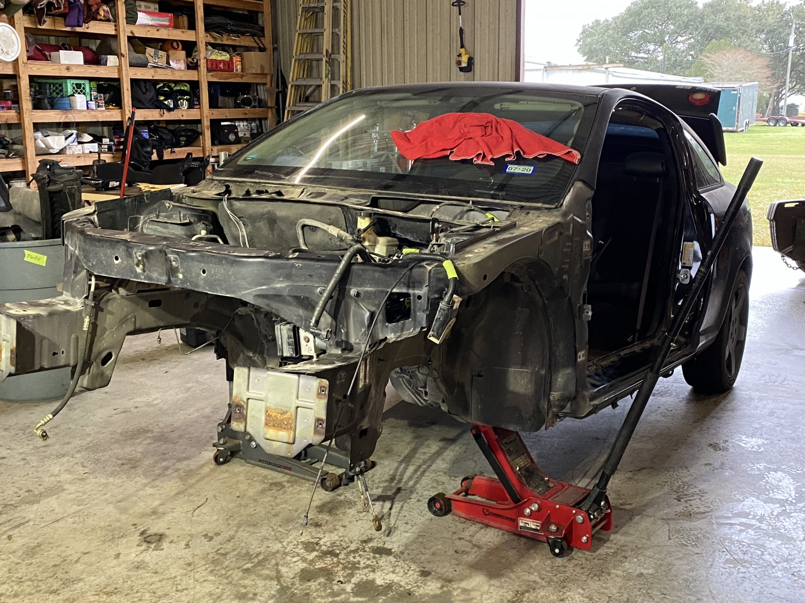

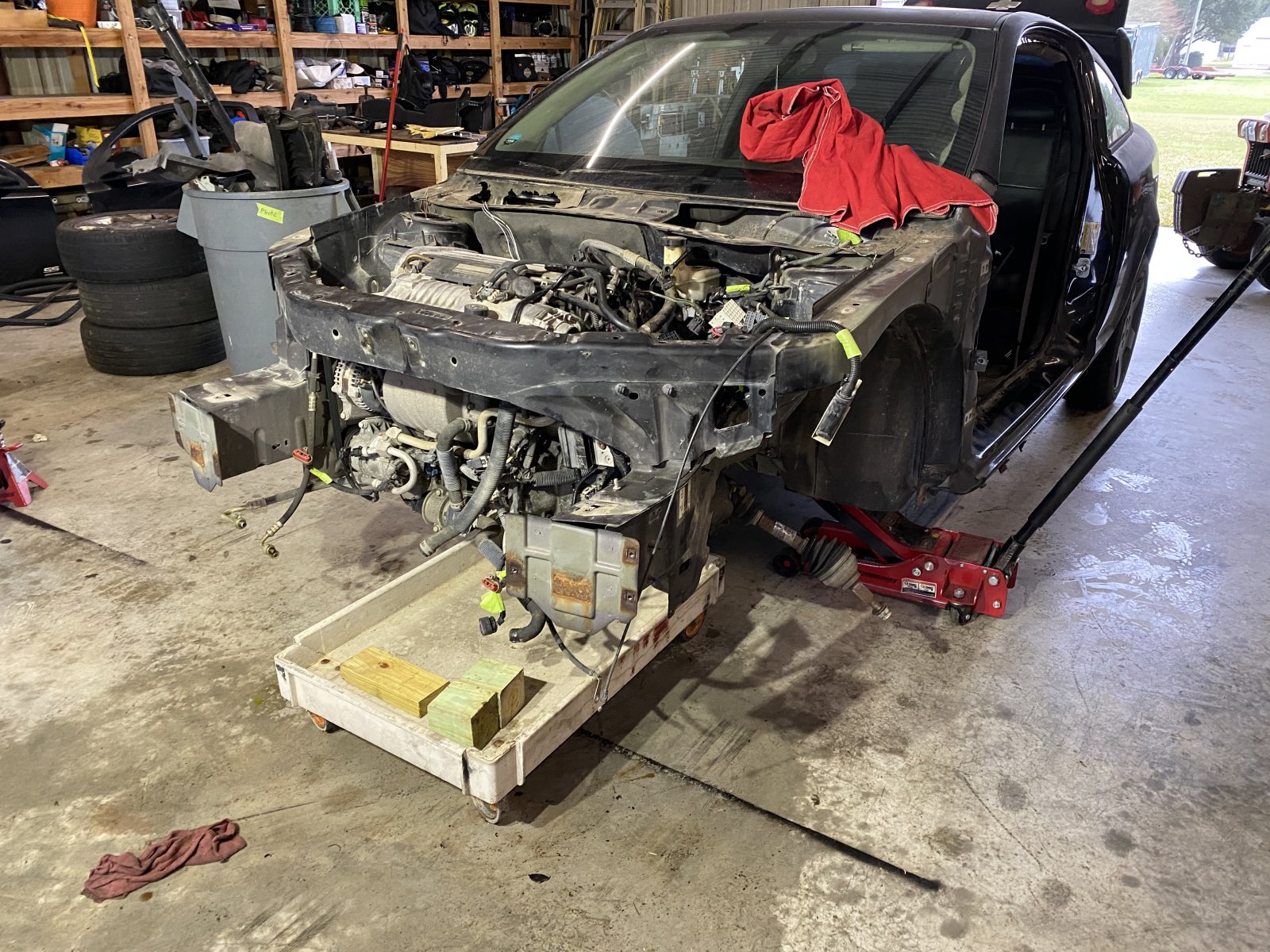

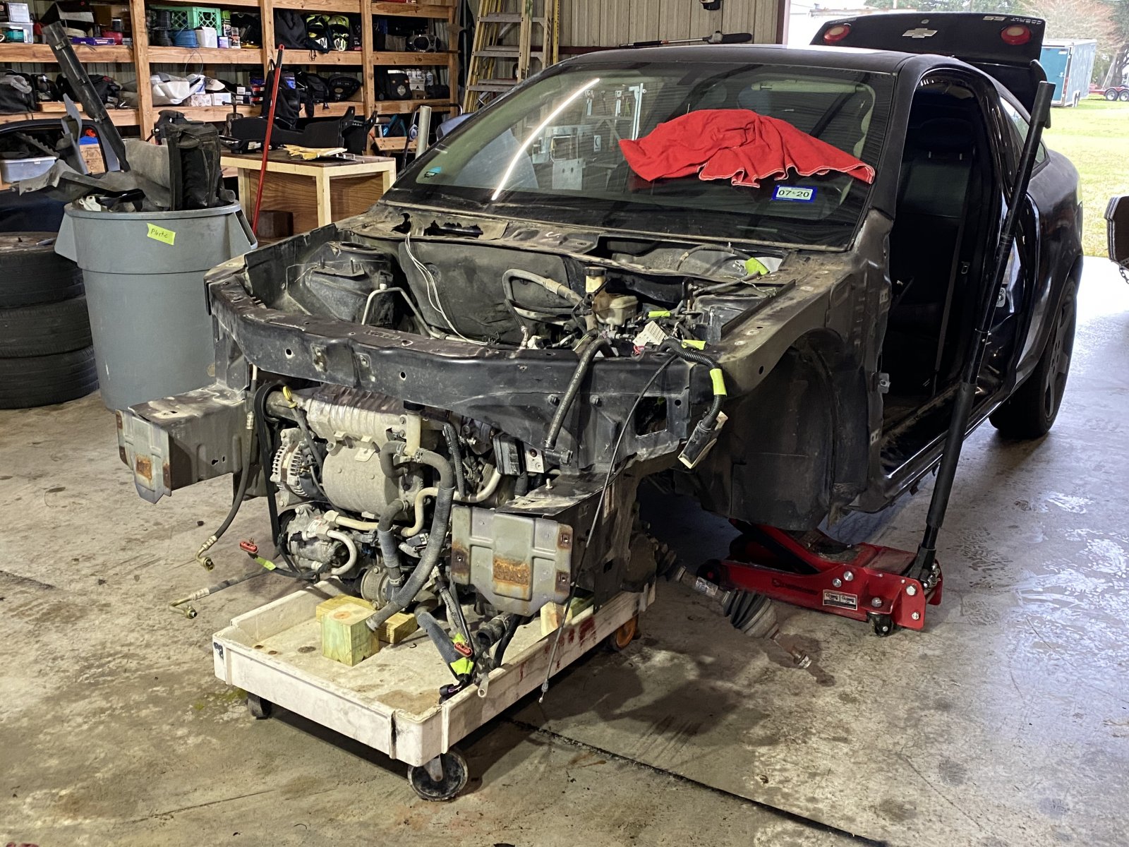

Ok thanks for the suggestion I think we will try that. Also we are aware of the belt being in a terrible condition and we will replace that.
Joebob
I am with @Rttoys: cut the front radiator cross member and slide it out the front.
Joe
It may be that he’s trying to guide it down onto a dolly. I lifted my engine out and it was a pain, even with cutting the front cross member. I also recommend the dropping down method just as I can’t see this being harder than lifting as we did.
