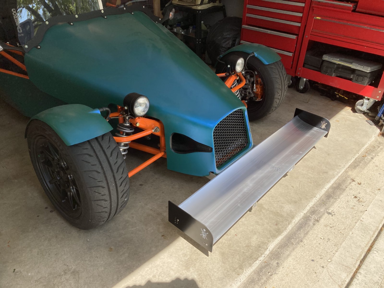

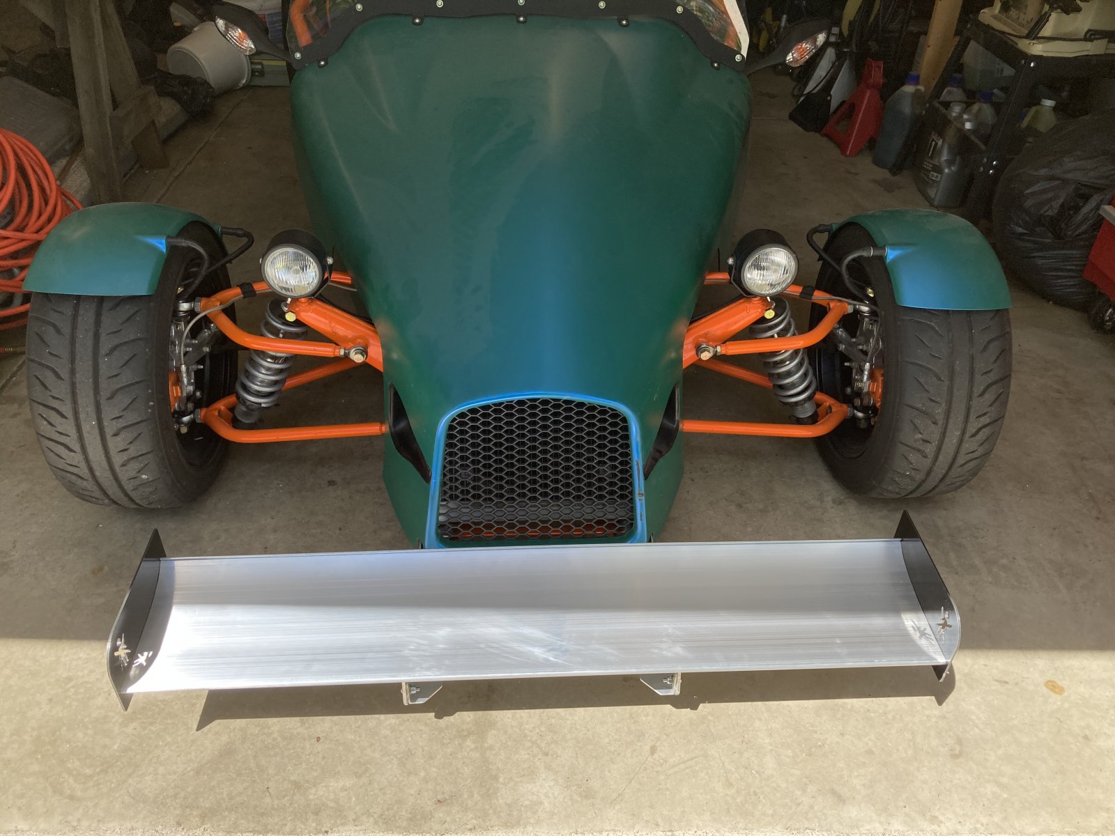

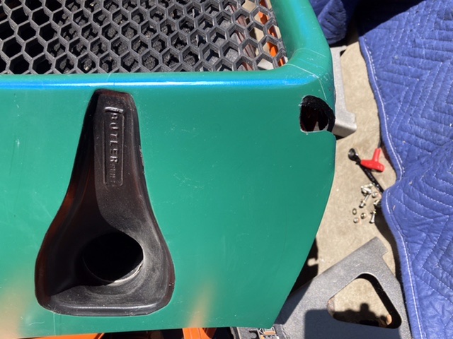

I finally got my front wing mounted up from Nine Lives Racing. What a difference. The car is so much more stable and solid at speed. There is a noticeable difference at any speed above 30. The steering is much heavier, which is a great thing because of the electric steering. At the 55 - 70 it only takes a few fingers on the steering wheel to guide it. Before at highway speeds I would always have both hands on the steering wheel. The twitchiness is gone. I let go of the steering wheel at 60 for about a half mile and it tracked straight. Wow... the car really feels planted now. Bonus - my IATs are down at speed. They are now within 11* degrees of each other.

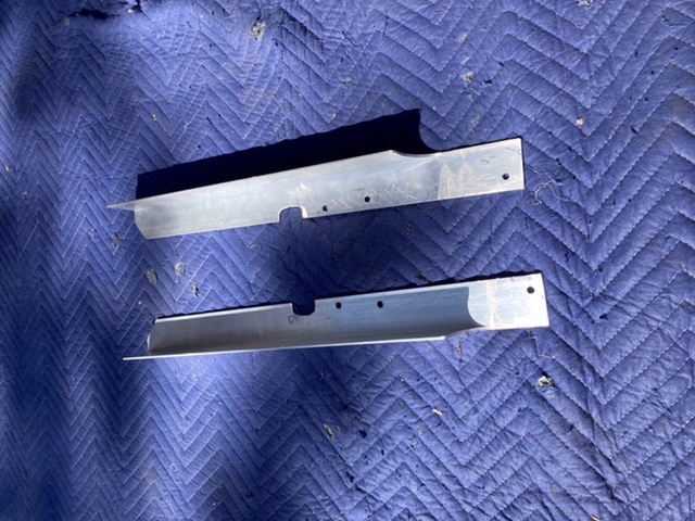

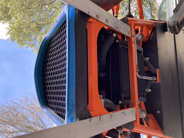

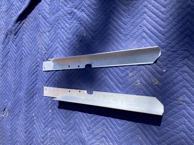

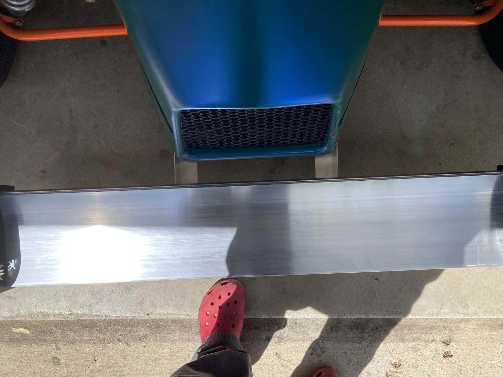

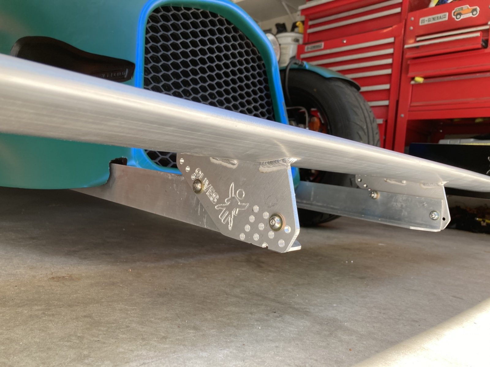

I spoke with Justin Reed last fall about his wing and decided to follow his lead. I ordered the Wang from Nine Lives Racing to match my rear Wang. It is 48” long with 16 1/2” spacing. I got the front Wang end plates as well with a 1/2” gurney flap. I mounted it at 10* to get the most downforce. I bought 2” x 1/8” aluminum angle from Home Depot. I used 2 - 24” sticks for the mount. I had to notch around both radiator hoses and notch a generous hole for the dzus fasteners with room to get the hood on and off. I also left a gap between the Wang and the nose to easily slide the hood on and off. The Wang needed a little trimming and some extra holes drilled to mount it up. I also had to notch the bodywork a smidge to allow the mount to pass through. The Wang is solidly mounted enough I can stand on it ( I’m 275 lbs). There is a little flex which I’m going to fix by swapping the mounts out to 3/16” thick aluminum. The ground clearance is 3 3/4”. I have a curb et the bottom of my driveway which I was worried about. No issue with scraping getting in and out.

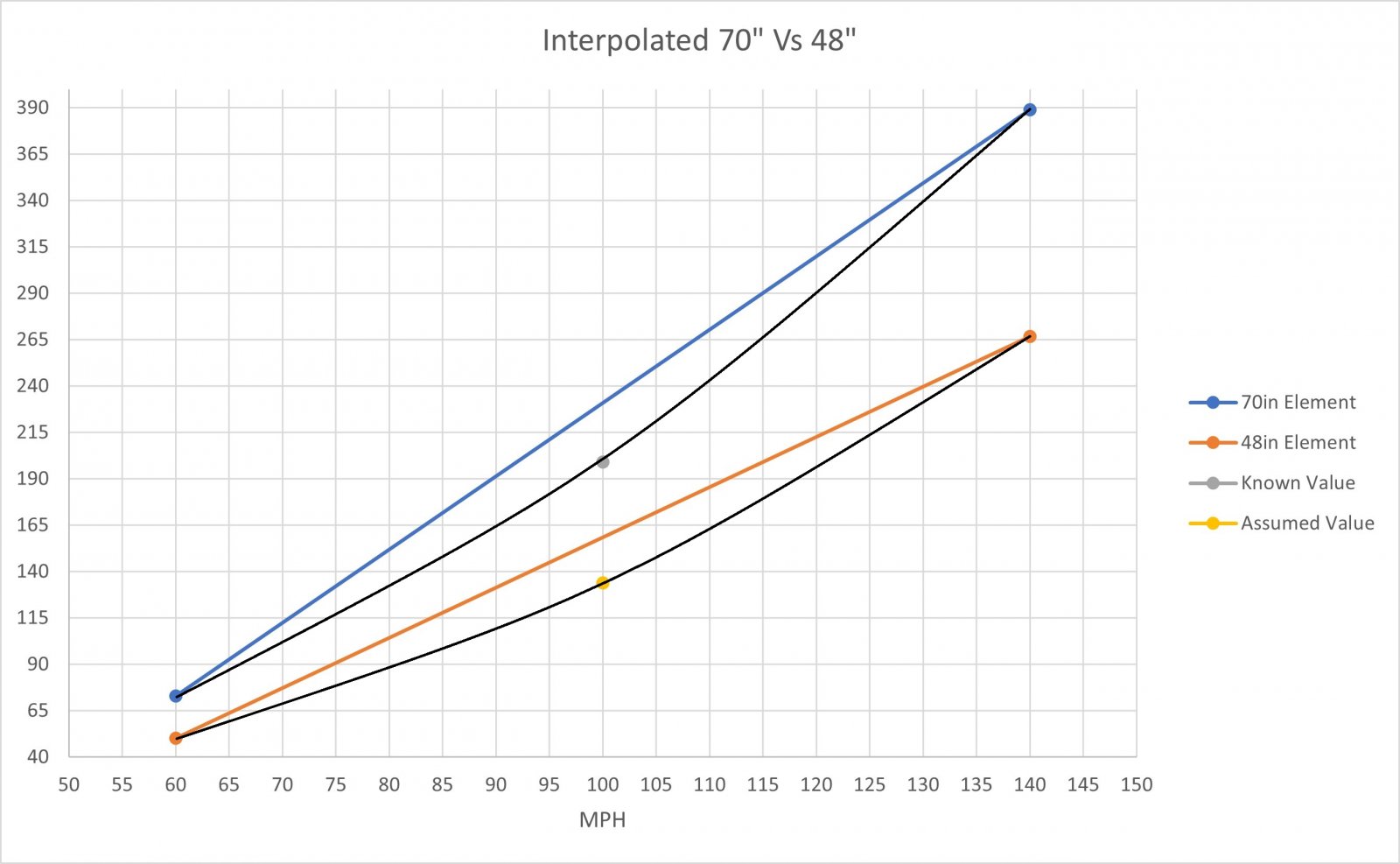

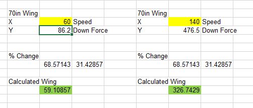

I plotted a graph using 9lives data for their 70" wing and interpolated for a 48" wing to see what the theoretical force would be. Any reason why you and Justin went with a 48" and not larger?
DCMoney
!!!Warning Theoretical Data Below!!! None of this should be taken as true. Reading the below post may result in loss of IQ, bowel control, brain bleeding and potentially death.
Wanted to see what the theoretical numbers of a 48in front wing would produce at a 10degree AOA. Since 9lives has the data for a 70in wing, I used linear interpolation between 60mph and 140mph. plotted the known value for 100mph and drew in the arc connecting the 3 known values together to get something closer yet still theoretical.
This is not going to represent the actual force pushing down on the front of your car. You could calculate the moment about the front pivot point and get something yet again theoretical.
3/4" gurney flap adds roughly 30% more down force.
Data matches what lonny posted for a 1/2" gurney flap.

I think color matching it will go a long way to making it look more integrated.
Will it handle speed bumps and other normal road obstacles or is it too low?
Some speed bumps and driveway curbs have already been navigated. It's just under 4" - the front bodywork (hood) is just over 4". If anything scrapes it will be the mounts. The wing itself is at 7". I can actually see the driver side wing and end-plate while driving.

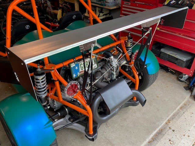

I actually like the bare aluminum look. I will just oil it up every once in a while like the rear wing. I also left the rear control arm, turbo, engine and trans bare as well.
