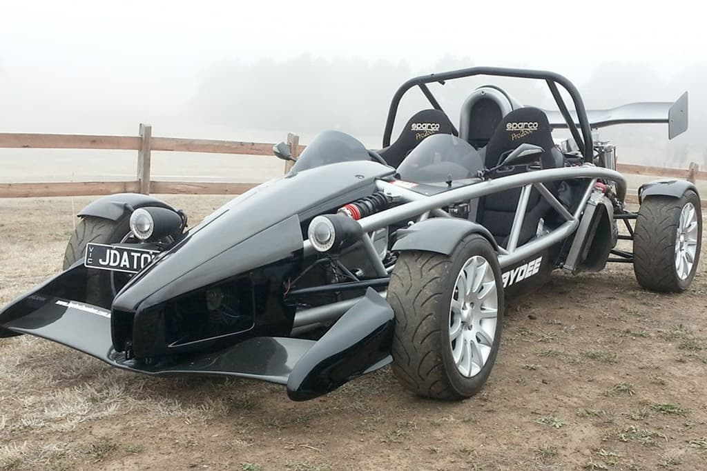

If we ever get to the point of needing some front aero, which I believe the SS variants could benefit from, the car may need a way for a bracket it be mounted high and low.
I happened to run across a way that the atom is mounting there setup.
The green frame has the front loop coming around still, the blue does not. That loop may be a nice area to help tie in an upper arm of a bracket too. Just an idea.

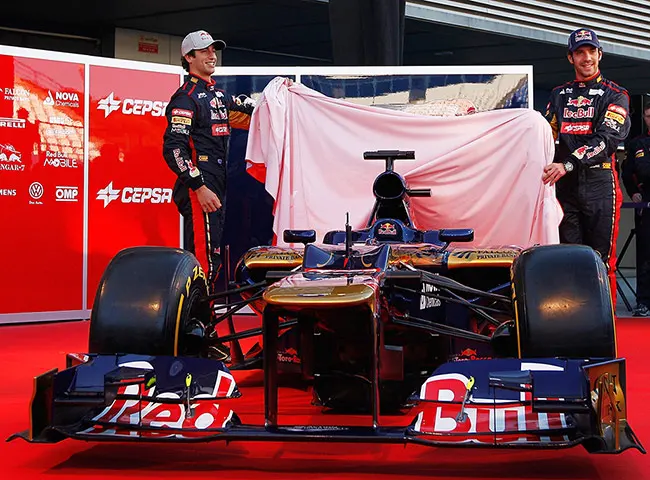

I've wanted to try a front wing that lifts the air before the front tires, and is flat across the radiator entry... kind of like this wing:
7548
Well that wing has a lot of extra little wings rather than one simple wing... so I was thinking simpler, but it has the basic shape. Here is a simpler version:
