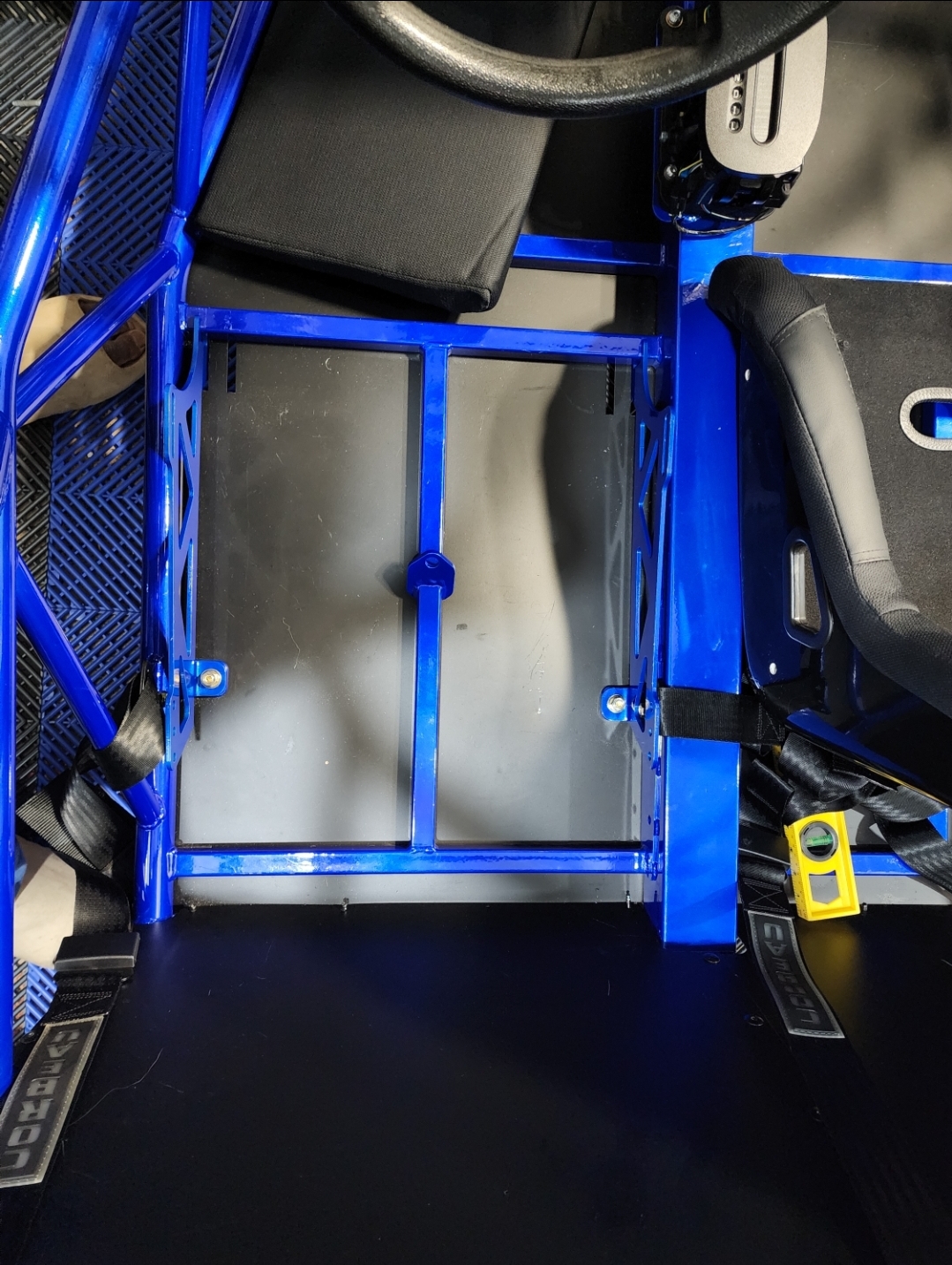

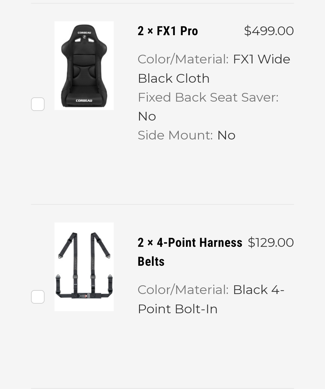

I'm attempting to install my seats. I purchase the wide corbeau seat and it appears to be too wide for the mount provided. Am I missing something or install something wrong?

I can confirm that the corbeau FX1 wide do NOT fit. I bought a used set with the description of being the standard FX1. Confirmed with a lot of fitting that the only way to get them to fit is to mount them very high off the floor (+4"). I sold them for what I paid and found a set of used Sparco seats instead.
DF sells the Standard and the FX1 pro which is the narrow seat.

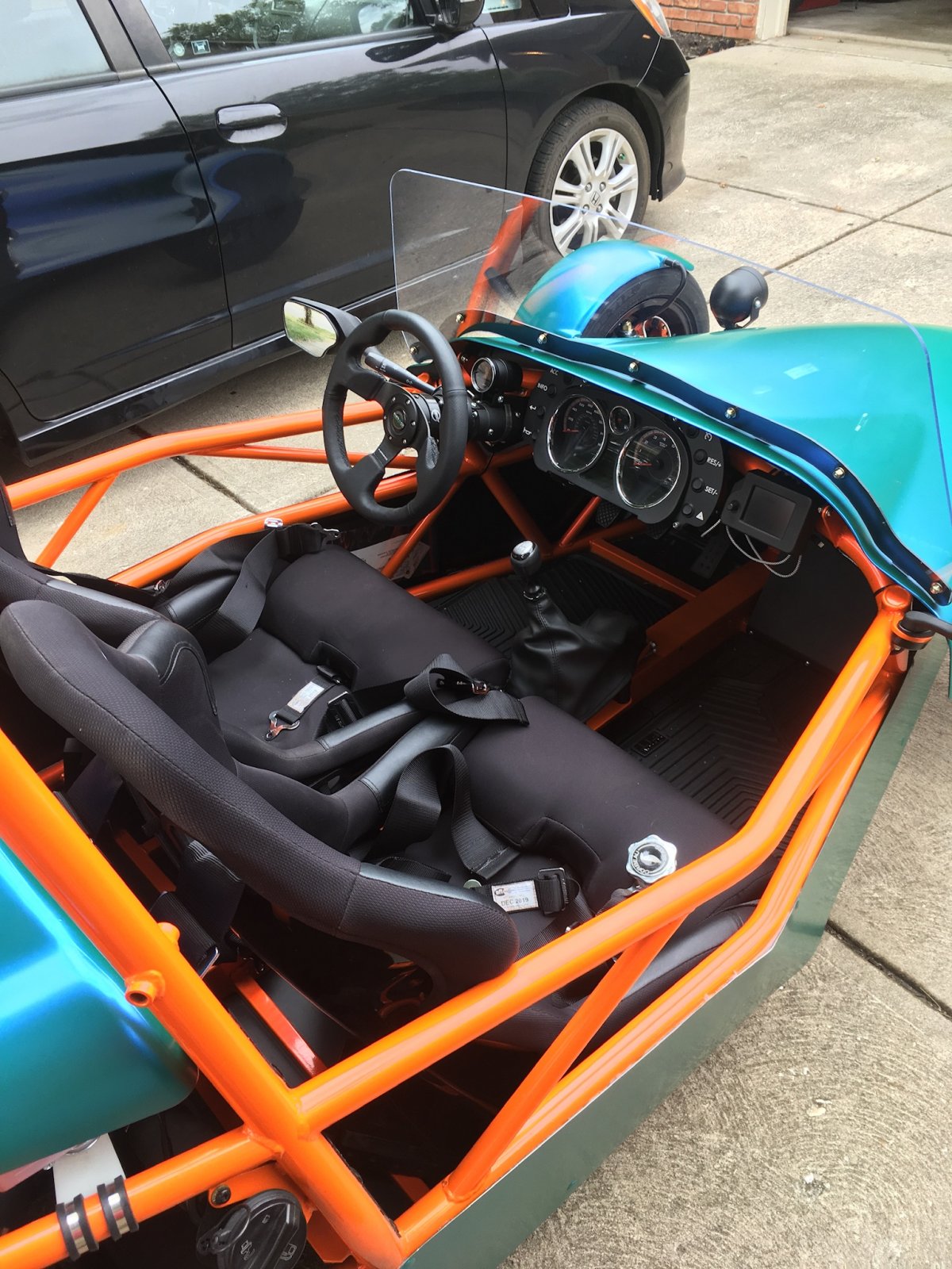

I have the Corbeau wide seats installed in mine. I ordered mine through DF. They were shipped from the factory. I had to redrill the mounting holes fit the brackets and slightly message the seat fiberglass in order to get them to fit. The shoulder supports at the top center actually touch in the center and at the door bars. there is no room for the emergency brake - although I have never really needed one. I just carry a pair of wheel chocks.
The seats are REALLY comfortable. When I had it dynoed, the guy complemented the seats over and over.
I’m 6’2” and 275+/- lbs. They are great. My girls are 120ish pounds and the work for them too.

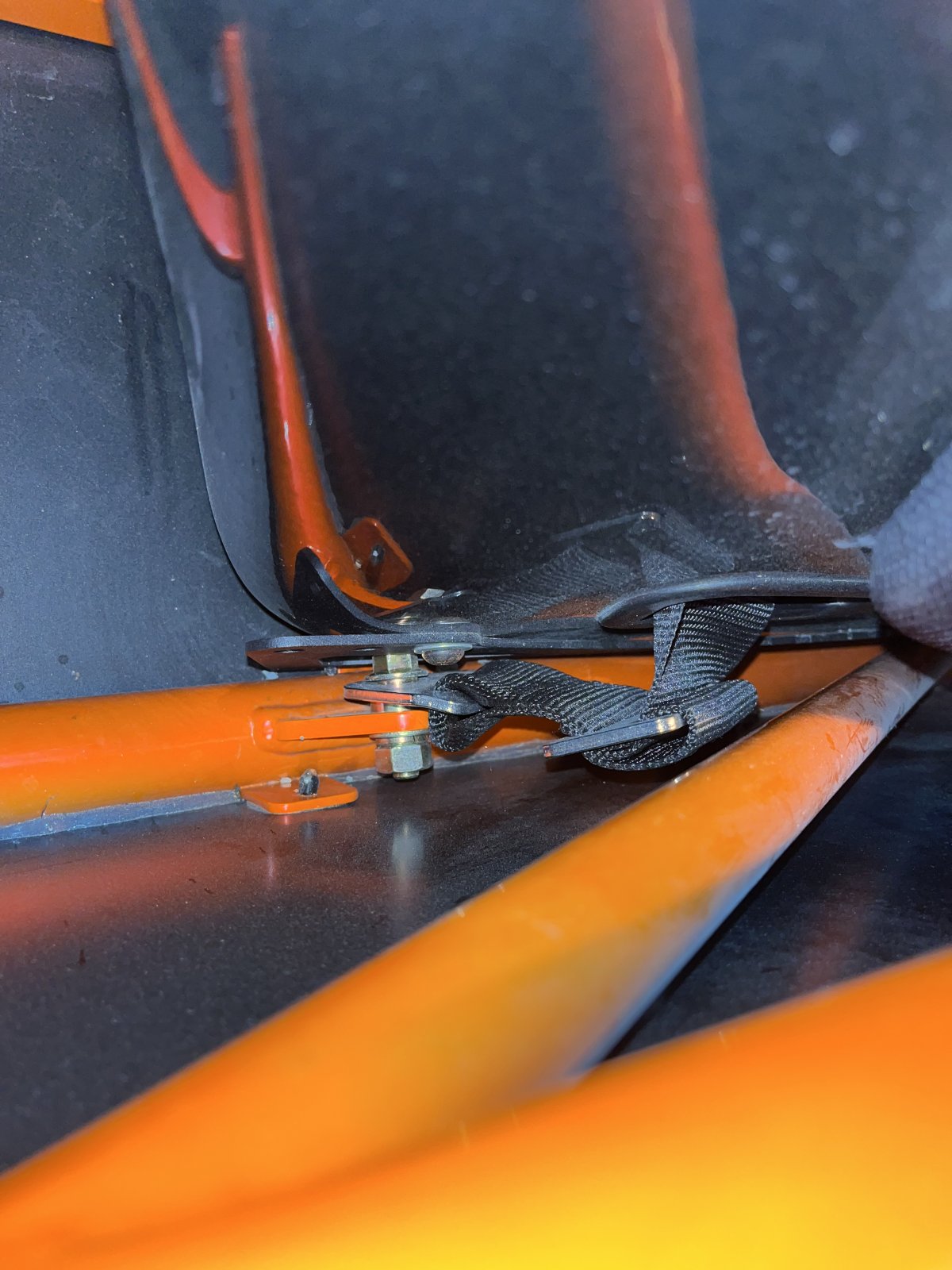

Here is a shot where the seat mounts to the bracket. It’s hard to see because the seat is so reflective. It’s tight in there. I think I also had to drill a relief in the seat for the seatbelt bolt on the outside side…. Get some gloss and flat black fingernail polish. It will be you best friend for covering blemishes and fixes.
The second shot is how much I moved over the seat bracket. I definitely remember bending and tweaking the seat rails with a crescent wrench to get everything to fit. You can see the bend to the outside in the pic. It took a whole day to get them to fit. They were in and out dozens of times.

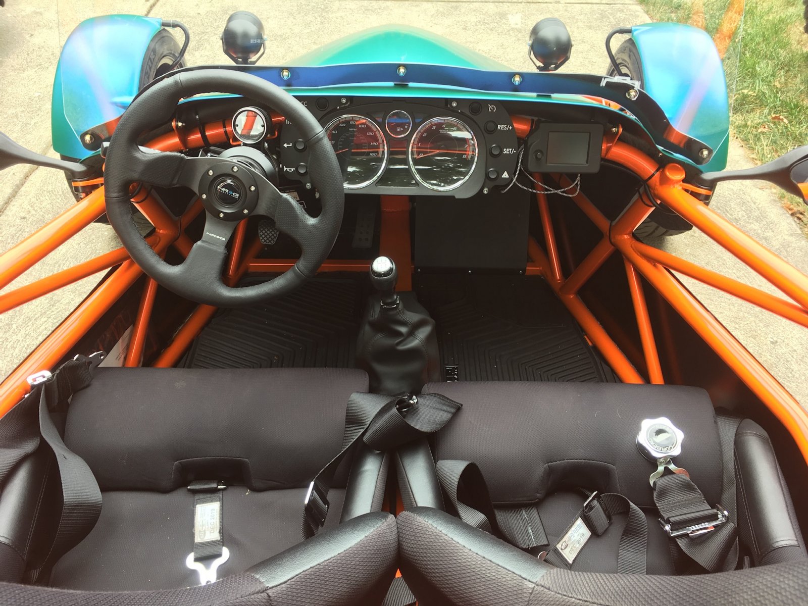

The next two are that the seats barely fit and touch on both sides.
