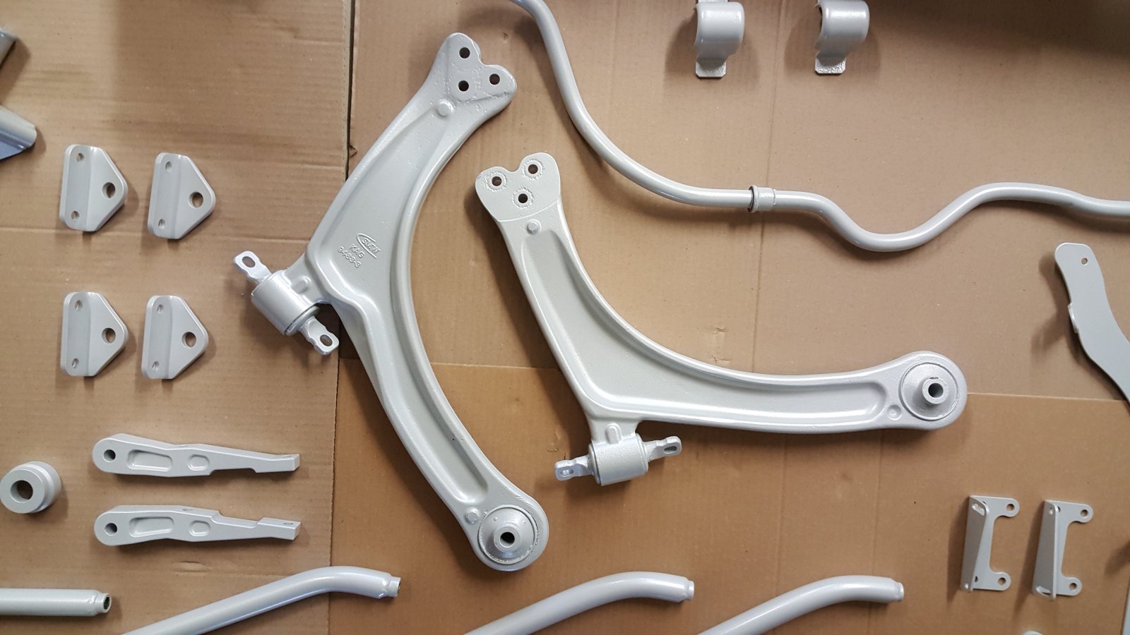

I'm not yet ready to install many of my suspension components, but I realized today that my powder coater did not return my notes with my coated parts. I'm able to figure out most of it from pictures that I had taken beforehand. However, I am not sure on the orientation of my control arms for the rear of the Goblin (front of the Cobalt). There are numbers stamped on one side of the control arms (9482-3 on one, 9483-3 on the other), but not sure if the numbers face up or down during installation, or which control arm goes to which side. I removed the factory ball joints, so not sure which side of the control arm the new ball joints go on. Help?
I'm not yet ready to install many of my suspension components, but I realized today that my powder coater did not return my notes with my coated parts. I'm able to figure out most of it from pictures that I had taken beforehand. However, I am not sure on the orientation of my control arms for the rear of the Goblin (front of the Cobalt). There are numbers stamped on one side of the control arms (9482-3 on one, 9483-3 on the other), but not sure if the numbers face up or down during installation, or which control arm goes to which side. I removed the factory ball joints, so not sure which side of the control arm the new ball joints go on. Help? View attachment 31989
The arm on the left is oriented up and is the passenger side, the one on the right is oriented facing down and needs to be flipped upright for the driver side. :)
The powder coating needs to be removed from the rear bushings before installing the arms, since they have to move feely.
Iwanttogofast
just match the orientations in this picture ;)

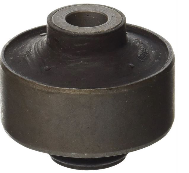

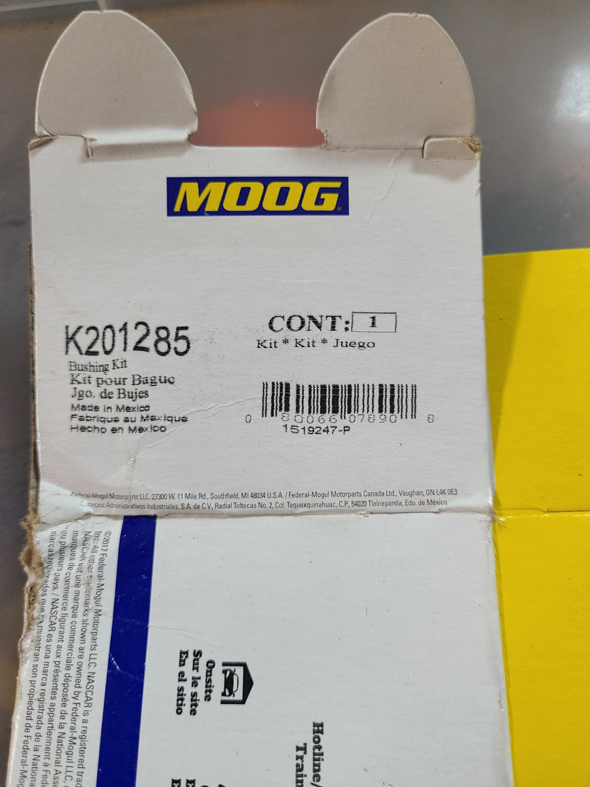

Ok that’s what I figured - do you know the part number of the steel bushing he is referring to? I checked Moog’s as well as rockauto website and did not see a full steel bushing
This is the Moog bushing.

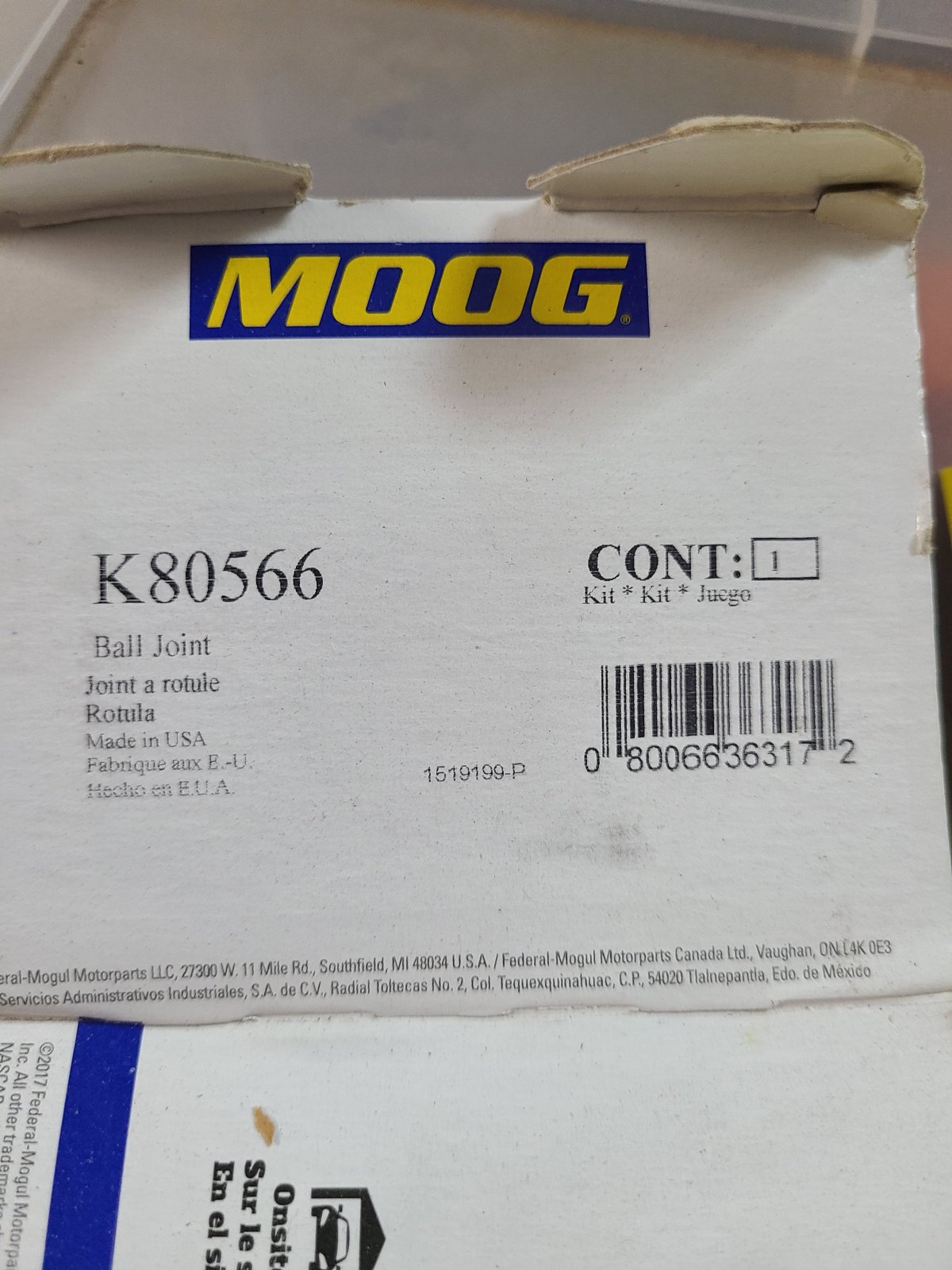

This is the Moog ball joint - for SS/TC 2008-2010.
I need some clarification. It was my understanding from past posts that the FE5 ball joints had a larger diameter stud and no one, including Moog, made a ball joint of the proper diameter. Have you measured the stud diameter of your old ball joint and Moog K80566? If they are the same, this is good news. Am I right that my 2009 SS/TC has a FE5 suspension?
There is some disagreement on whether the moog is the right size ball joint for the SS/TC. Desert Sasq got one that worked but he is the only one that I’m aware of. I tried it and got one that is too small. Someone else contacted Moog tech support and was told they don’t fit.

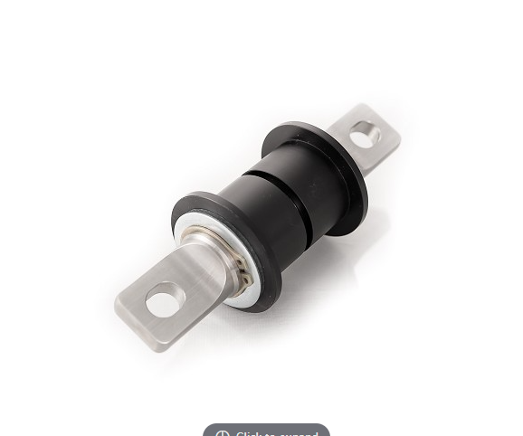

These are the Moog heim bushings. OTTP make some too that are more beefy, but not sure they are worth the extra expense.
The non-TC ball joints have a 0.750(+/-) inch stub on top. The TC ball joints have a 0.805(+/-) inch stub. Because of the GM suspension codes from year to year, both of these ball joints are considered FE5 parts even though they are not interchangeable. This has caused many problems trying to get replacement parts, as has been discussed at length on the forum.

here is a solid rubber ZZP offering. I am using these. REMOVE OEM STEEL RING from control arm before installing these.
32443
That’s barely above stock. If you are going through the trouble of pressing in bushings, I would at least do the heim bushings.
pro tip-
Put the bushing in the freezer over night. It makes pressing them in a lot easier. Bonus points for heating up the control arm to also make it easier.

Thanks for the help guys - I had actually placed an order for the Moog's and cancelled it once I saw that OOTP made some. Any further thoughts on whether or not they are worth the coin? I also saw that they make bushings for the front:
