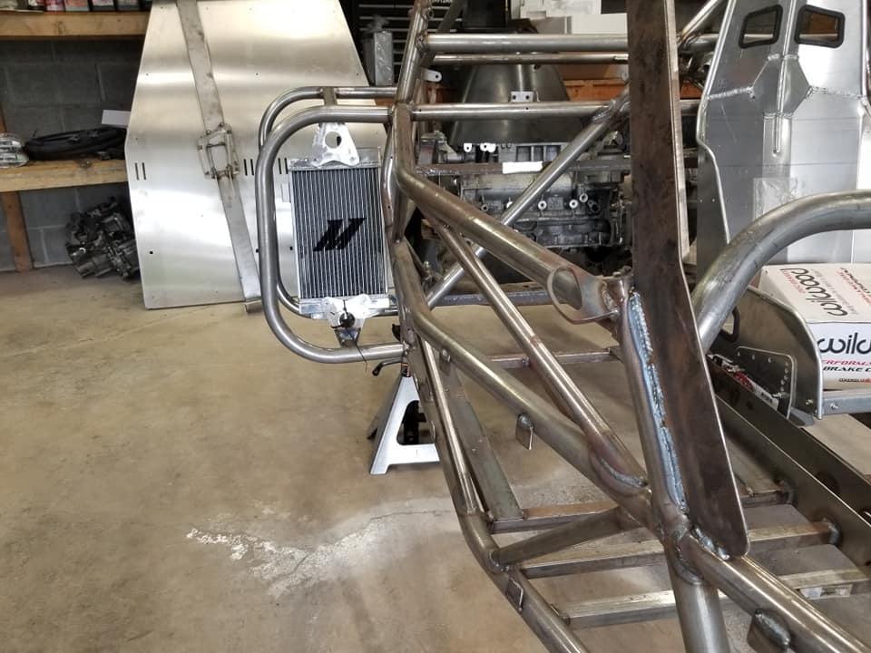

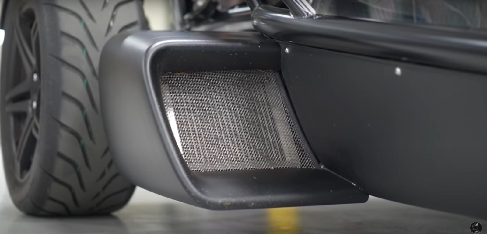

Here is another spot to that might work for the intercooler. Ariel atom 3 pics:
View attachment 13849View attachment 13850
That is where I got the idea to mount my heat exchangers for my supercharger.
13886
R

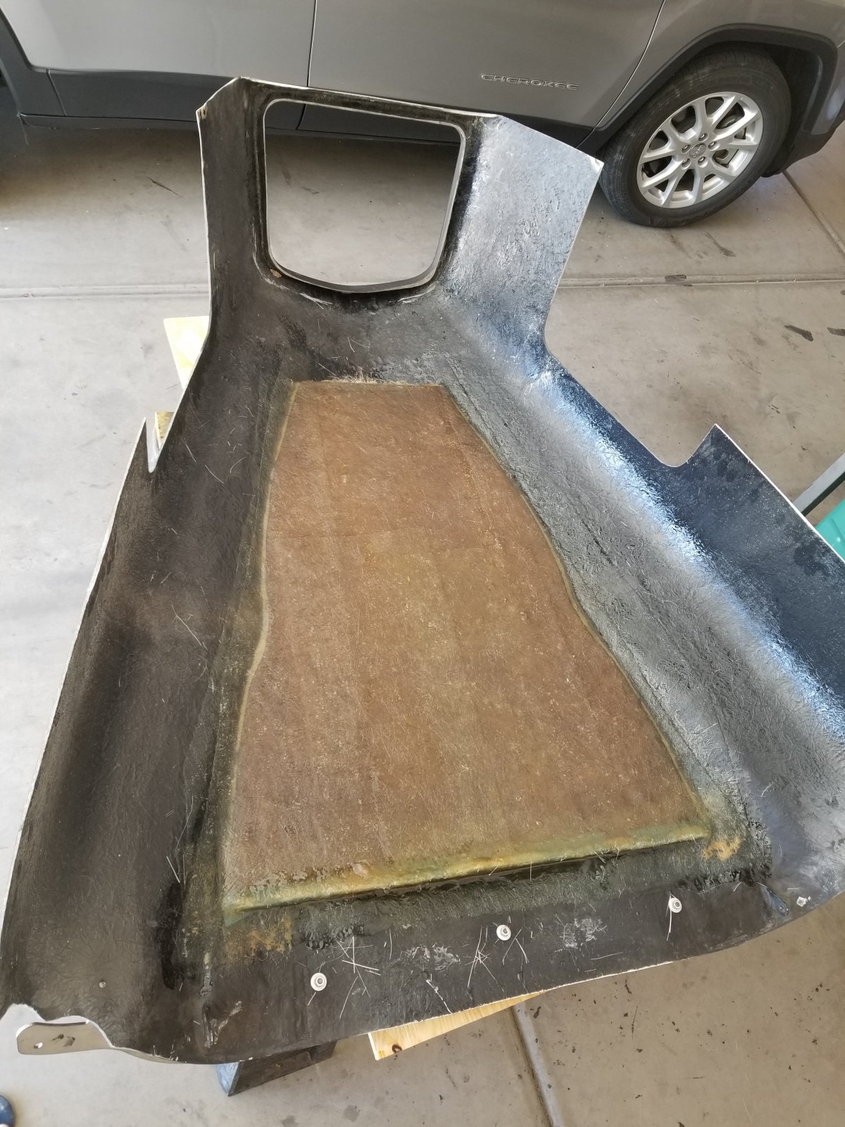

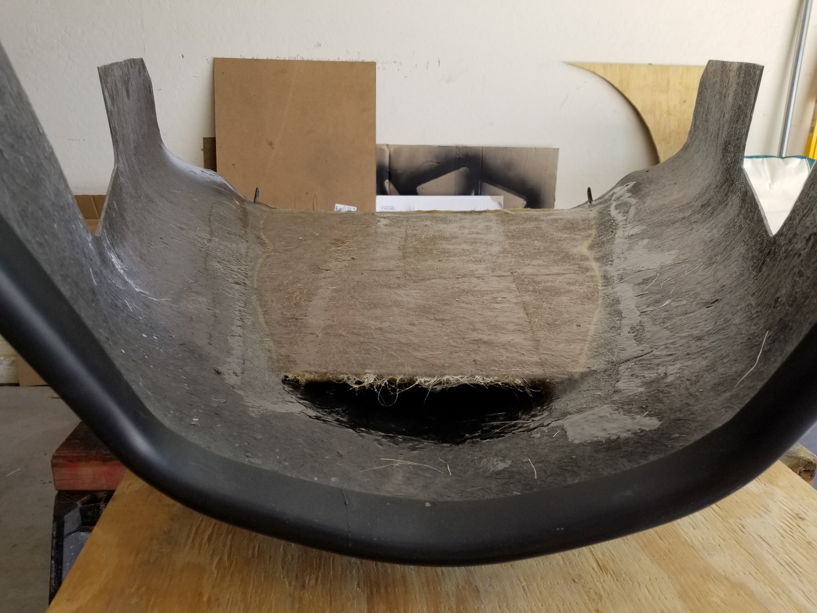

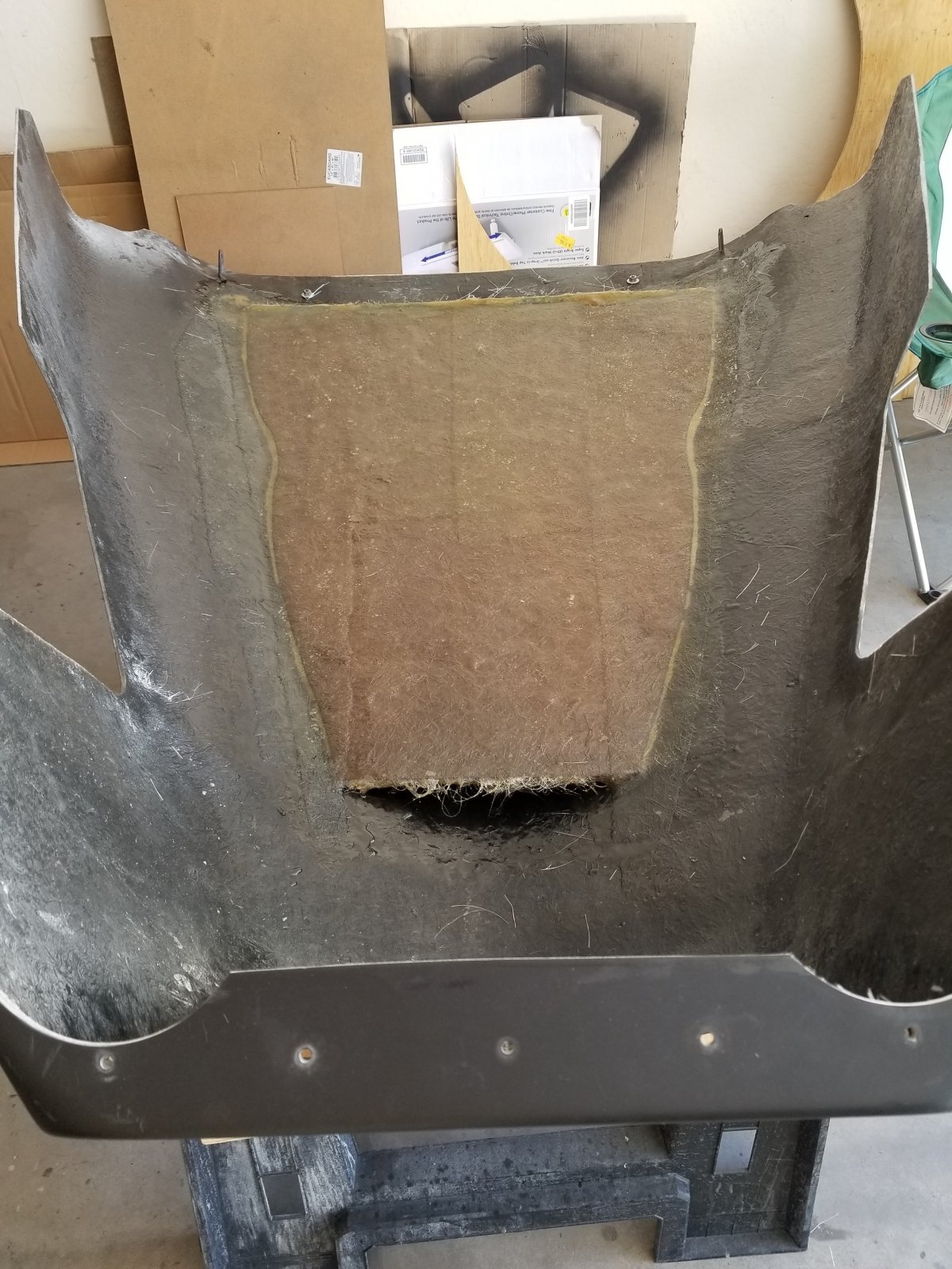

Or putting a cold air plenum into the underside of the hood that draws directly from in front of the radiator. It is open in the natural gap between the bottom of the hood and top of the radiator, where anything above 10mph will push air into the plenum. There will be adjustable vents in the rear side of the plenum to direct air at the driver/passenger feet/knees.
A few more photos.
I would be concerned that would still draw hot air from the radiator especially when stopped. Maybe when the cooling fan is running it will pull the hot air down and away enough.
There is no airflow when stopped, like there is no airflow thru NACA ducts when stopped. As soon as you start moving cool air enters the opening at the front of the hood and 'piles up' in front of the radiator as it gets passed thru the radiator fins. This packed up cold air gets pushed up - default from the radiator angle - towards the opening in the plenum. This push slightly pressurize the plenum, same as air pushing into the NACA ducts, resulting in positive airflow which then exits the cooling ducts at the rear. As you said, the radiator fan pulls the cold air thru the radiator which becomes hot air and then exits out the open sides of the hood between the suspension arms. BTW, putting the NACA ducts behind this opening in the sides of the panels will get a mix of hot and cold air that is somewhat turbulent at that location.
EDIT: an extra added benefit is the panel makes the hood stiffer - and weight added by the plenum is on the front of the car, where it is needed.
