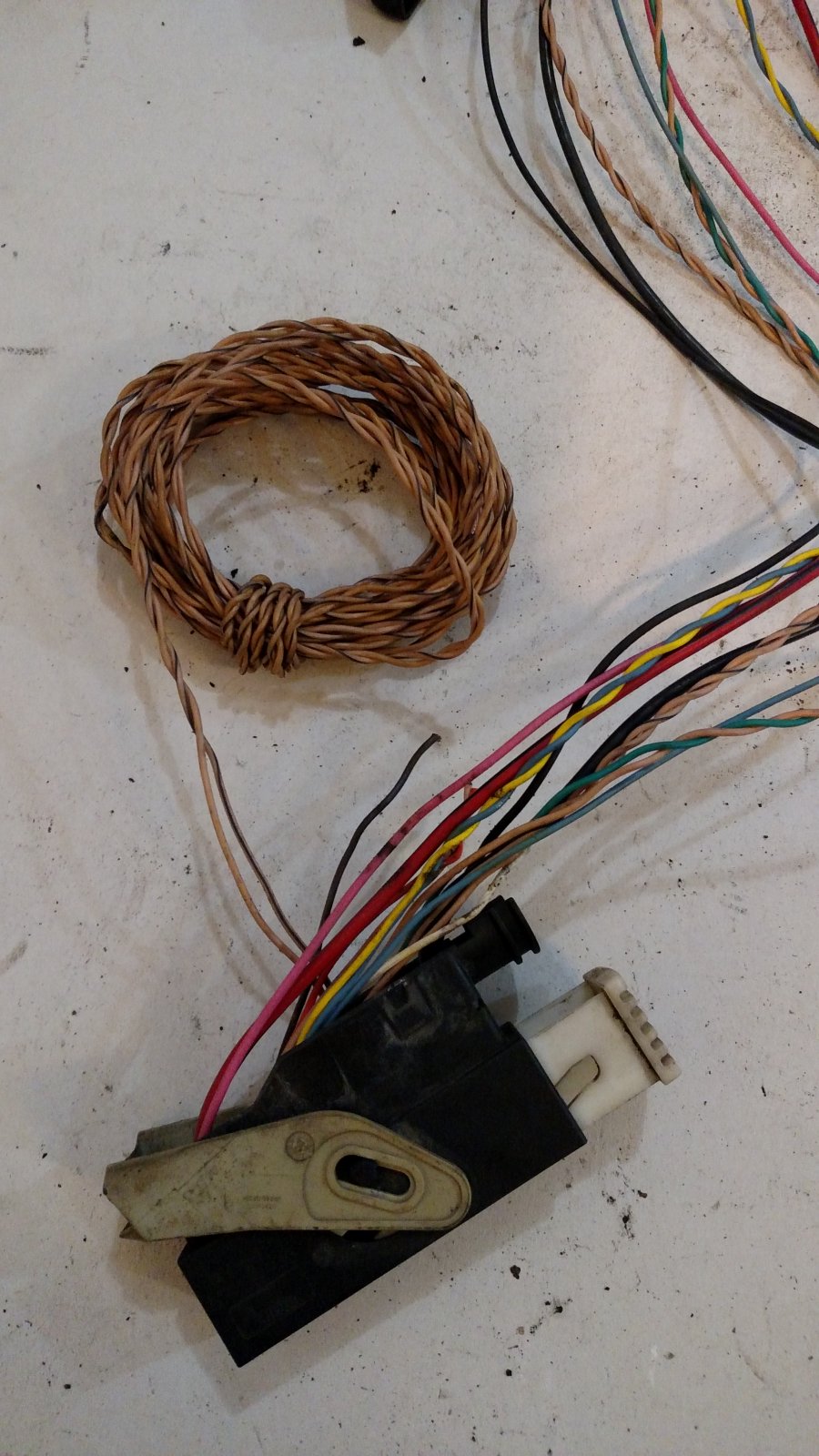

Cool thank you I will try to find that post. Actually one of my questions is with the brown data wires. They say to leave them on the black and purple connector but there is no such connector. This is the opposite connector of the black and blue so this is what I did not sure if it's right or not.
Those are the wires I was referring to. I called them tan, but you are probably correct with brown. They should go from the ECM plug then through the large dash plug and then to the BCM. Tonight I can take photos of the plugs and the pin locations of each plug.
I was missing the purple and black connector also.

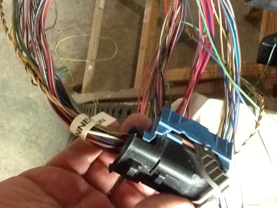

The two data wires should start at the ECM plug as shown below....

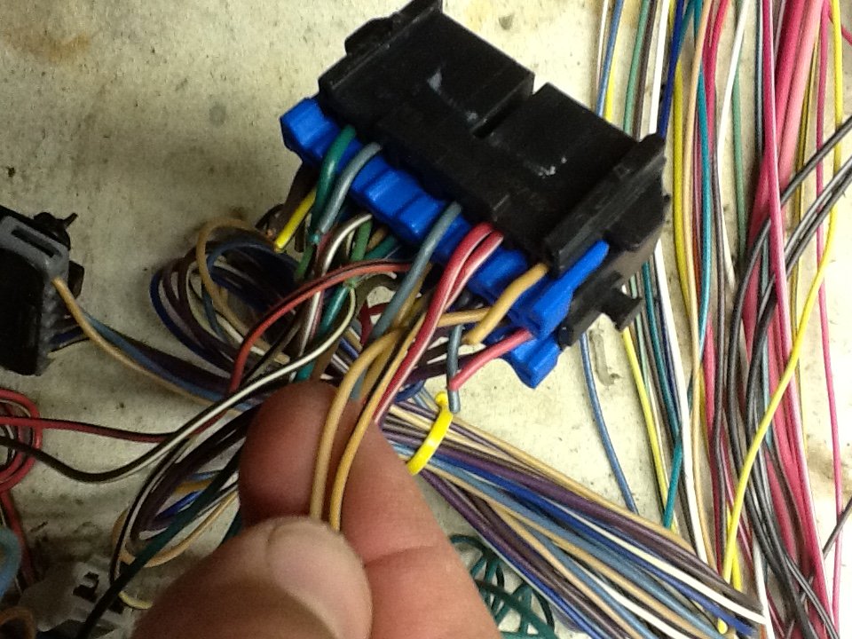

Then go to the dash connector.....

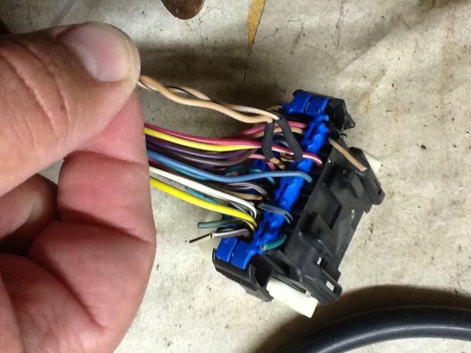

Out the other side of the dash connector (in one plug and out the matching plug)....

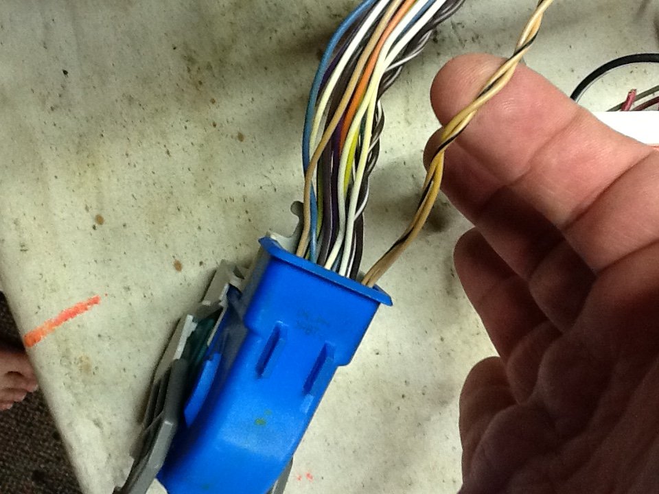

And then onto the BCM connector....
If I'm wrong, please correct me but this is the way I understood it to be. Hope this helps.
I believe that connector you show is the one from the ABS (anti-lock brakes) controller. You will remove that connector altogether if you aren't going to use the ABS. Cut the data wires there and use them to solder the connection between photo one and two of my previous post.
Allyn
Sure enough that is the ABS connector and I found the data wire that I'm going to need for the other plugs. Thank you very much. So I can eliminate all the wires coming from that connector if I'm not using abs?
