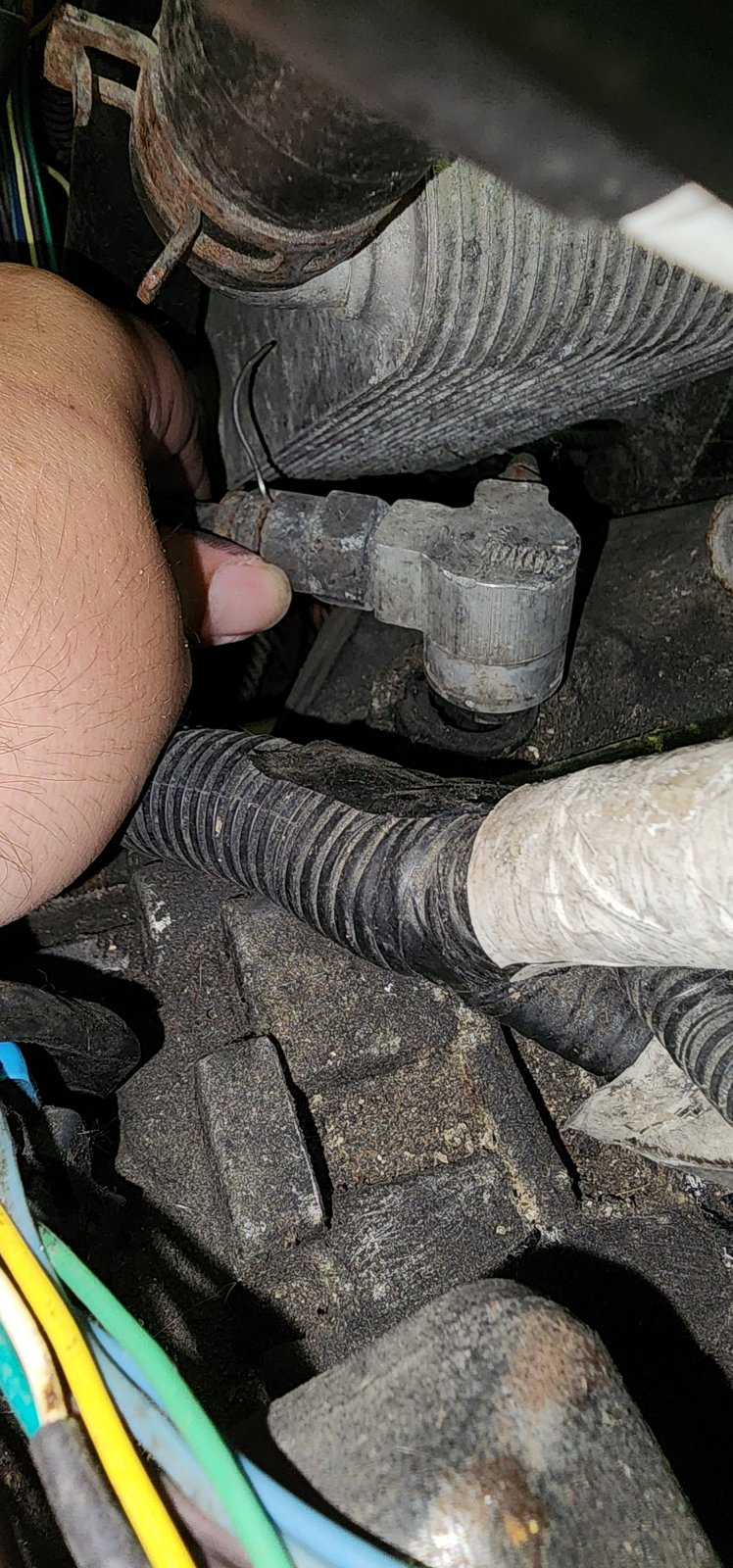

I have no clue why my clutch line is like this
When I got the car my clutch line was off like this and I have no clue if/how to fix it. It seems that it can spin around and that it isn't fully seated on the trans (f35)
How exactly is this supposed to be, hopefully I don't have to replace anything internal just yet.

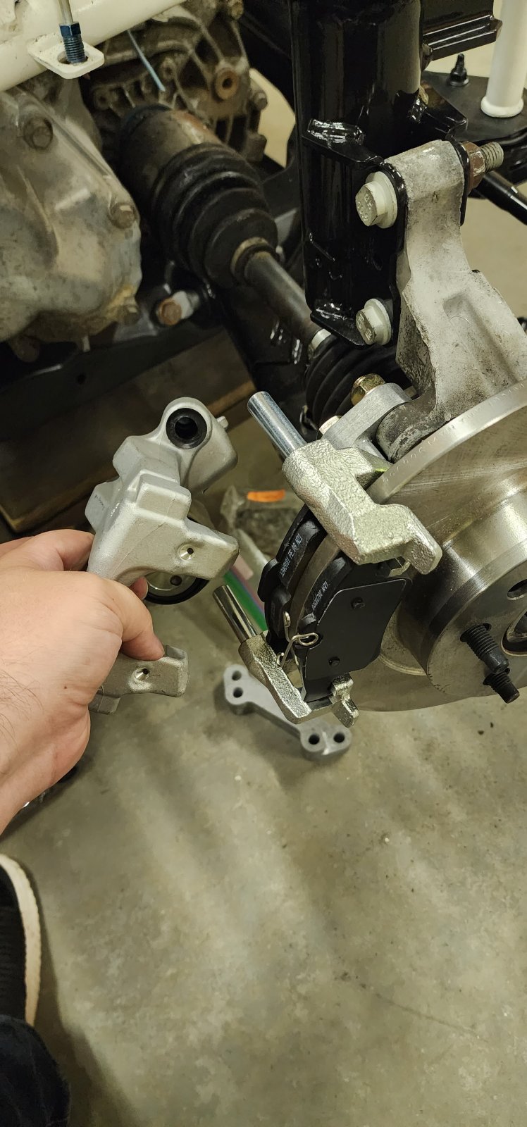

Maybe I'm just dumb after an extra long day at work but how exactly am I supposed yo get the rear calipers over the pads and rotors?
The fronts have bolts you can remove to slide the calipers overtop but the rears have the shafts to alow the calipers to move around with the rotors.

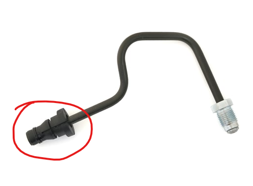

It looks like this piece might be missing or broken on yours?

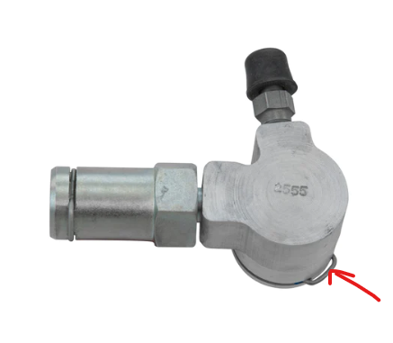

There's a clip that locks the elbow to that plastic piece

Yes, that hard pipe goes down to the slave cylinder. I believe there is an access panel you can take off that would let you feel around in there, maybe the black piece just fell down inside.

My first block did that, when I replaced that metal unit and the internal line to the TOB, it didn’t. It’s because the line to the TOB is stretched upward and not pulling that block down to sit in it’s groove.
The clip that locks the clutch line in place goes on this way. GM calls this thing a distribution block.

The circled end of this clutch pipe is on the outside of the transmission, the silver end is inside, and goes to the TOB (Throw out bearing).
You figured out the brakes!, good. A Warning! ??Does the clutch pipe sticking out of your trans look different? The top of the clutch pipe is all rubber and if it is missing on your trans it can be removed from a new clutch pipe and installed on The old one!! That seal is NOT available separately! But it is very special and if missing is worth sacrificing a new clutch pipe to get one! Installing a new clutch pipe would require transmission Removal and Reinstall, very time consuming. Moving the rubber piece over to your old pipe only takes a minute. I learned the hard way!
