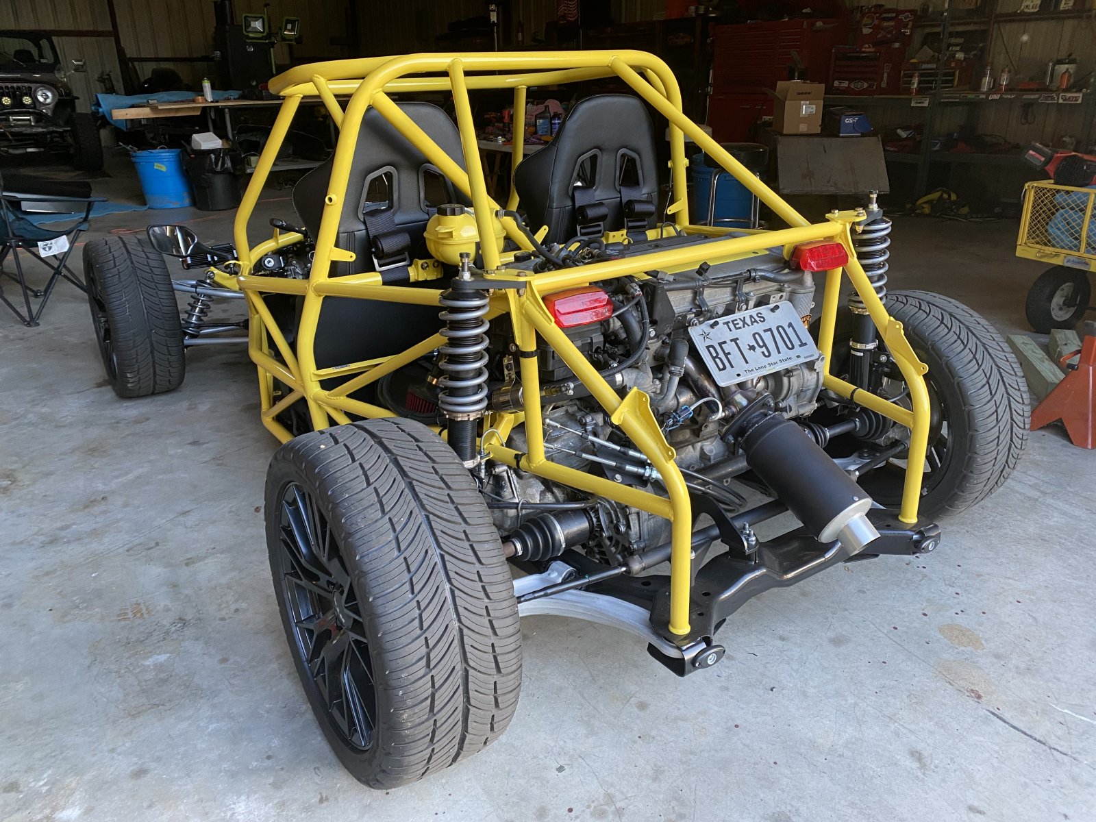

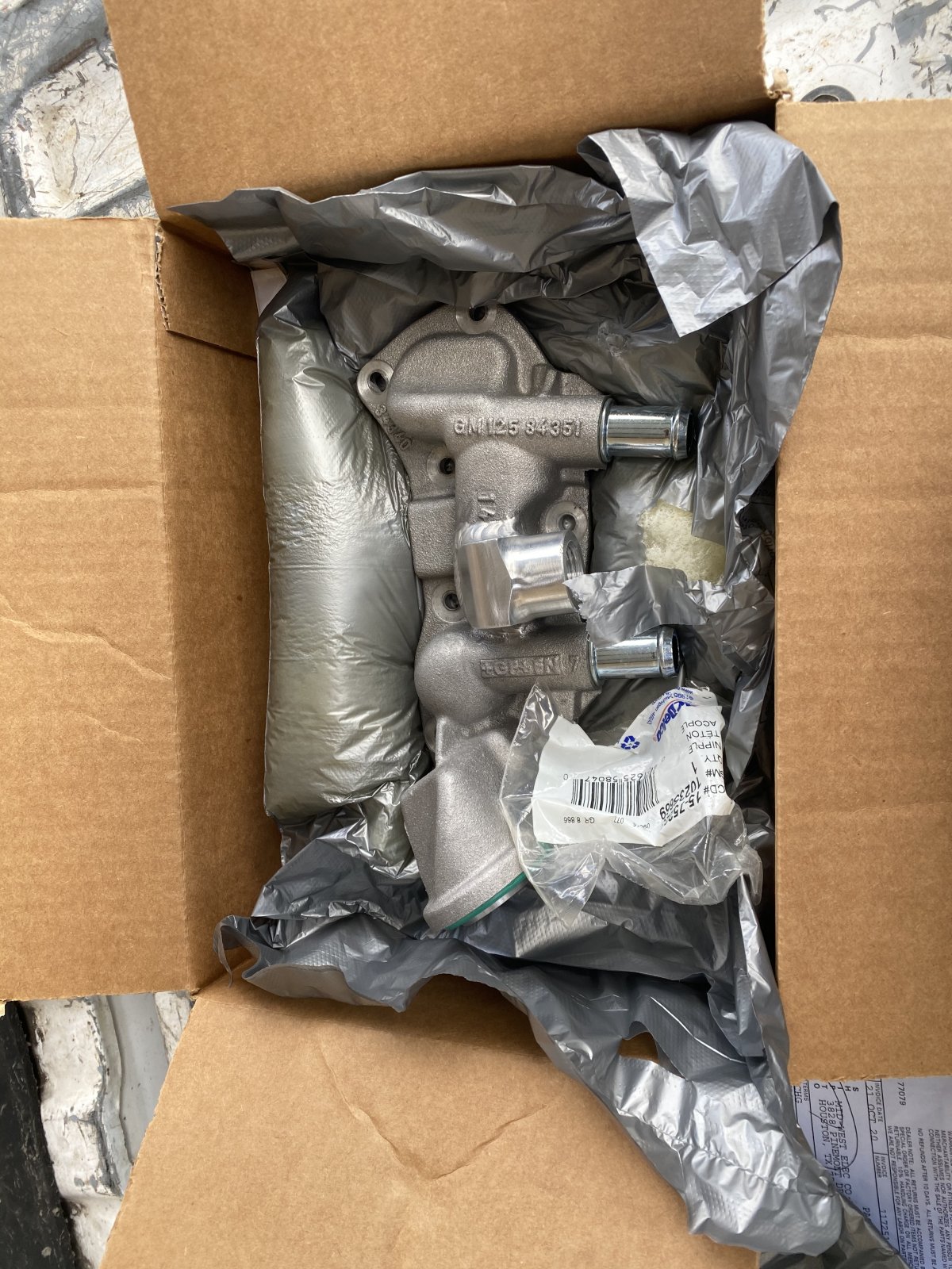

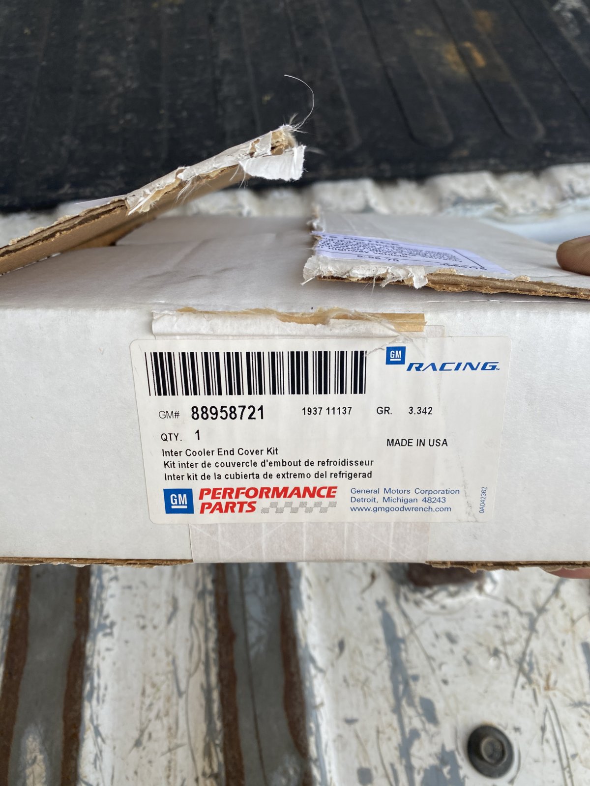

Since zzp and all other outlets I could find is out of the dual pass cooler, with a bunch of phone calls, come to find out, It can still be ordered from the dealer in their GM performance line. It will come up as “out of stock”, but it’s actually considered “order through manufacturer”. This means, you order it and they will send it to you. I got mine in less than a week. :cool:
part number Dual pass endplate 88958721

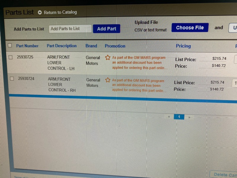

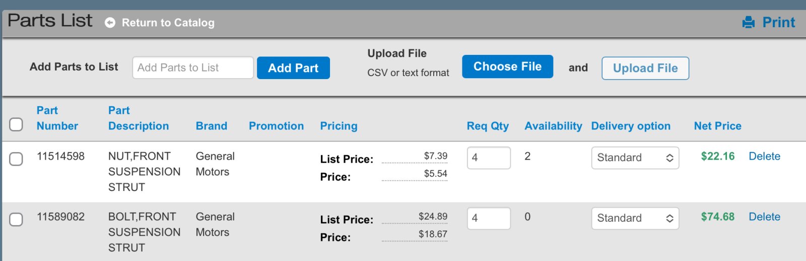

Aluminum lower control arms for TC models, GM part numbers

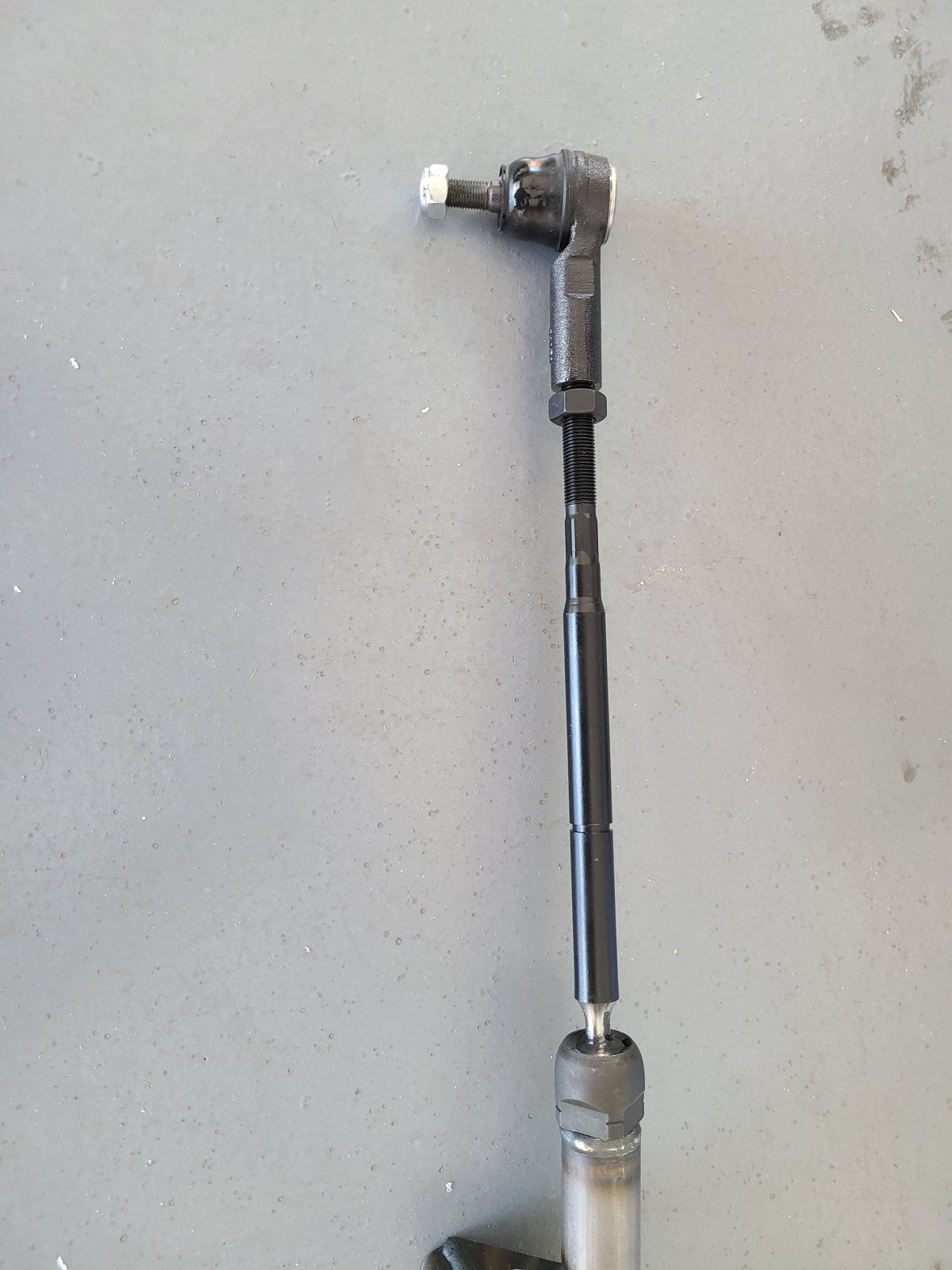

Moog 512287
53586
These fit the tie-rod brace that replaces the rack and pinion in the rear. Mine arrived last night and I checked them out. basically 4 for less than one of the official GM part numbers.
Amazon.com: Kozelo 4 Pcs Hex Head Screws Bolts - [M12-1.75x150] Carbon Steel Grade 10.9 Fully Threaded Hex Tap Metric Hexagon Head Machine Bolts Right Hand External Hex Drive, Black : Industrial & Scientific
Just to clarify, that thing is called "Toe Link Bar".(A bit of DF Goblin science I am quite grateful for!)
