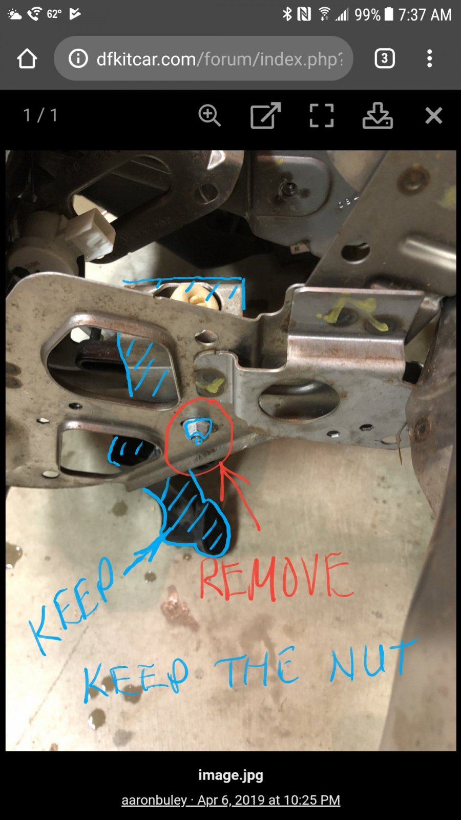

It appears to be spot welded to the dash. I’m guessing I don’t get a new one with the kit. What did y’all do to remove it?

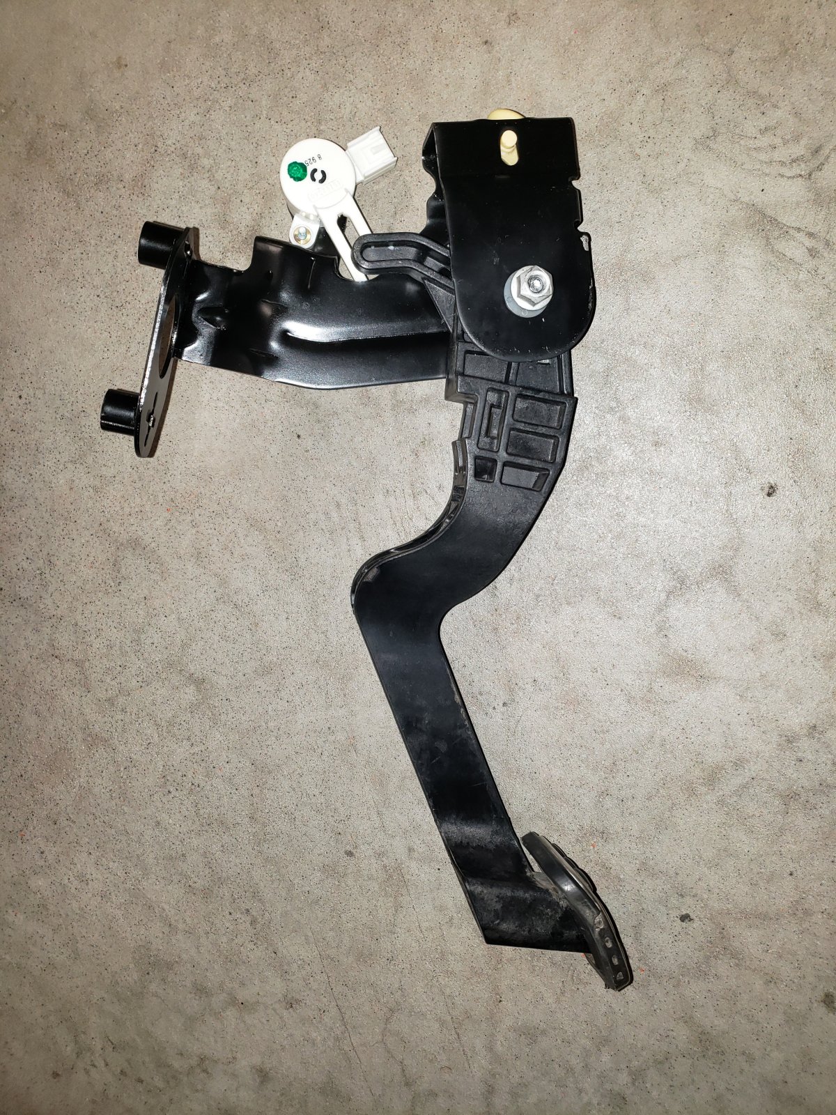

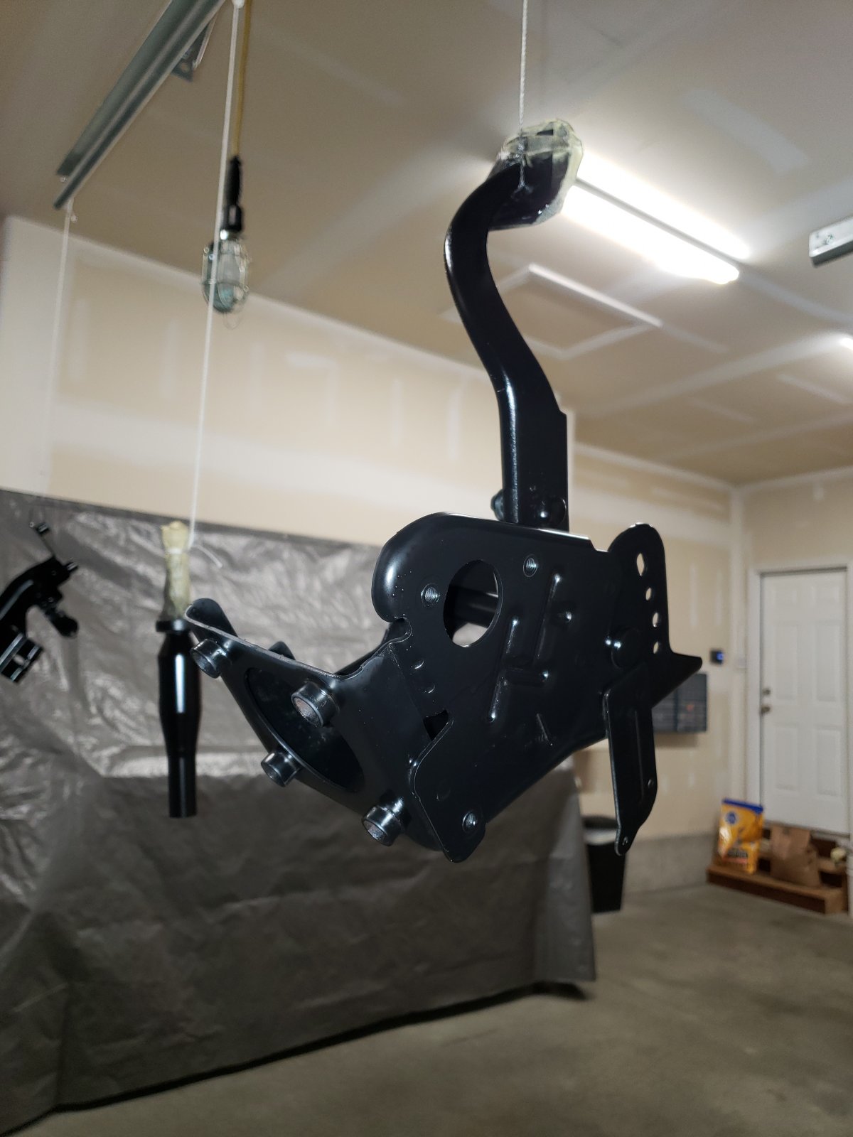

You actually remove the whole pedal box assembly. I just hung mine up and painted it, so it's upside down and looks to be slightly different then yours. You can see the four tubes on the bottom that the bolts go through to mount it to the firewall plate. I have everything removed but the pedal.
That was the brake and throttle that Tim was showing you. For the clutch, after you remove the clutch master cylinder you will need to take the nut off the pivot bolt and remove the two nuts from the front of the mount and the assembly will come out. It is not welded
