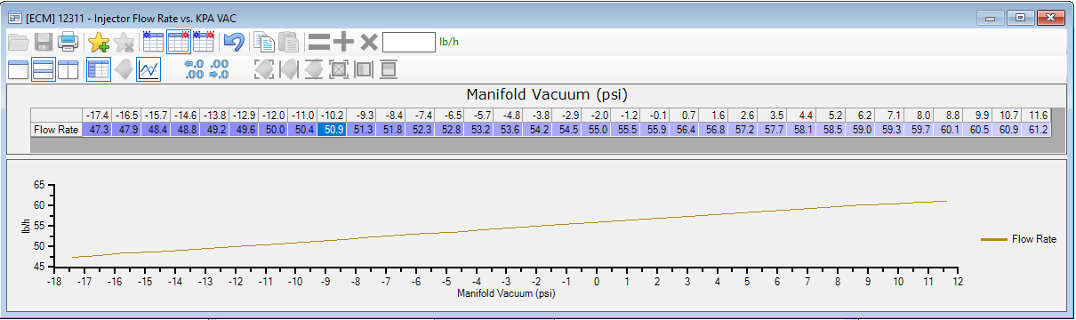

Do you have a boost reference fuel pressure regulator? It's odd that your Injector Flow Rate is almost a straight line. Usually you see that with boost referenced system. Not trying to say is wrong, just wondering and trying to understand things. Your VE table is interesting.

I do not but was thinking of going down that route, matter of fact I was talking to a friend last weekend that mentioned not having one may result in your tuner hating you...…

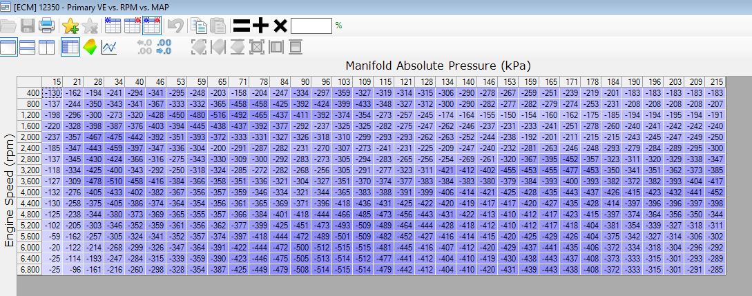

I compared my VE table to Ross's and its consistently lower everywhere. Tuner may have had a hard time, the car was on the dyno for hours but was a little less jerky afterwards.

I attached the difference in Ross and My VE tables if I understand it correctly I'm consistently/substantially lower everywhere. Isn't the VE table a representation of how much air is coming in ? My wideband is giving me lean readings and I wonder if this table is not commanding enough gas for the amount of air.
Since you don't have a Boost-referenced system, I would think it would be more accurate to have the injector flow rates on a slope much like that of the stock (only higher values). The flow is going to vary depending on the intake vacuum/pressure. In a boost referenced system, the difference in vacuum/pressure is used to modify the fuel pressure to compensate.
More like this:

The VE table is used to calculate the injector pulses. The MAF is used more to provide how much air is ingested. It's not uncommon to see high AFR on a wideband at certain times. This is especially true during decel, the ECM will cut much of the fuel using the DFCO. When you run into problems is lean during accel or tip in. To really know if it's right or wrong, you need to compare the ECM's commanded AFR (or lamda) versus what you are actually getting. It would be easier to look at a scan to see, but it has to be set up to show what to look for.

It seems like they turn things off to do the tune but don't turn them back on. I noticed on yours the Piston Protection is also disabled. I just find this strange, did they mean to disable it in the final tune? And your DFCO is disabled, again this is something that you disable while tuning the VE tables and should turn back on, but it's not. Again, I'm just questioning, not saying things are right or wrong.

That makes perfect sense. The way it was explained to me is that when the injectors are under normal circumstances there is a vacuum helping pulling or assisting the fuel out of the injectors. When there is boost there is pressure resisting the fuel from flowing out of the injectors as it normally would. I’m surprised that table has is so flat.
More like this:
I tried to change value and it appears 63.5 is set max value. looking at similar tunes they do adjust that chart incrementally from 38-63.5 . I have also noticed on Ross's shared file I can go into the transmission values and I cannot on my files. I have toggled back and forth to advance mode and even reinstalled VCM suite also tried the Beta version. For some reason I am getting limited views....... Since the parameters are visible it may be that I'm not pulling all the data from the ECM when I read.
