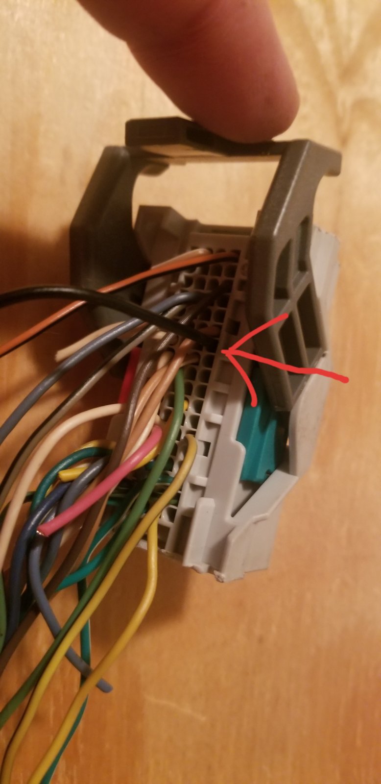

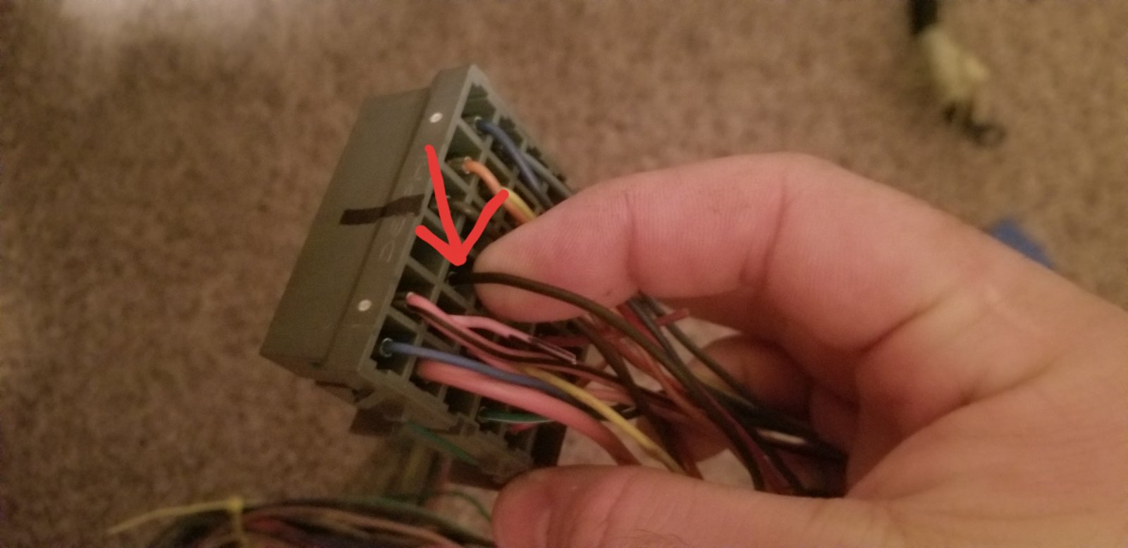

I'm working through the body thinning video part 2 (where Lonny finished thinning the body harness) and by the end of it I had 3 of the 4 copper ground lugs detached from the harness instead of the 2 Lonny says there should be.
Can someone help me figure out the location of the remaining ground lugs so I can suture this baby back together? The pictures are of the O ly two ground connections left.

Our Goblin has 3 ground lugs:
-side of the battery shelf
-side of the throttle pedal mount
-drivers side engine mount, under the fuse box.
So route all your ground wires to the nearest post... doesn't matter which one, long as it gets a good ground connection.
