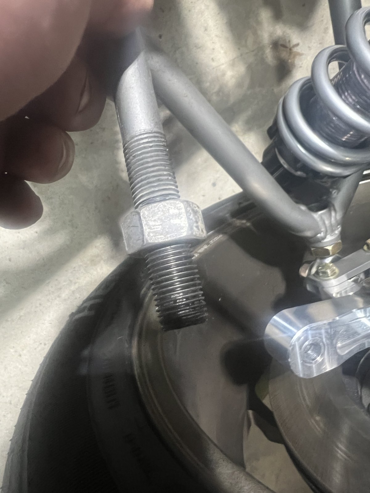

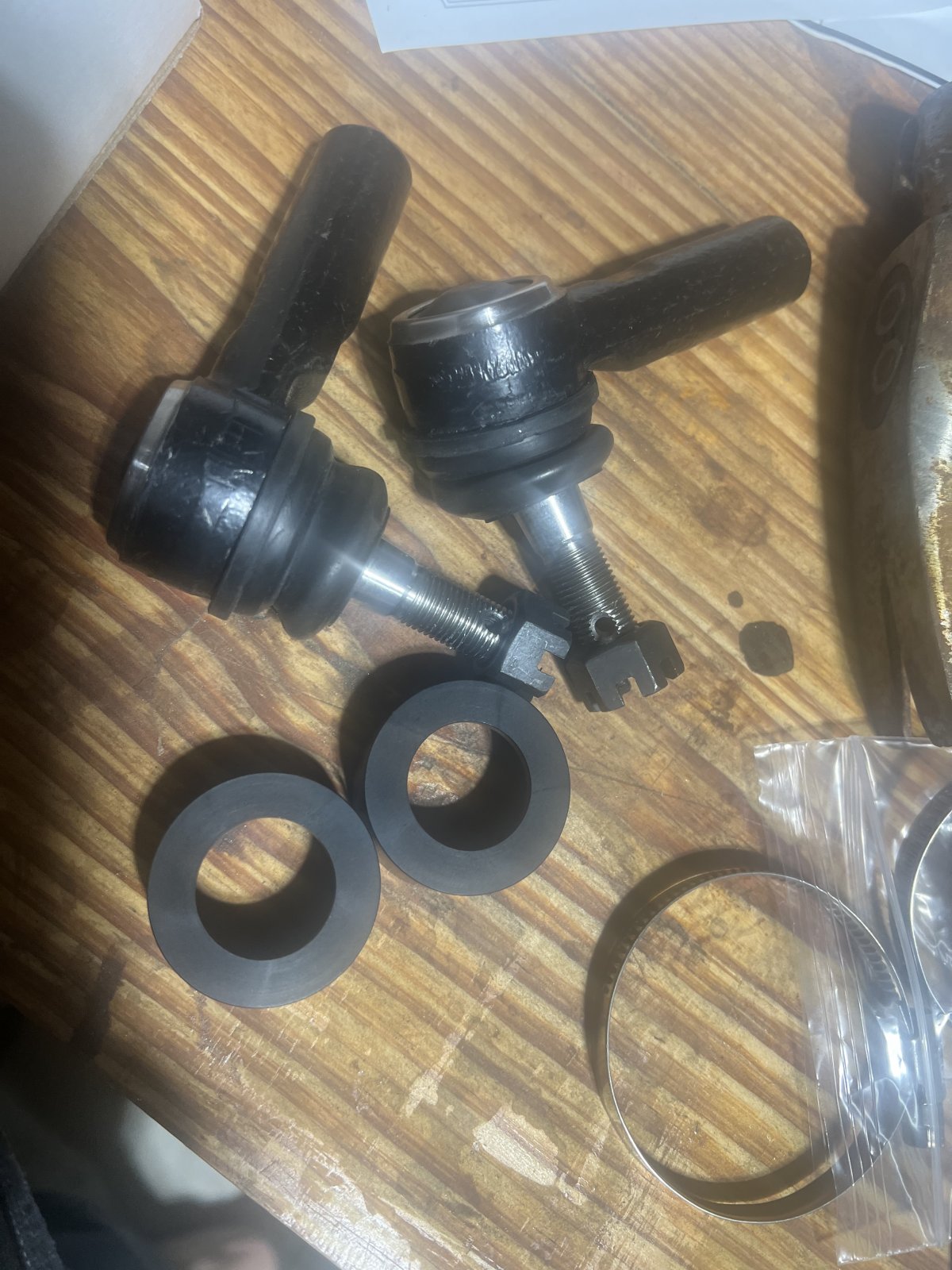

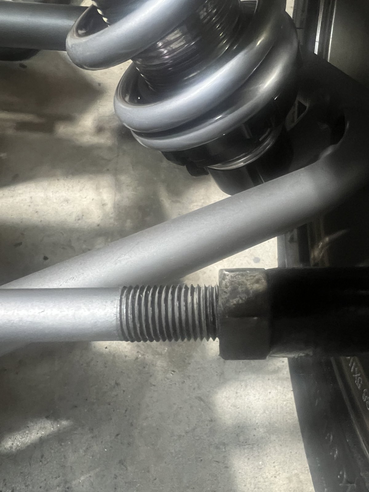

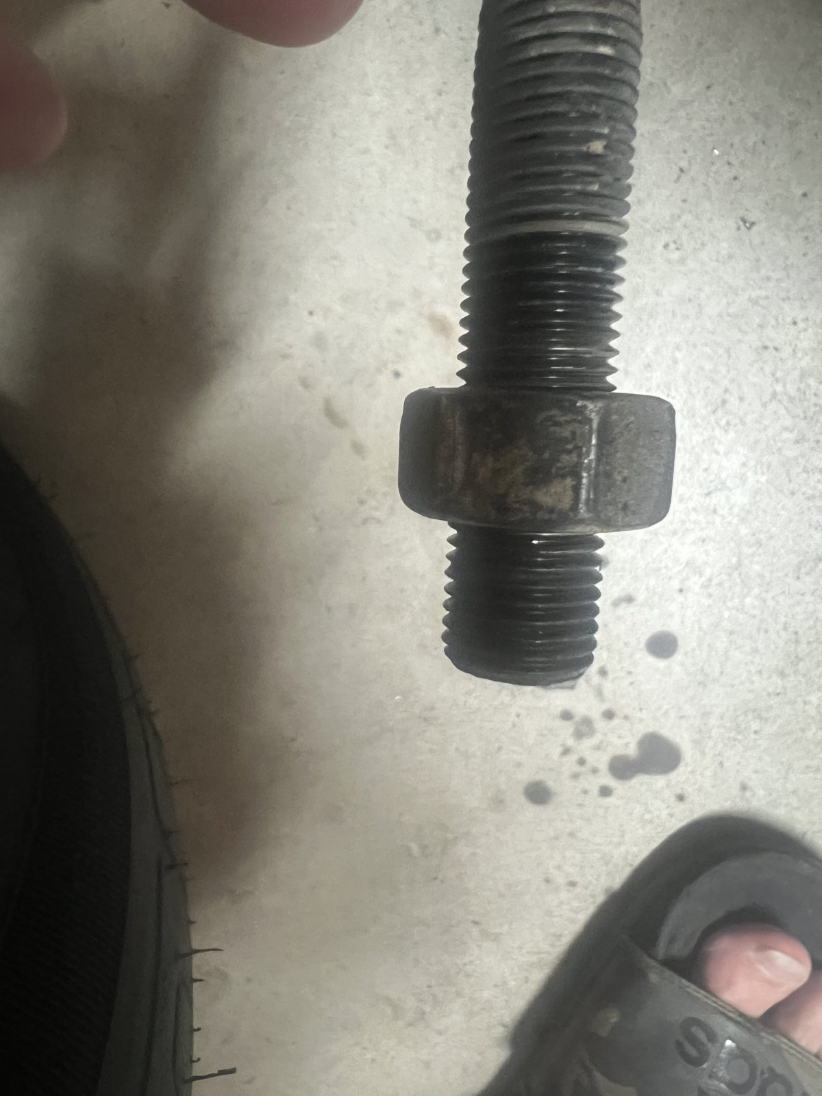

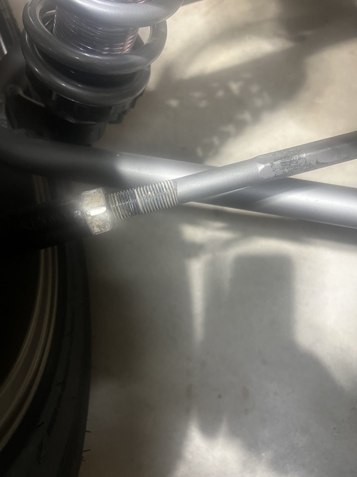

Ever wonder how many threads you’re steering on? Well I know I wondered when aligning my goblin front toes.i have taken pictures of before and after removal of goblin supplied tie rod ends. Total thread counted left and right 20. I had a split of 8 and 12 threads for my tie rod ends.I ordered Detroit axle tie rod ends for a colbalt standard 2.2. See if I can make ‘em fit I might cut them a bit if there to long. I think 8 to 10 threads for a tie rod end on a 1500lb car is plenty. I allways like to upgrade as I go and being Iam installing rack limiter I was allready working on it. I’ll add details on longer tie rod ends when they arrive.

Did you put the shorter, DF supplied, tie rod ends on the front of the goblin
and put the longer Cobalt tie rod ends on the rear of the goblin?
I have heard that the length of engaged threads should be the same (at least) length as the rod is in diameter. So a 14mm shaft, should have at least 14mm of thread engagement.
D&dgoblin69
Yes I used the supplied goblin tie rod ends up front. 25.4 mm equals a inch so 14 mm is 9/16 of an inch standard measurement. 8 to 10 threads is right at 14mm of threads that holds the outter tie rod to the inner tie rod. Yes I put the donor tie rods in the back.
