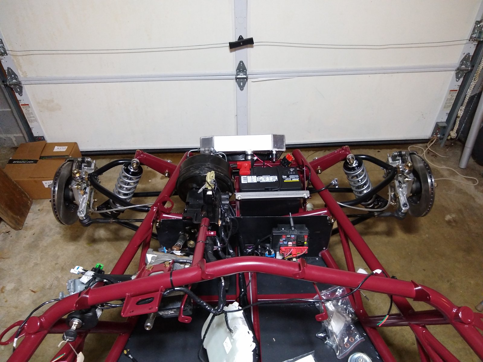

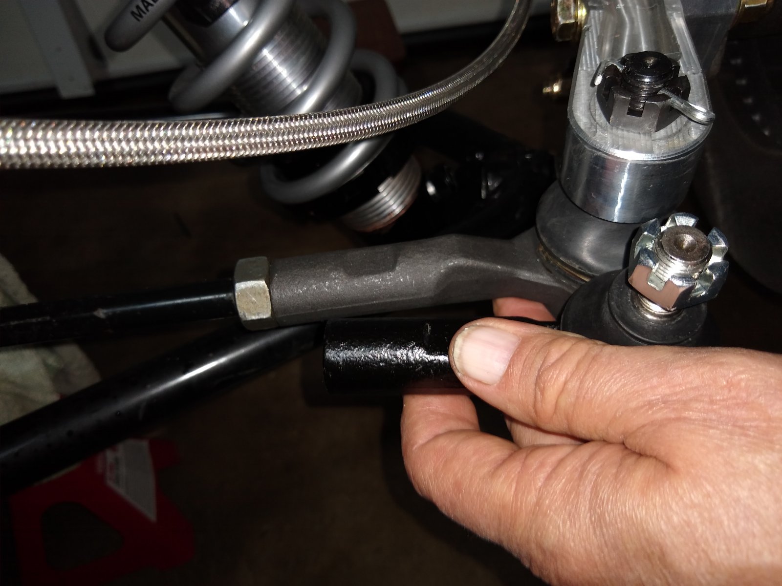

Pic 1 is the 3" on top of the 4 1/2". Pic 2 is the front end as it is now. Imagine the two steering arms pulled in 1 1/2" each and you can tell how far out the alignment would be.

I don't see anything wrong with the front end, but the pictures don't show me much.
Can you take some photos straight down on the steering arms and some of your ball joints/rod ends at the top and bottom of your upright ?
Roughly adjust your caster and camber and then check your toe with a tape measure and see where it is at.
Roughly: caster is 9*, camber is 4*, and toe is out 1/4". I have not installed the rear suspension yet and not installed the steering wheel yet. Tires and steering are not yet centered. I will be fine-tuning later.

The front suspension:
Lower A arms have all 3 heim joints threaded in almost all the way. About 1 thread left.
Upper A arms have about 4 threads visible on all the heim joints.
Tie rod ends have an inch on one side and 3/4" on the other of threads visible on the short(3.5") tie rod ends. 4.5" tie rod ends go on the rear.
I have just learned that the front rods and ends go to the back, and the back go to the front. This info is scattered throughout the forum and I had not noticed it before. I am putting it here, too, so there is one more chance of somebody seeing it.
