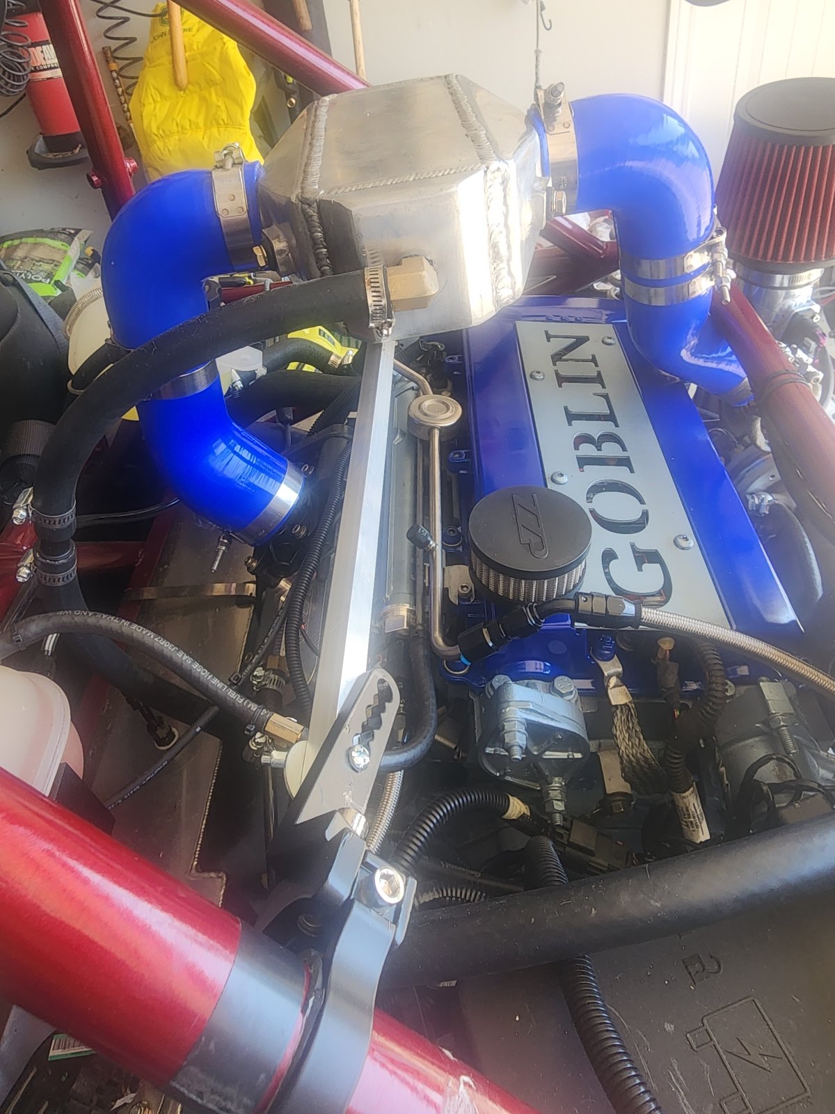

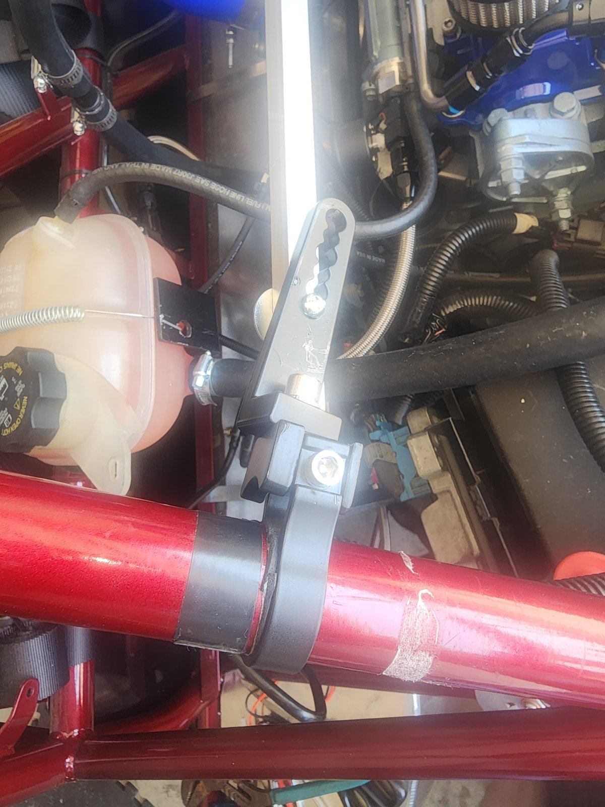

A2W support brace installed.

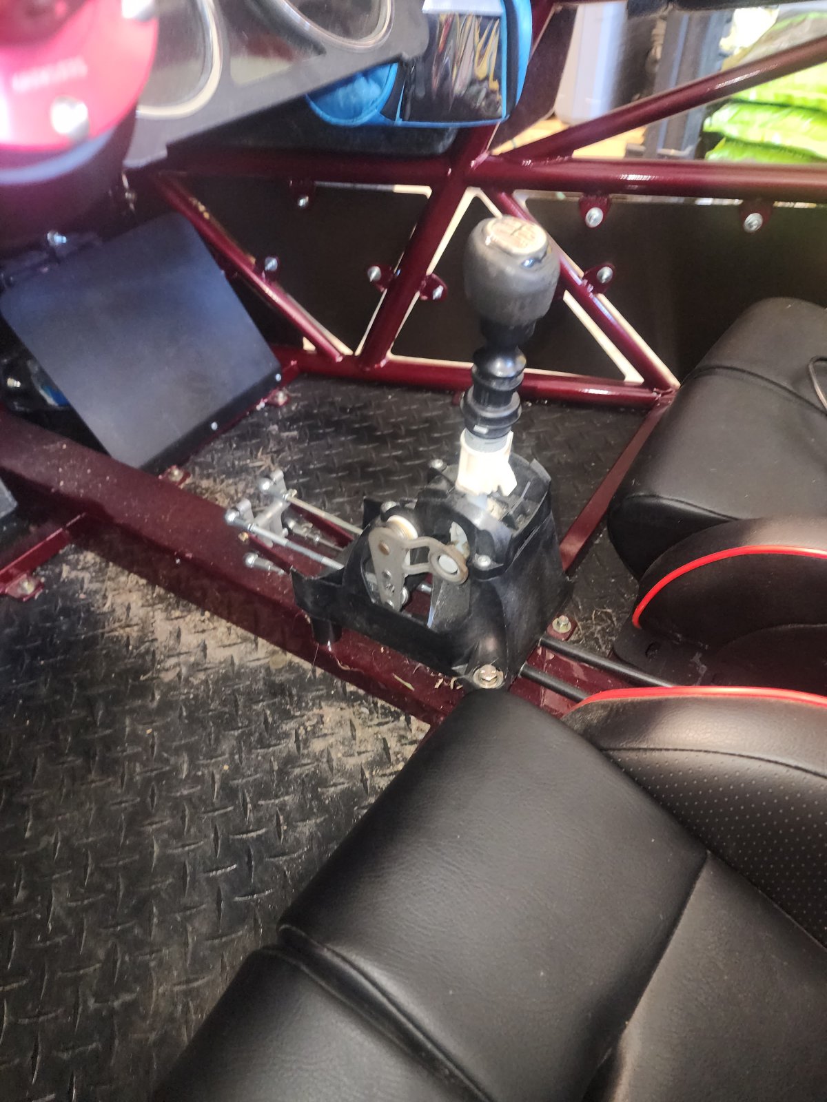

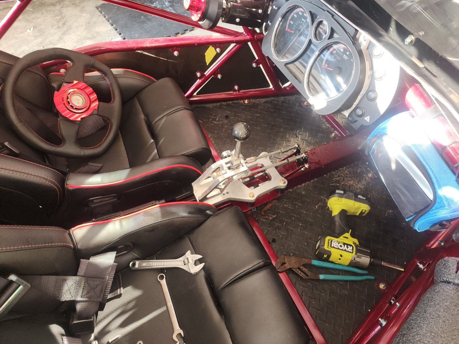

Can't find 5th or reverse yet....just needs adjusting is my guess.

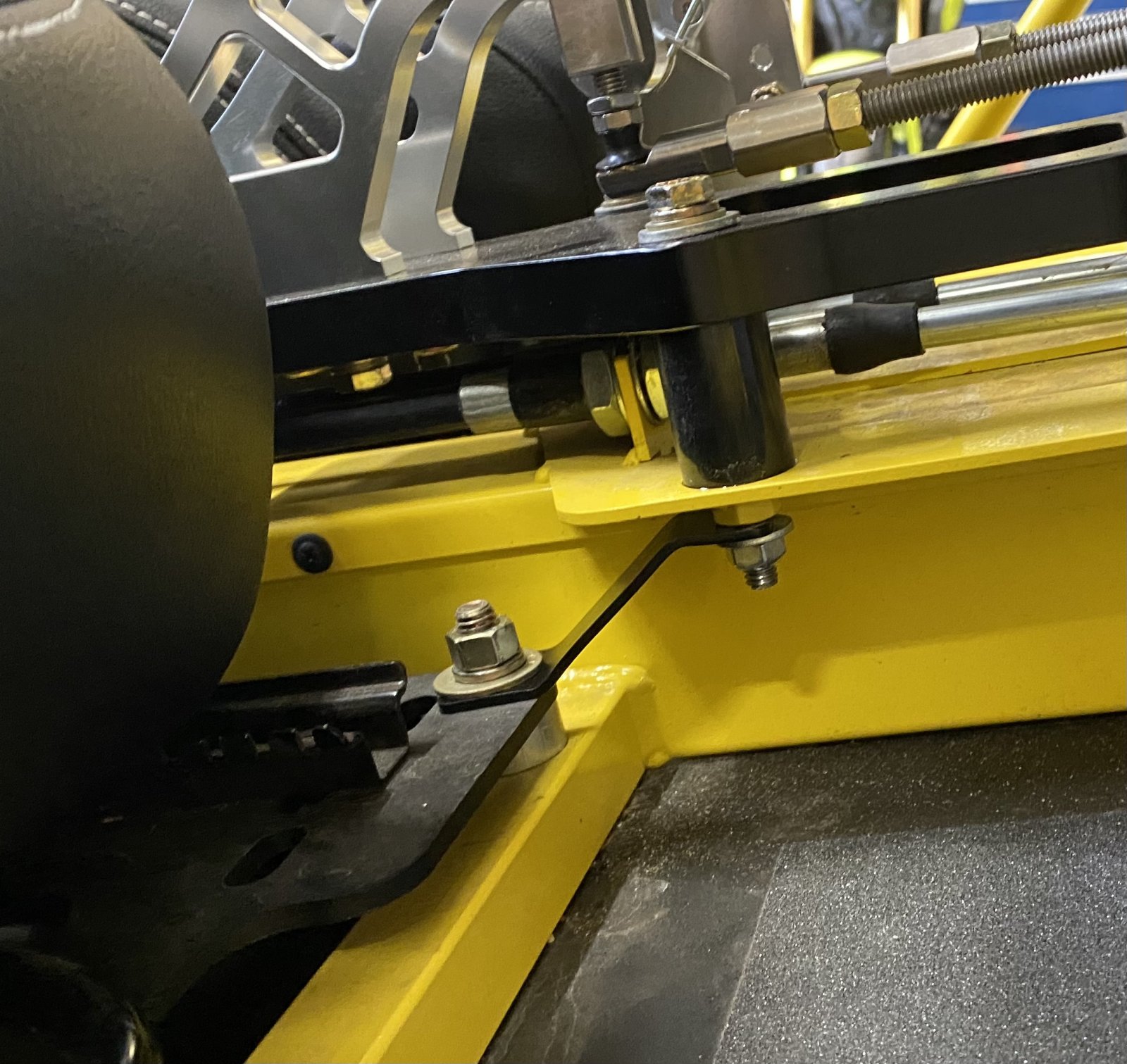

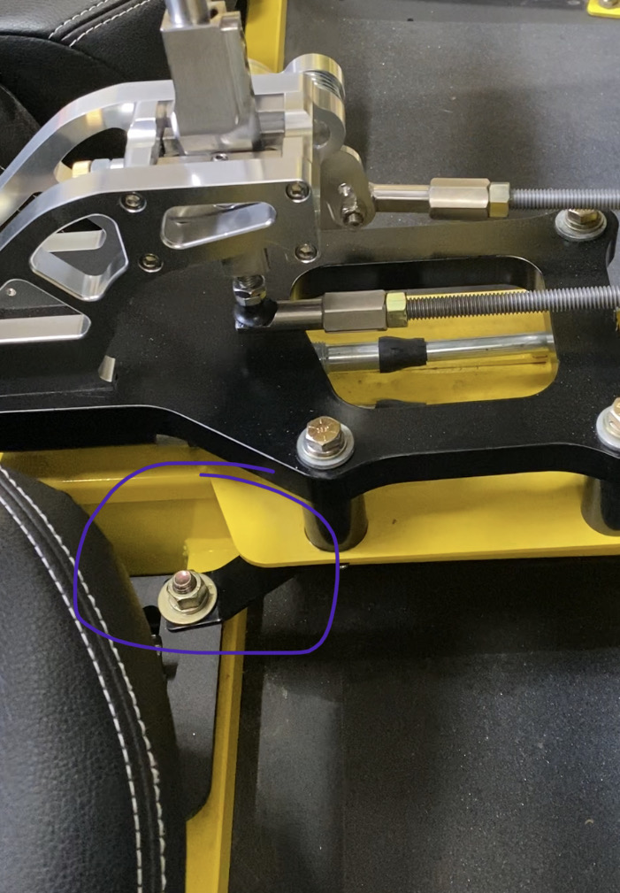

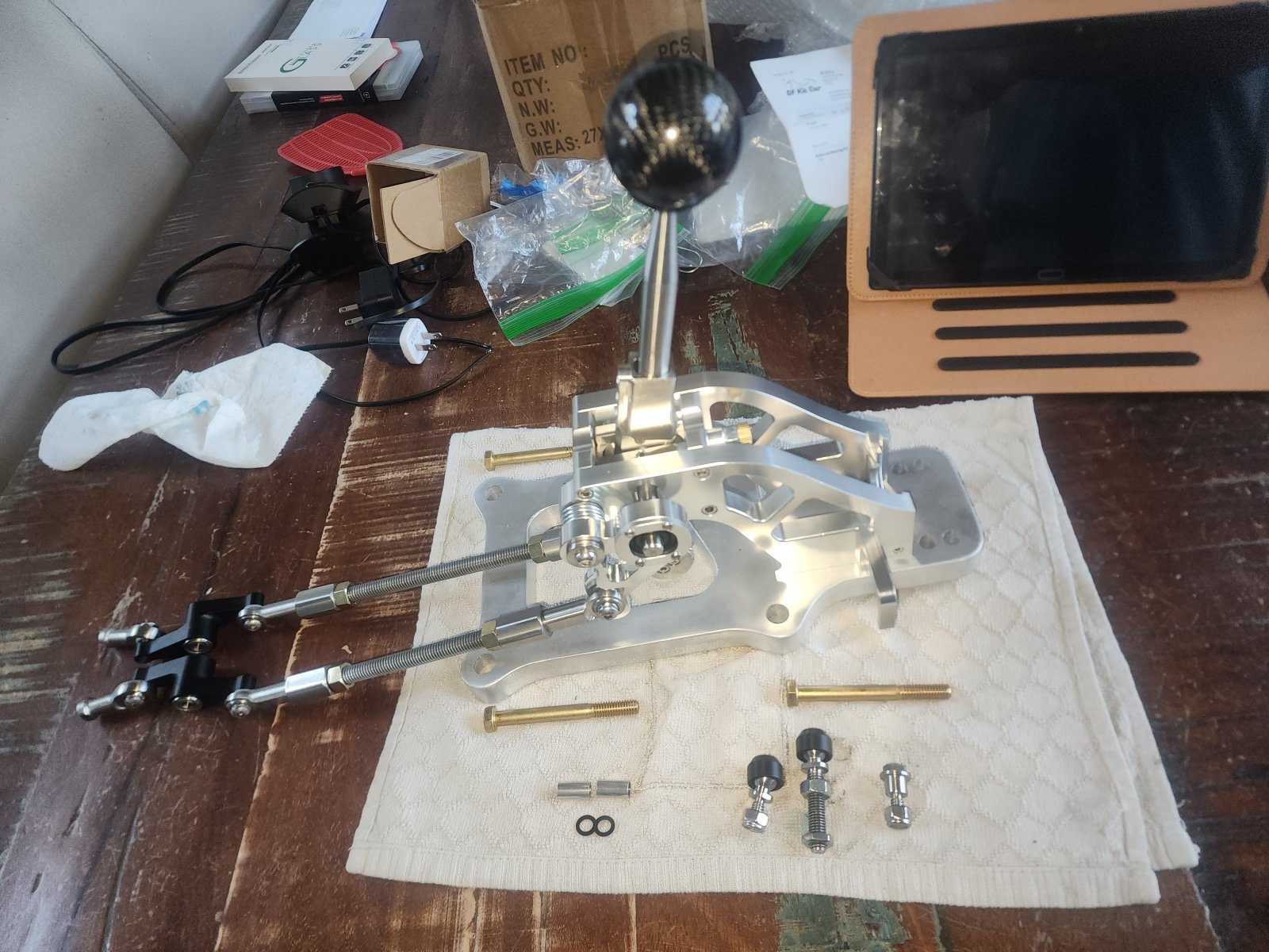

Has anyone installed this shifter? I think I got it right but can't get into reverse, anyone have advise or better yet actual install instructions?

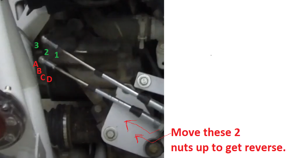

Here is a map of the transmission levers.
41810

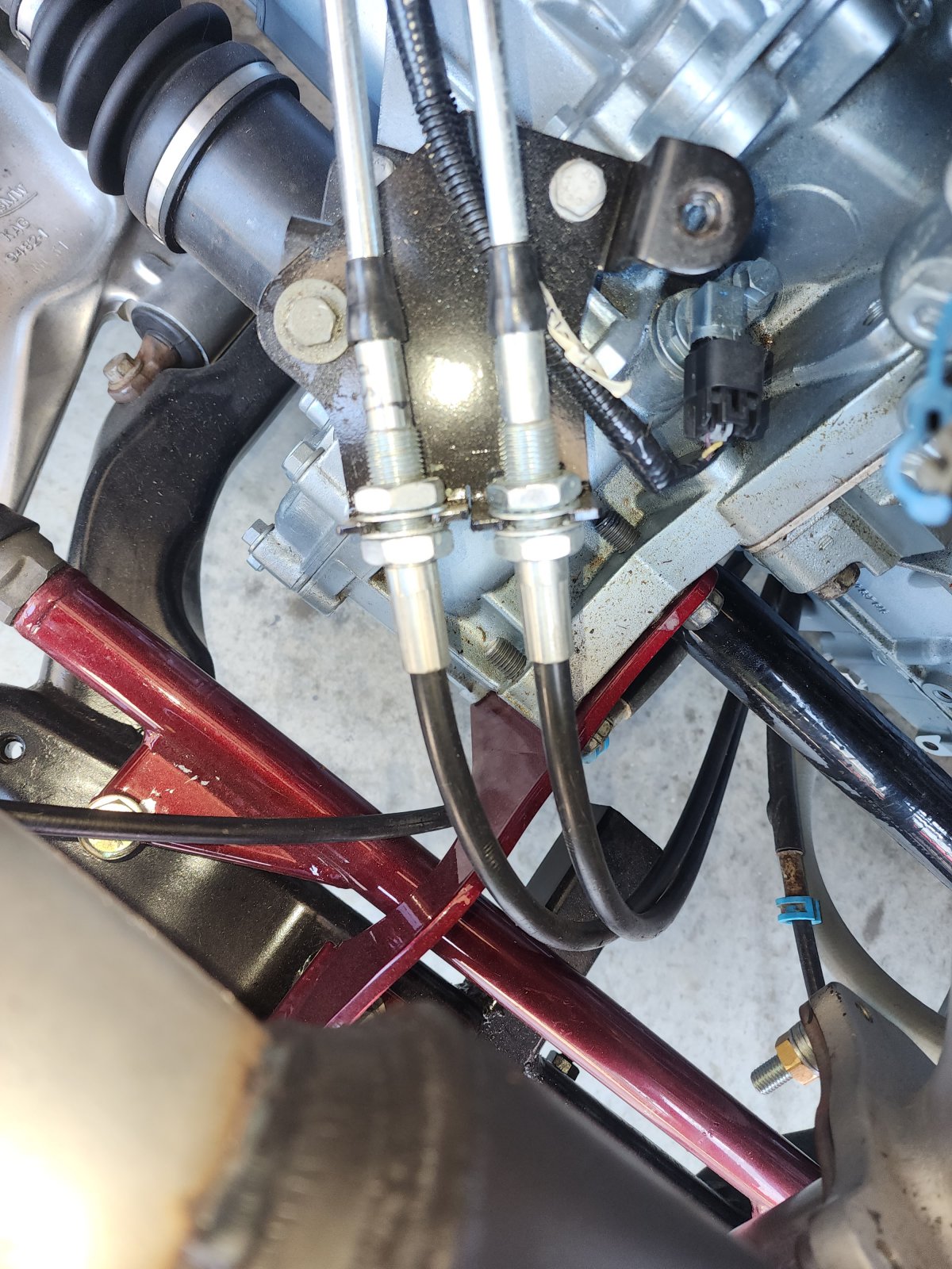

Since you are able to get to A and B, and not C and D, you need to move the 2 nuts that half in view, up.
5th is a little hard to find on that one and reverse is way the heck over and down. I use my knee to nudge my hand and shift lever over to hit reverse. You’ll need to add a stiff leg to stabilize the tunnel cap too. The movement in the tunnel cap will keep the shifter from working properly.
41811
41812
Yes, those 2 nuts can lower or raise the cable-to-lever distance. Your bottom/left-most cable isn't pulling the lever far enough, so backing up the cable will help.
Your cable is adjusted to be as short as possible (all the threads are on top), so backing that up should be easy.
You can also back up the cable at the other end, beside the shifter.

I think the original setup advice I got was for the nuts to be in the middle. Even with them there, I had to move mine in the direction Ross is suggesting to get 5th and reverse consistently.

Made about 15 mins of adjustments, 5th and reverse are now working!
5th is a little hard to find still but may trouble shoot that a little more later.
