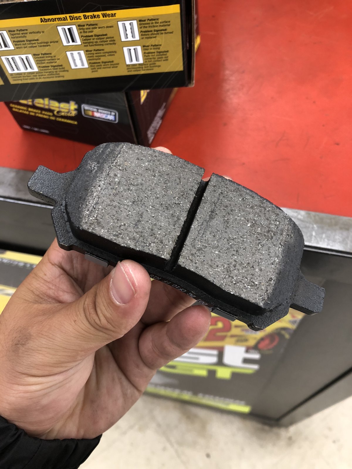

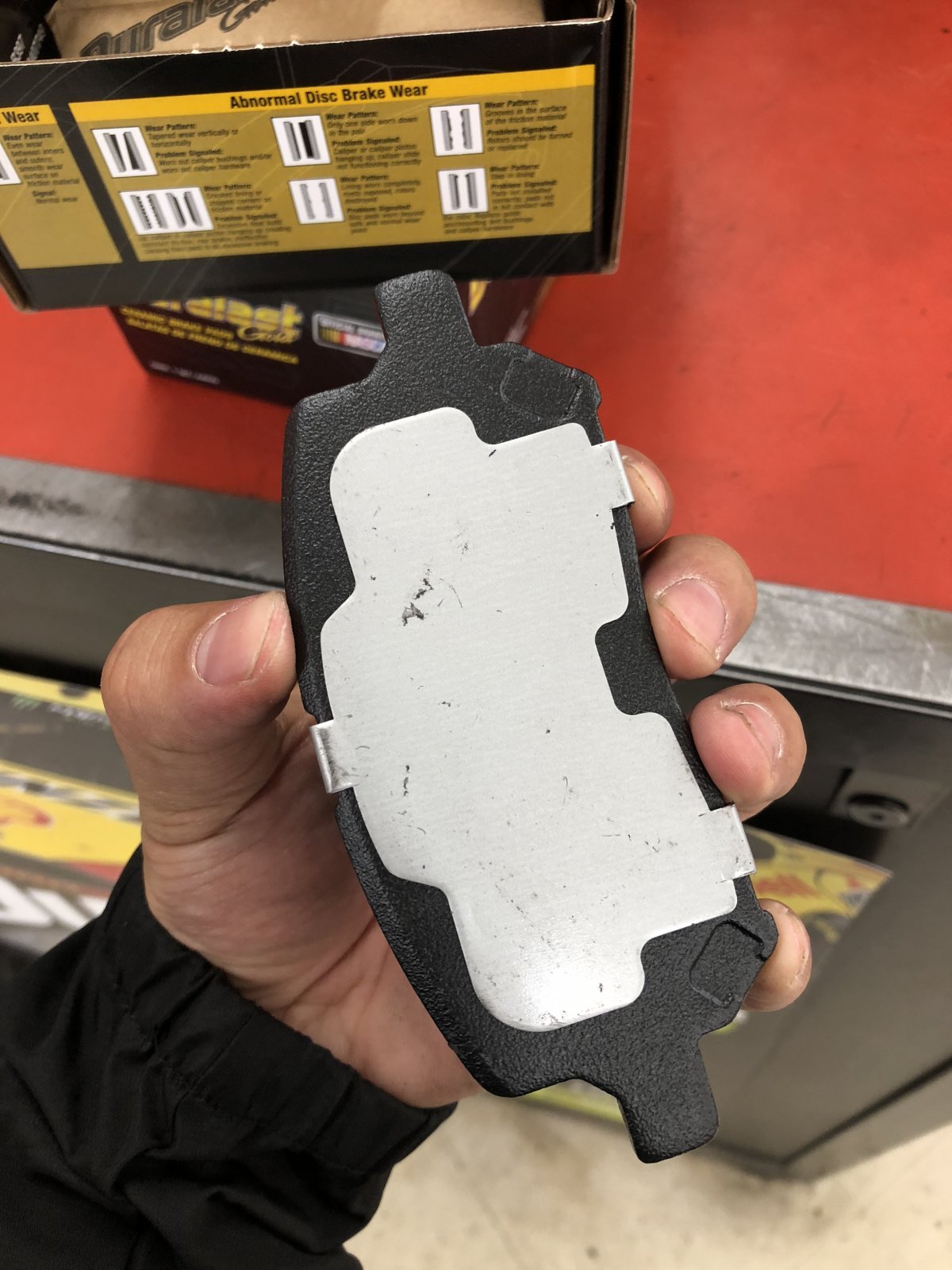

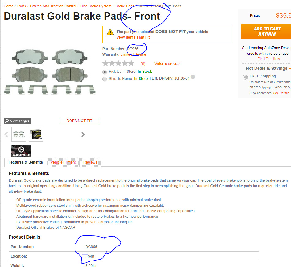

So I am at autozone right now and the DG956 are coming up as rear brake pads... I just got off the phone with Adam he said to get the DG956 and take a picture of them to see if they’re right.

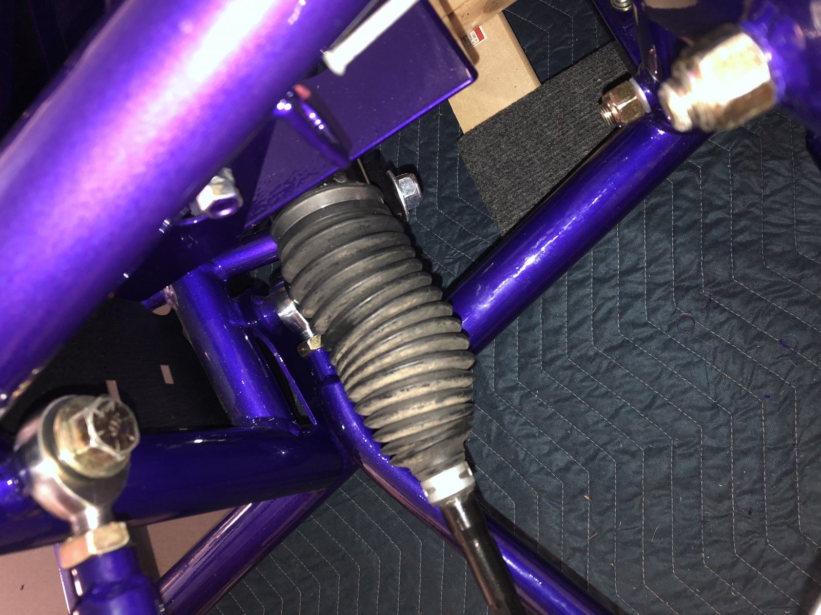

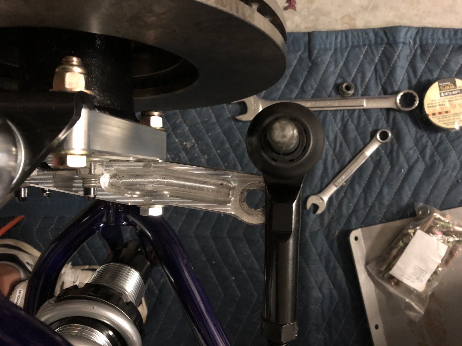

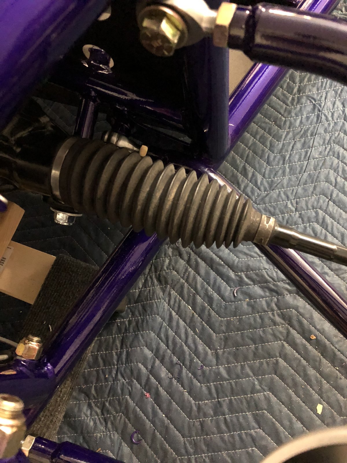

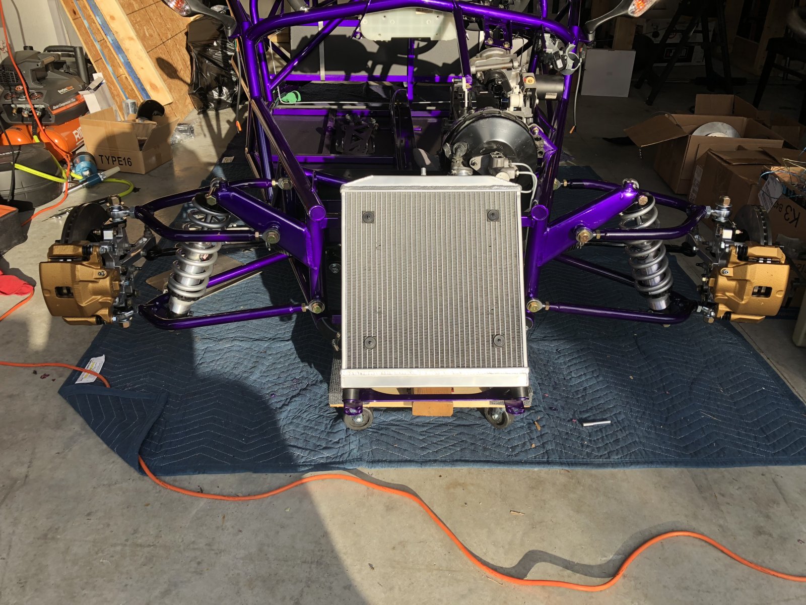

Trying to finish up the front suspension and I noticed that the left side is straight but the right side is slightly curved inward. How do I adjust it so both wheels will be straight? As you can see in the pictures the one side boot is stretched out and the other is not.

TheNuker
Did you put each side ball joint in on the same threads? You will probably have to adjust both sides when you find the steering wheel center. Also those boots slide a bit mine did.
Just make sure you adjust both sides and mark the threads, I thought I had mine fine but ended up that one side only had like 3-4 threads and that's bad :D

I’m not sure what you mean by did I put each side ball joint in on the same thread.
Jlarson524
Are they screwed into the rods that come out of the steering rack the same number of threads in?
Nuker-
Yes they are screwed in the exact same distance. with both wheels facing forward and one connected this is how much over hang I have.
Karter2026
Did you change the tierod ends to the shorter ones that were supplied. With the new steering arms you take the stock ones off and move them to the rear and the new shorter ones go on the front.
redline
I did not change the tie-rod ends around on mine and everything worked out well. I don't think you have to change them around???

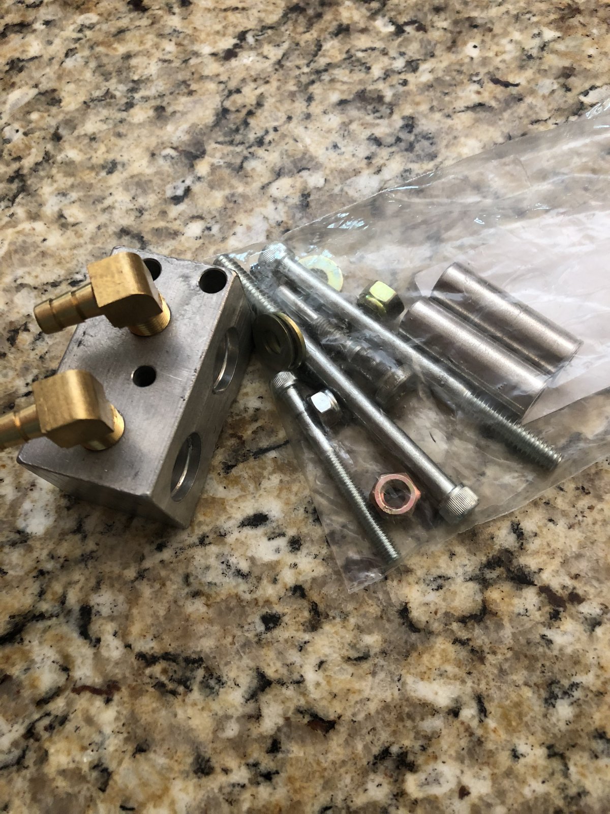

Does anybody have any detailed instructions how they attached their brake fluid reservoir? This is the kit I have.
