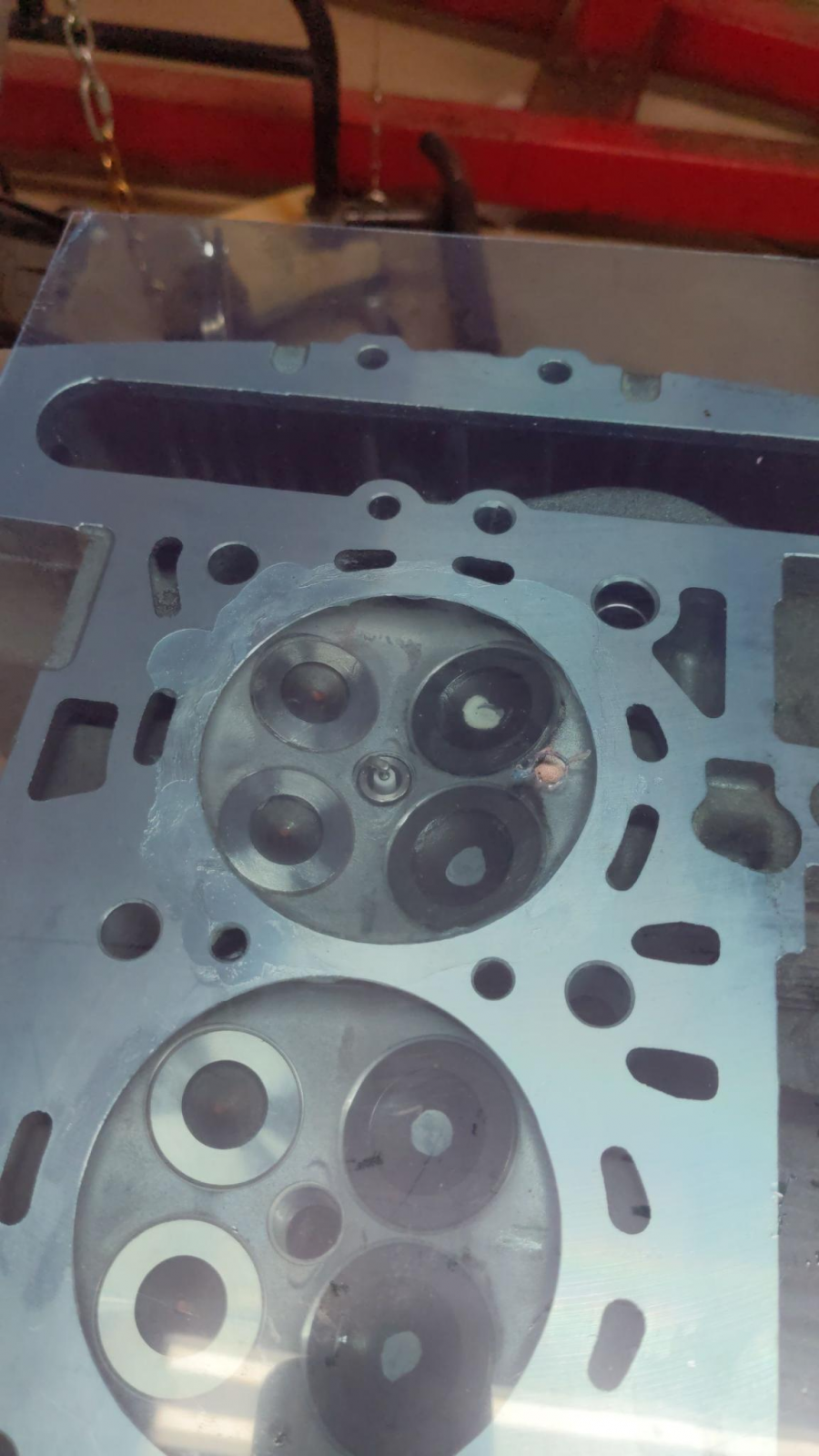

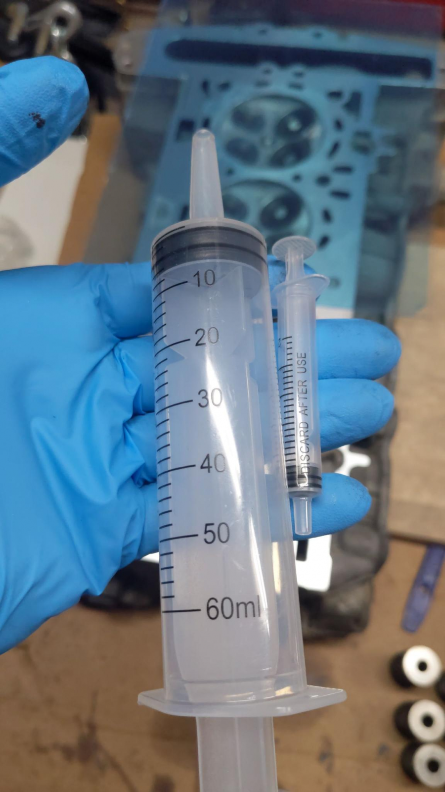

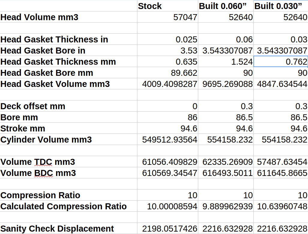

Still waiting on the OTTP Main Bolt replacements in the mail, so I thought I'd do something more fun - calculating compression ration. Being that I am using flat top 10:1 pistons, the math is fairly easy. The hardest part is getting the volume of the combustion chamber. To do this, I measured by volume and weight of water. I coated the backside of the valves in vasoline, and then put a piece of plexiglass down on top of it (again sealed with vasoline) to seal the chamber. Using a liquid syringe and scale, I was able to get within 0.5 ml of the combustion chamber volume.
39437
39438
This isn't 100% accurate, but I would like to think its more of a "worse case scenario". All numbers have purposely leaned that direction before any calculations. Technically I should be using thick plexiglass so it doesn't bow in the middle. I didn't want to pay for it, so I just used what I had on hand. This likely upped my compression ratio calculations, but that's ok. As I said, worst case scenario.
Here are the results:
39436
The only magic constant I have is the stock head volume. I don't know this number because I didn't measure before the head was refreshed. The deck offset is how much was skimmed off the block. This is not 100% known, but should be around there. I'm fairly happy. I went with the 0.060" Cometic gasket. This tells me my compression ratio will be at or below the stock 10:1, which is what I was really aiming for.

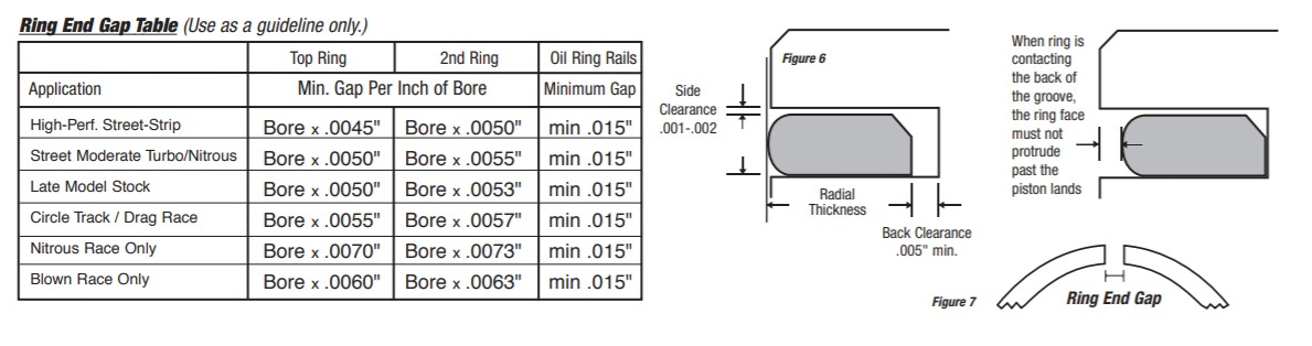

While I wait I want to work on my piston/rods. What ring gaps are y'all running? I misplaced the documentation that came with the Wiseco. This is their chart and TBH I'm not sure which application to select. I assume I would want to fall on the larger side if anything for safety.
39688
jirwin
Street Moderate Turbo... should be about right. Or you could back into it from the 2.0 SC stock number if anyone has it. Unless you are going to be spending extended times at high rpm.
Extended time, no. I will have the capability of hitting 8K now though I think. Balance shaft delete, 82# valve springs, ATI.
