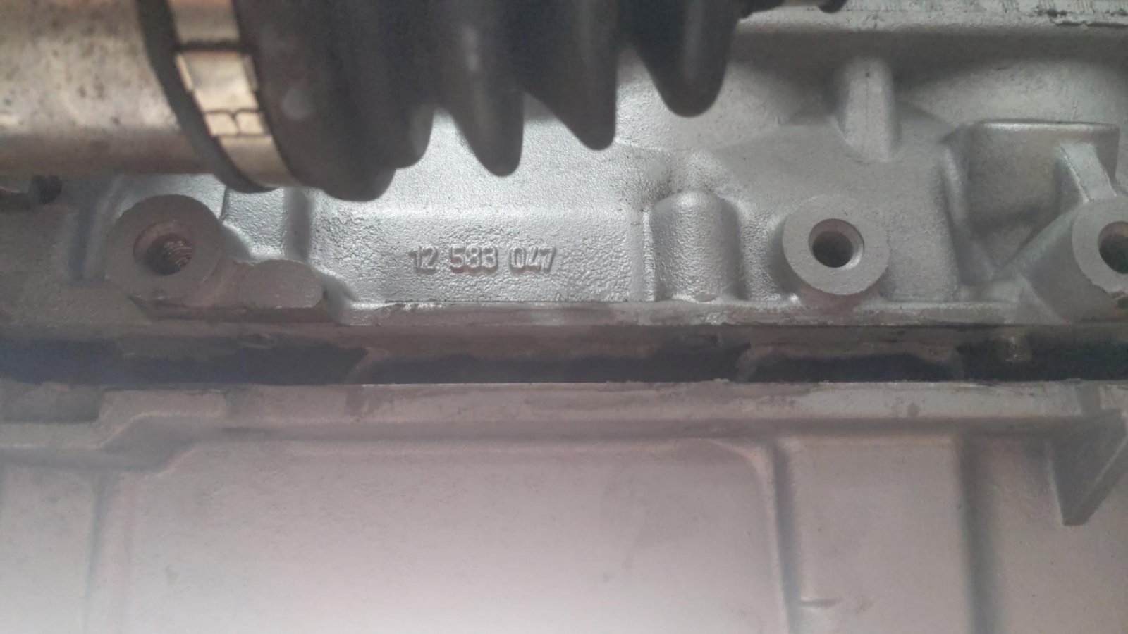

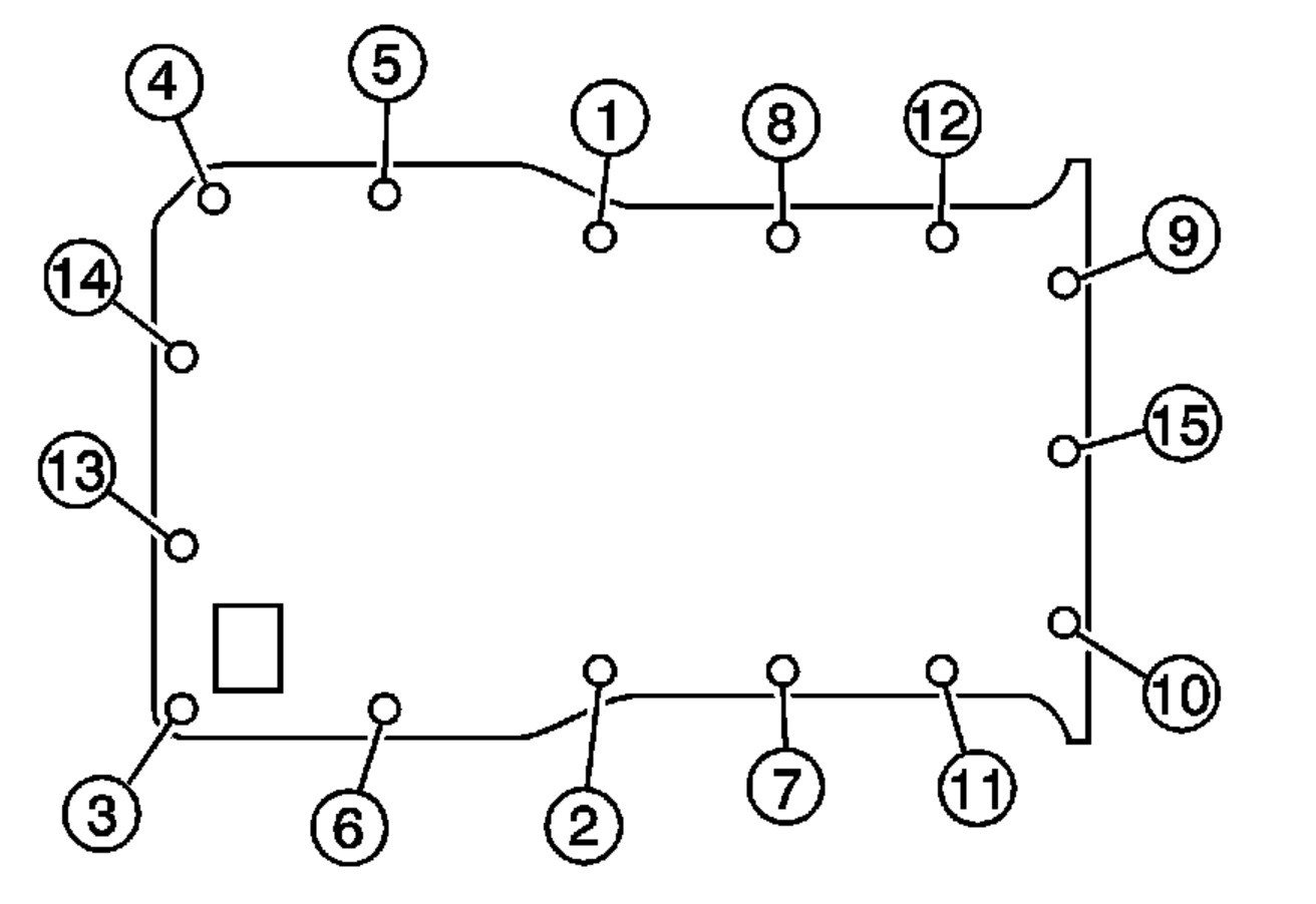

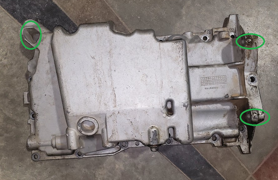

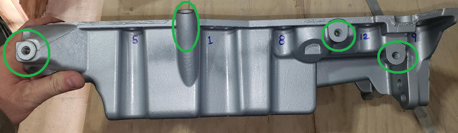

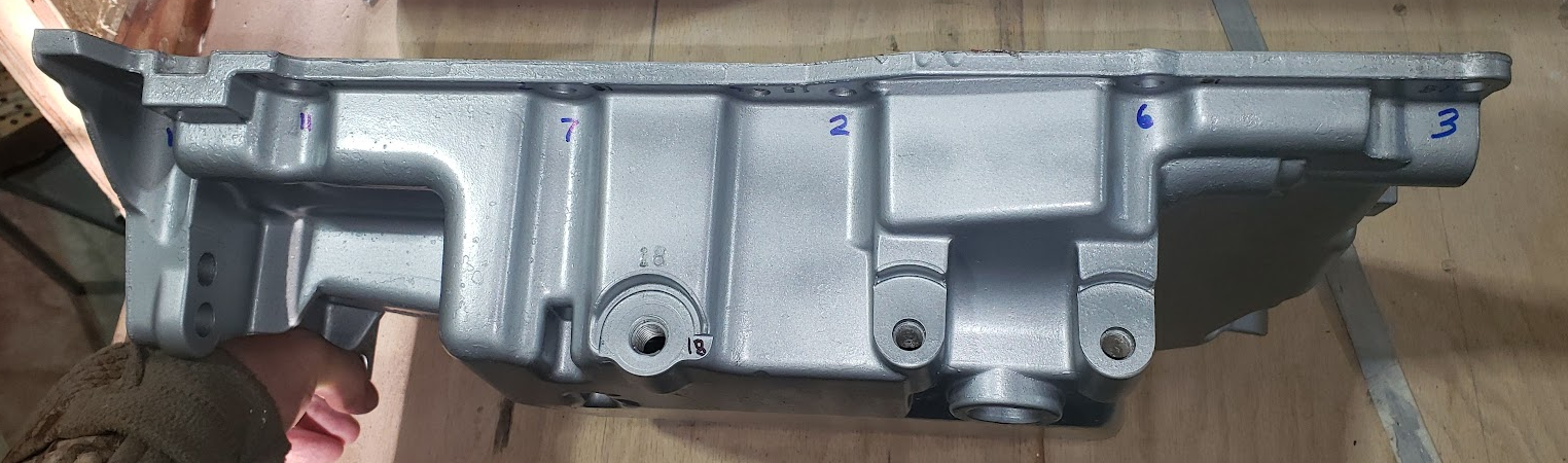

Your oil pan has 14 small bolts, #15 is longer, and there is 2 big bolts going sideways into the bell housing?
Bolt #4 is kind of hidden on my LSJ oil pan. I used a green circle on the pic to show where the hidden bolts are.
45930
45931
3 side bolts, and a dipstick tube.
45938
4 holes heading toward the bell housing.
45939
Oil drain plug and 2 more bolts on this side.
45940

Thanks Ross. Yeah bolt 4 got me at first too, but I did get all of them before attempting to pry anything. I have 14 short bolts + 1 long + 2 transmission bolts. Shes just on there good. Hopefully that bladed tool works out

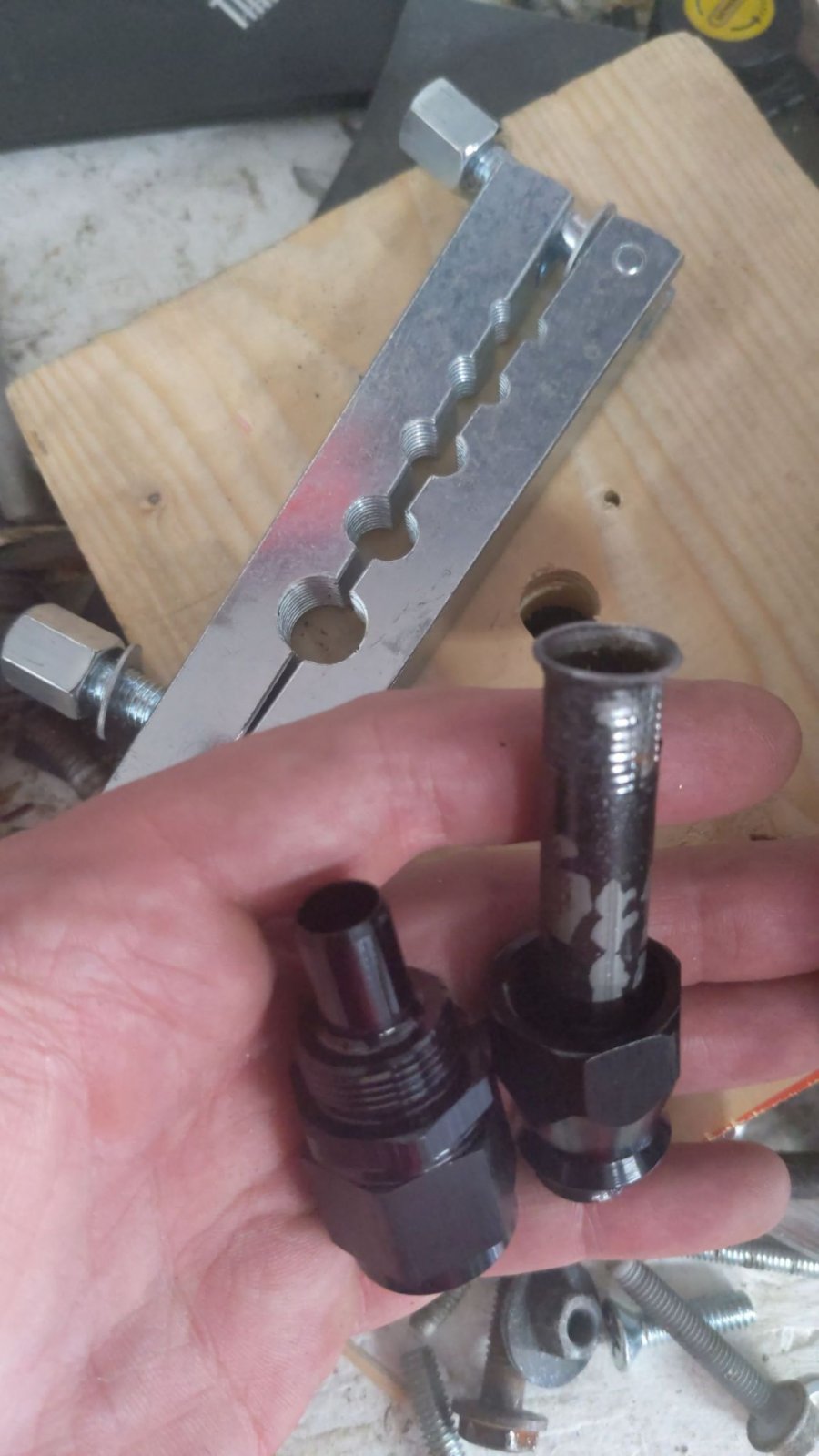

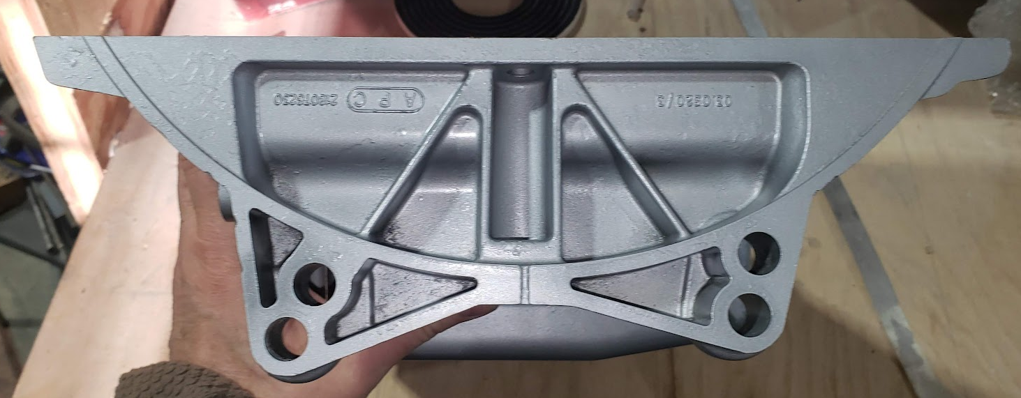

The drain plug was stuck in so I got the smart idea to tap it. The tap worked and I got a big bolt in there. I used 2x4s as a shim and made a crude bearing puller. It worked!... But snapped the remainder in two. I said screw it and ordered a $65 pan.

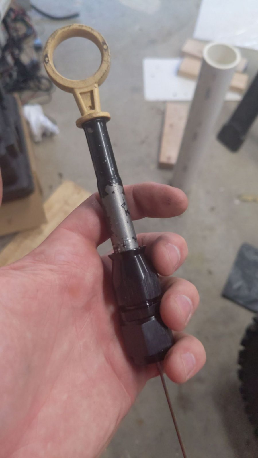

In the meantime, I'm working on something fun. I got some 8AN hose, and I'm (hopefully) making a flexible dipstick to replace it. Then I can check the oil with the engine covers on and everything. 8AN fits perfectly over the dipstick tube itself as it is ~0.5". I used a flaring tool and flared the tube I cut off. Throw on a regular AN fitting and you have yourself an adapter!
jirwin
Flexible dipstick tube didn't end up working out. The fitting were too long. I ended up just modifying the dipstick tube gently in a vice. Its in a good position and secure now.

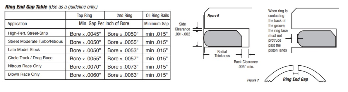

While I wait I want to work on my piston/rods. What ring gaps are y'all running? I misplaced the documentation that came with the Wiseco. This is their chart and TBH I'm not sure which application to select. I assume I would want to fall on the larger side if anything for safety.

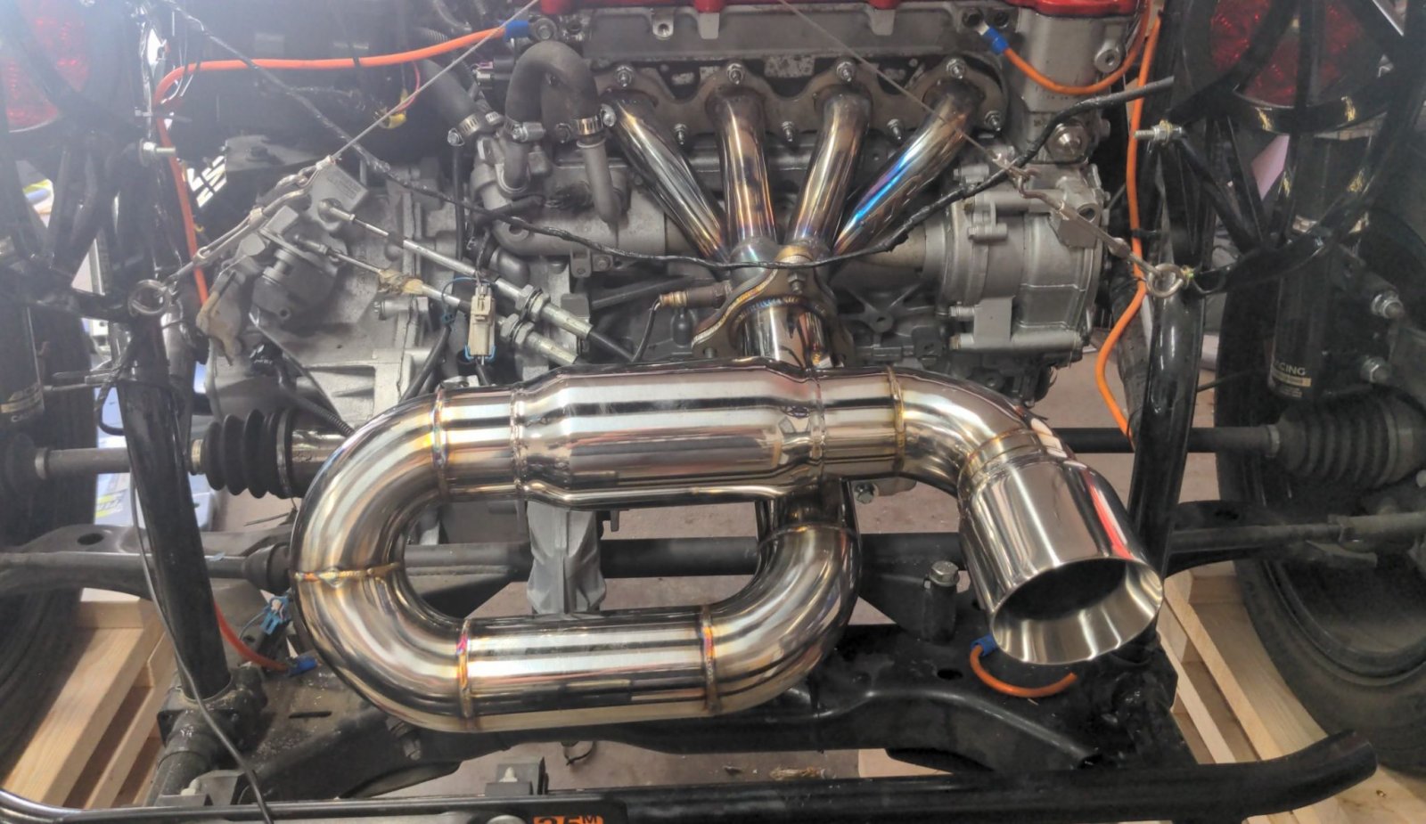

Got my new exhaust back from Redbeard Fab (https://www.redbeardfabricationoh.com/). Tory did a great job building an exhaust off my measurements without having the car on hand to reference. Turned out great! Its 3" stainless all the way, with a 3" Vibrant bottle resonator, and a 4" tip. Its very deep at low load, but a bit Honda boy at WOT. Overall I'm happy with it, as it looks 1000 times better than stock.

Super clean! That manifold and exhaust look so good. Post up an audio or video file, if you can, so we can hear it

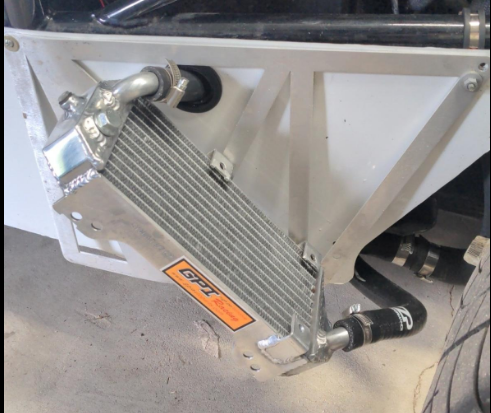

I guess I'll share a little bit about what I've done with the sidepods. The background is, I wasn't really happy with the stock positioning of the DF Heat Exchanger for multiple reasons.
  • Its right behind the radiator and tends to heat soak from it
  • It requires tubes to be stuffed into the tunnel
  • Its hard to get clean, cold air to the heat exchanger (without NACA ducts)
  • I can't run NACA ducts and a hinged hood effectively
So, I went down the route of adding sidepods. I own a Suzuki DRZ400. One of the reasons its a great bike is because its been the same for 20 years. Parts are cheap. I decided using DRZ400 Radiators would be a good start. They are compact and cheap ($60 for a mid tier set).
I made some aluminum brackets with SendCutSend and mounted them on each side:
46690
These will eventually be encased with fiberglass so they look nice, but only if they work well enough. The radiators are each 120mm wide, so a standard computer or server fan(s) will work. For now, while it is not super warm outside, I am running it fanless. Yesterday it was 65-70F and cruising my IAT2's were ~85-90F after it was fully warmed up (and heat soaked). If I'm in the city or just idling it expectedly rises in temperature to 110-115F. Being that cruising temps are already ~20F over ambient I'm not sure that these are sufficient. I'm really debating buying something like this to measure the IAT and IAT2 (since my ECU can't do both, I rewired 1 to 2). I'm curious how much its actually heating up the air. It could be that the air intake is just pulling warm air from the engine bay. I started building an air box for the intake for this purpose, but there's just not all that much room to make it happen. I think that's the route I'm going to go for now, because I don't think there's any benefit to adding a fan as it won't allow for any additional airflow, except at slow speed.
