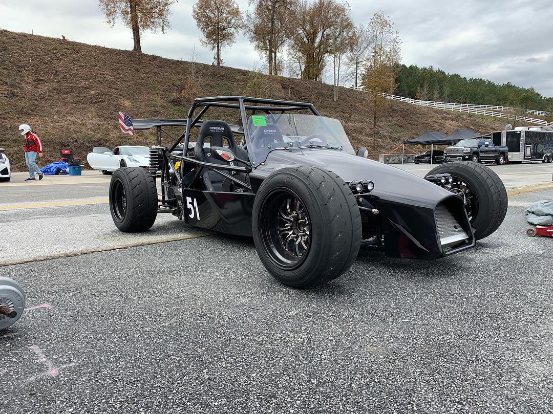

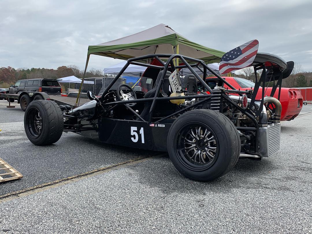

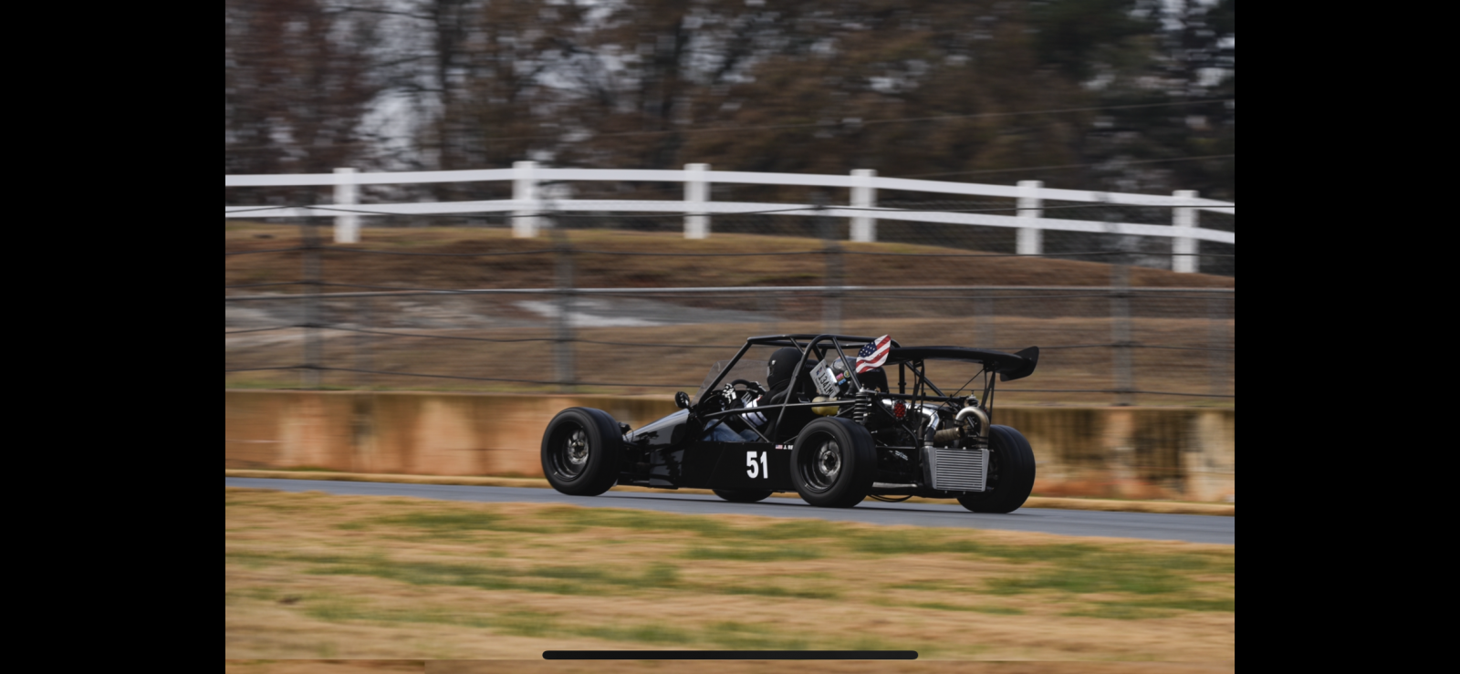

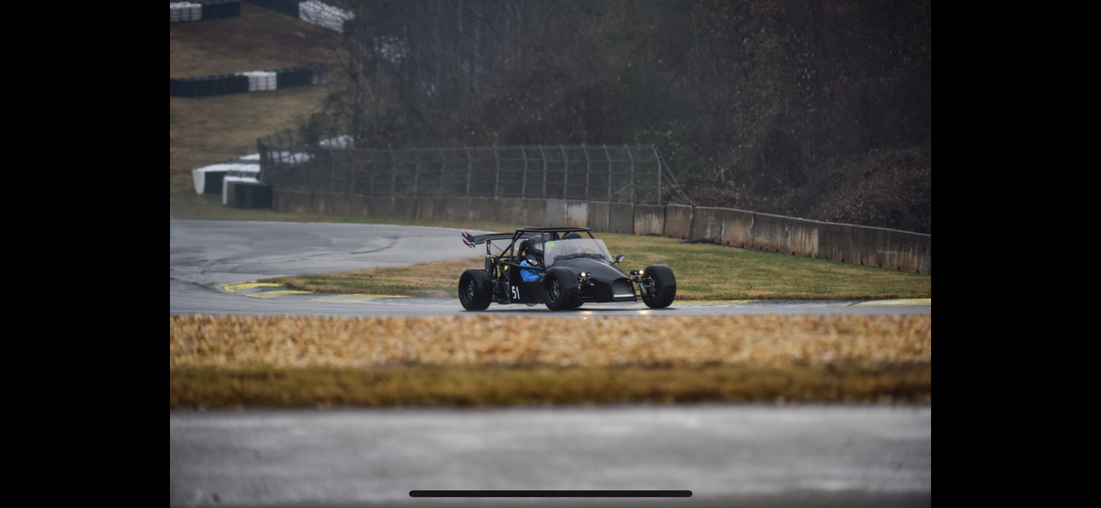

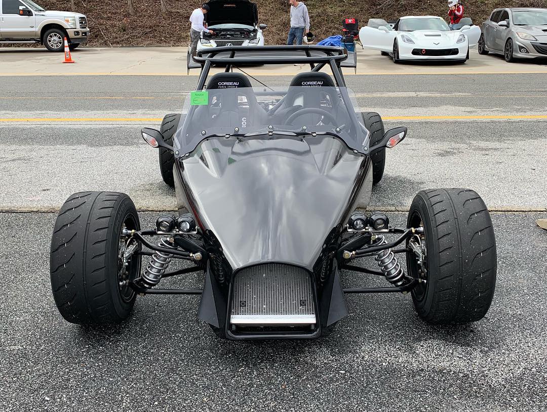

Little late to post but took it to Road Atlanta in November and boy was it wet! Car handled fantastic in the rain surprisingly and was somewhat forgiving to drive at its limits in the wet. Little oversteer but that’s your friend, better than understeer lol it dried up around mid day for the 3rd session and the car started hooking. This thing was on rails. I never got a clean lap due to traffic unfortunately. Around the 4th lap on session 3, the engine started knocking off the long turn 1 and finally said it had enough and shut itself down upon letting off the throttle. Oil starvation is the enemy with these engines and I completely over looked it. Also didn’t have a oil pressure gauge anywhere in the car other than the dummy light in the cluster you can’t even see. Needless to say I ordered a trap door oil pan and accusump for next season!

Are those canards on both sides of the hood down low? Hard to see on my phone.

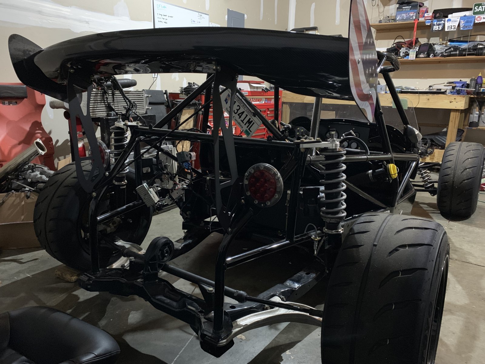

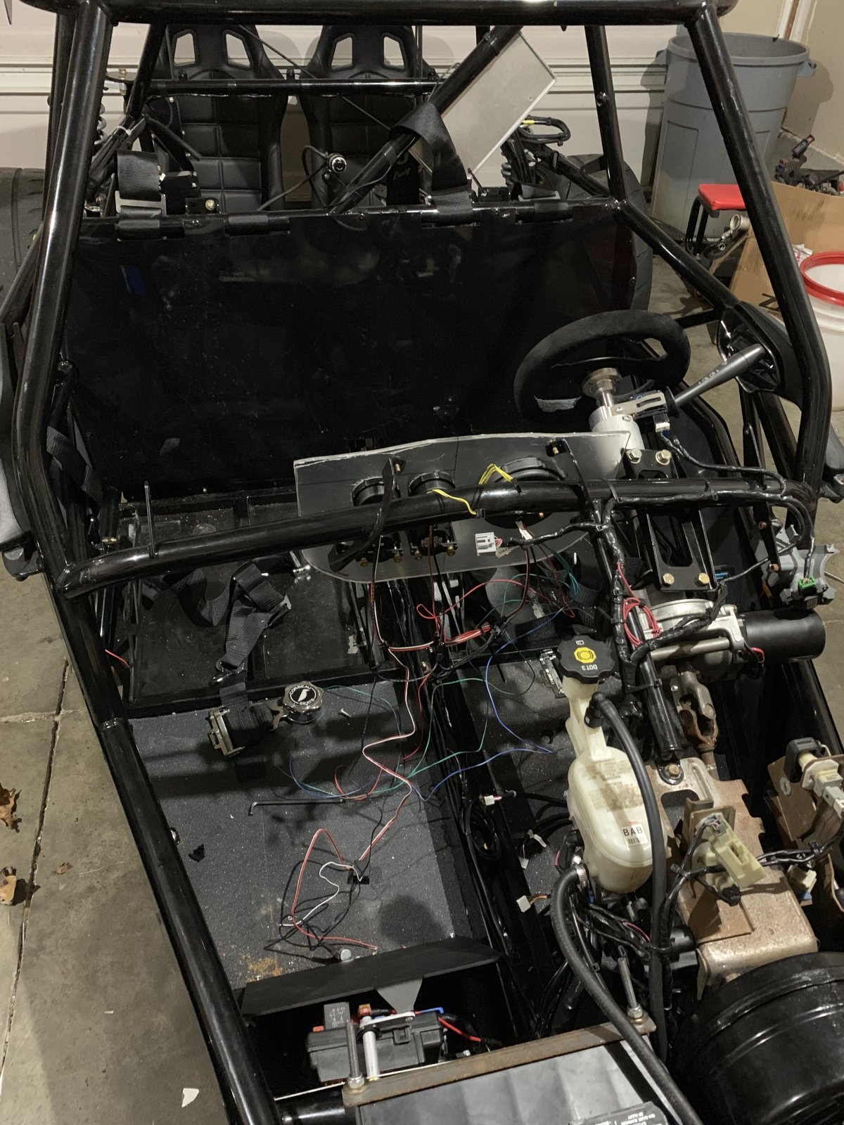

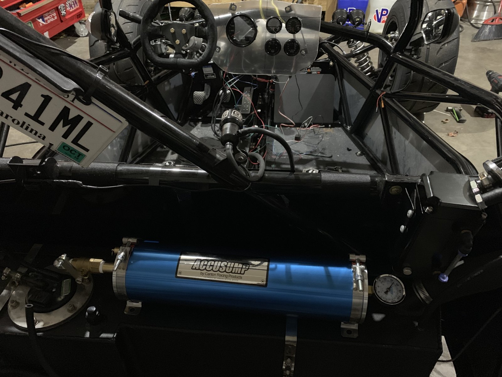

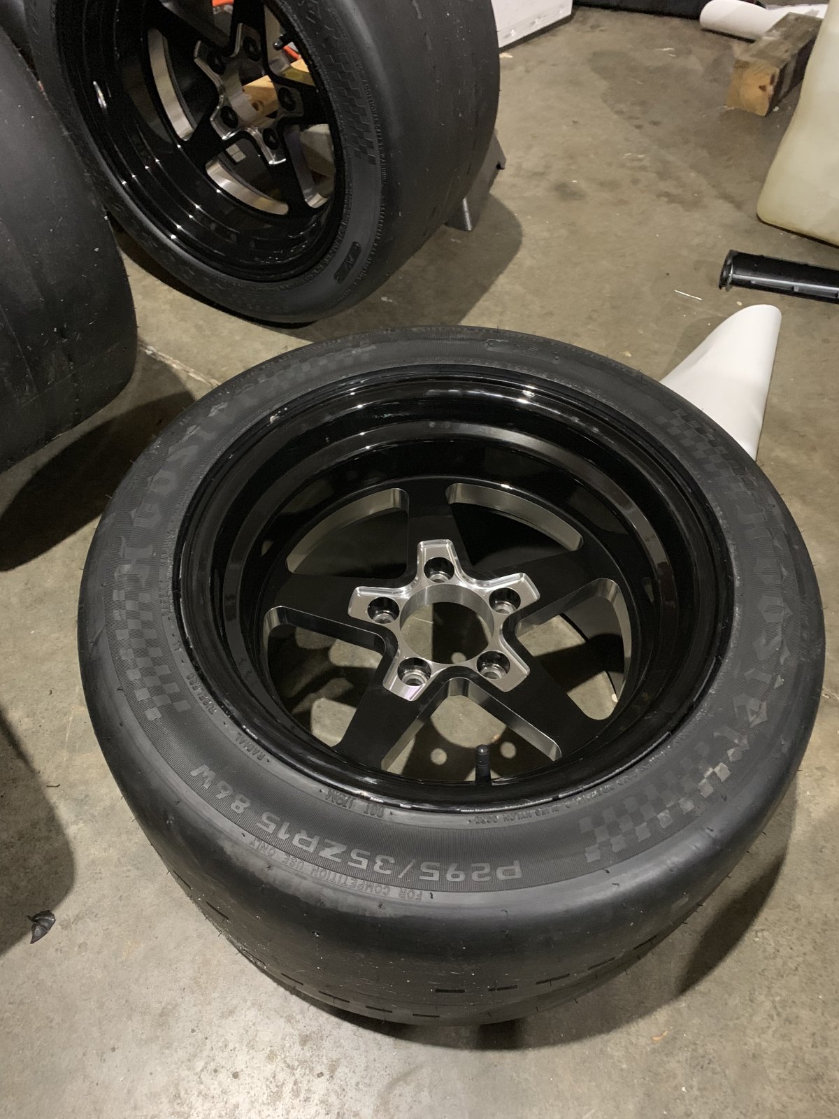

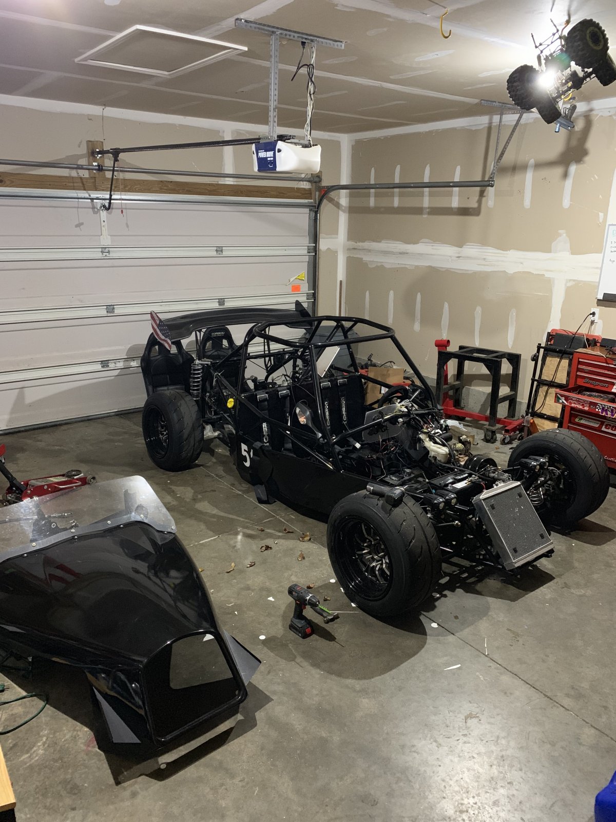

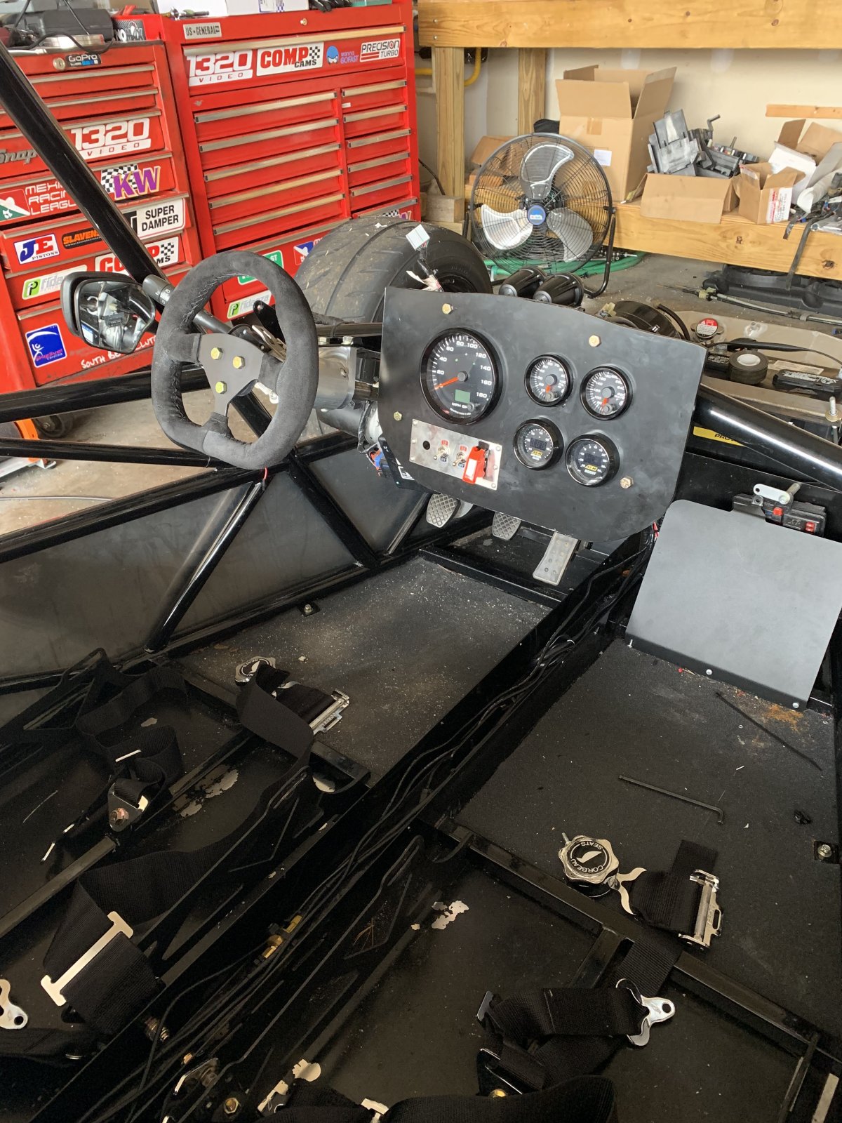

Well underway with upgrades for this race season. New gauges, steering wheel, trap door oil pan, accusump, s257 turbo, fresh engine with a race ported head, stage 3 cams, lsd transmission, and some 275 and 295 race slicks!

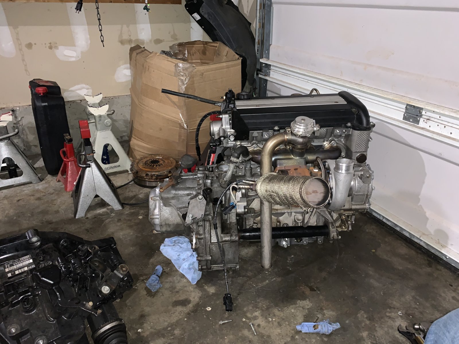

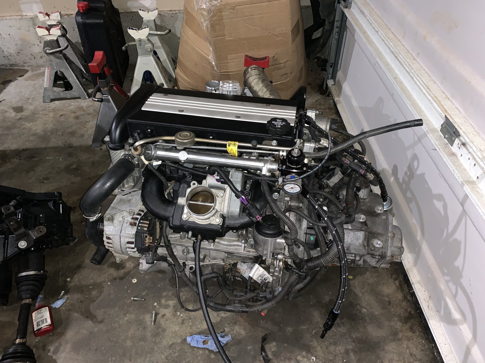

Justinreed7

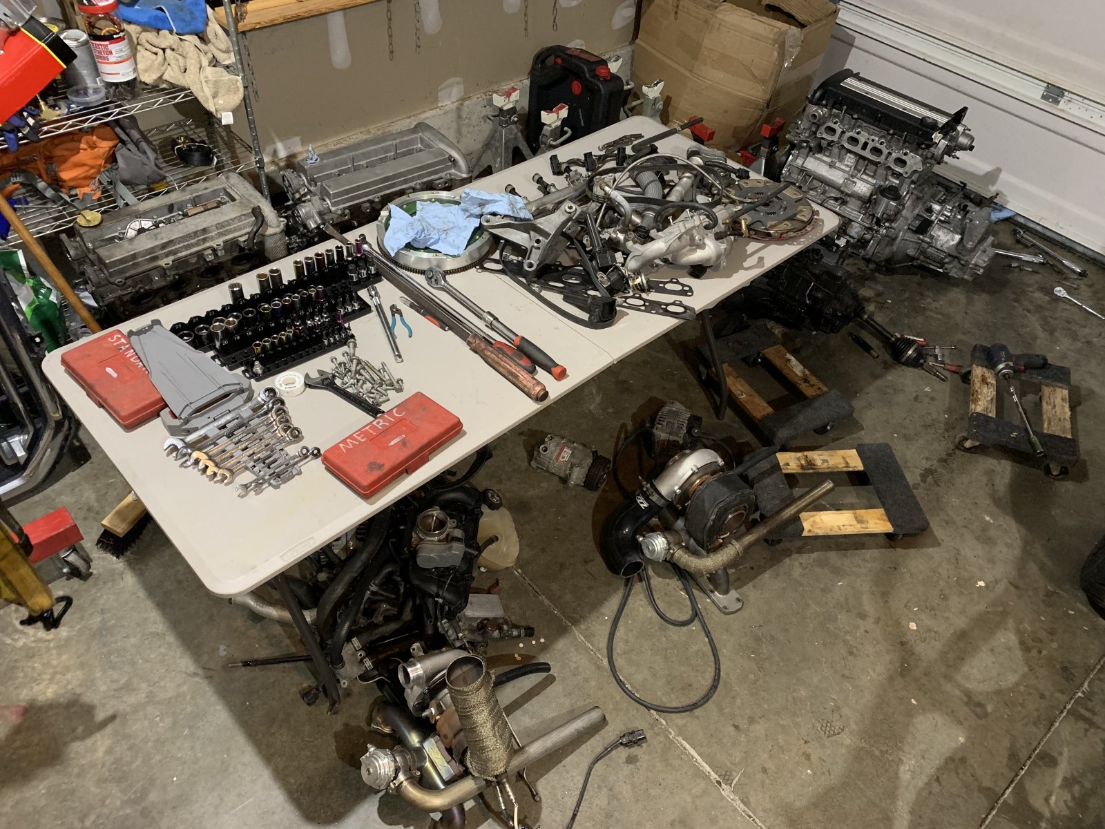

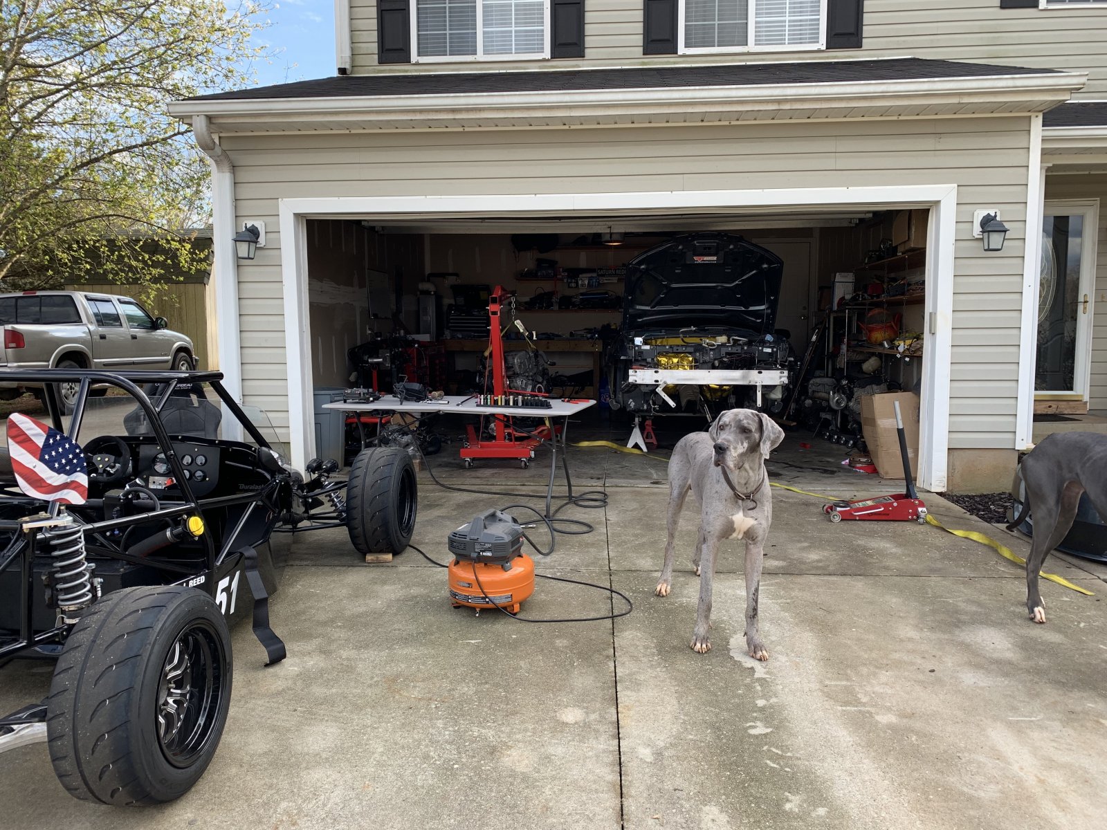

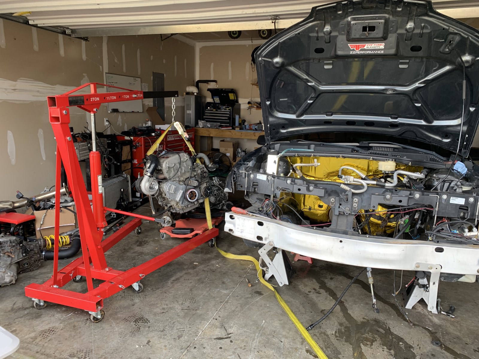

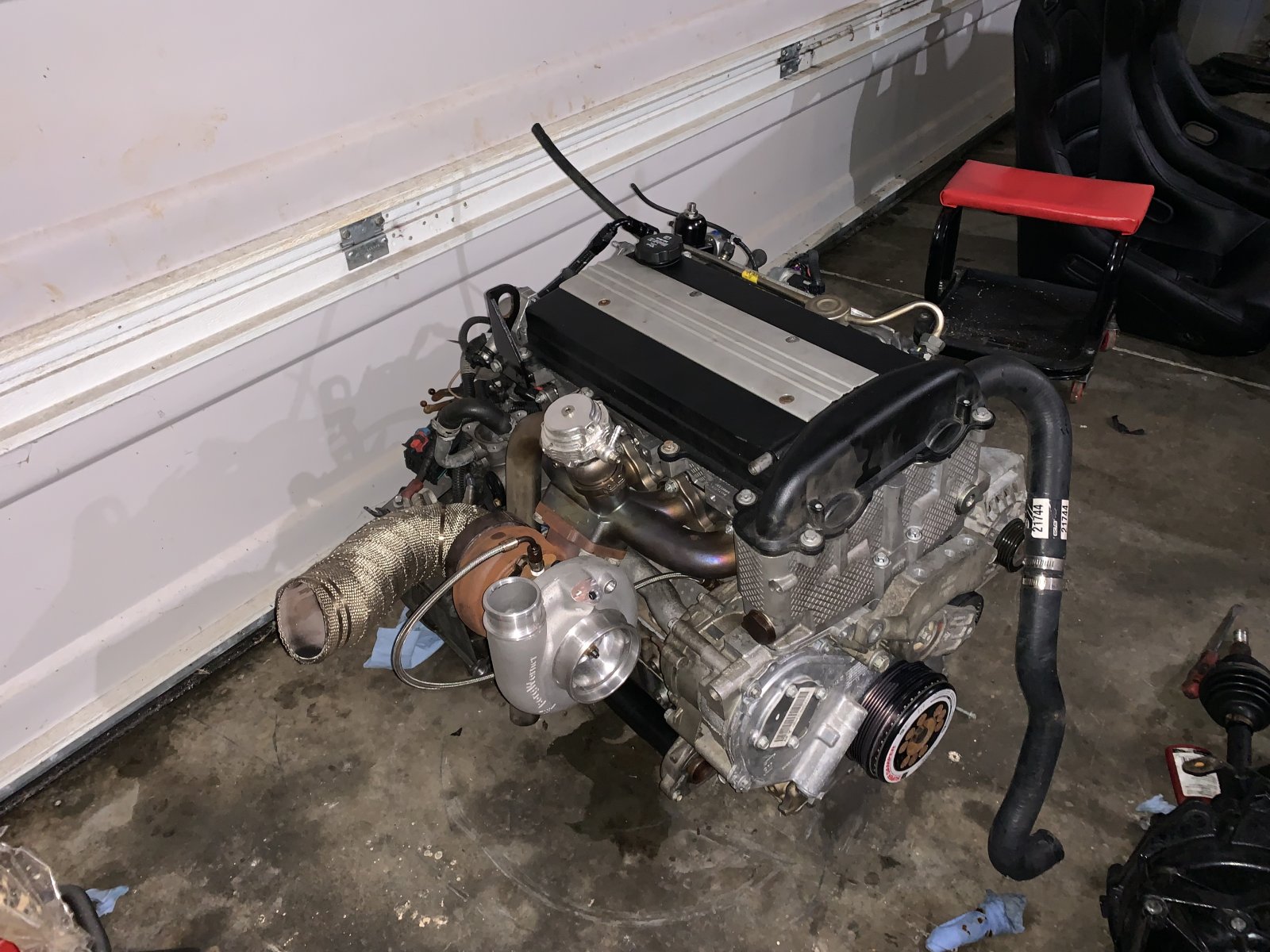

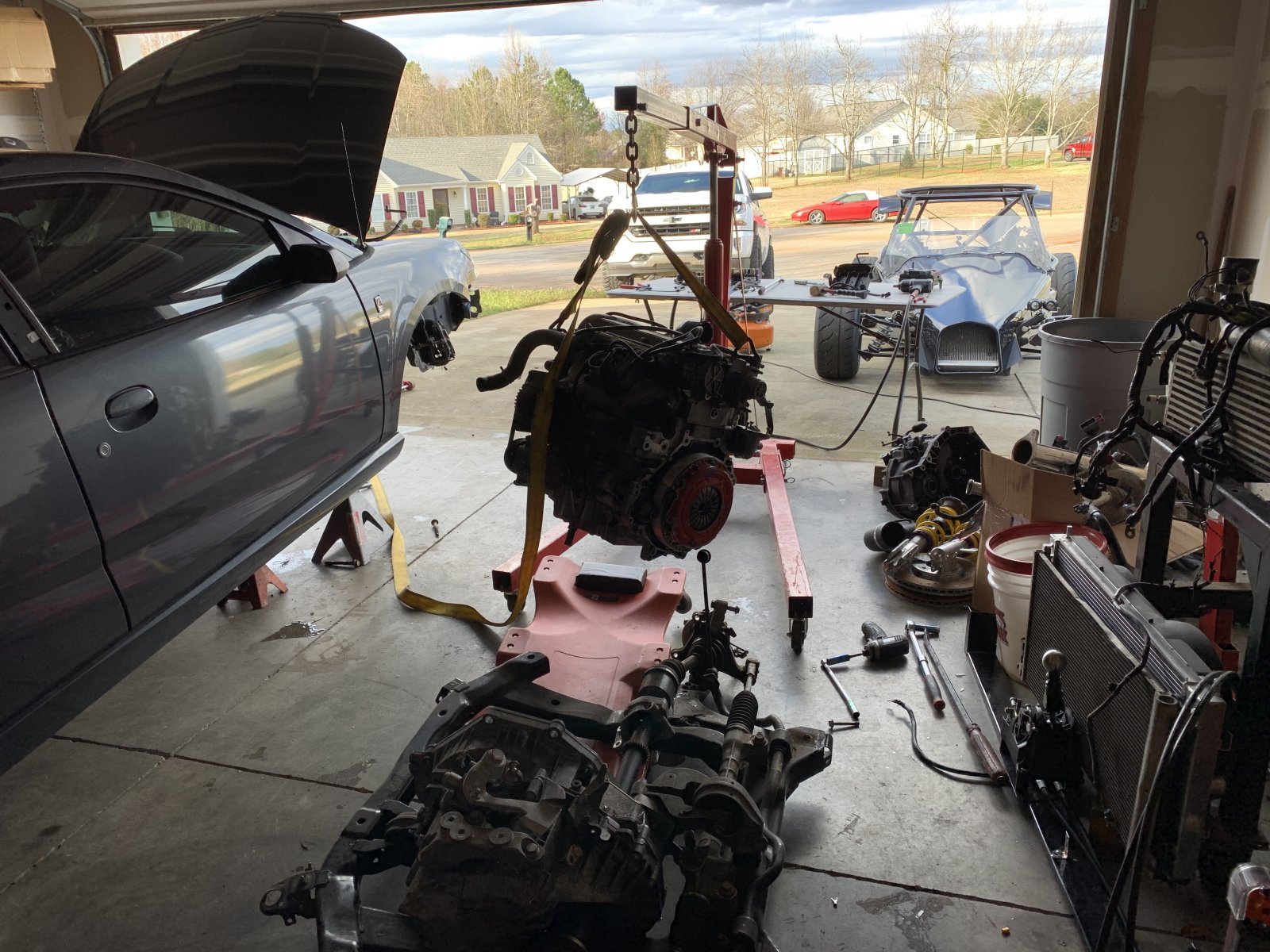

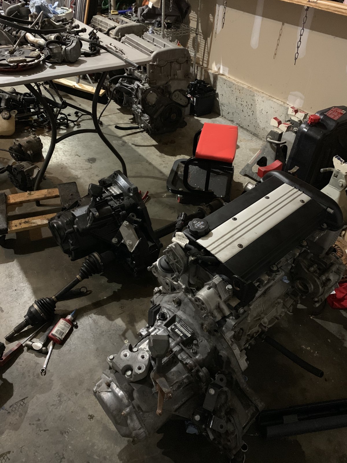

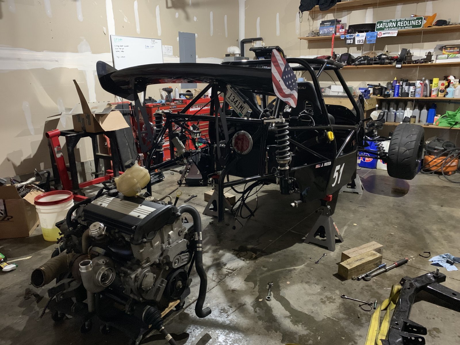

So I decided to rob the engine out of my Saturn that is currently having wiring issues. The Saturn setup as it sat was a race head with stage 3 cams, 82lb valve springs, 6466 turbo, balance shaft deletes, headstuds, and arp everything with a freshened up bottom end and a f40 transmission. I took the engine out and left the f40 in the Saturn. Didn’t feel the need to do a f40 swap with the goblin. Stripped the manifolds, f40 clutch and flywheel off and began transferring the goblin engine accessories over. F35 race clutch and aluminum flywheel, s257 turbo and mated it together with a lsd f35 I picked up from a guy on the Facebook forums. Making progress
