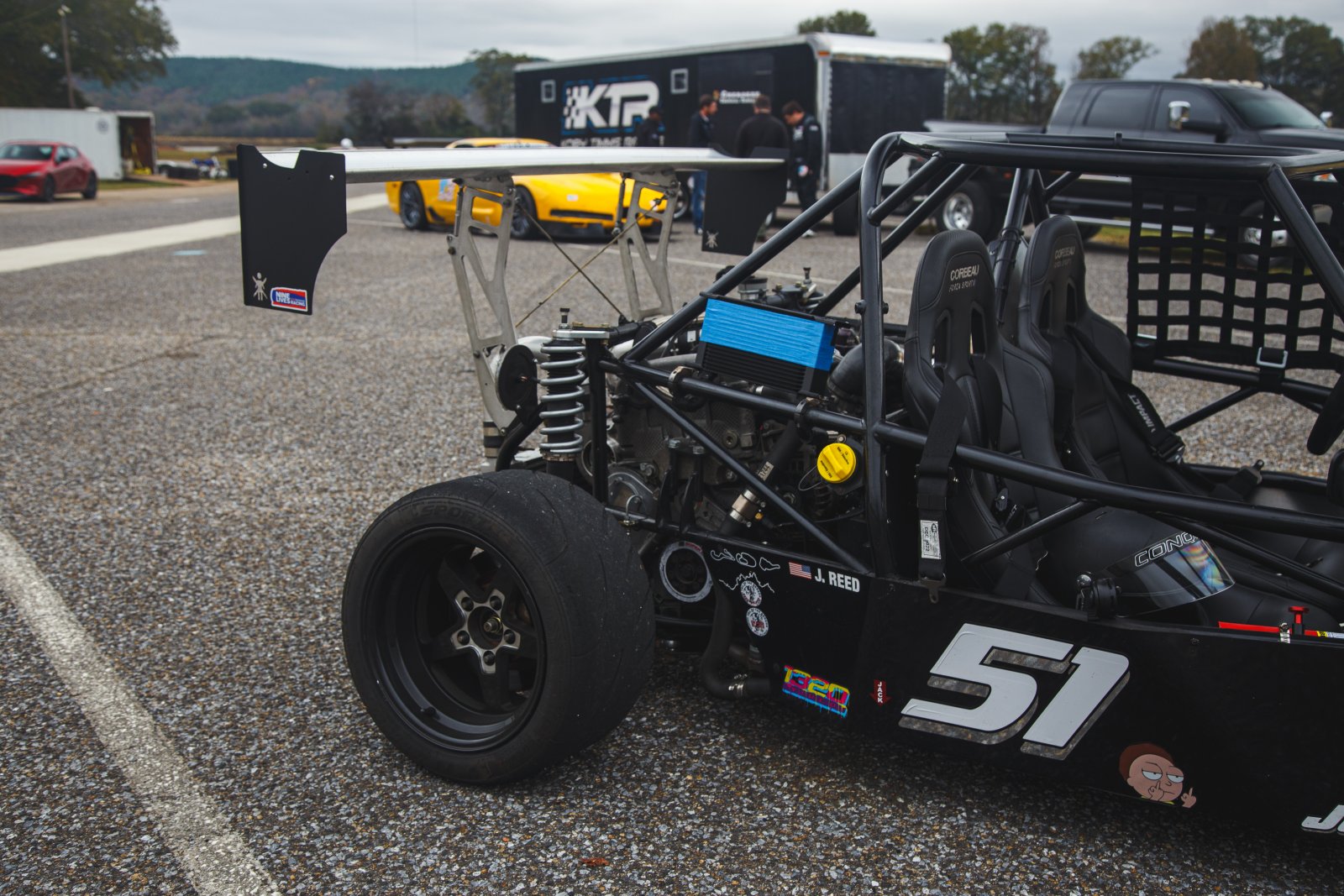

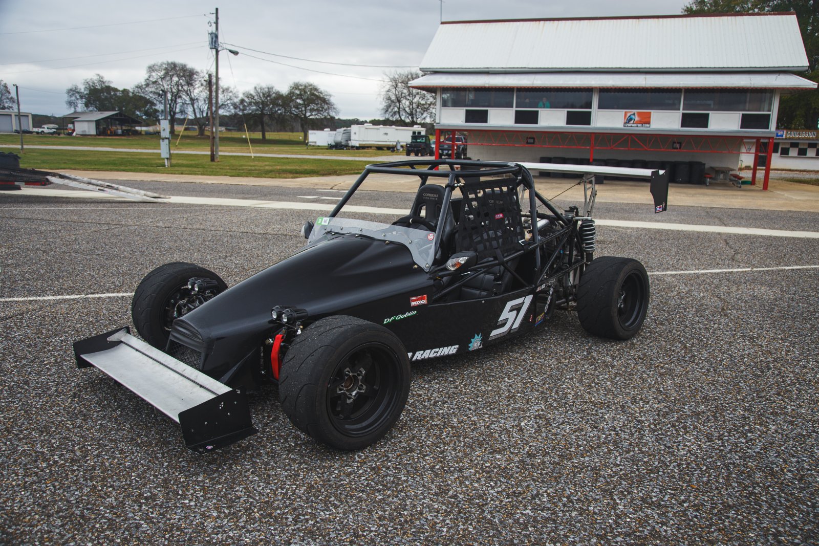

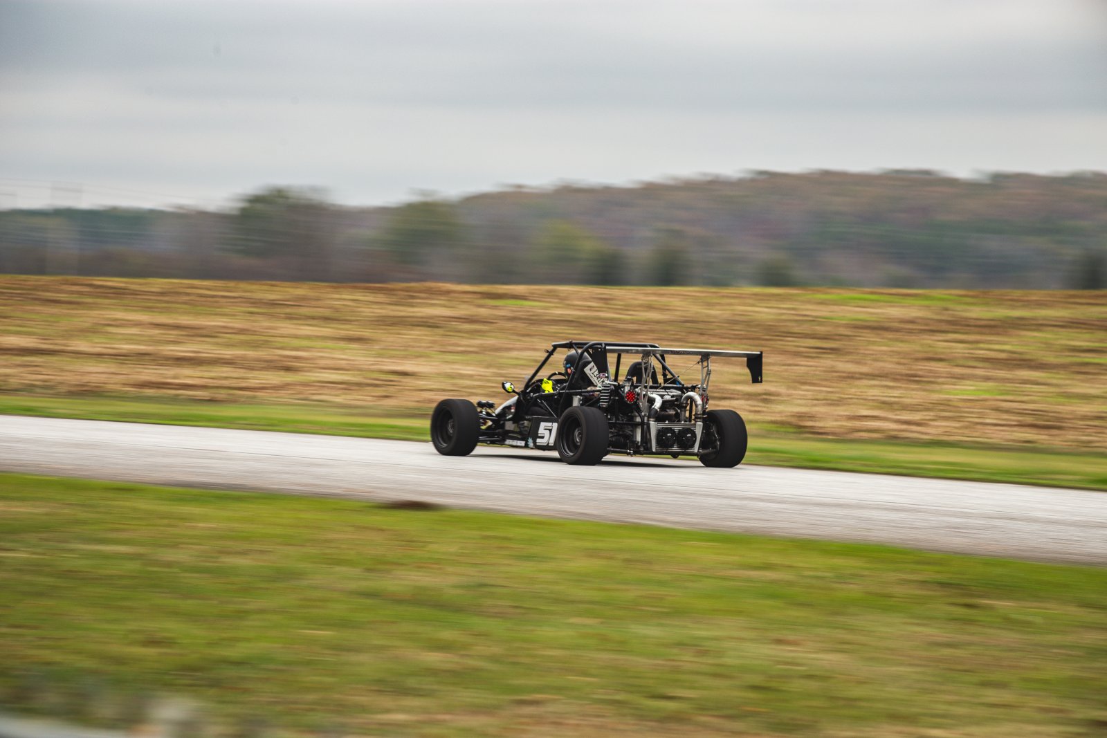

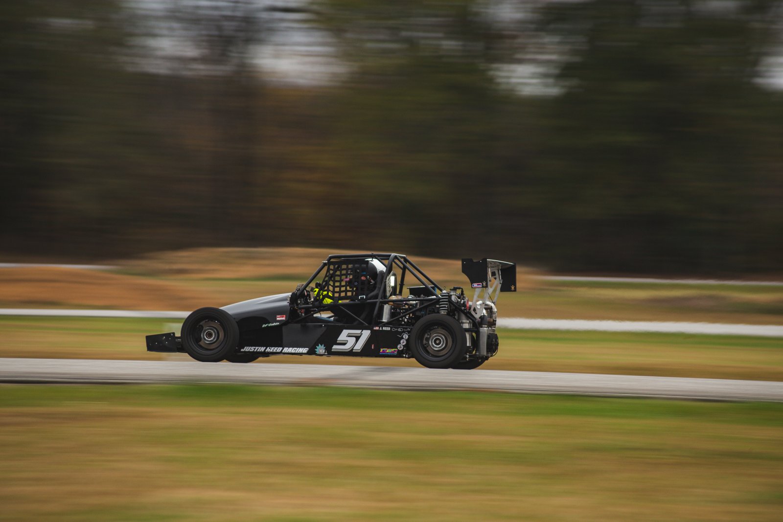

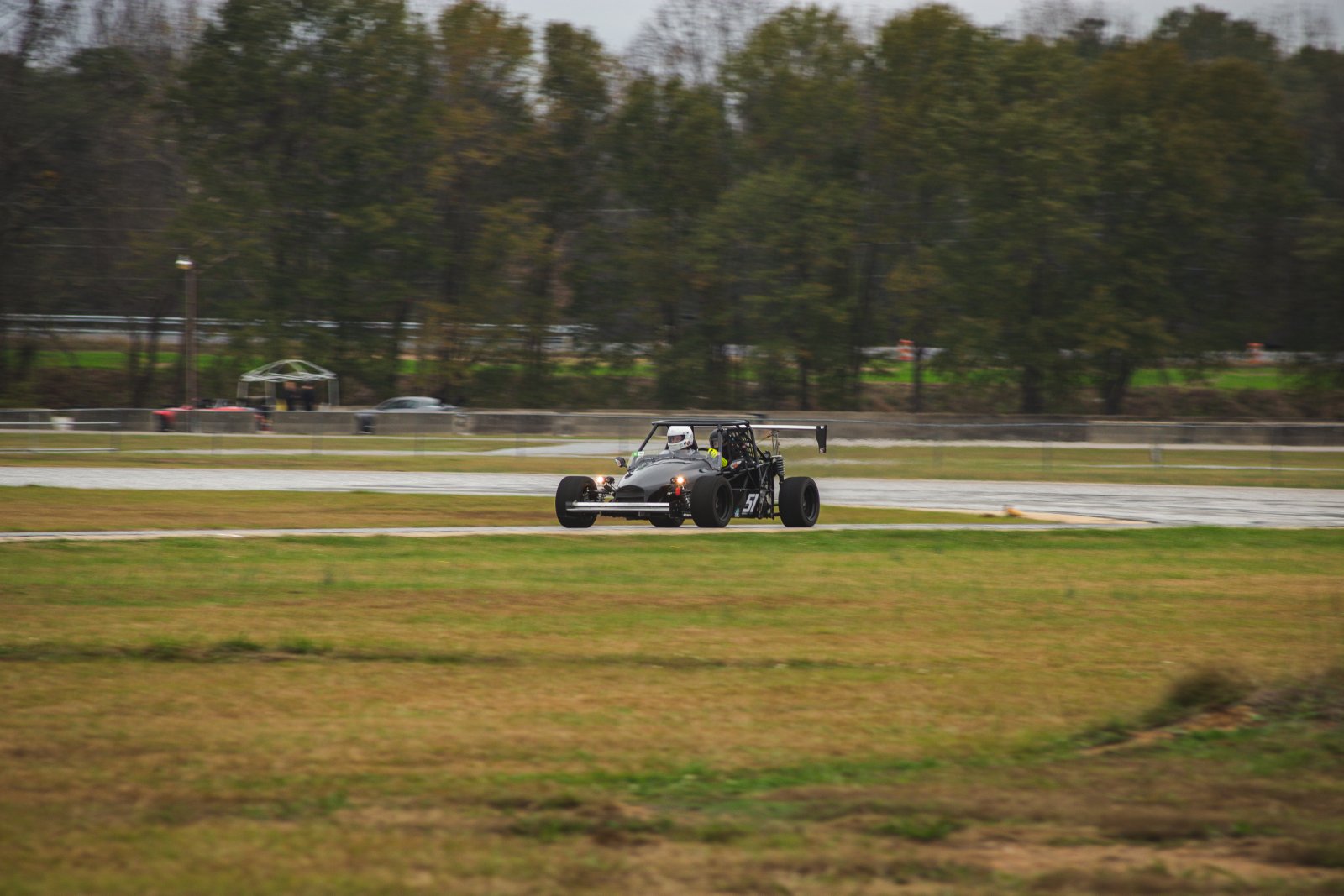

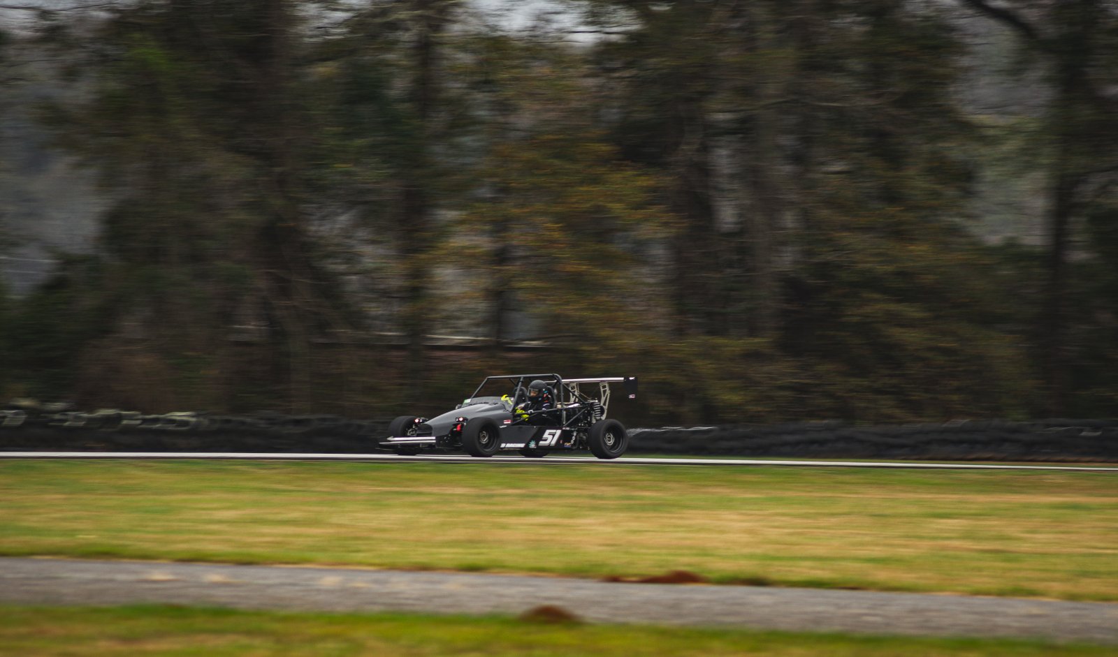

Car Setup for Talladega Gran Prix 2022 11/12/22
I forgot my Gopro at home so a passenger iphone video was the best i could do lol
Chassis:
Nine Lives Racing 48 inch Front Wing with dual element 10 degrees, 69 inch rear wing 10 degrees
500lb front springs 400lb rear springs
Brakes:
front-stock base cobalt rotors and caliper
rear- stock solstice rotors and caliper
Setup:
wastegate 16psi @425whp
1/8 toe in at front
0 toe in rear
-.5 front camber
-3 rear camber
275/35/15 Nankang AR-1s on 15x10 wheel
22psi cold front
26psi cold rear

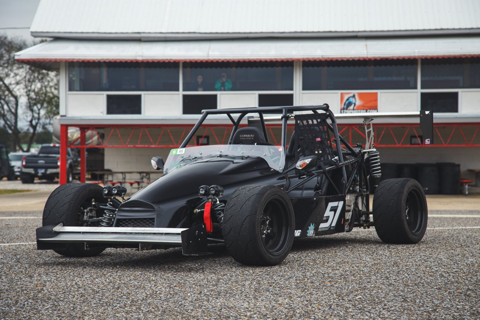

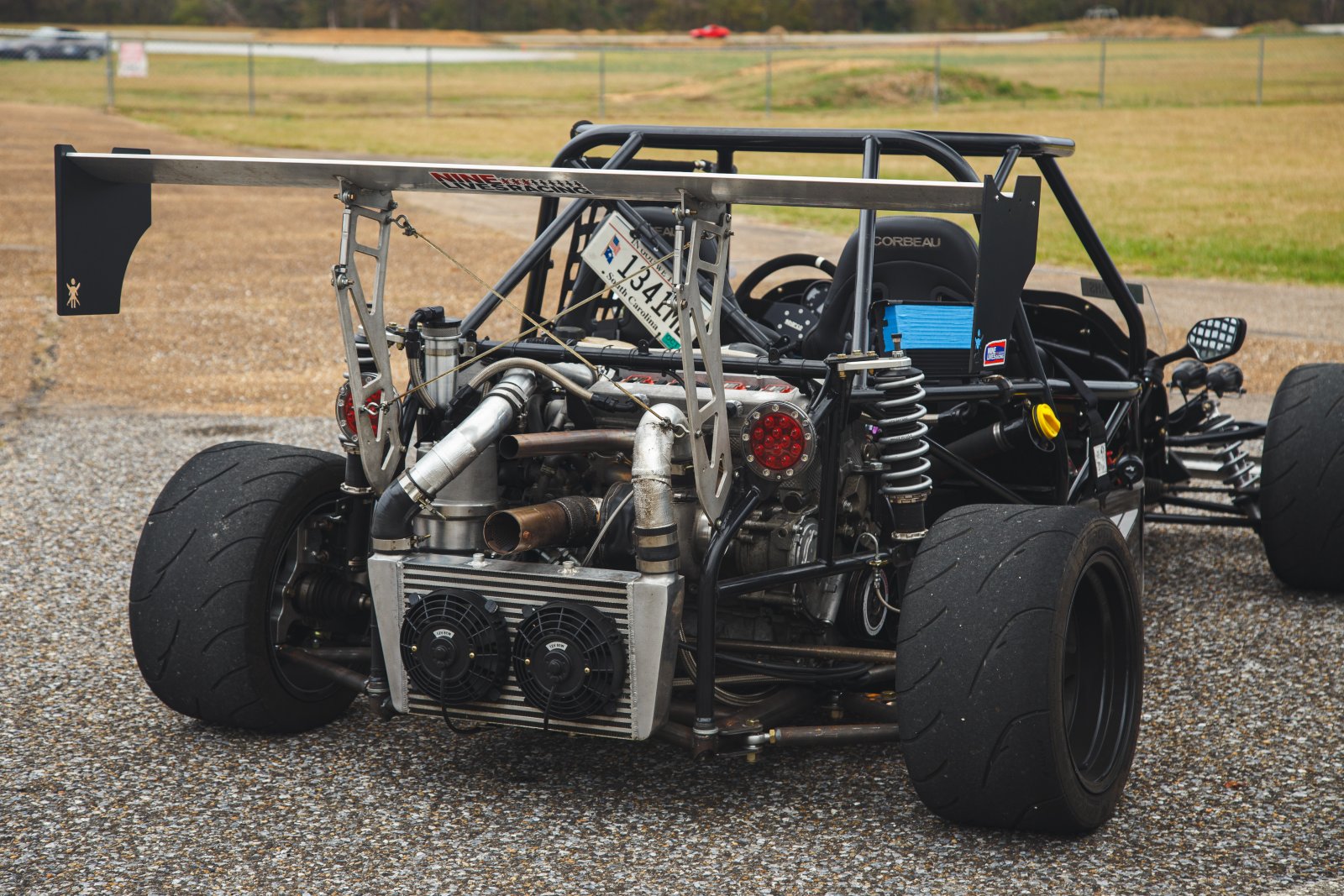

Notes: Track is extremely abrasive but has decent grip. The first track day I've had when traffic wasn't an issue made me aware of my inferior brakes. Running full beans the brakes only last a lap and a half before shuttering the car violently and fading extremely fast. Other than that the car was happy all day with the setup working quite well. Fairly stable under braking with slight movement and a secure corner entry and planted center. Slightly loose upon playing with throttle mid corner for better turn on slower corners and slightly loose on corner exit mainly due to trying to put the power down.
Justinreed7
What brake pads? Are you running the stock brake booster setup?
Stock pads because they don’t make performance pads for the base model unfortunately. No brake booster since I’m running a wilwood pedal box. The pads are so glazed they’re practically useless unless you get at least some heat in them now

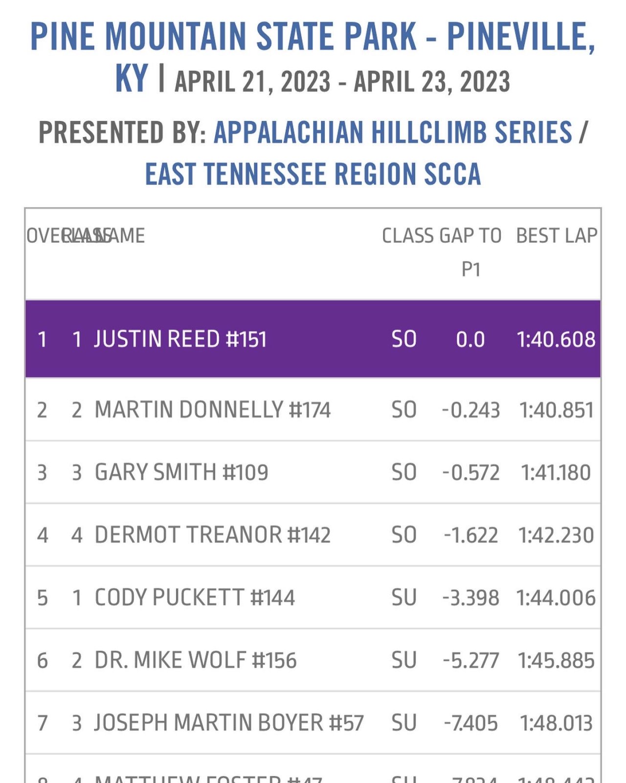

Thanks guys! In case anyone is confused what they’re talking about, I’ll post the winning run below!

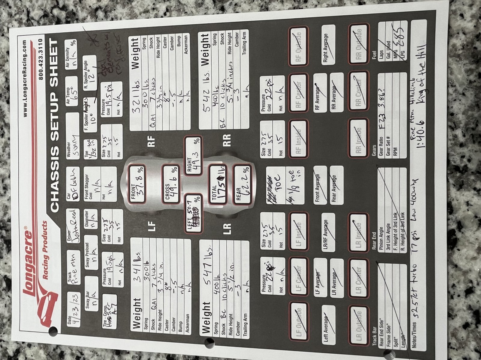

Pine Mountain hillclimb was one of the more frustrating hillclimbs for me due to the tight low speed corners and just terrible surface in general. Turbo is way to big for the tight switchbacks and am already looking into other turbo options to keep the car ahead of the field. There was some time left on the hill due to turbo lag for sure…. Here’s my setup sheet from the event as well! NOTE: this isn’t a magic setup and will not plug and play to yours. Saying this because I’ve had a few try and complain. Setups are relative to driving style and what the car will be doing.
