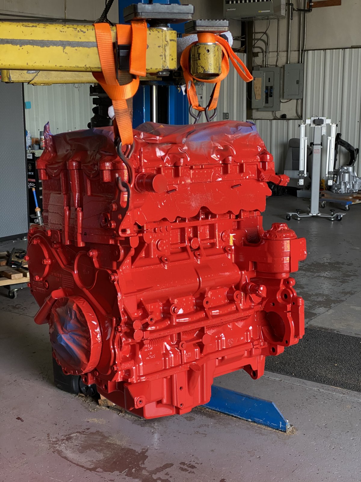

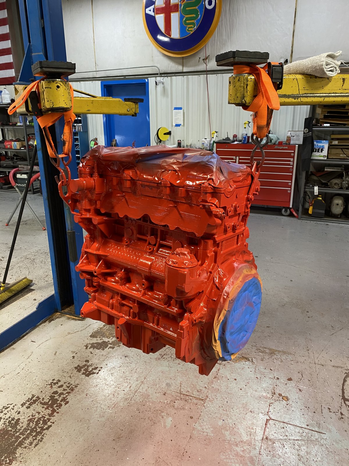

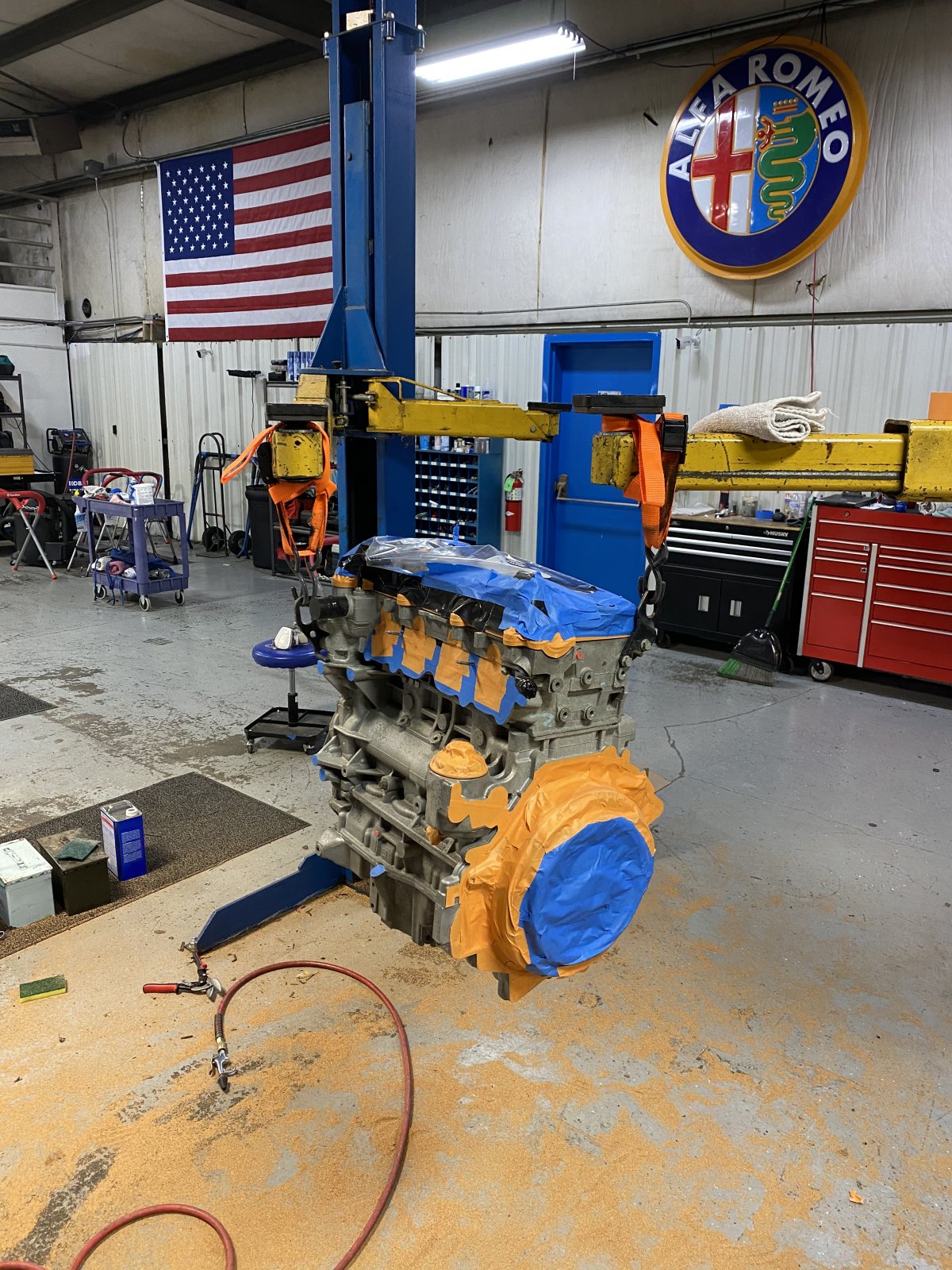

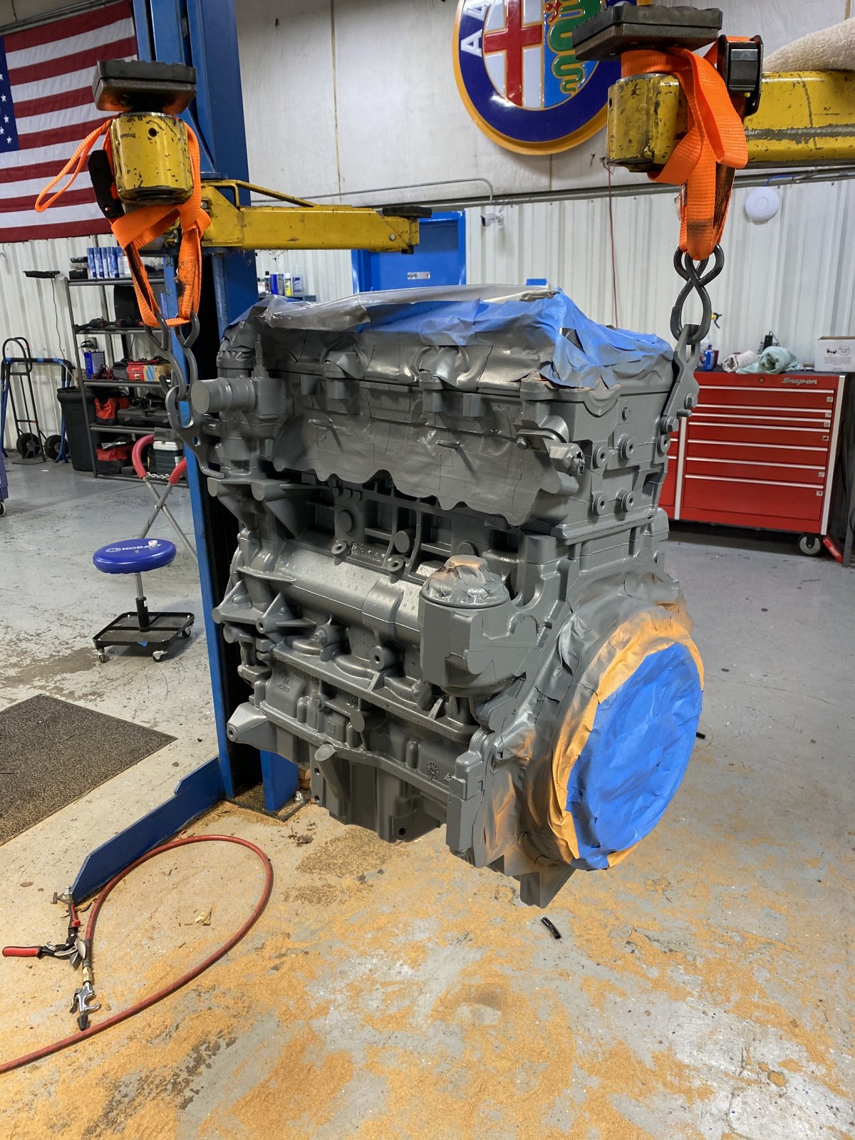

Well, got the motor painted today! Here’s some before and after pictures. Still gotta take the masking off but I think I’ll clear coat it tomorrow

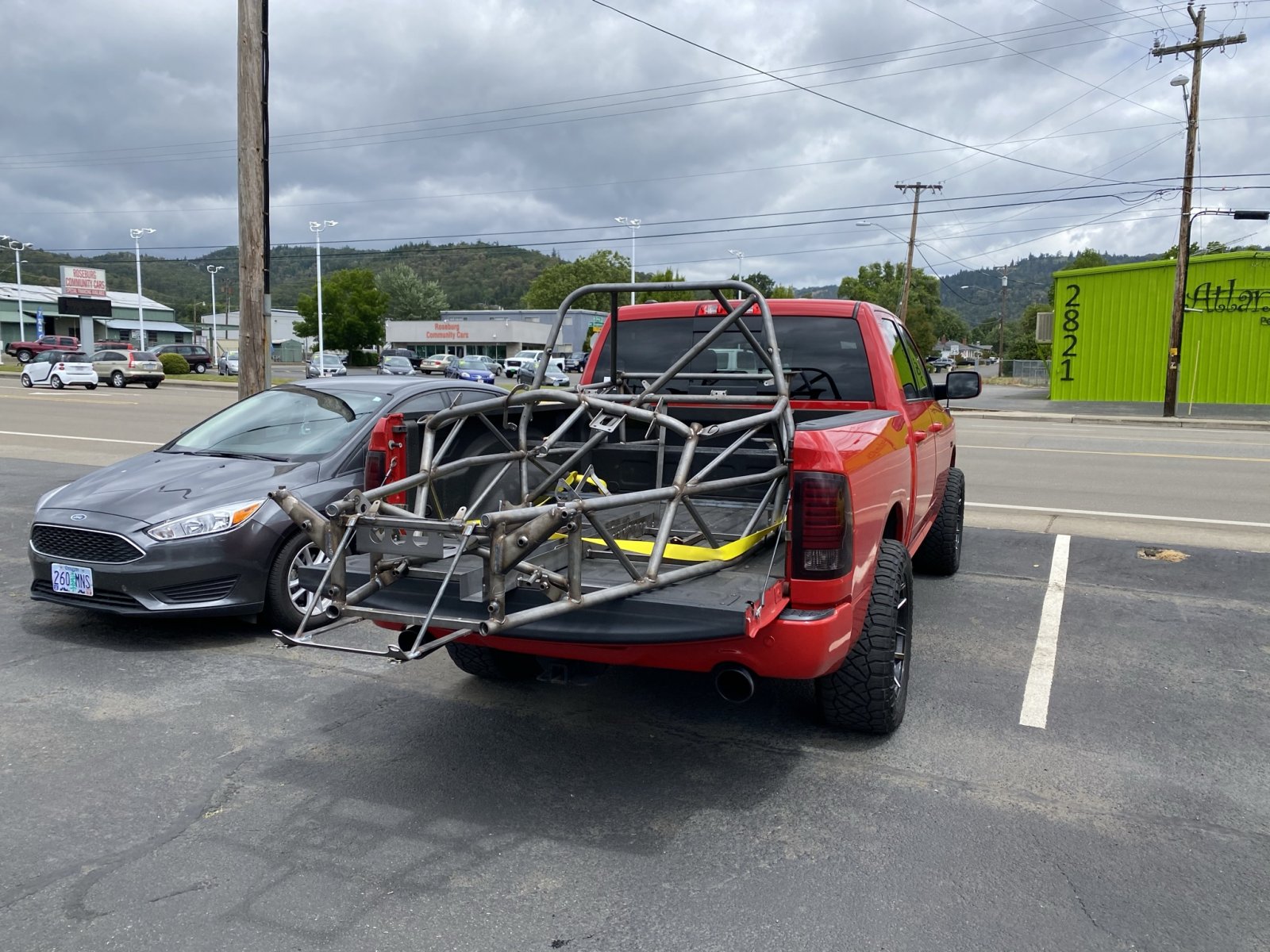

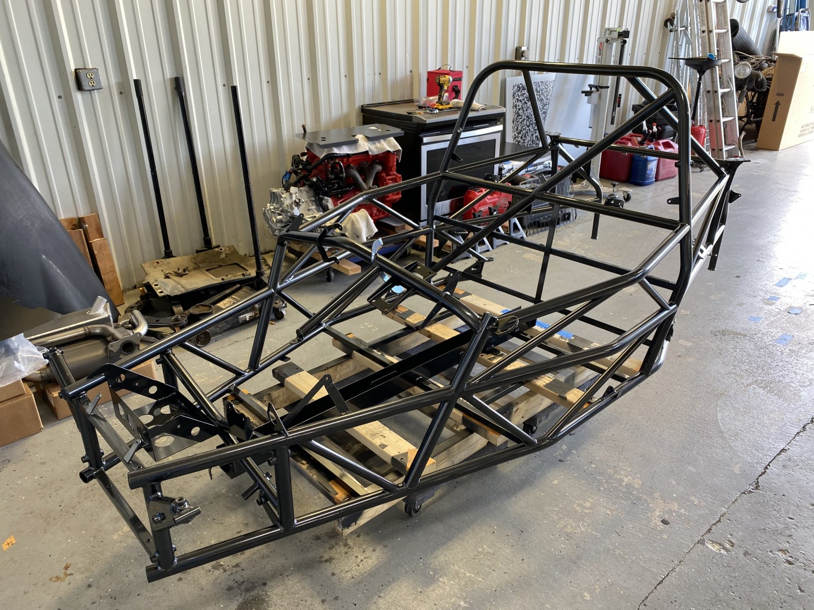

Alright it’s been a minute since an update but #288 showed up last friday and she’s already off to the powder coat shop!:cool:

2 weeks and $400 later for coating and she’ll be ready to load up the motor and *hopefully* crank over as long as I did all my wiring work right:eek:

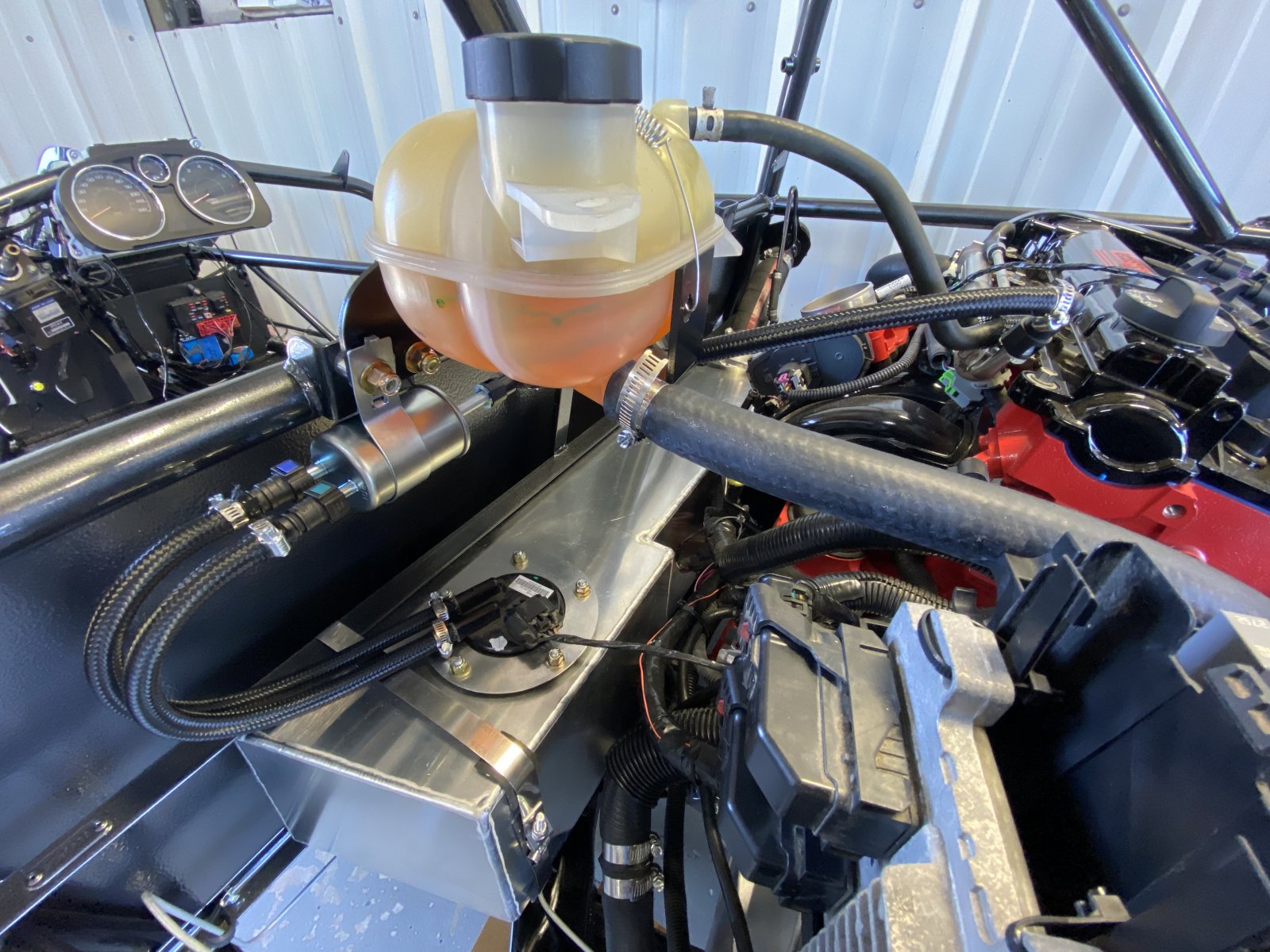

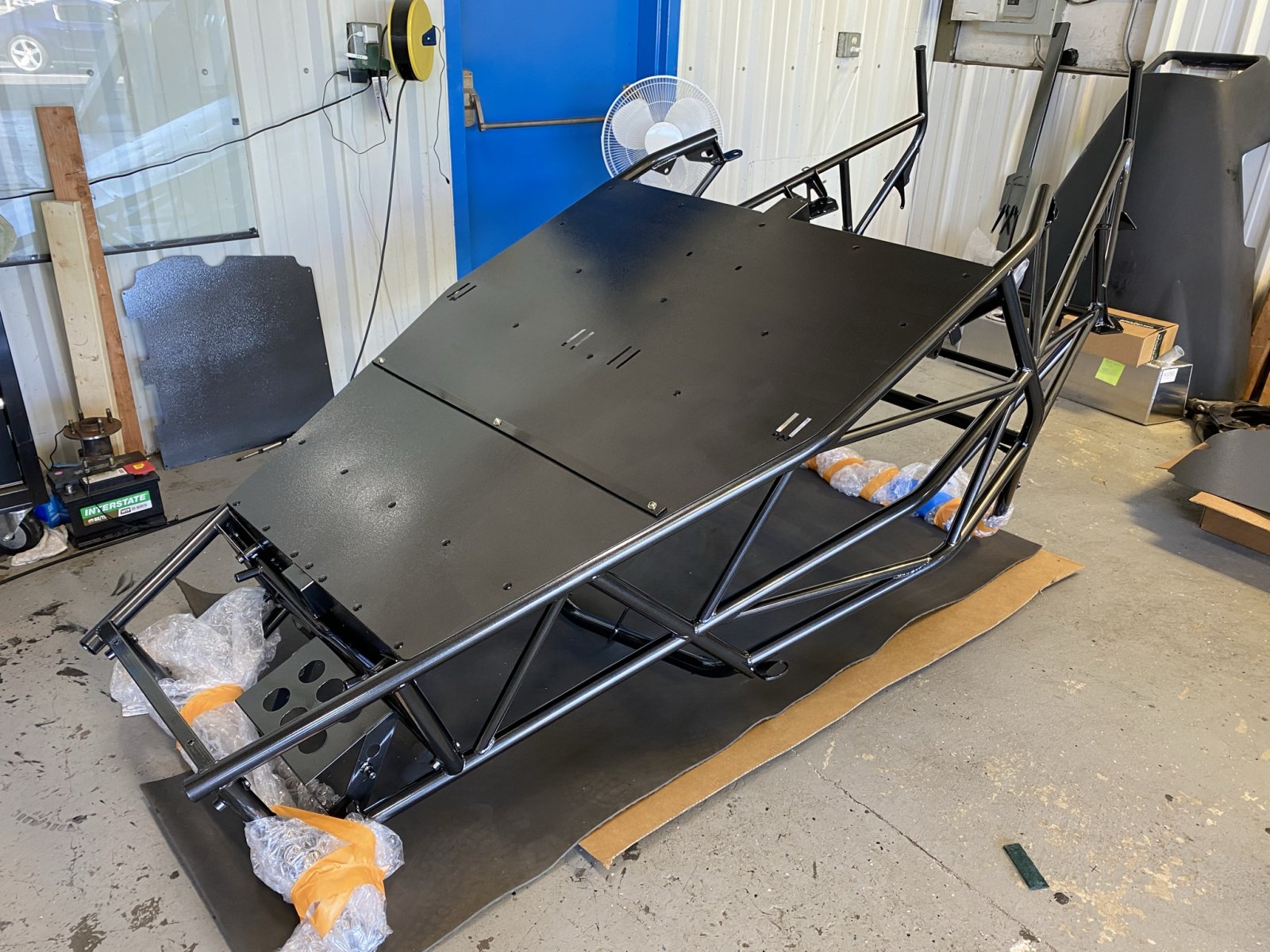

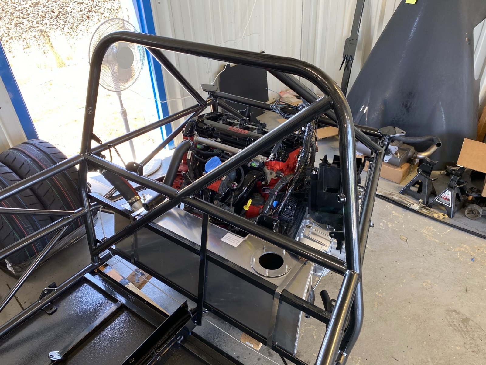

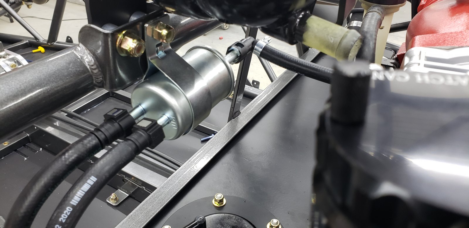

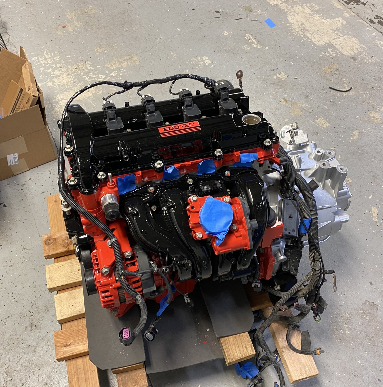

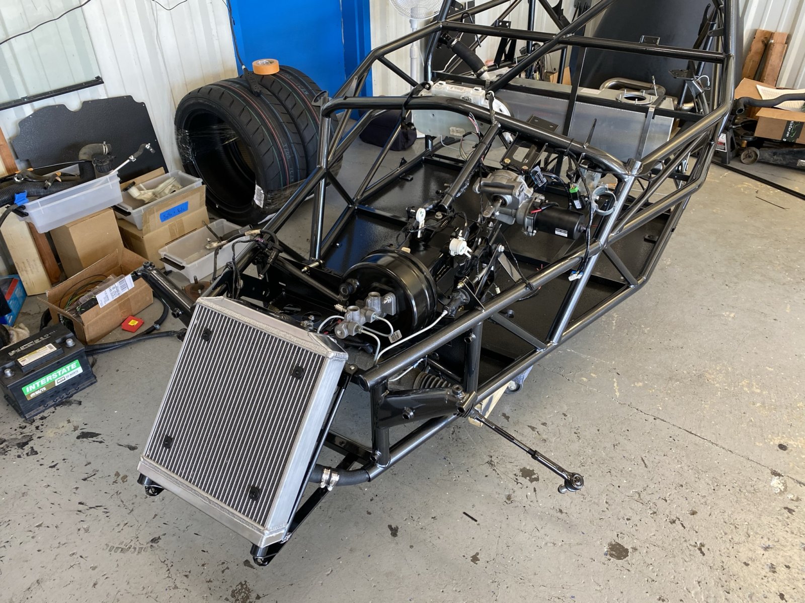

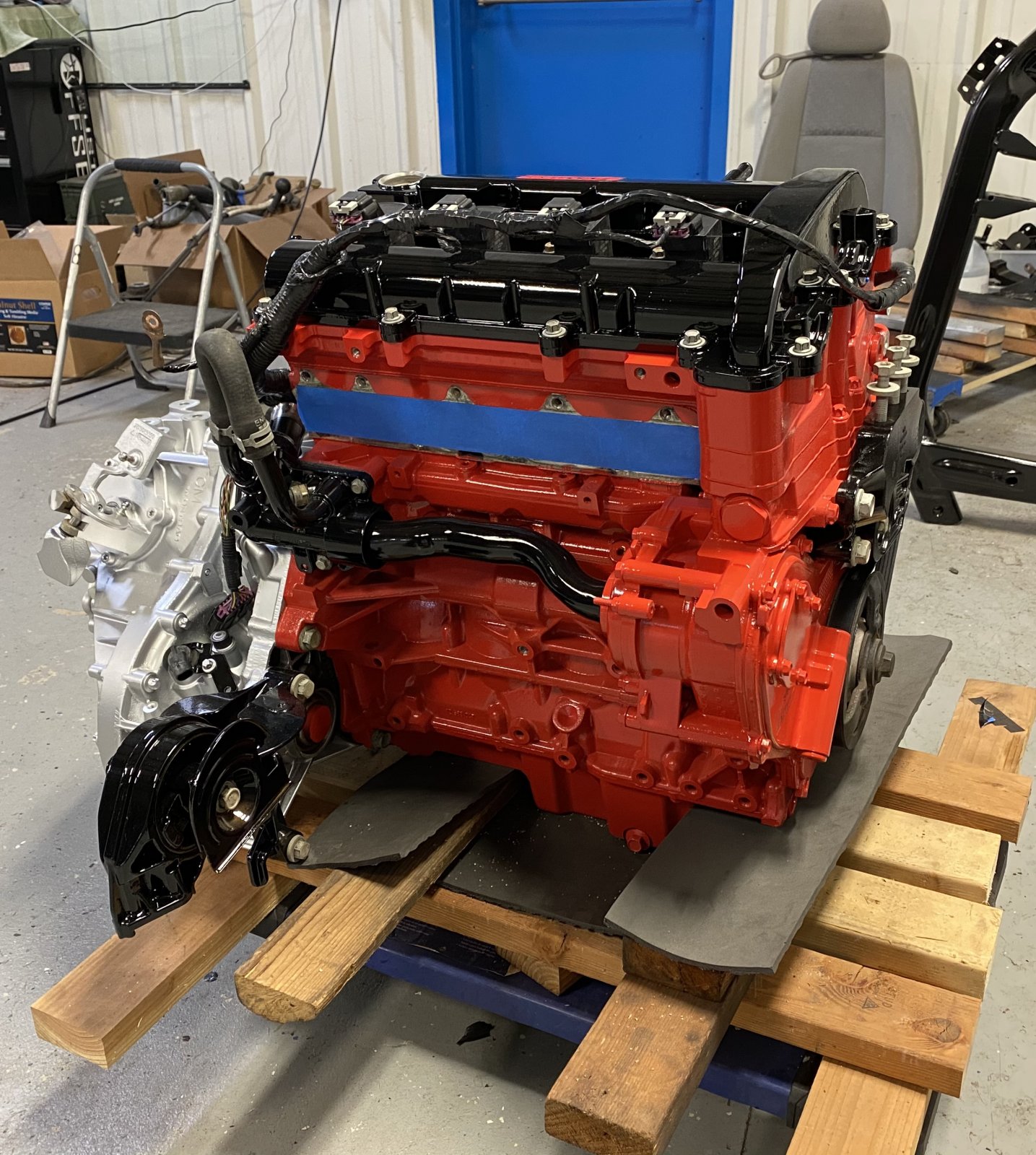

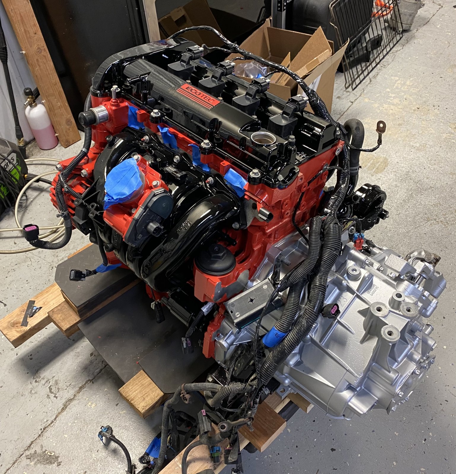

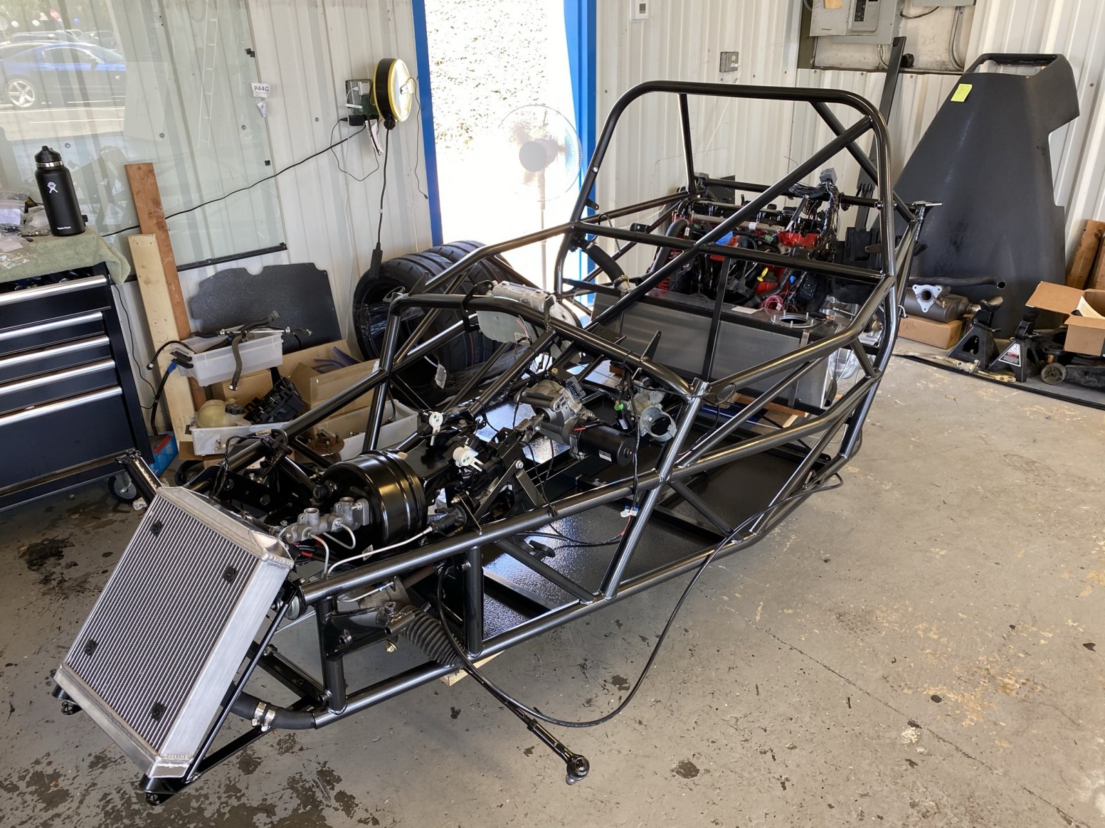

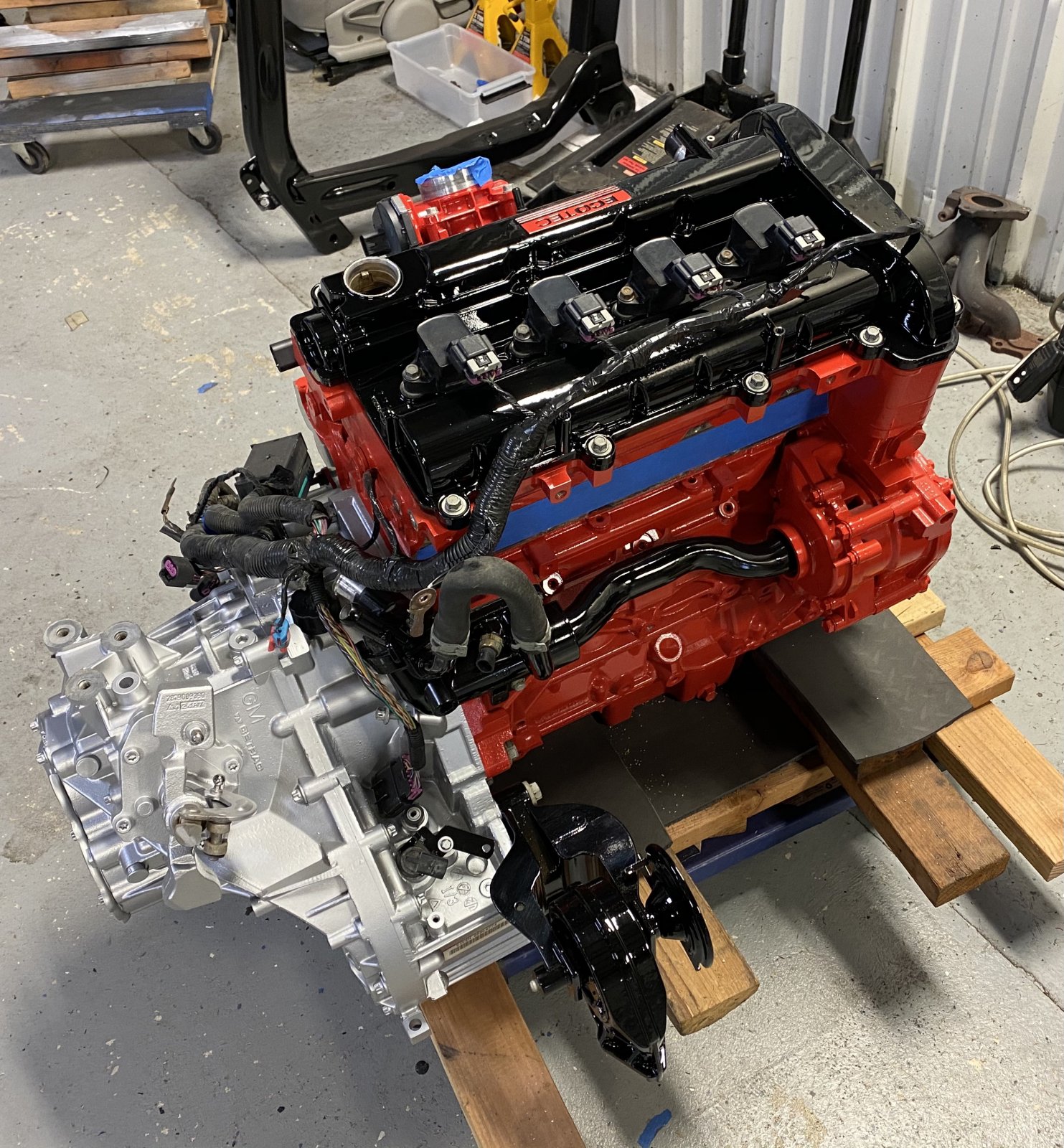

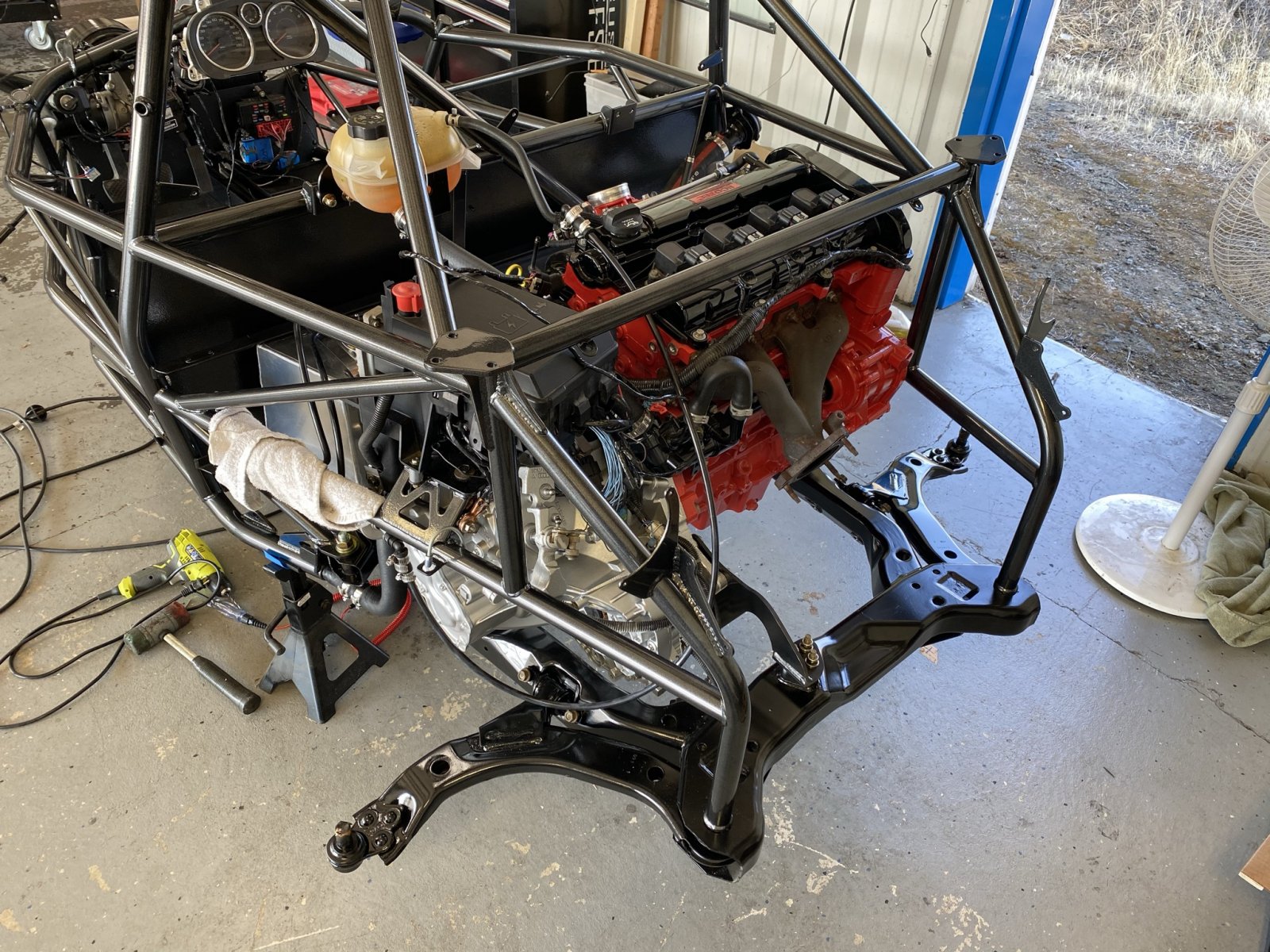

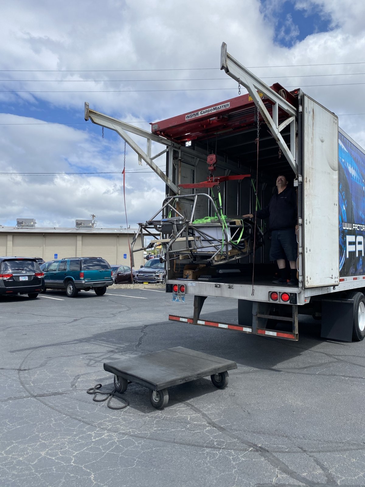

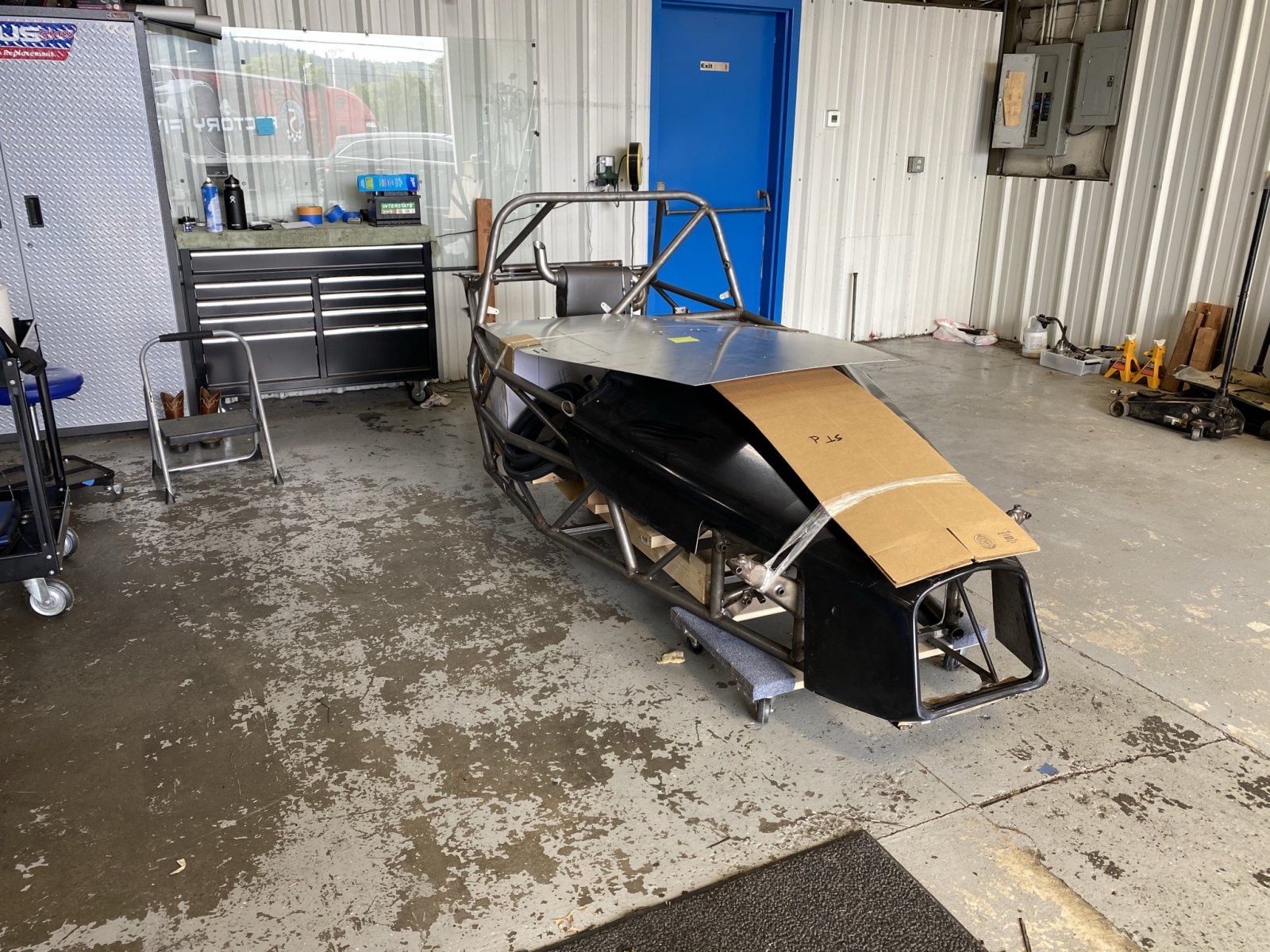

It’s been awhile since I posted any updates but that’s because I’ve been non-stop busy tackling the build since I got it back from the powder coat shop! Here’s a collage of how it’s come together since then.
25168
25169
25171
25172
25173
25174
