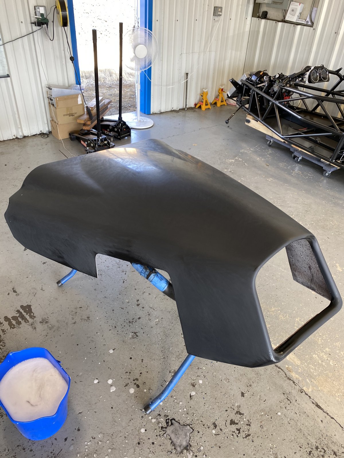

Hitting the hood with 600 and then 1500 grit in prep for vinyl wrap

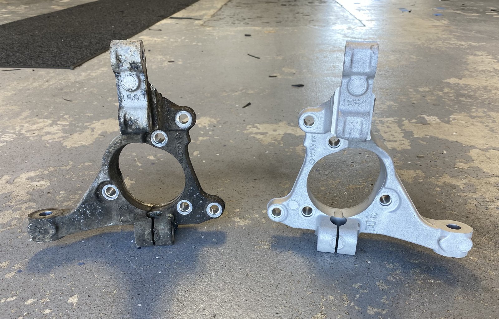

jFritzies

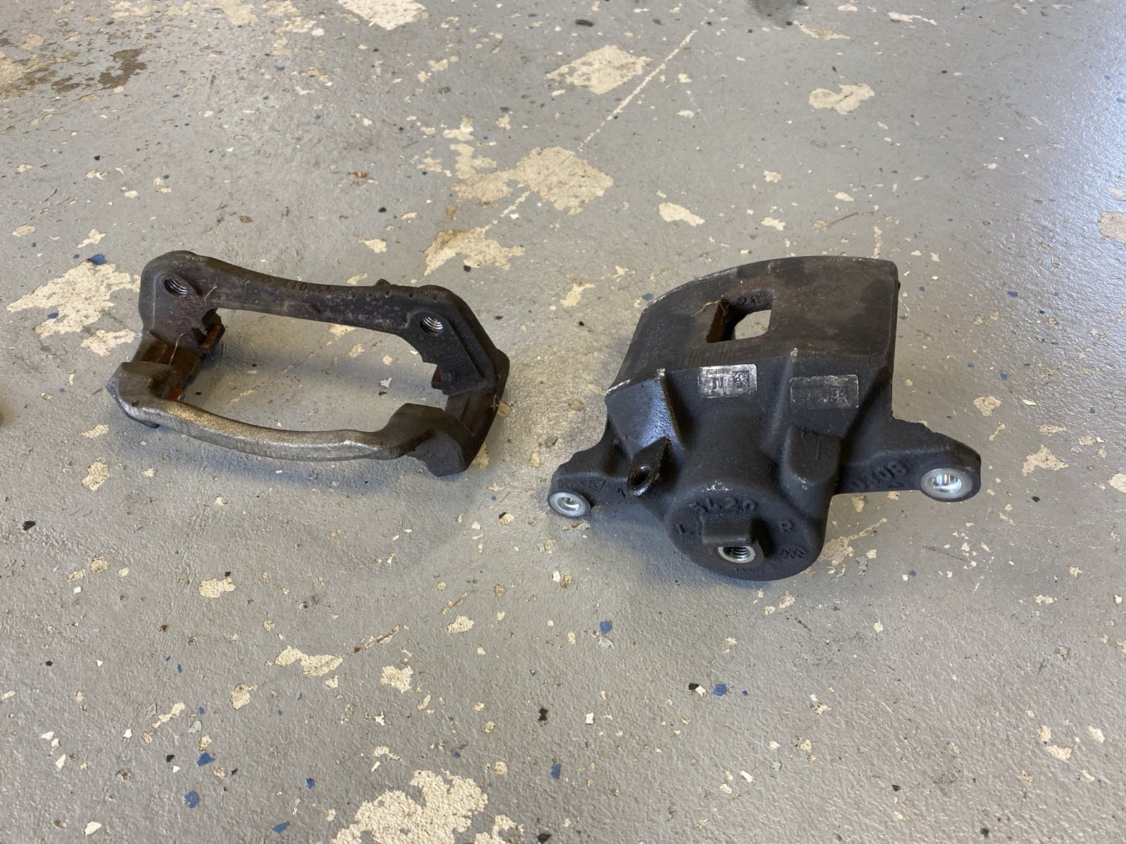

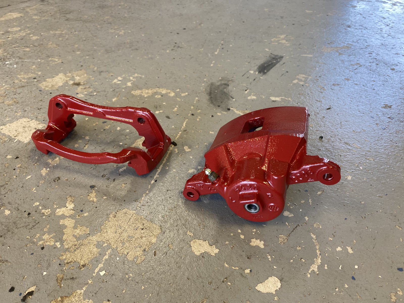

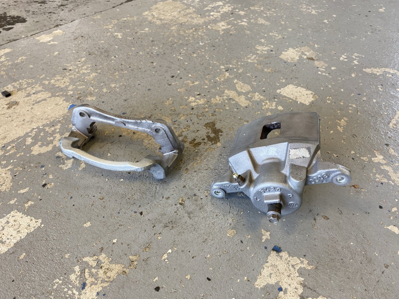

Got some before cleaning, after sand blasting, and after paint pictures of the calipers. Just used Rust-Oleum caliper paint and they came out as good as cheap-o gm calipers can;)

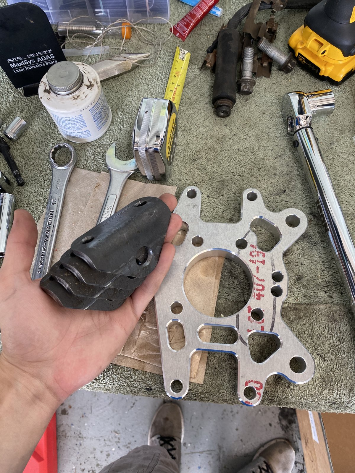

jFritzies
These must be the newer version of the rod end mounts? I’m still following along the old videos and I’m assuming these are them.
25623
These must be the newer version of the rod end mounts? I’m still following along the old videos and I’m assuming these are them. View attachment 25623
second link on the page.

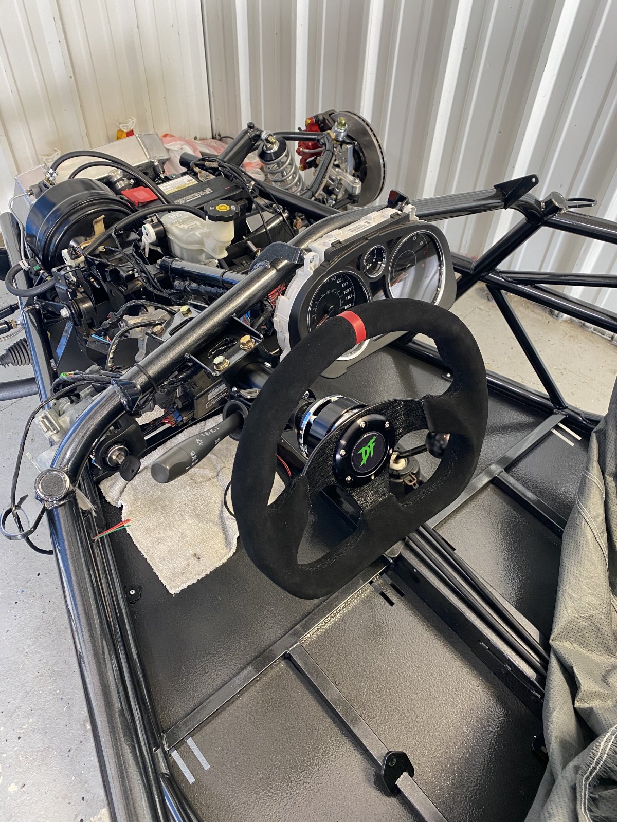

jFritzies

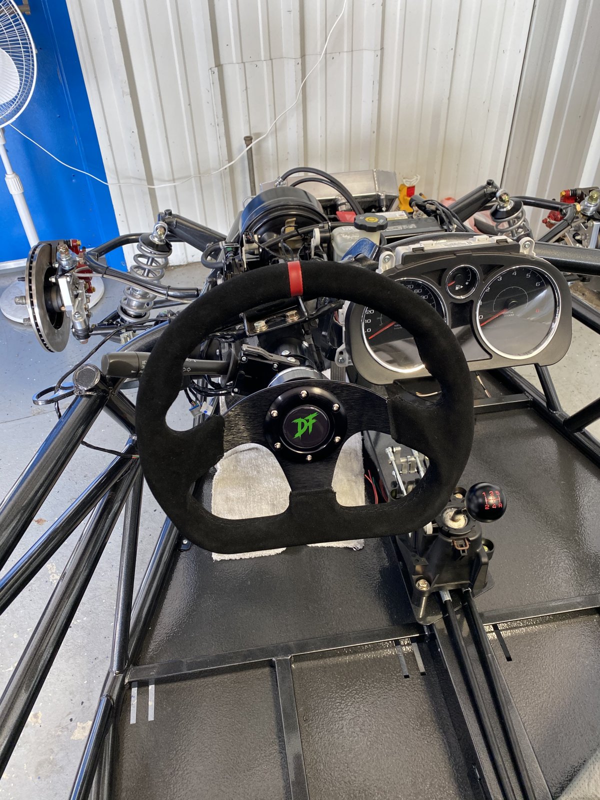

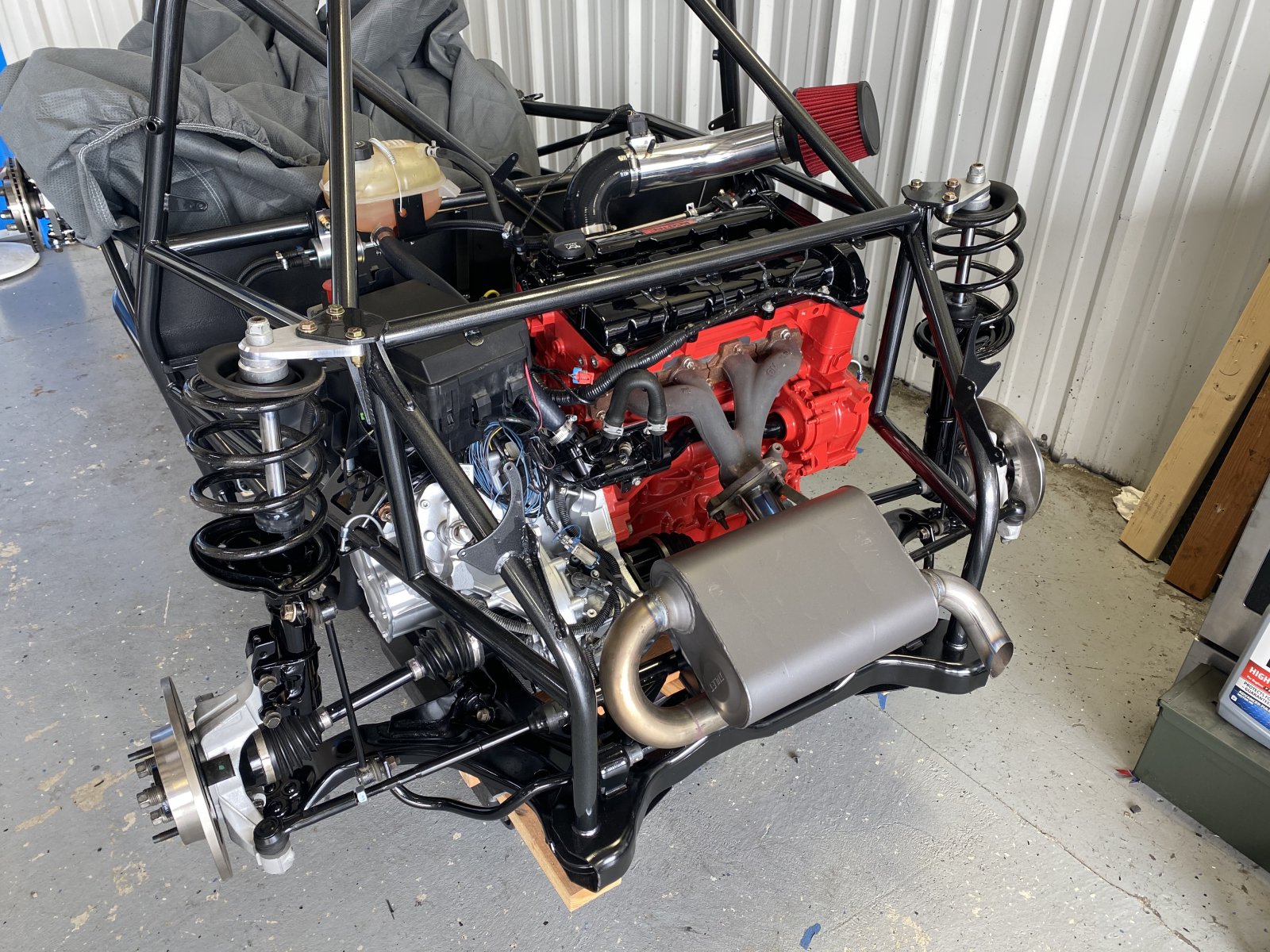

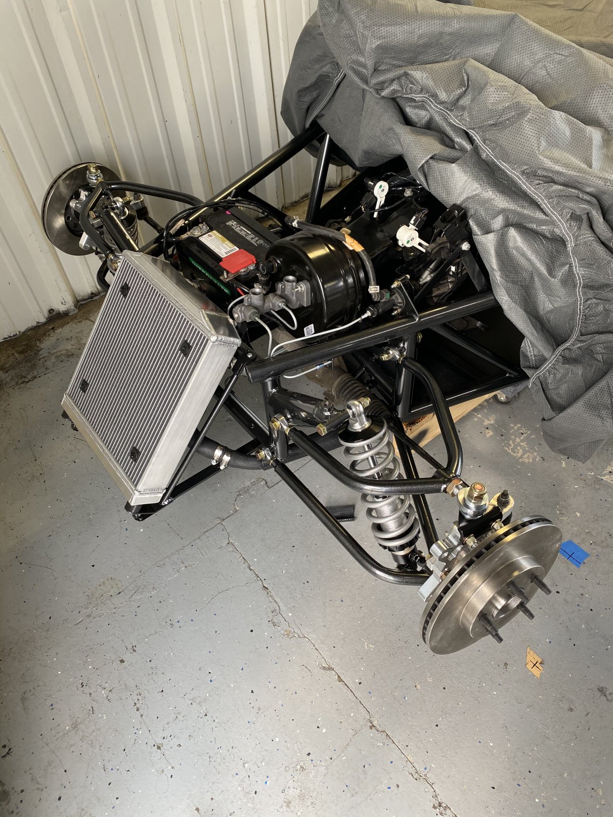

Made good progress the past couple days on the front suspension. Gonna start on the rear soon. Anyone have pictures of how the rear suspension with reusing the old front cobalt struts and springs go together?:p
25691
jennam
Mine still has the factory struts. I can take any pictures you need.
One note, you will need a coil spring compressor to mount the top of the strut to the frame.
jFritzies
All the suspension and front brakes are done. Anyone have pictures or a thread that shows how the rear brake calipers mount up? The parking brake instructional pictures don’t show much.
25821
I ended up having to pick up 4 extra M12 bolts and some washers to shim the caliper mount bracket adapter. I don't remember the length off the top of my head.

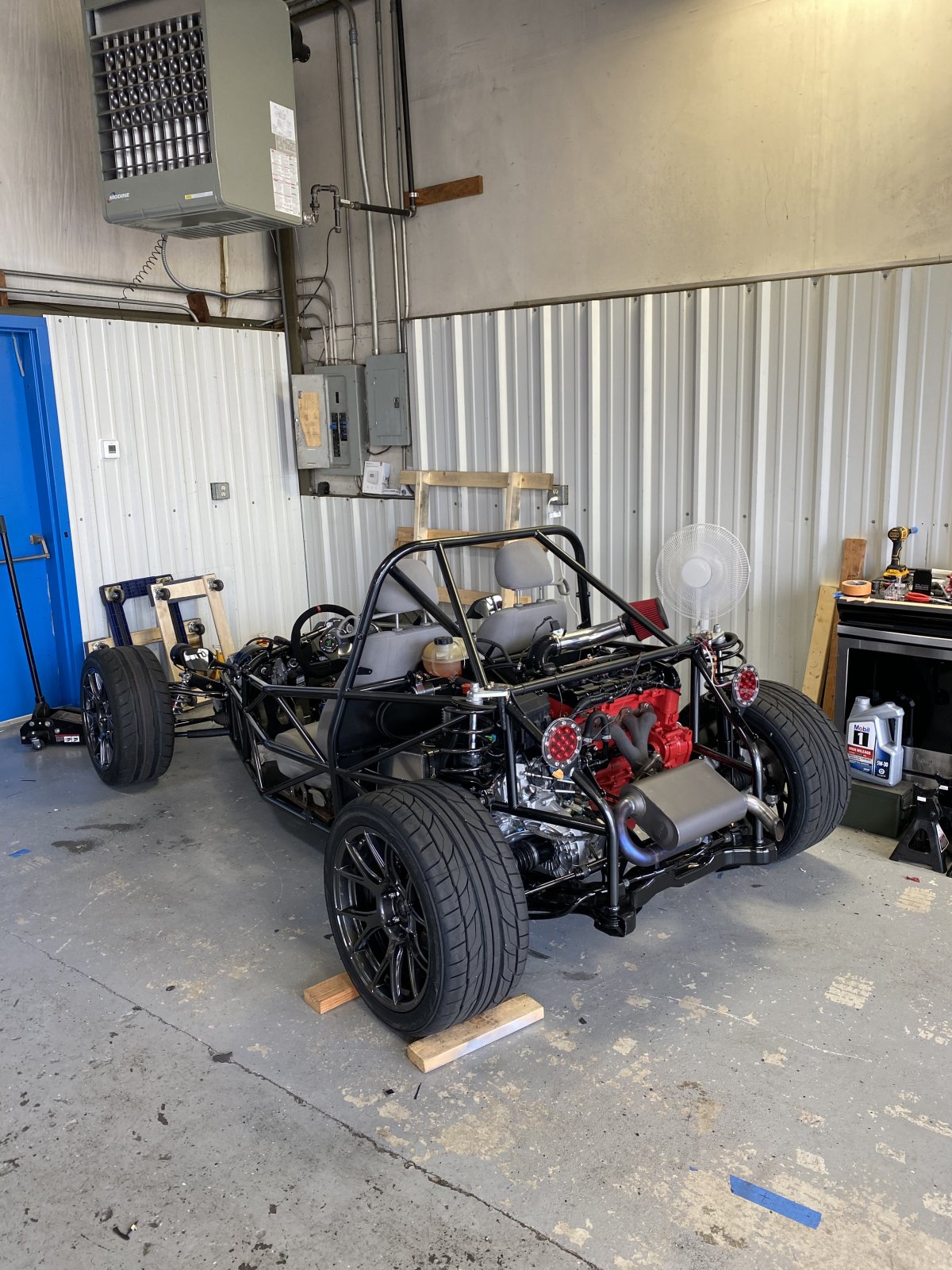

Got the wheels and tires mounted and had the first little drive today! She’s QUICK. Even though it’s a N/A 2.2
So are you still going to turbo it? You drove it around at 155hp and said "she's QUICK," but also you want to double (more or less) the horsepower? Sounds just like me ;)
What are those wheels and tires?
