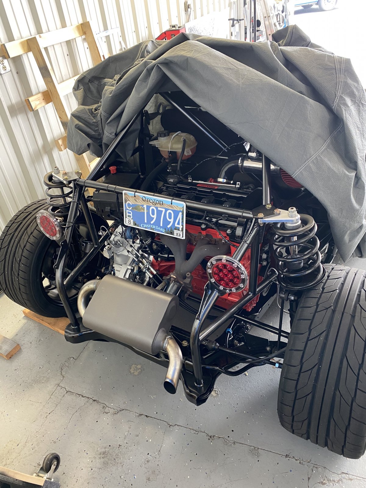

The wheels are Konig Ampliforms. 17x9 up front with Nitto NT05 255/40/17 and 18x10 in the rear with Nitto NT 555 G2 285/35/18. I probably have ~1/4” of clearance with the factory cobalt rear struts with this setupo_O
Good thing I went with 285 wide instead of 295 last minute or else I’d be shopping for some spacers

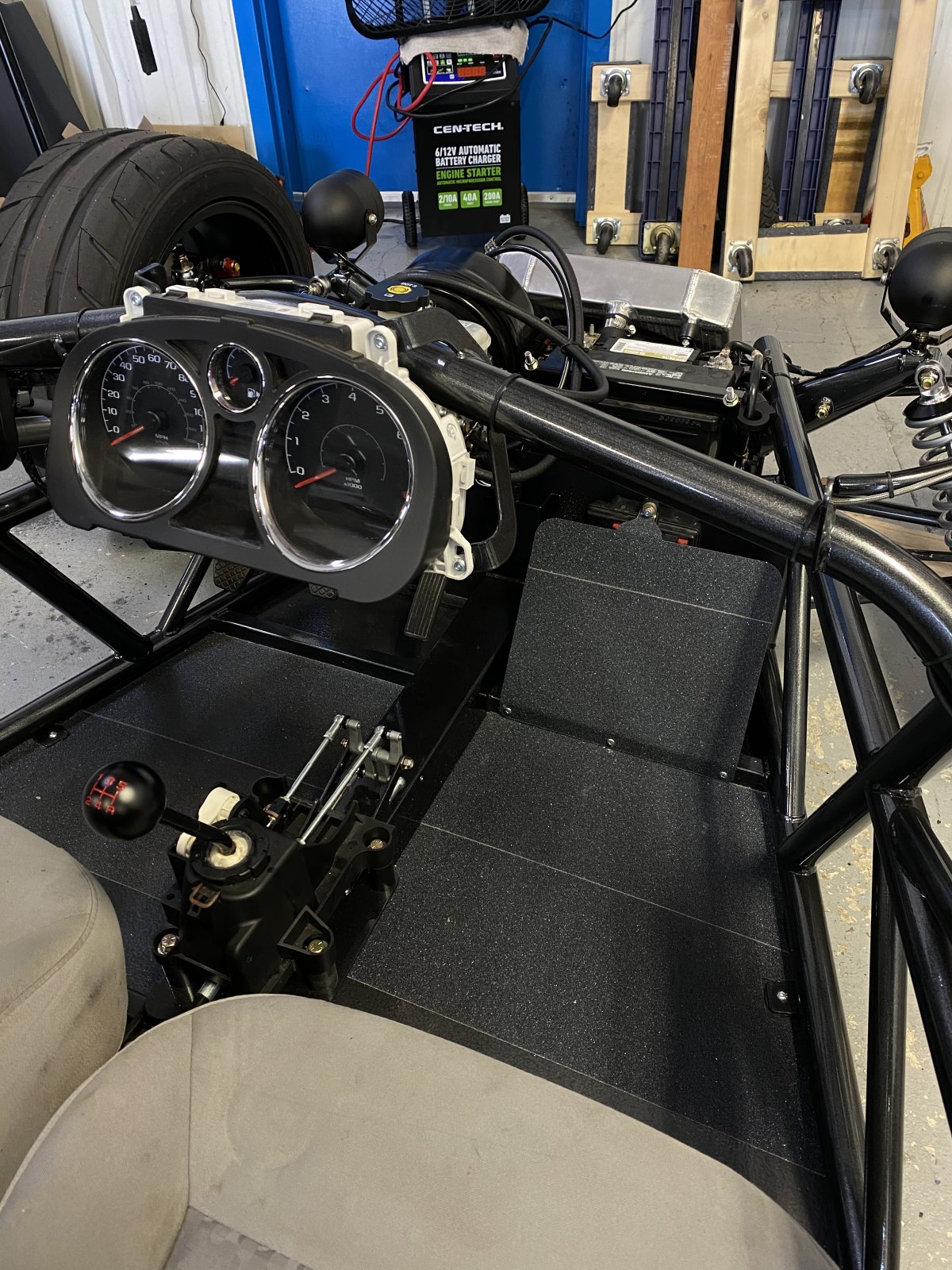

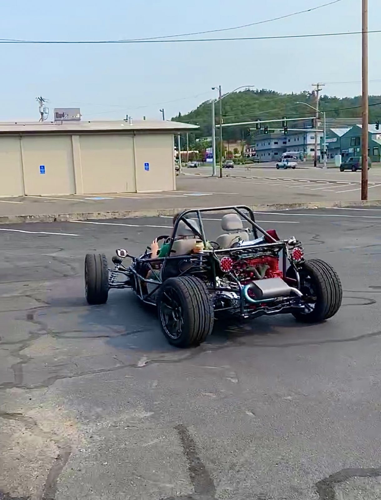

Got a few things done today. Bolted in the seats so now they’re not just “sitting” in the slots, (was a bit sketchy on the first little drive). Installed the kick plate along with grip tape on most of the floorboard and then got the toe aligned. My angle finder will arrive Monday so I can adjust camber and caster. But as of right now she tracks perfectly down the road. Camber is definitely what needs to be addressed as it’s very aggressive negatively. Also love how she looks from the back with the 285 wide.

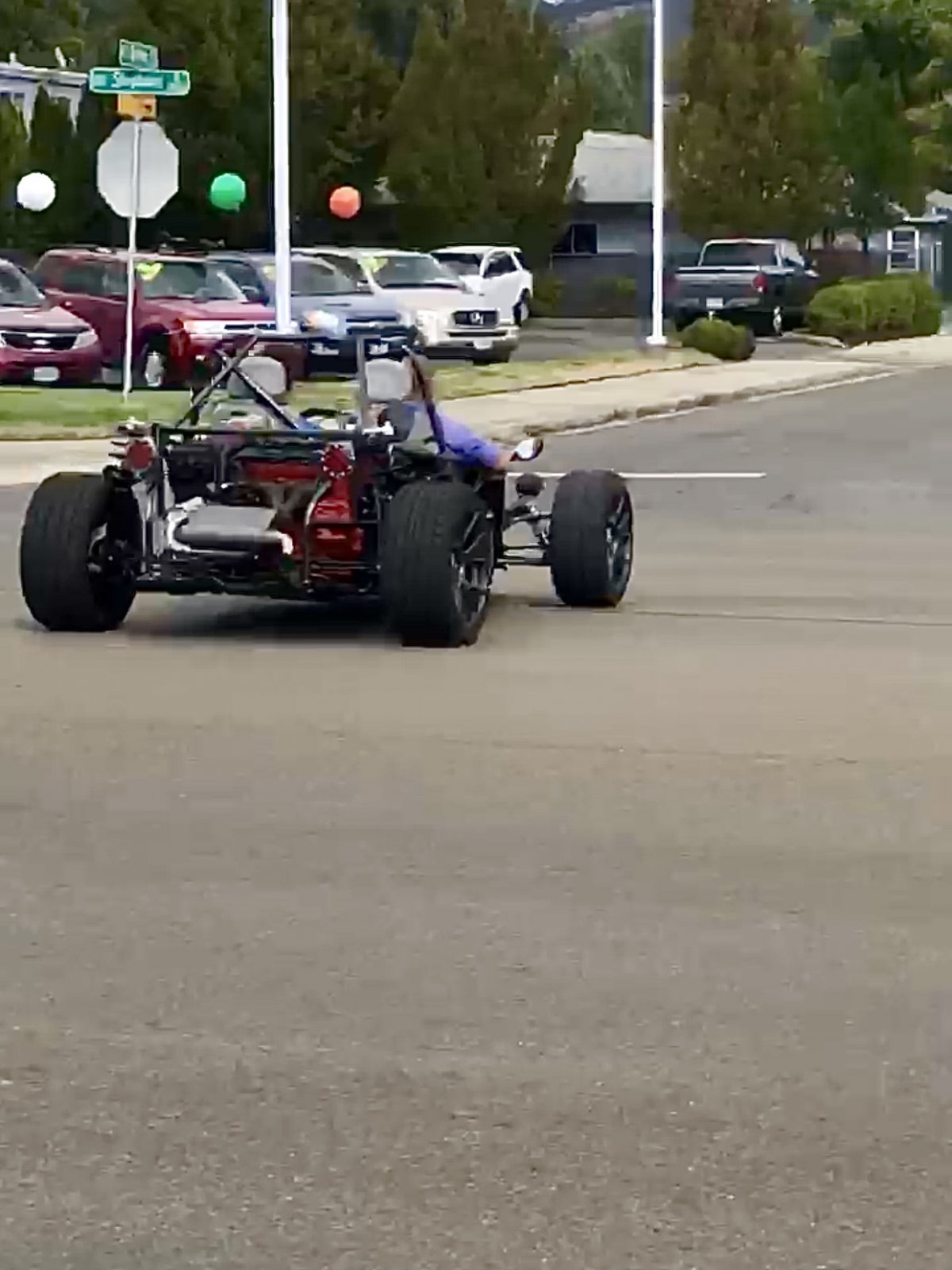

jFritzies

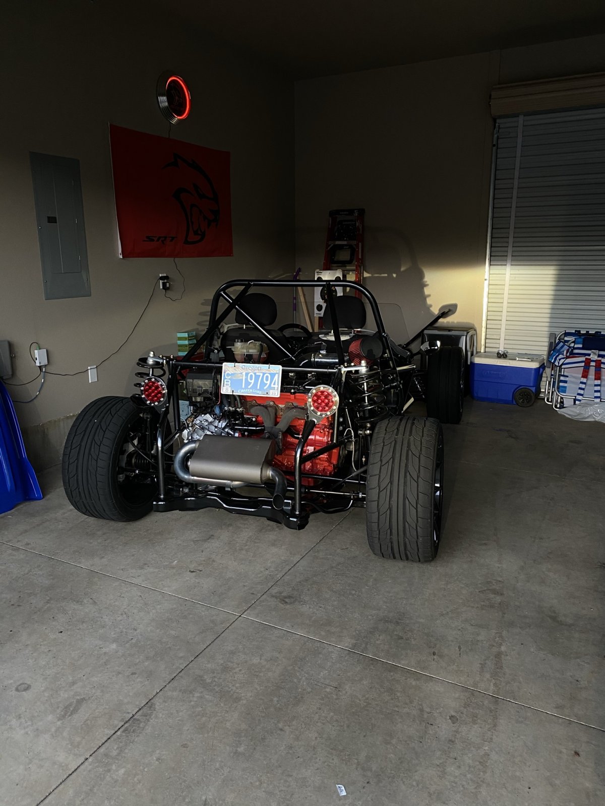

After aligning the whole car with my new angle finder I took some of the family for a quick drive down the street. All I have to say is, WOW. This thing is ridiculous with only 155hp! I can’t imagine what you SS donors experience. This this is stout and so much fun. I haven’t even experimented with cornering yet:eek:. I got a few pictures of her moving but I plan on making a compilation for YouTube eventually. Other than that I have a slightly stripped stud on the drivers front hub bearing, the video said 50ft pounds and I think it’s supposed to be around 35. Good thing is I have all original hubs from the donor I can swap into the drilled ones from DF I’m using. I’ll try and get that done tomorrow.

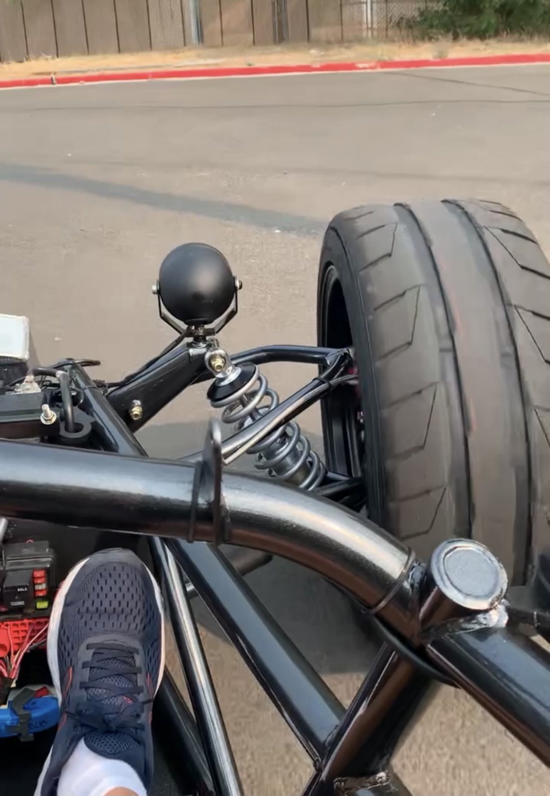

What made you go with the different tires front and rear? Just different size availability for the different diameter wheels?
jFritzies
Originally I ordered all Nitto NT05’s (the ones on the front) in June. The rear kept being back ordered later and later and later and I couldn’t find them anywhere to buy them from and get them sooner so I canceled the rear and got Nitto G555 for the rear. I didn’t want to but it was what had to be done to get the **** thing on the road. At least they’re all the same brand:rolleyes:

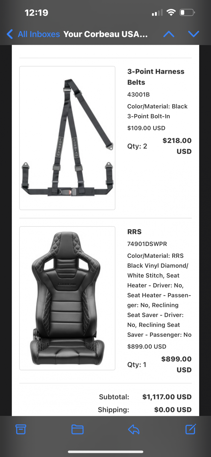

k.rollin
I don't know if there's a good way to run those 3 point harnesses in our cars. The single shoulder belt mount is typically attached in the rear of the cabin, and the Goblin doesn't have a suitable area for that arrangement.
jFritzies
any reason you went with a 3 point harness over a 4?
Looking at the difference between the 3 and 4, the 4 just requires an additional spot to mount behind the seat. With the 3 being slightly cheaper it was a no brainer for me. I don’t want to deal with 5 points either because I’ll mostly just be driving it on backroads.
