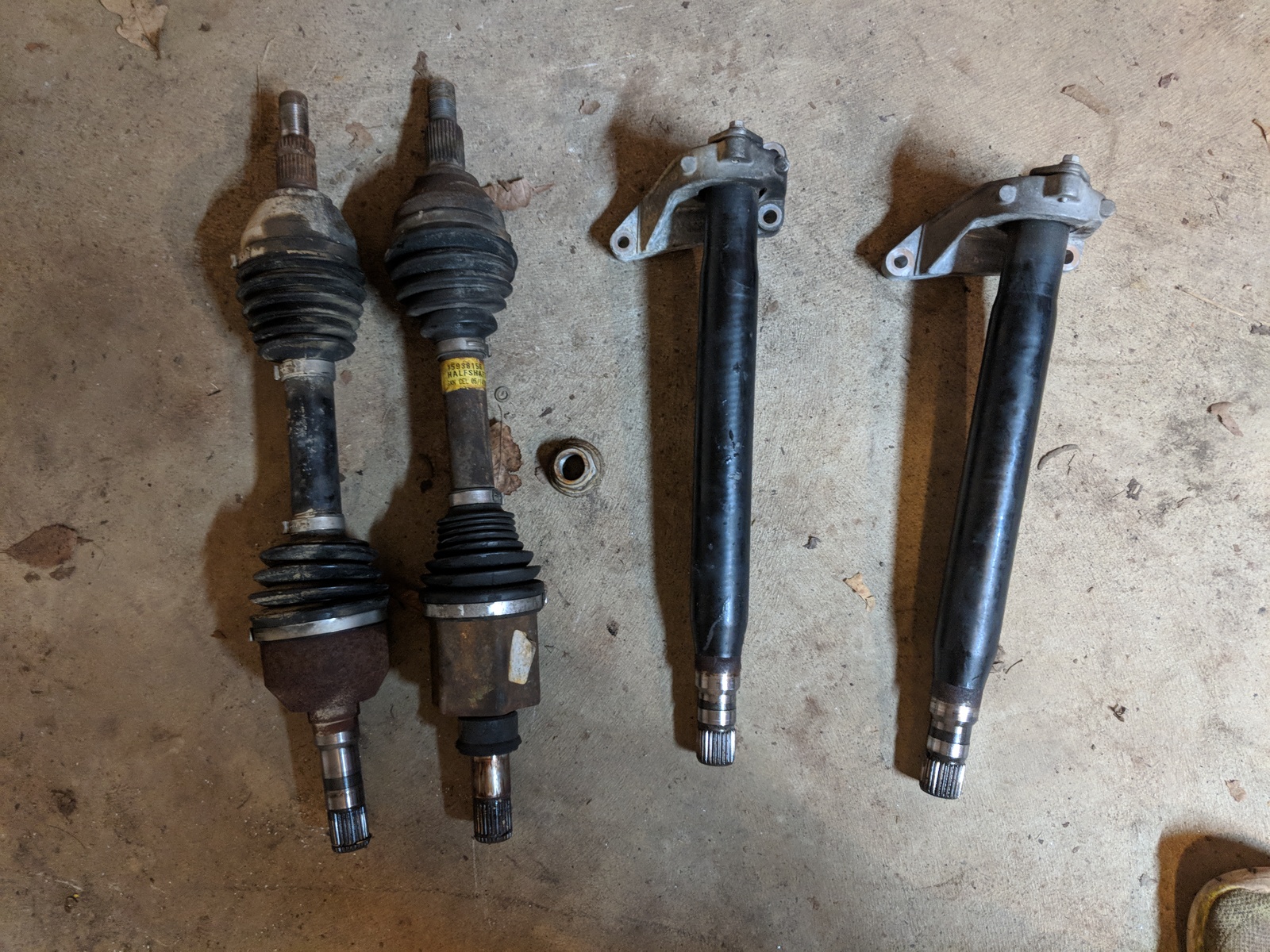

I started comparing a few items from the 9-3 and cobalt SS TC.
The axle extention seems to be the exact same. Splines are identical and length appears the same.
The axles on the 9-3 may be ever so slightly smaller but they look very close I will compress both fully and have someone else measure.
Cobalt axles feel heavier but that may just be my imagination.
The 9-3 ones look thicker but I think the middle just has a plastic cover over it.
Cobalt right 9-3 left

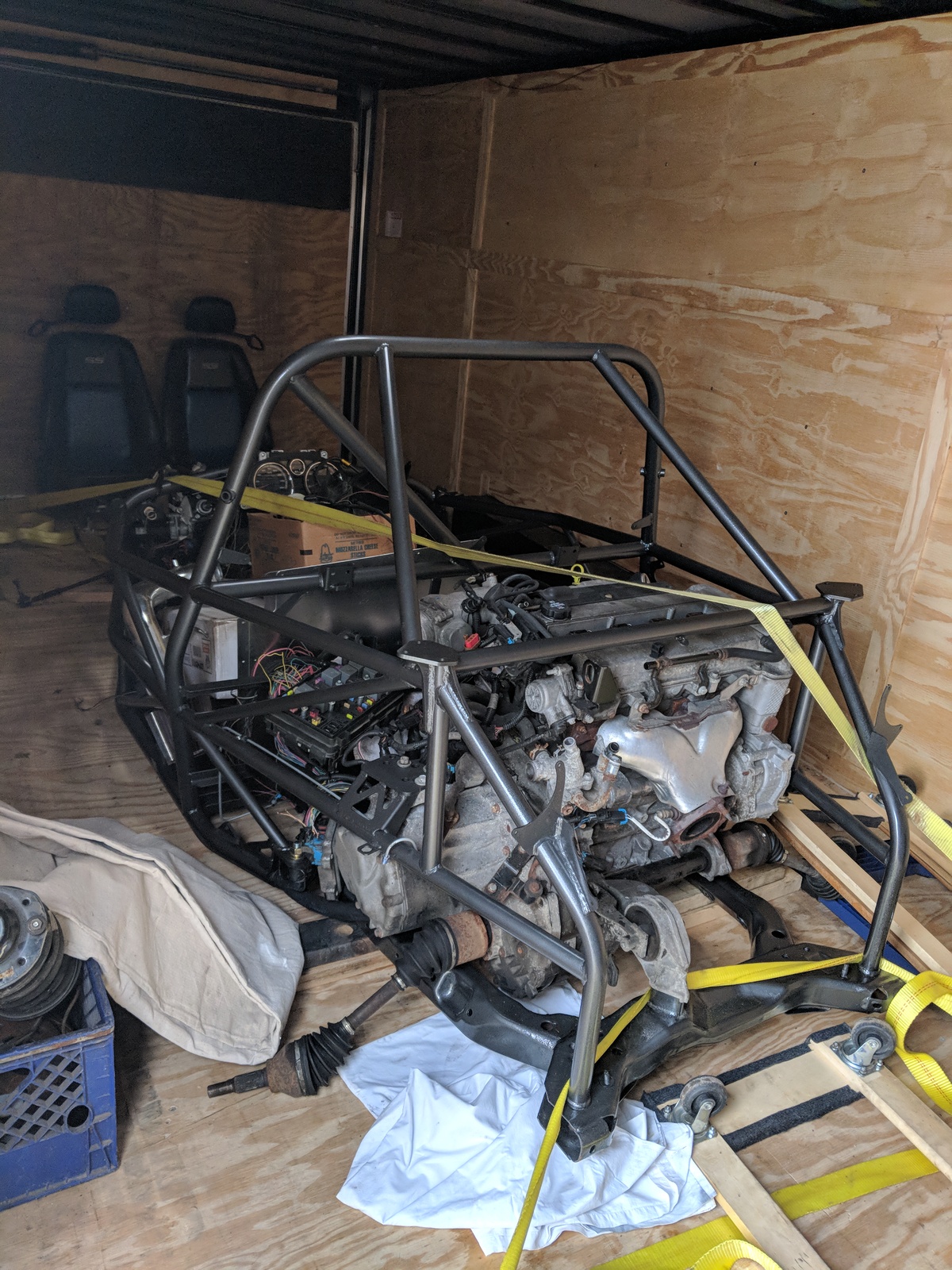

Well it was a long weekend of driving but I made it down to Red Oak and back this weekend.
I left work at noon Friday and grabbed the truck and trailer.
I left my house with a few friends who helped keep company and split up the driving.
We managed to get stuck in traffic in Cincinnati, Louisville, and Nashville but after that all went smooth.
It was great to meet Lonny and Adam and see where everything is built.
Getting to ride in the goblin made me even more excited to get everything done once I finish up a few other projects that should be complete here soon.
I stopped by my parents on the way back to visit in Nashville which was nice to visit and it broke up the drive. I also grabbed some furniture from them while I had the trailer with me.

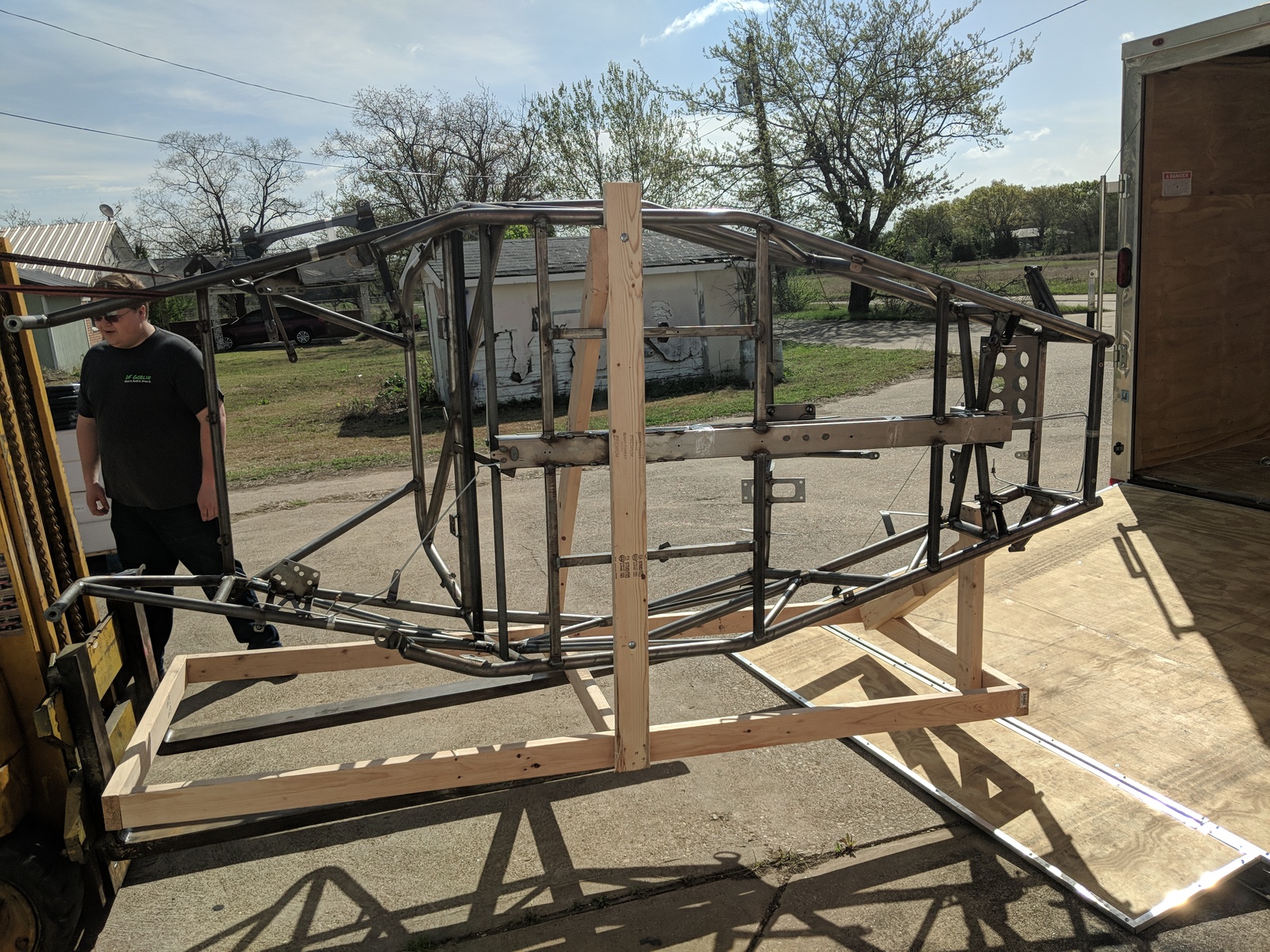

Now some pictures!

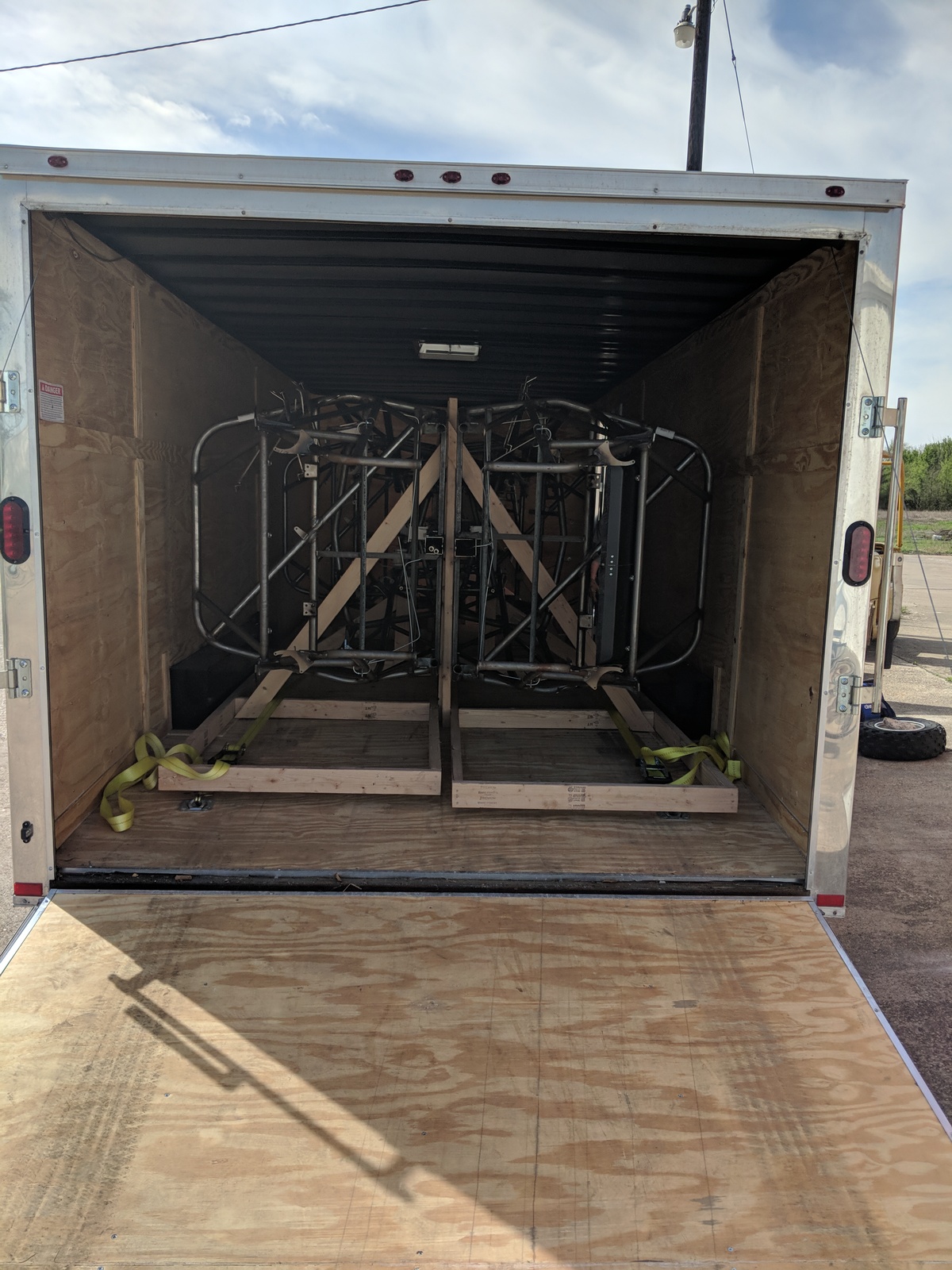

It's hard to see but 4 frames fit perfectly in the trailer

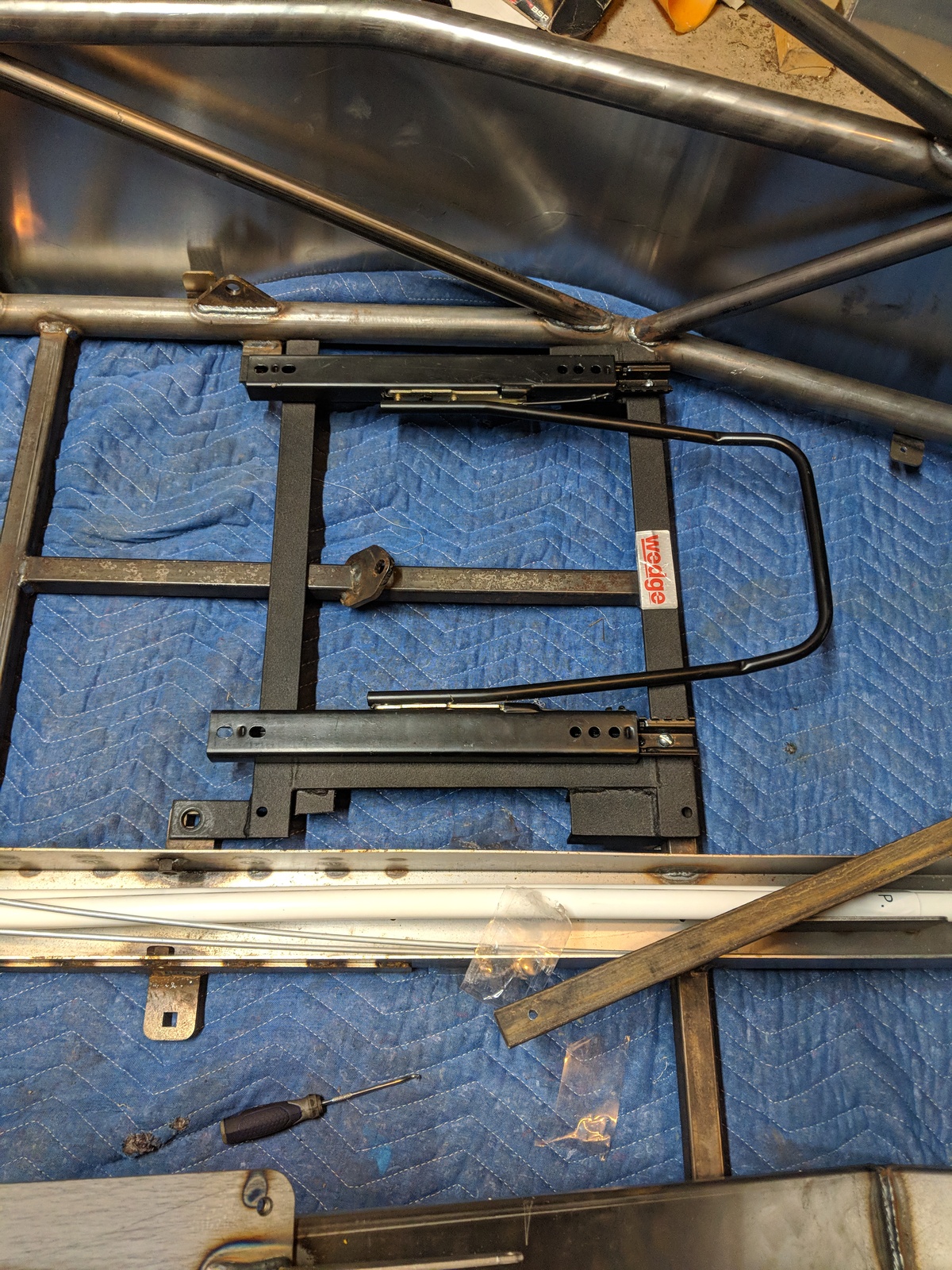

Finally got a little bit done.
I had initially planned on using the stock sliders which I may still do for the passenger seat but I picked up a nice slider for the driver's side.
I trimmed the front left a tiny bit and had to cut the support that goes to the trans tunnel but other than that it bolted right in

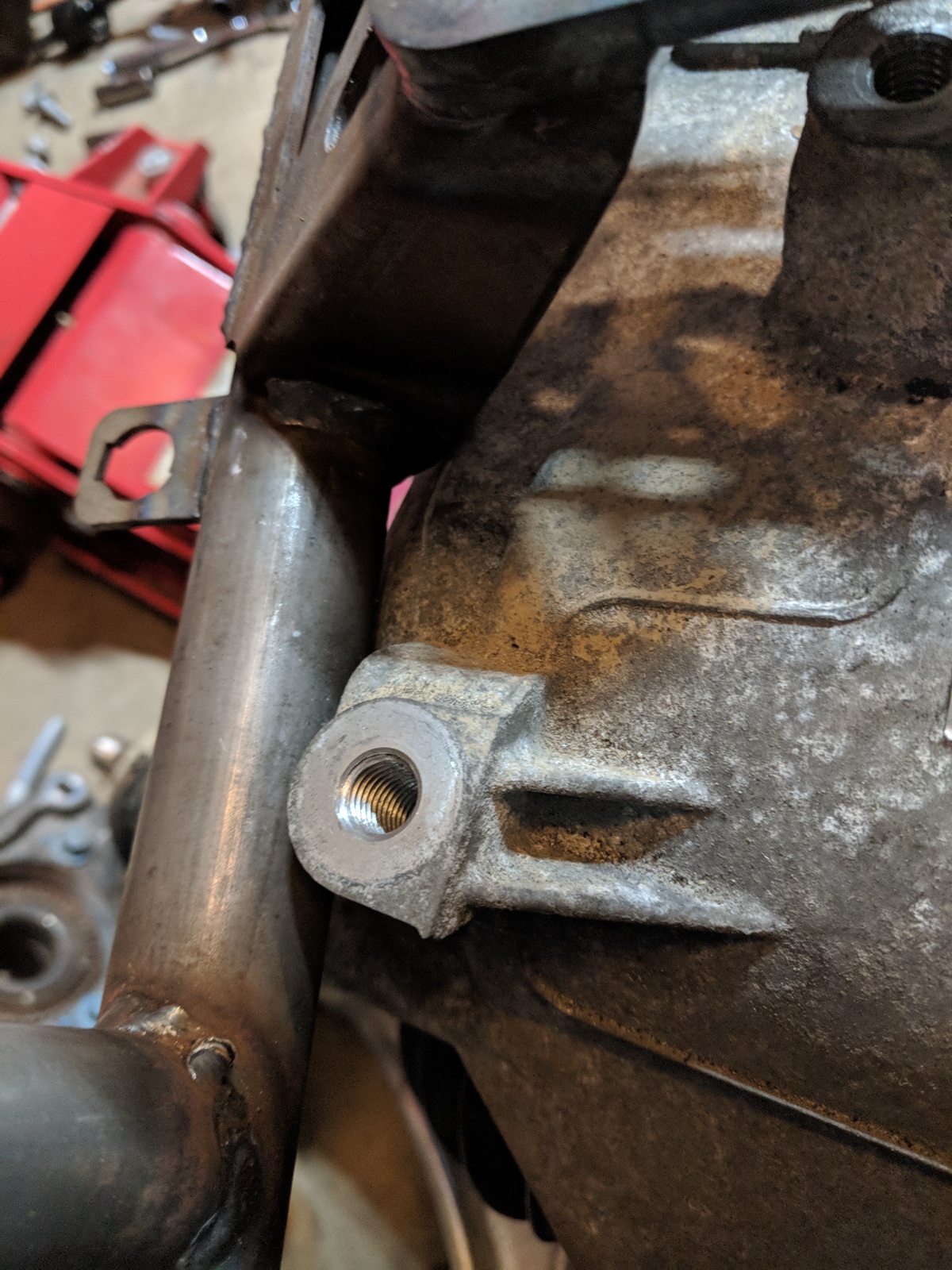

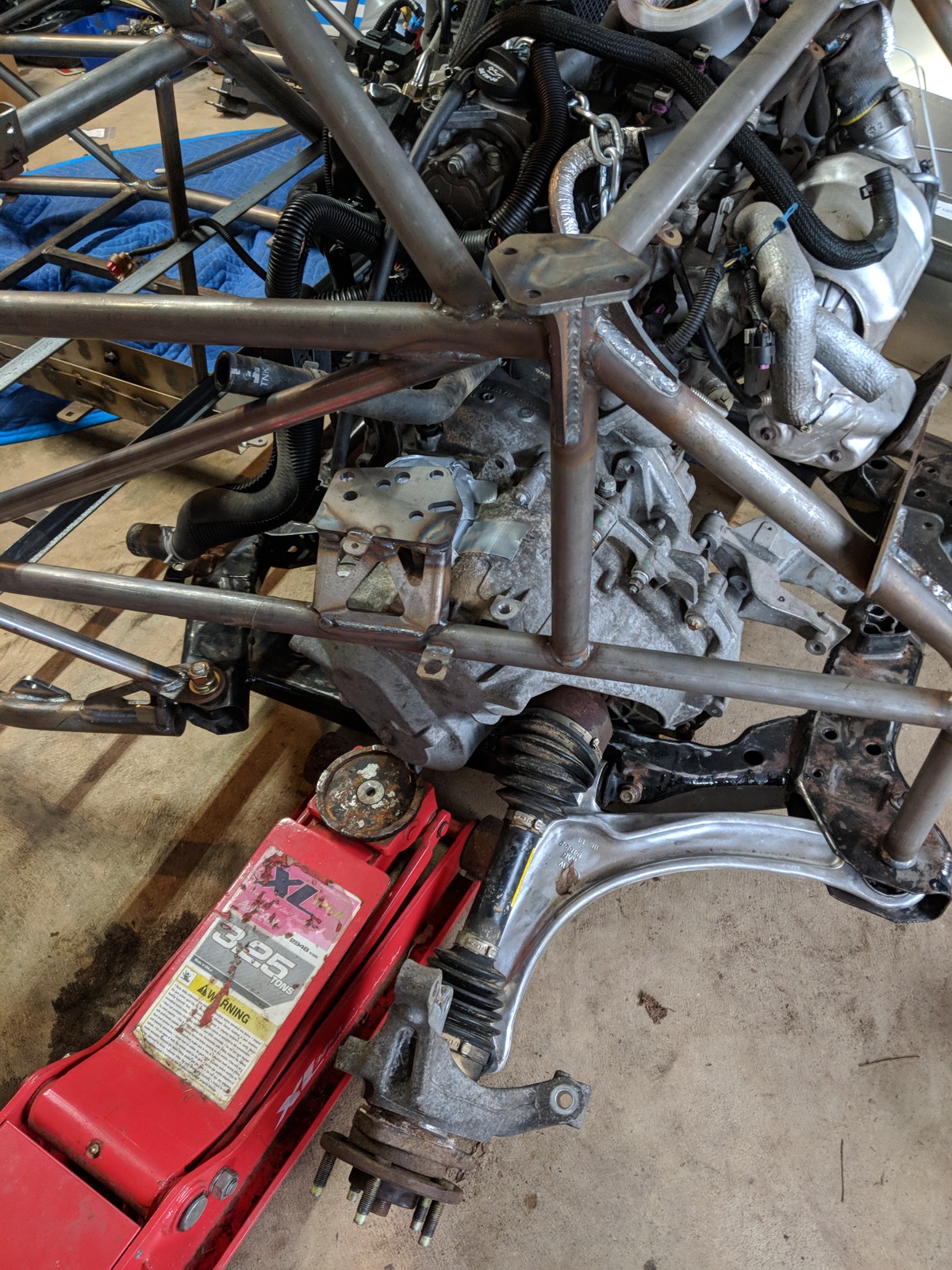

I hooked up the six speed and started mocking overthing up. It is going to be very tight. I was hoping to be able to use the mount they had on there but it looks like I will probably have to cut it off and weld on my own.
It is very tight between the trans and frame so I still need to do some work to make sure I can get everything where it needs to be
I will take a few more pictures later to show how tight it is in there

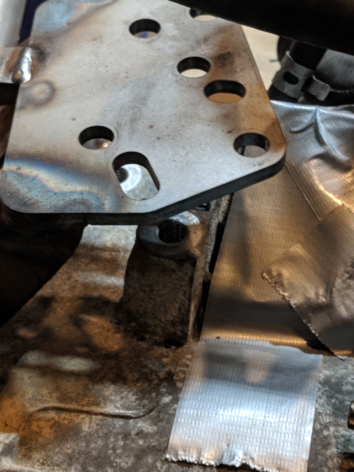

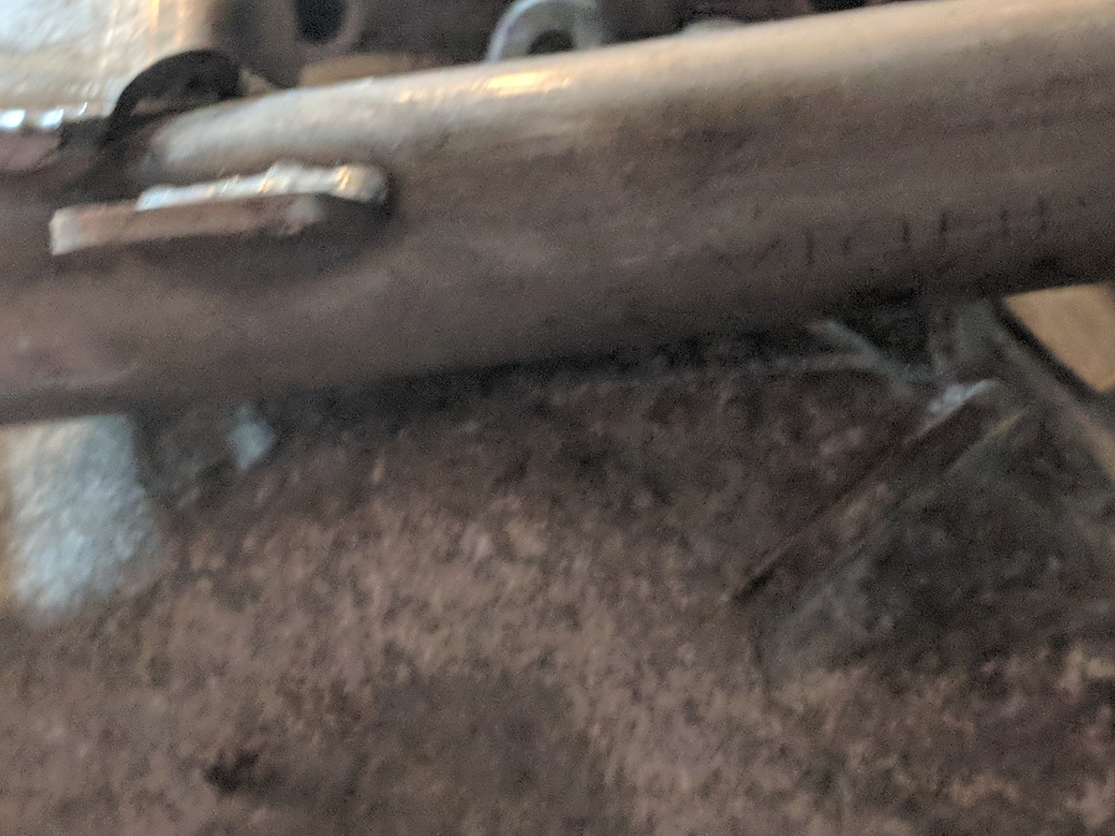

A few more pictures of how tight the F40 is in the frame
Where I have tape is where the shift shaft enters the trans. It interferes with the existing trans mount

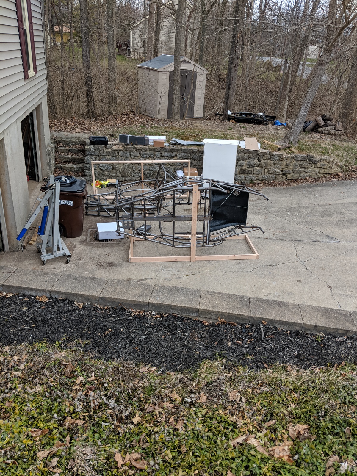

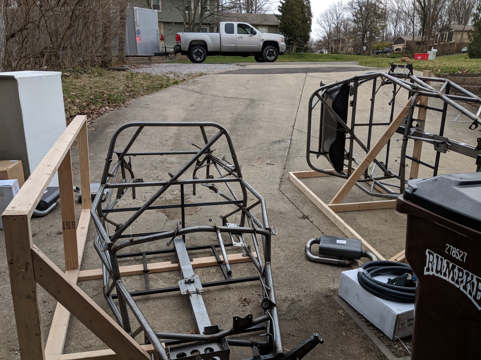

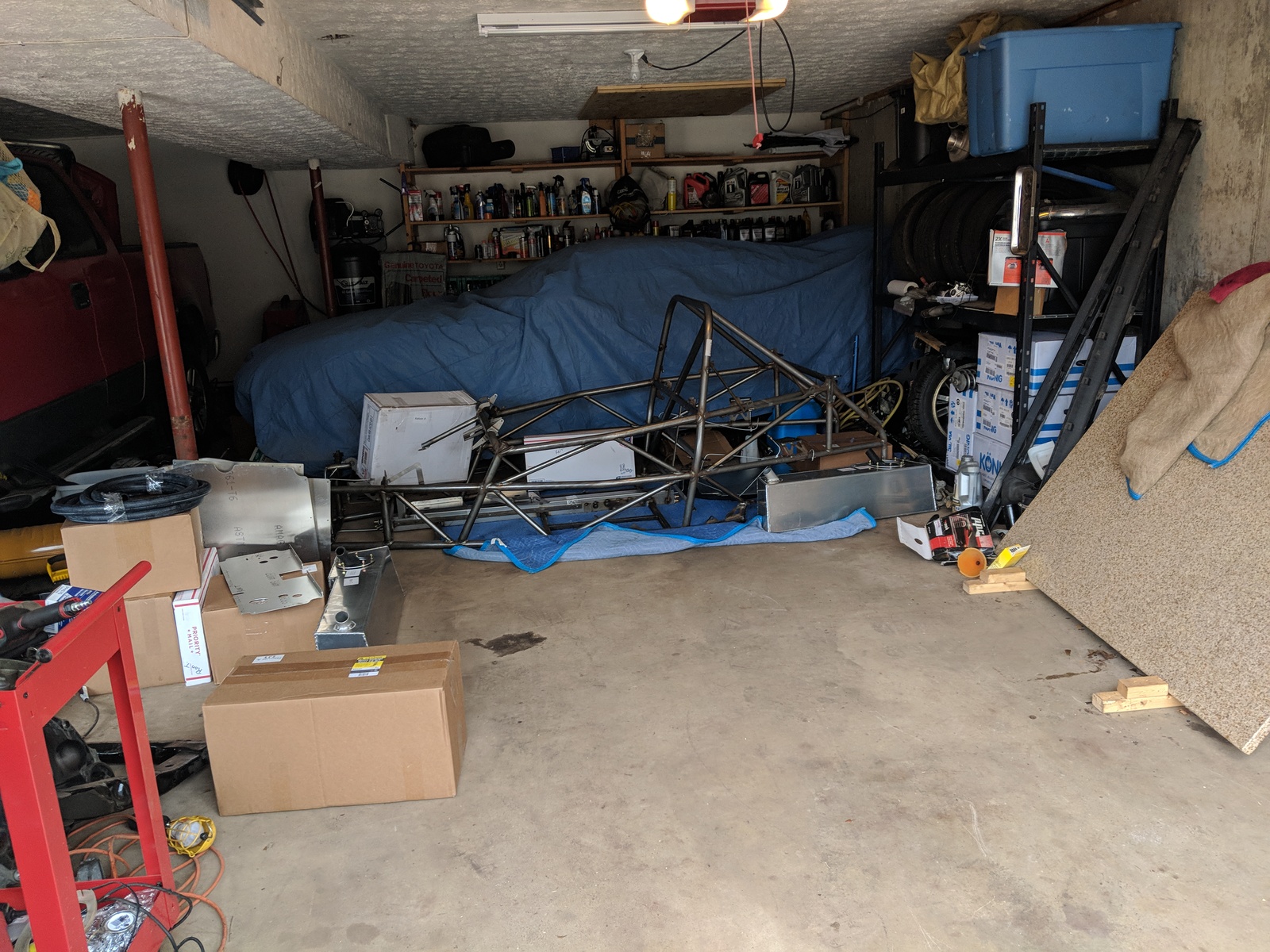

No progress on my goblin this weekend except I did find a powder coater I am going to use.
I did however go pick up my a goblin frame with my father in law this weekend.
After seeing mine he decided to build one rather than picking up a new motorcycle.
We had planned on going to Akron to pick up a donor but stumbled upon Allyn selling his frame and drivetrain.
