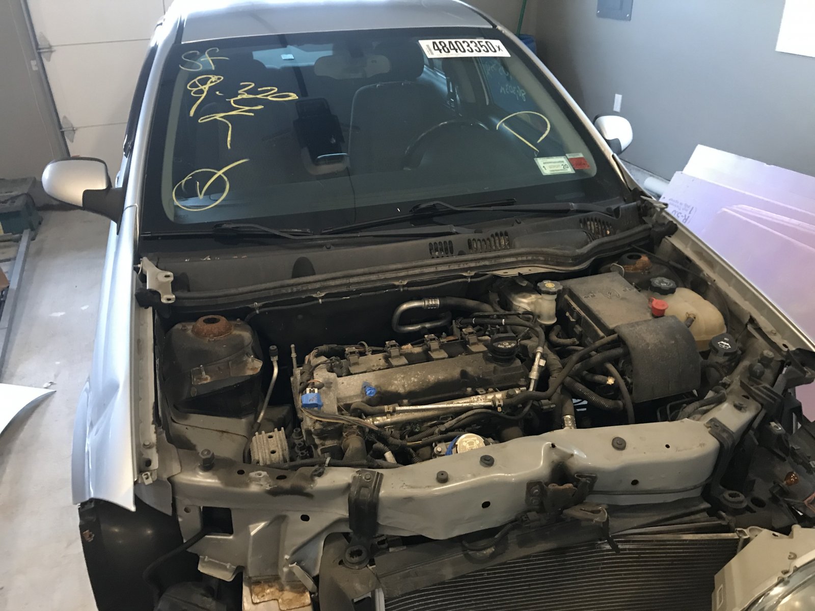

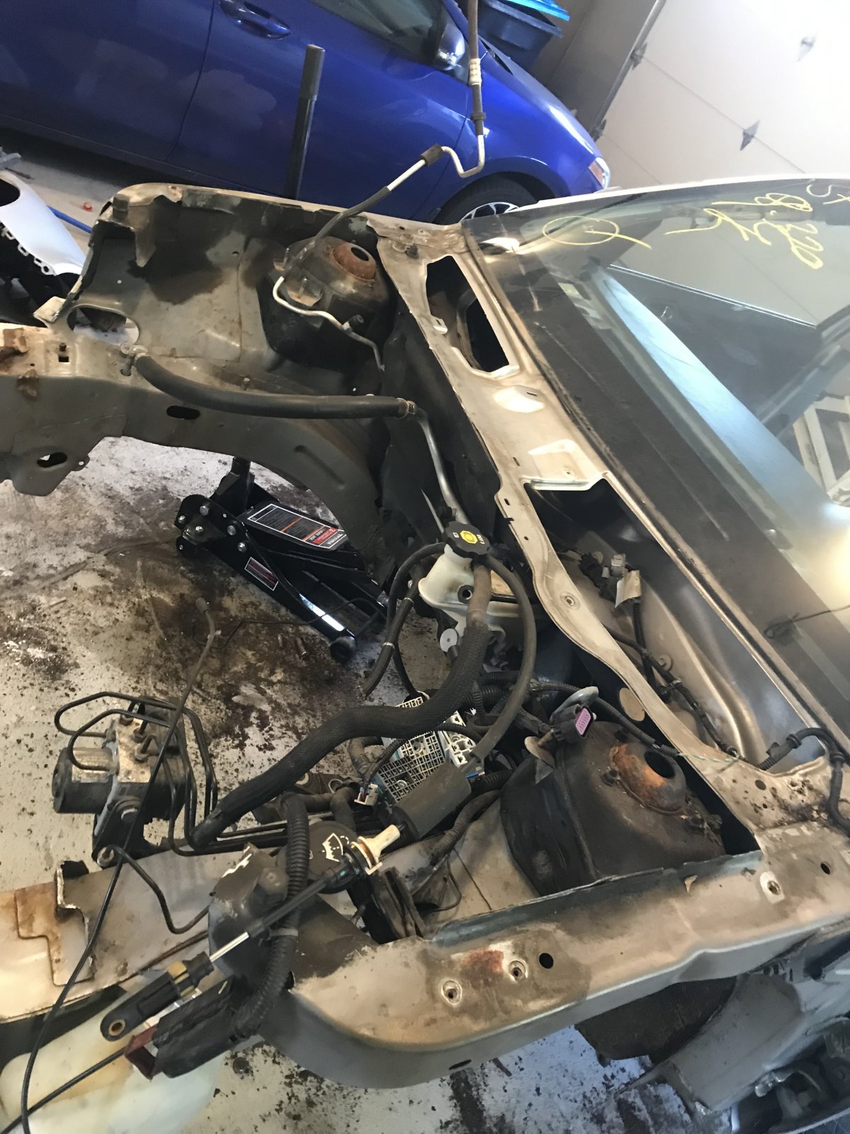

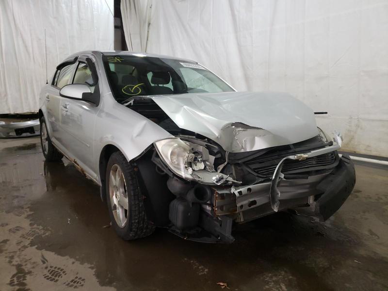

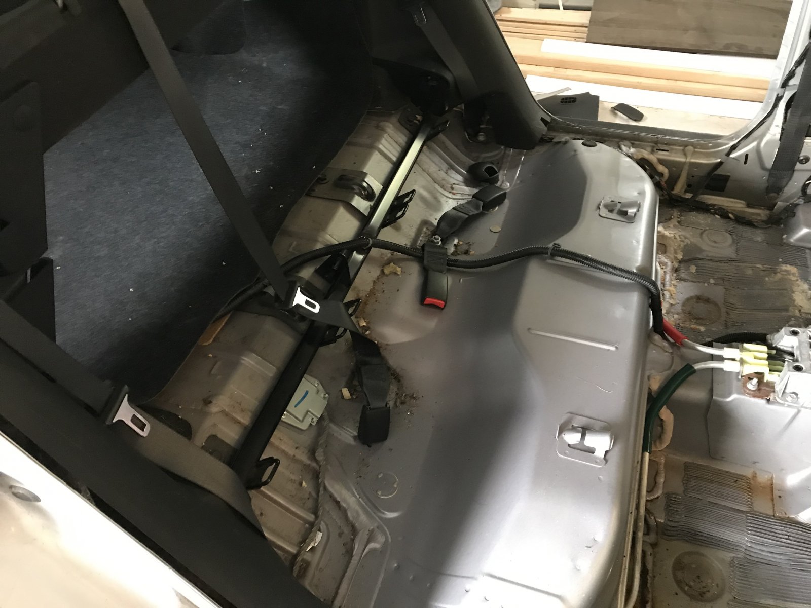

I received my kit this morning, so I thought I would start my build log. I purchased a 2010 NA automatic Cobalt this past October, and the kit early November. I have very little mechanically knowledge, but I decided to undertake the challenge of building a kit car. Already I have enjoyed the experience and learned quite a bit about the inner workings of a car. I'm looking forward to the assembly of the kit. I will starting working on it tomorrow.
The donor is already dismantled. Almost every bolt was a challenge. But a good impact wrench did the trick. I'm not sure what else to mention about the donor. Also, I sent in my wiring harness because I didn't want to deal with the headaches. My wiring harness came back to me with kit so I can get to work right away.
