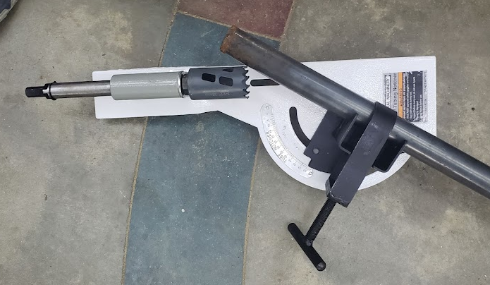

Wasn't long ago I notched my seat belt bar. A lot cheaper than a tube bender.
Sometimes I wish I hadn't powder coated my frame for this exact reason. I have a notcher and welder and have some minor rollbar work on another race car but I just can't bring myself to start grinding off the powder coating.
k.rollin
Sometimes I wish I hadn't powder coated my frame for this exact reason. I have a notcher and welder and have some some minor rollbar work on another race car but I just can't bring myself to start grinding off the powder coating.
I used the color matched aerosol on my temporary harness bar, and while it's not perfect (not as much pearl in it), I think it's good enough that I'd consider coping tubes and welding in a bar like Ross did.

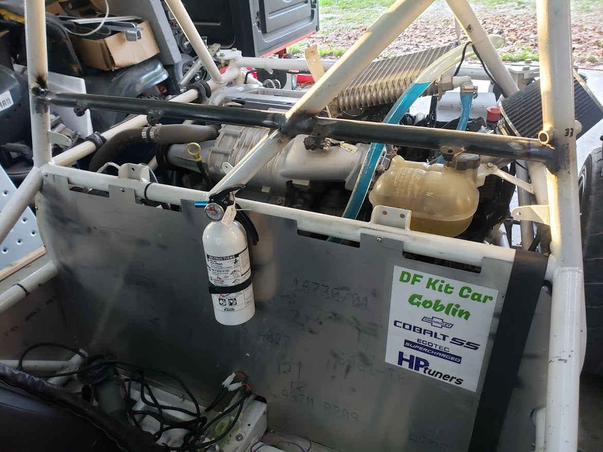

Welded it in

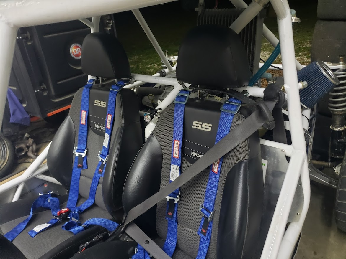

Mounted the seatbelts

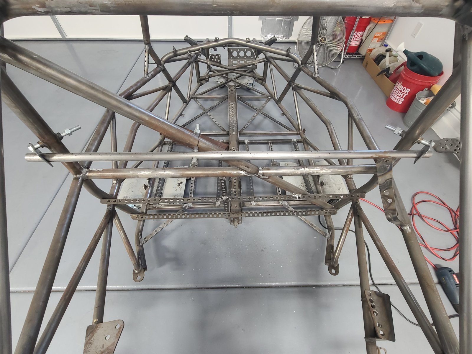

Mocked up the harness bar so far. Still needs welding, the correct bolts installed, and some final shaping/finshing. BTW, the harness bar will be closer to the B-piller uprights than is shown once the depth on the center bolt is adjusted - it won't be gapped the 1/2 inch shown in the photo.
