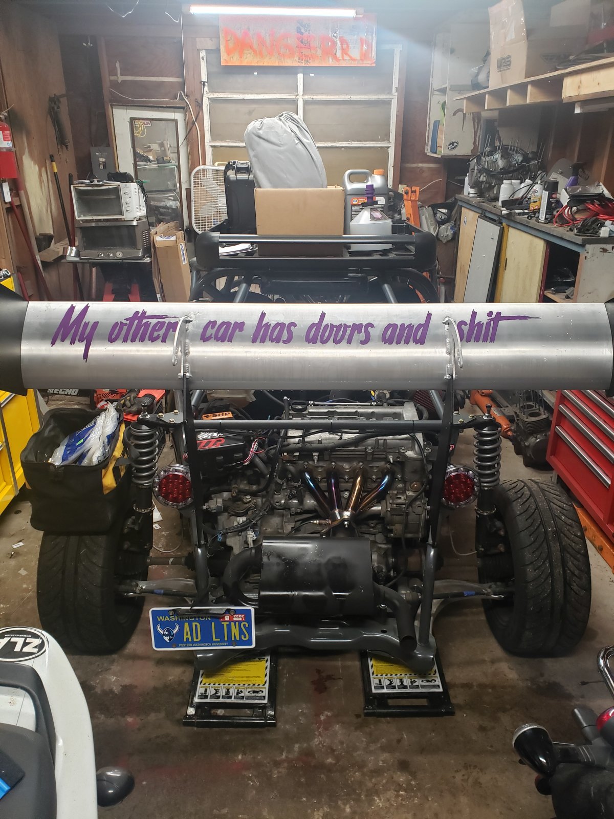

Added some vinyl to the underside of my wáng today

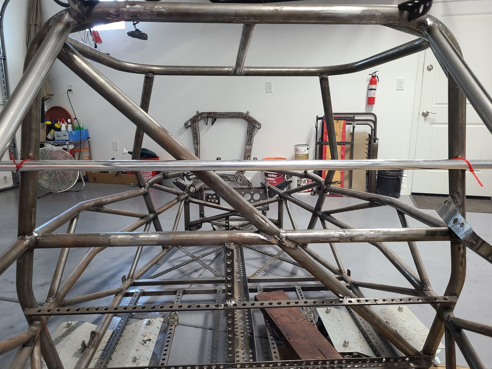

Can you send me photo or two of the bolt in harness bar? I'm thinking of fabricating one myself - I have plates fabbed and am almost ready to cut tube.

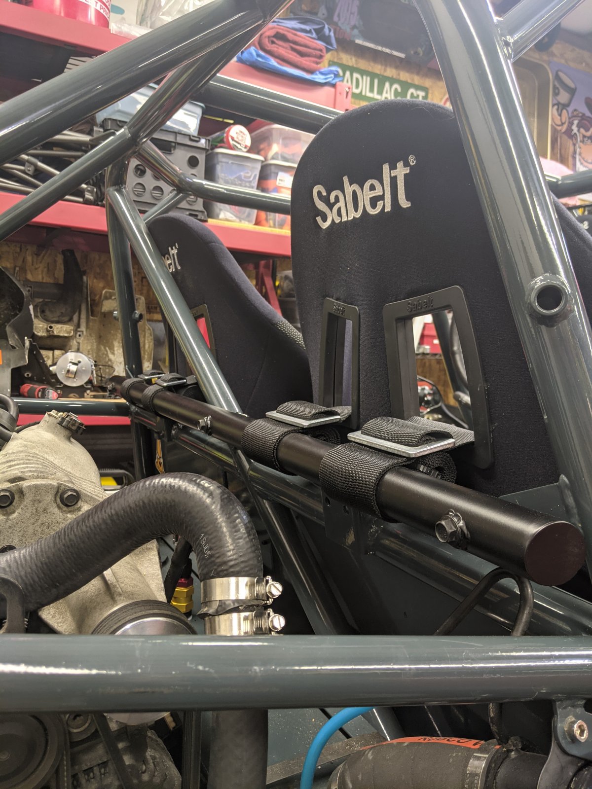

Interested to see how you did your seat back brace. Can you share a pic when you can?
Sure, I'll post some after work today. Like I said, it's temporary/not ideal. As your chassis is uncoated AFAIK, if I were in your position, I would mock up my seats to establish the necessary height then just cope a couple pieces of tube and weld them in such that they're in the same plane as the main hoop.
My final solution is to use a couple of 1.5" OD tube clamps and bend a piece of tube at the ends such that the weldment can bolt in above the coolant surge tank and behind the main hoop.
I'll post some after work. I basically just notched the plate to fit around the brackets on the provided harness bar, secured them to the bar with coated U-bolts, and ran (4) M8 bolts through the back of the seat and into the brace. The driver's side brace was also trimmed shorter to eliminate interference between it and the coolant surge tank.
The Cobalt seat belt bolt hole mounts in the B-pillar/roll bar are by default the correct height and have necessary strength to bolt a harness bar into. One additional bolt hole - same as the stock mounts with a reinforcement tube welded in - in the diagonal bar behind the driver's seat is where I planned to mount the harness bar.
Mock up with a scrap piece.
I was planning a 1 inch DOM tube (0.083) for the bar with 3/16 plates for the stock seat belt bolt locations. The plates will be thru-drilled to have the tube thru the hole and exposed on both sides of the plate for a double weld. The center bolt in the crossbar will be a welded reinforcement tube like the other thru holes. Using all grade 10 bolts with large reinforcement washers.
I would have to believe this is plenty strong and if it were to bend you have far more serious problems and injuries. o_O
My chassis didn't have bolt sleeves for the shoulder portion of the Cobalt's inertial reel belts, and even if it did, I get the feeling that they would be too high to mount a harness bar with my seats.
Mine is 1.5 OD x .095 W, with .50 OD x .120 W bolt sleeves that I later bored to 5/16 ID. It's mounted to the engine cover tabs, which have had the bolt holes reinforced with doublers on both sides. Grade 8 5/16-18 flange bolts secure the temporary bar to the chassis.
