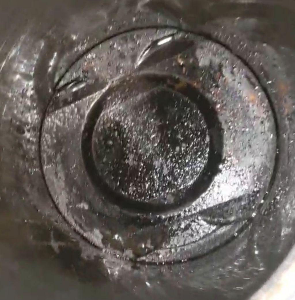

More information. I was talking to my engine guy and I got to thinking about my pistons. I remember them being domed. Thankfully I had a video of the engine from when I disassembled it. Domes AND valve reliefs! So @Cnixon160 you're likely fine with PTV, but now I'm curious if I will be with 10:1 flat tops

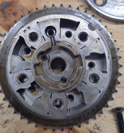

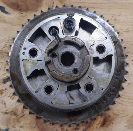

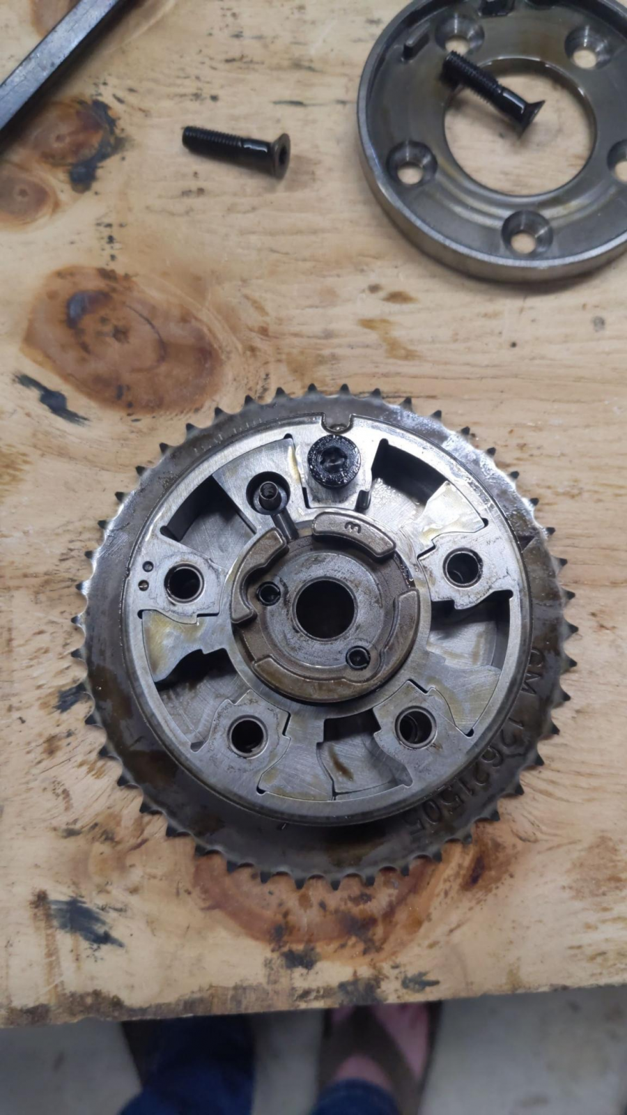

Well, my engine builder won't cut valve reliefs, so I either have to do it myself and bring it back for balancing or just wait til I get it back and check the cam clearance. I just tired to take apart one of the VVT cams and I couldn't quite figure it out. I was able to actuate the "VVT" portion of the cam, but only when I didn't have all the bolts in. Does anyone know how this is supposed to work? What am I missing?

Cnixon160
The small spring plunger piece is what was keeping you from actuating the phasers, it relies on a minimum oil pressure to unlock to avoid an uncontrolled movement, with it removed you should be able to semi easily move the phaser with the faceplate bolted on though for the purpose of measurement I would keep it omitted as the head and bolt will keep everything together and allow you to visualize the travel if interference occurs
