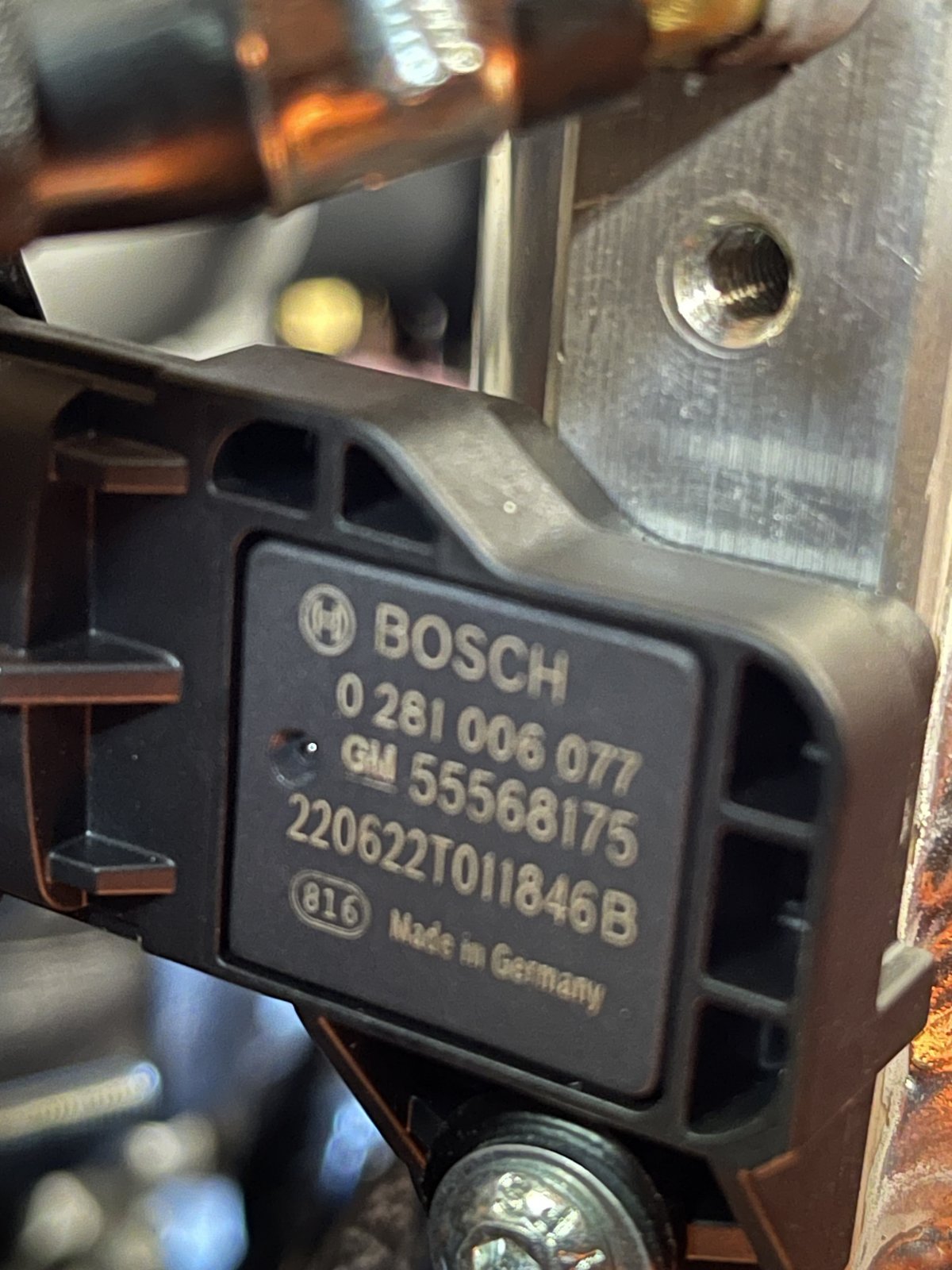

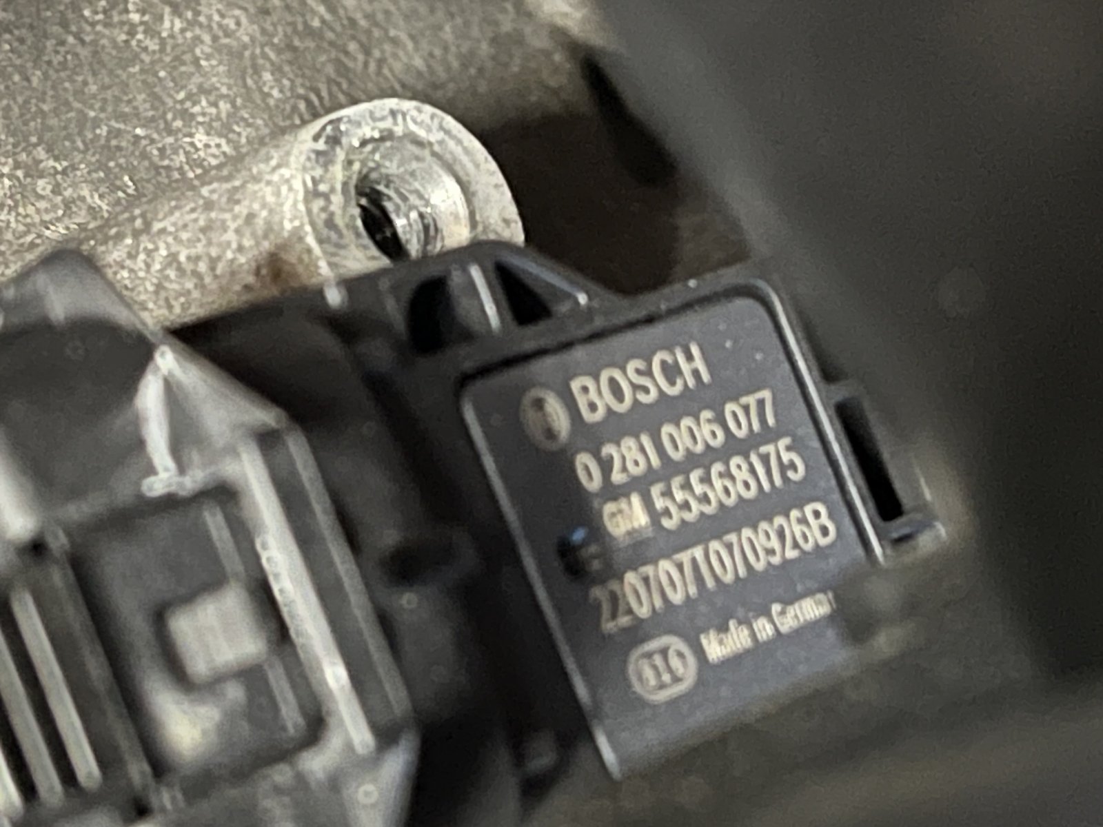

Map sensors that are installed
That cross references to the GM Part number for the GM upgrade kit so the linear offset should be good.
