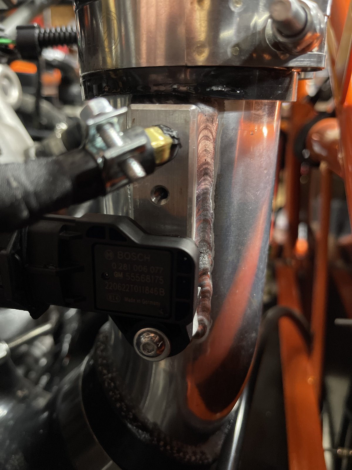

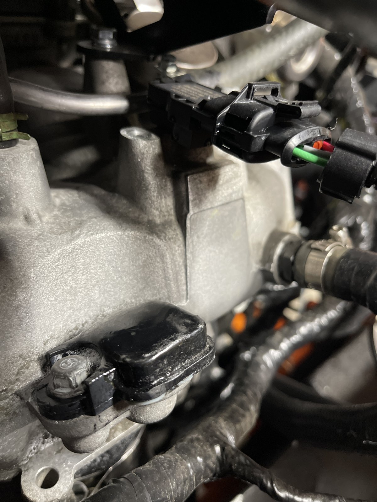

Found a decent leak and a small one, the bolt hole for stock map won’t let the bike pump the system much more then 12 psi before it drops to 0. The plate where the evap solenoid was (was broke I covered with epoxy) has a small bubble

And the hose to the break booster leaked. Fixed and guess I’ll load one of the previous toons and start from there tomorrow
