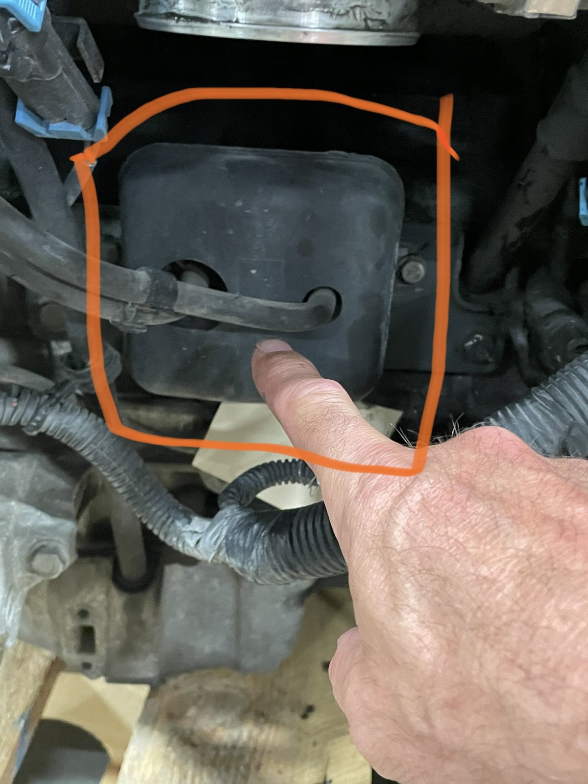

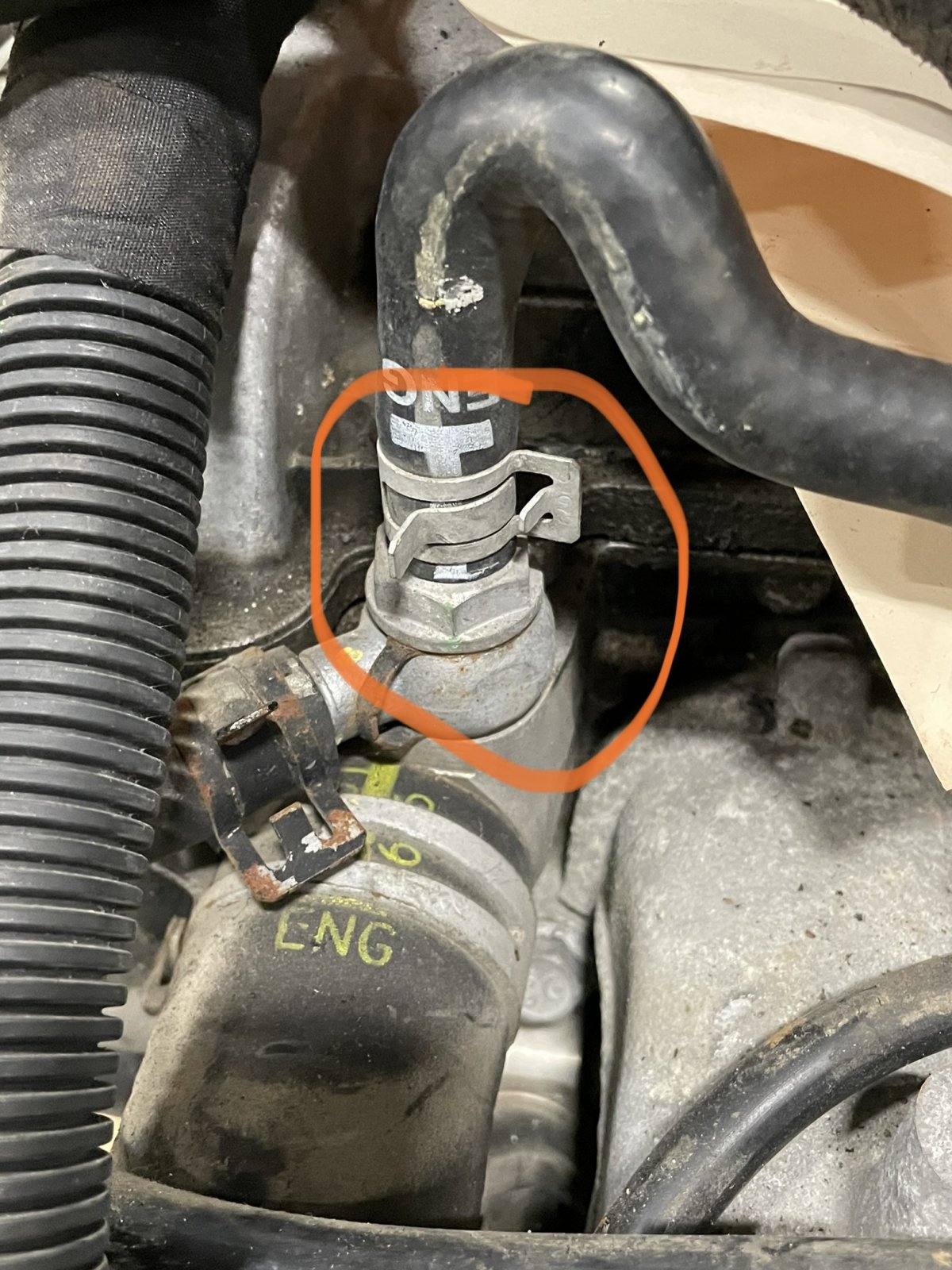

I have installed the new LDK an yes it’s very similar to the LNF with only a few differences.
I’m attaching two pictures an have highlighted my question areas.
Pictures from LNF Donor Engine
1) Did you install the Banjo Bolt - Allows you to run the line to overflow bottle?
2) Black-Box ( possibly emissions ) an do we install it on the LDK?
Thanks in advance!!

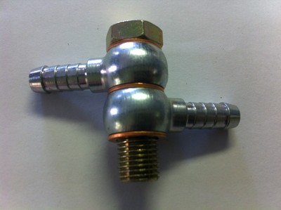

This is what I used on my new LDK to have both lines on the banjo bolt.
Many people according to the cobalt ss forums delete the vacuum reservoir, Personally I'm not running one on my LDK and I spool stupid fast. This thing is scary lol
Nuker-
