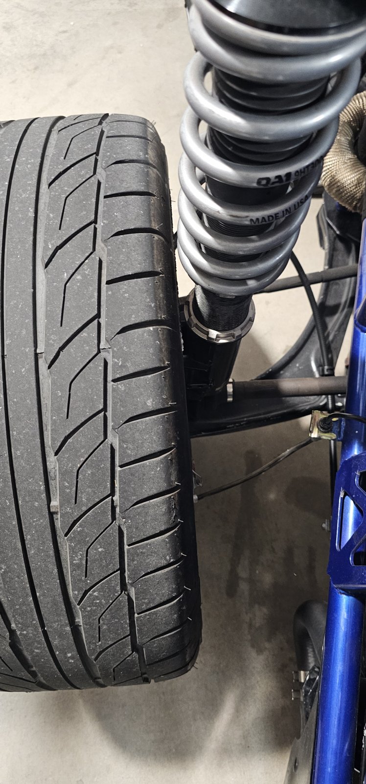

My car has already spacer at the rear axle, otherwise the tires would get in contact with the spring. Currently it works, but I would love to have a larger spacer and/or more thread used.

Why do you want to increase the track width on the rear? As @Gtstorey said the adapter is a better option than spacer!! Adapter plates and spacers may cause wheel bearing to wear out quicker. Moving the rear track width out may cause handling issues with front track being narrower.
