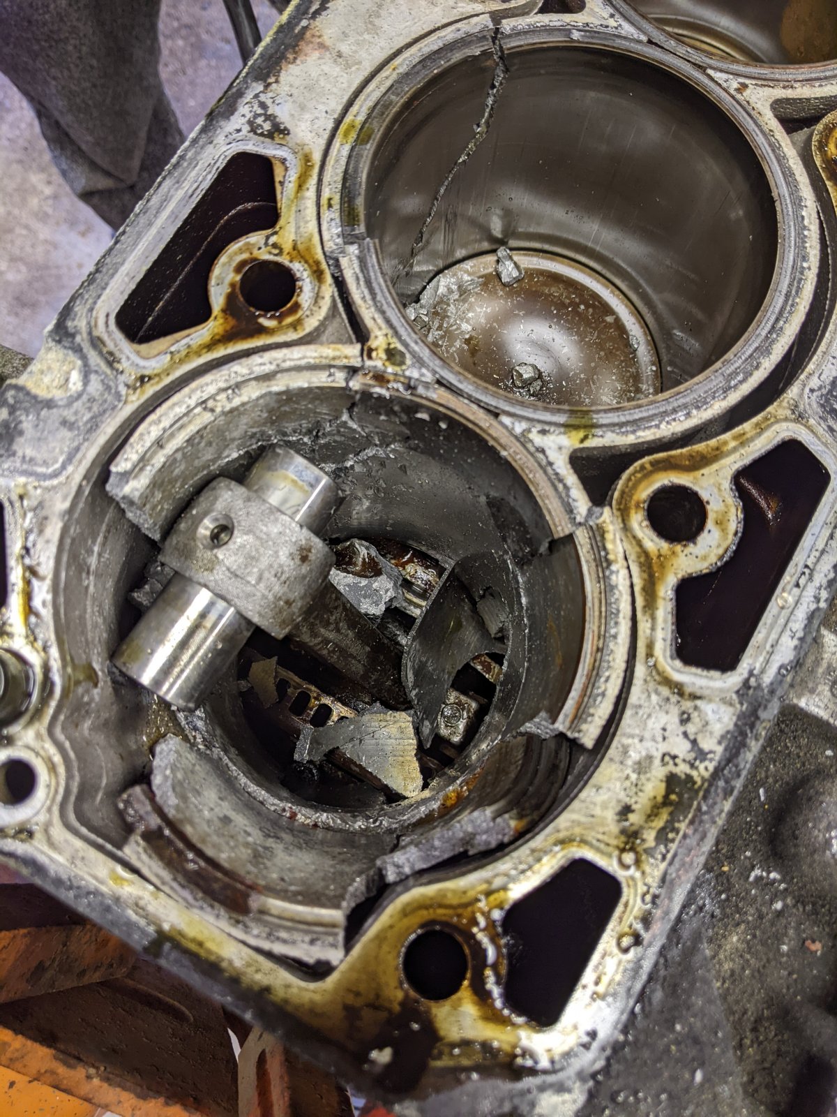

So first, my engine blew up during an autocross which was diagnosed as piston ring gap too tight.
Then I bought a "new(100,000ish miles)" engine locally, we swapped the stiffer valve springs and neutral balance shafts over, put head studs in it, Cometic MLX head gasket, and a new timing chain set in and tossed the engine in the car. Bolted everything back up just how it was when it was running perfectly before it blew up. I think the only part external of the engine we changed was the PCV valve.
