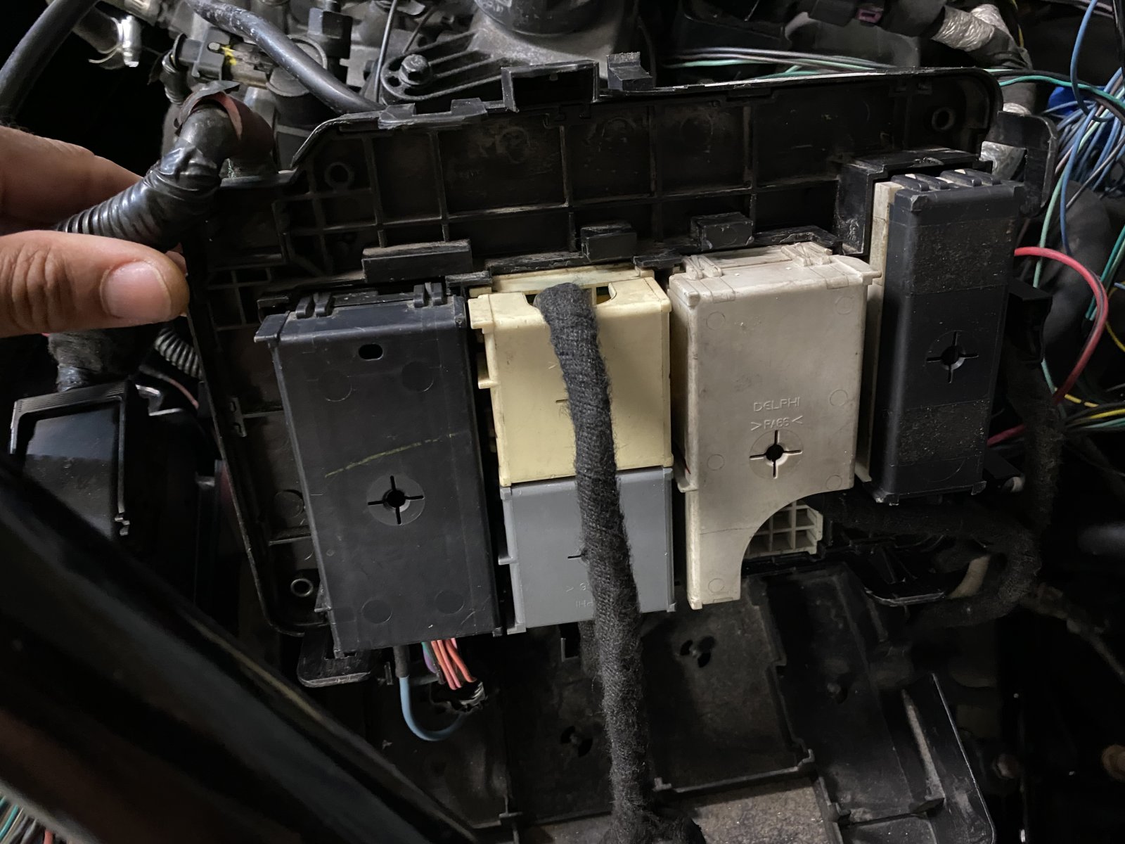

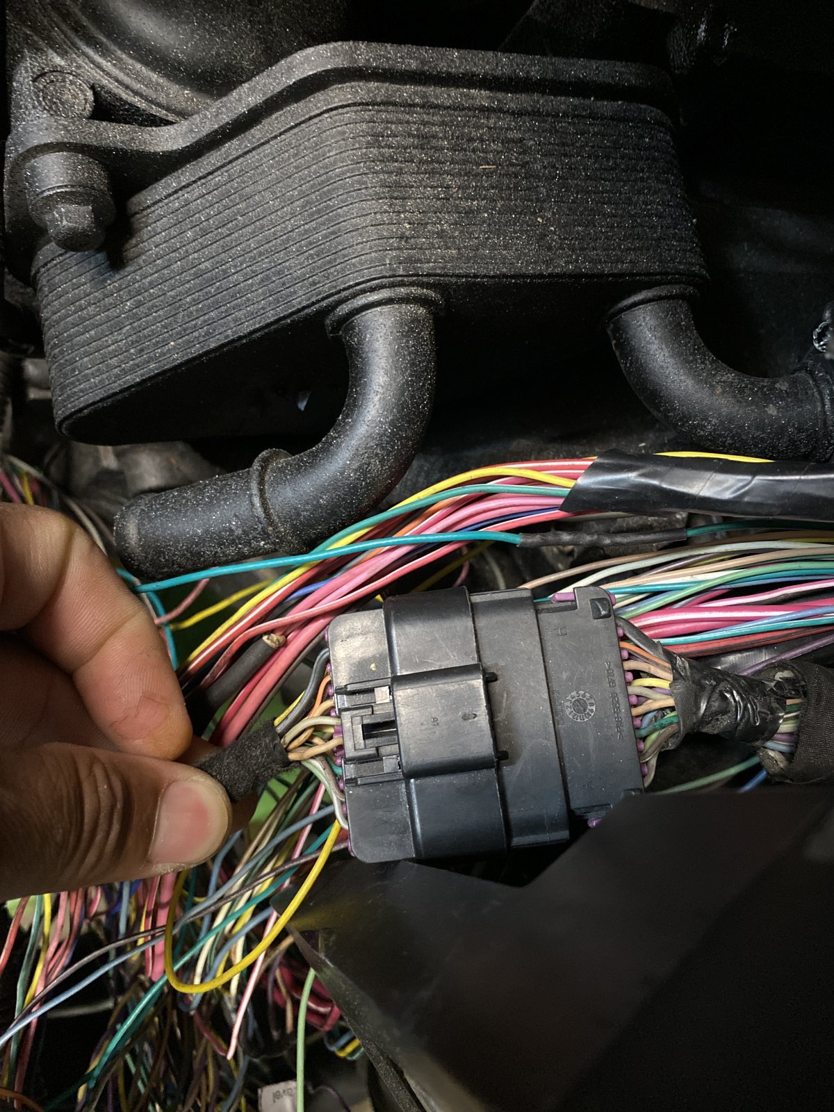

Do you have the body harness to engine harness plugged together? and is it plugged into the correct connector?
I think I do.

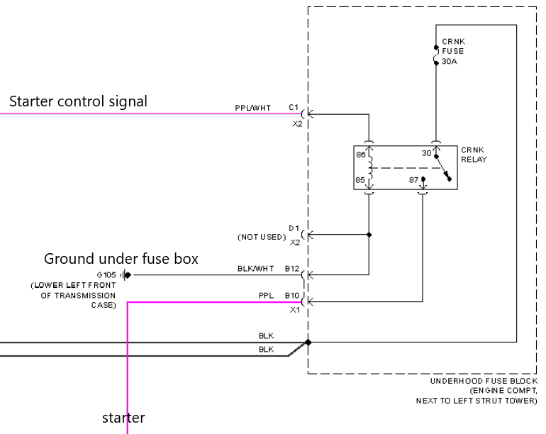

Does anyone know what colors is the wire that does to the fuse box for the starter signal. Really don’t know what else to check at this point.

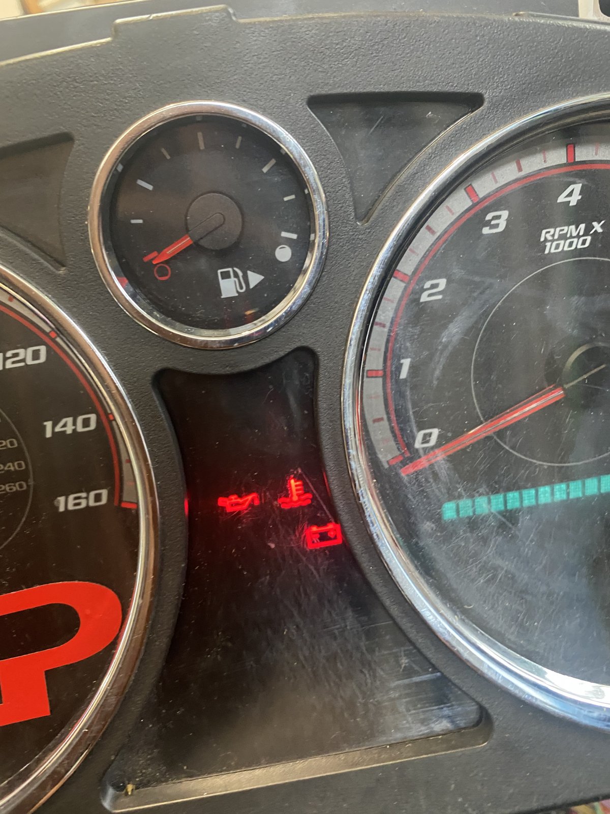

Am honestly starting to think it’s a bad bcm connection or bad bcm. Because this are the only lights that turn on when the key is turn.
