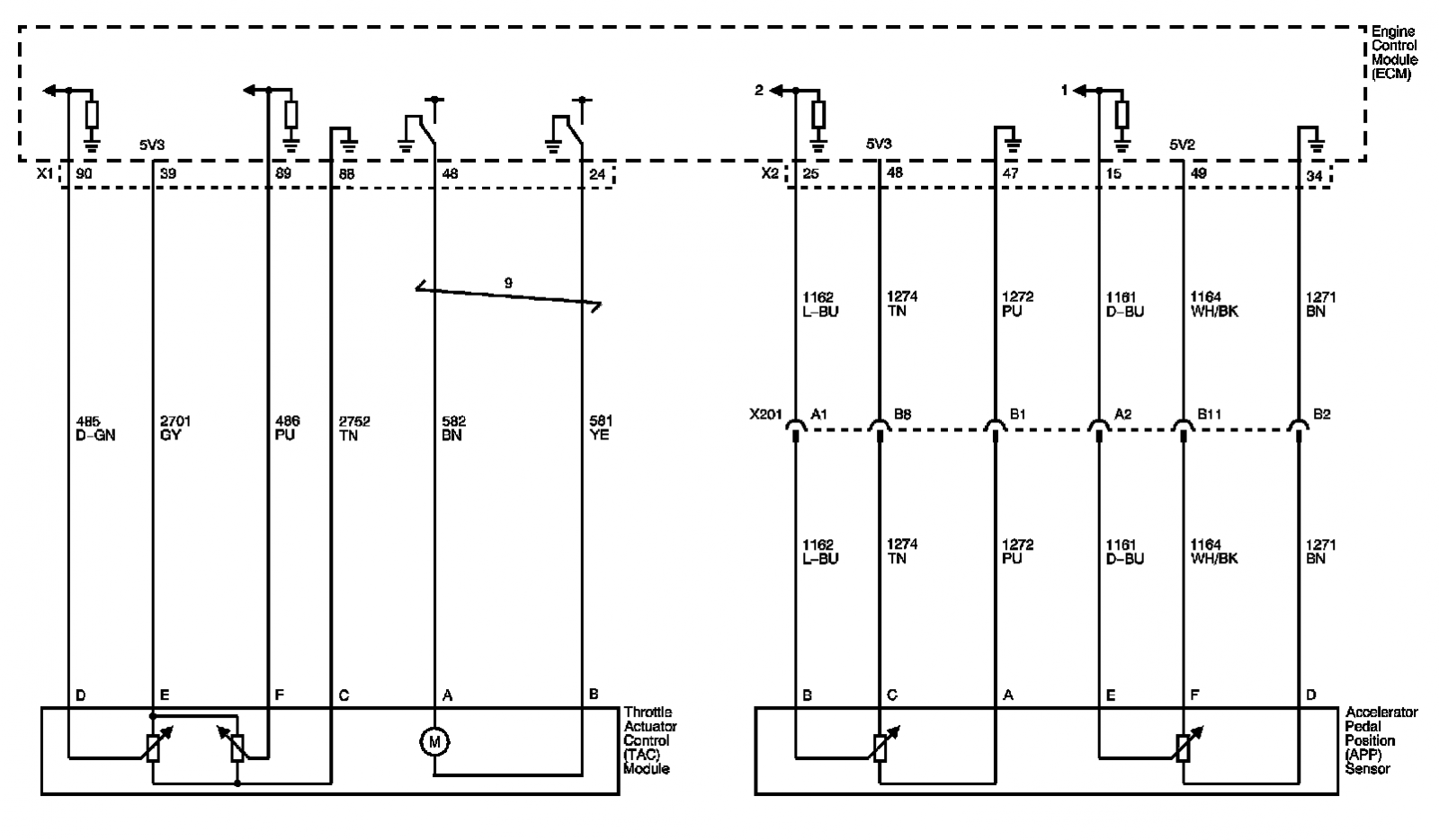

Seems like the TPS/PPS circuit is pretty basic and I cant imagine something is tapped into that.

Could someone post a wiring diagram for the goblin? I am wondering what splicing is/was required and maybe that might help me narrow things down, I looked a bit and couldn't find a wiring diagram as to what changes you make with the goblin.
There isn't a single finished wiring diagram for a Goblin. There are pieces scattered on the forums, but not anything complete. And the pieces can vary depending on donor. You have to take a wiring diagram for your original donor and figure it out. For the most part each piece that remains won't change the diagram that much, although a few intermittent connectors may be removed. But the start and stop are in the same locations and usually with the same wire colors. The biggest change is probably the data wires.
