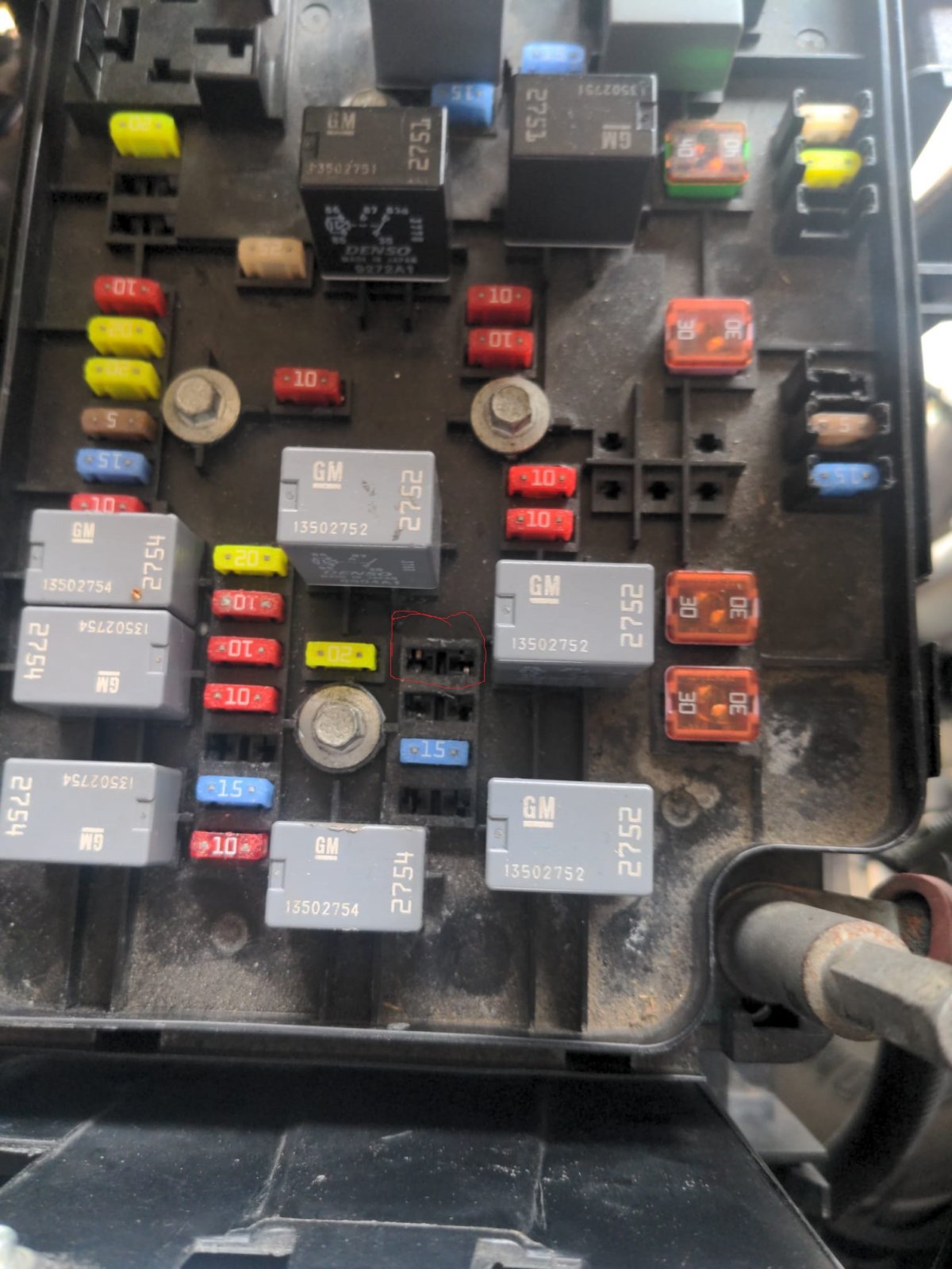

ill have to see when that happens again. Right now the car runs but i have my 10 amp exhaust fused pulled. If i put it in the engine starts but then cuts out fairly soon.
codes i'm getting now P0030 - HO2S Heater Control Circuit – Bank 1 Sensor 1
P0036 - HO2S Heater Control Circuit – Bank 1 Sensor 2
P0102: Mass or Volume Air Flow Circuit Low

When you say starts then cuts out, as in the engine stops running? How much time? Is it different when the engine is cold versus when you are able to get it hot? What happens if you run the engine with the fuse pulled, then install it after the engine is hot? Will it start and run?
Can you cicle the fuse you pulled in the photo and the number and name of the fuse from the fusebox lid?

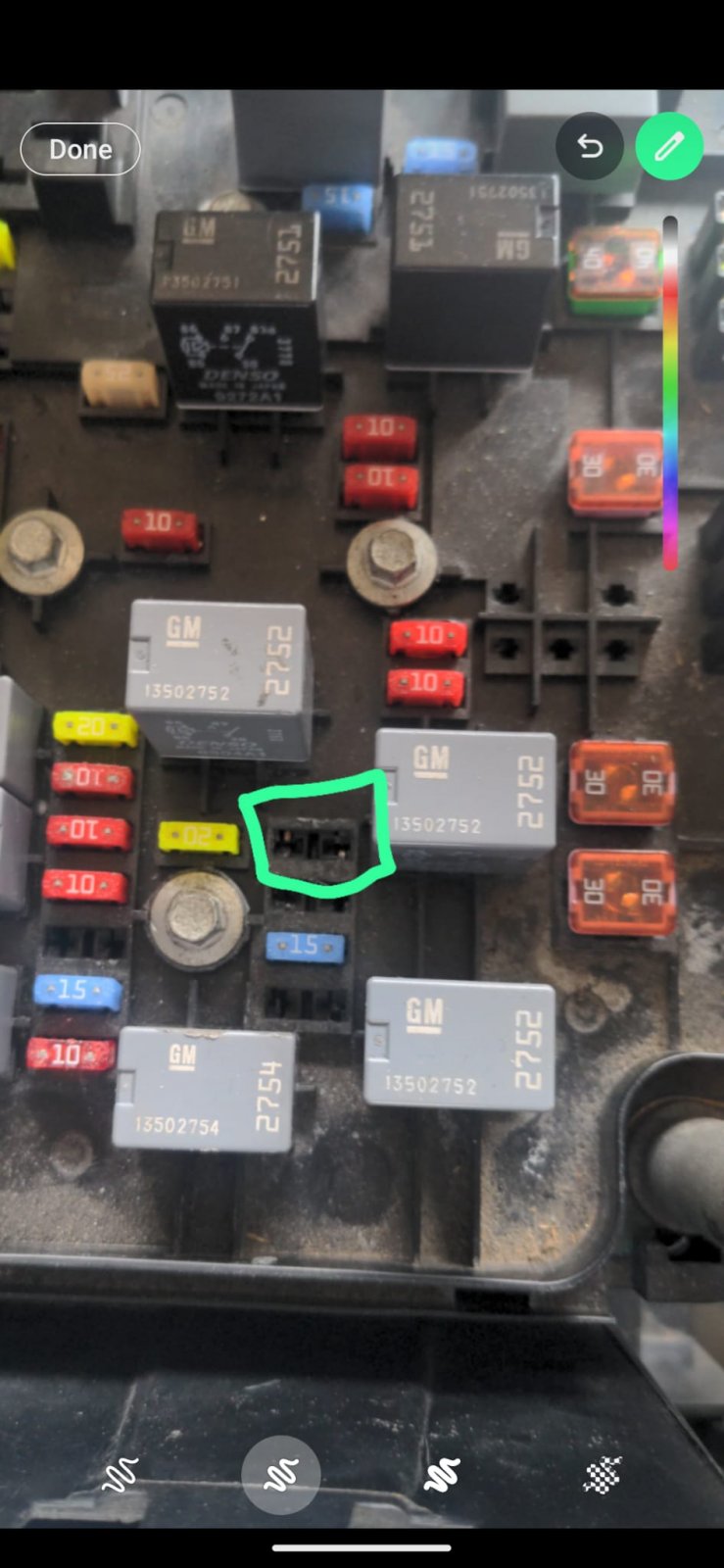

its the 10 amp EXH fuse, Exhaust emissions.

It looks like all three of B1S1 and B1S2 and the MAF are fed ignition voltage through the 10a EXH fuse. See the diagrams linked here and the section immediately below the one linked. My first guess would be that the codes you listed are because of the fuse being pulled, but if the idle clean up after you disconnect the MAF, then perhaps the P0102 diag would be useful at this time. Or maybe a new MAF fixes it all!
