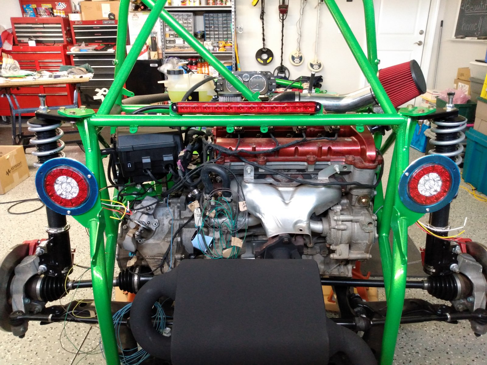

Just an FYI. I got real lucky on this one. I didn't want the hyper-flash turn signals and I didn't want to cut into my nice wiring harness to add resistors. I stumbled across a fix that worked for me. I previously ordered a third brake light that has a sequential flash for the turn signals. I thought it looked neat and added some safety for a small car. While checking on wiring this today, I had the third brake light wired along with the turn signals. This gave me a slow flash but no sequential turn indication. I removed the third brake light wire and WOW. No fast turn signals AND sequential! Also the third brake light works. No hyper-flash and no resistors (and no cutting of the wiring harness). Now my car does not have cruise control so you're on your own on that one. I'll post the amazon link for the light. Let me know if anyone has any questions.
