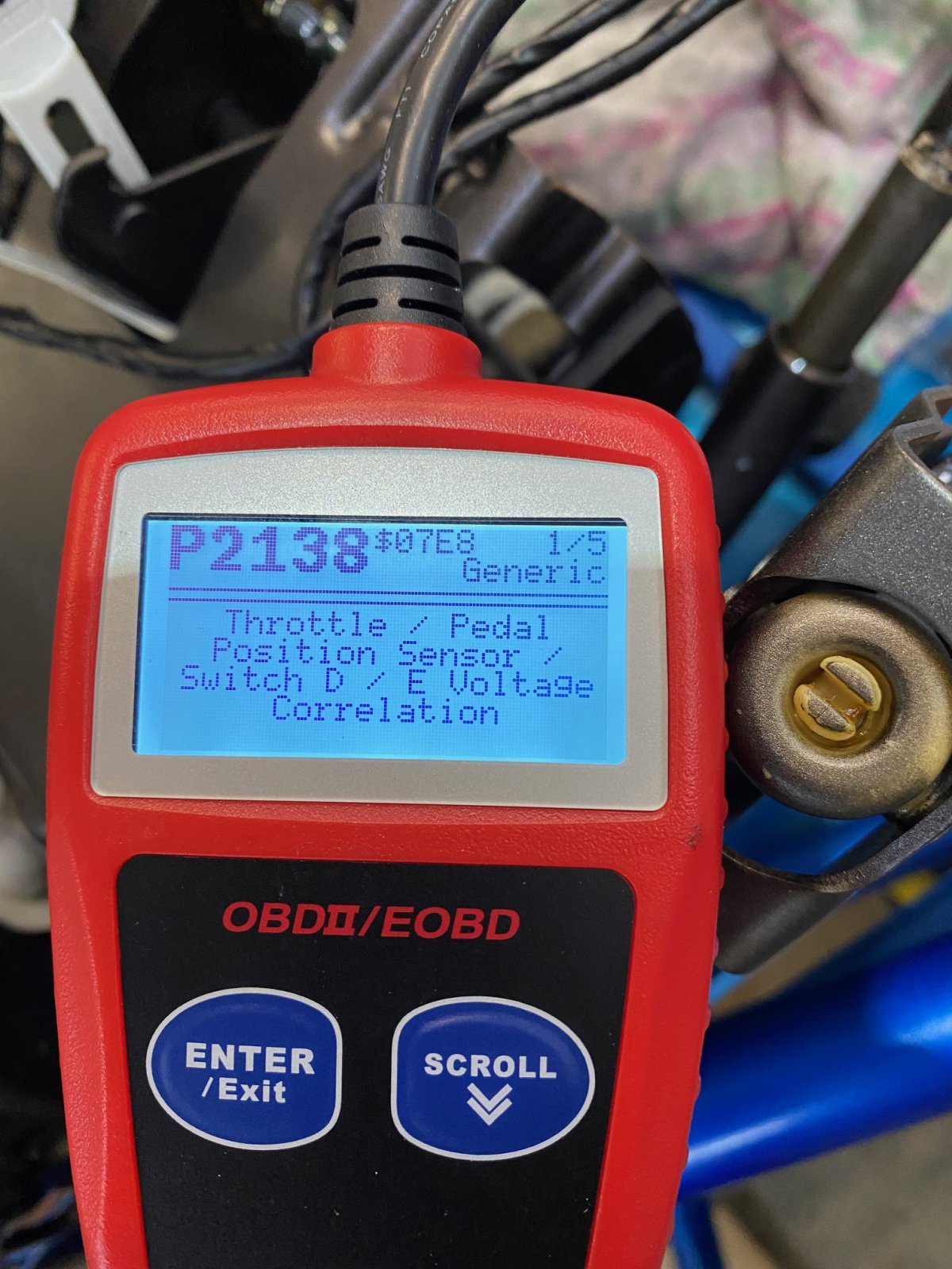

Problem: Hooked up the rear tail lights and side mirror turn signals yesterday according to what I found on the forum here and the engine began running rough - misfiring. The accelerator pedal would not function (ie. pushing the accelerator did nothing). Got a code (attached) which said: "P2138 $07E8 -- Throttle/Pedal Position Sensor/Switch D/E Voltage Correlation."
I unhooked all the light connections and restarted the engine. Ran fine. Deleted the above code. Ran another scan. No codes. I did order some resistors from Amazon (not delivered yet) just in case anyone advises me to place them somewhere. When it comes to electricity I just follow the directions - am clueless otherwise.
