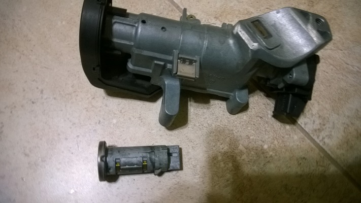

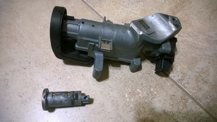

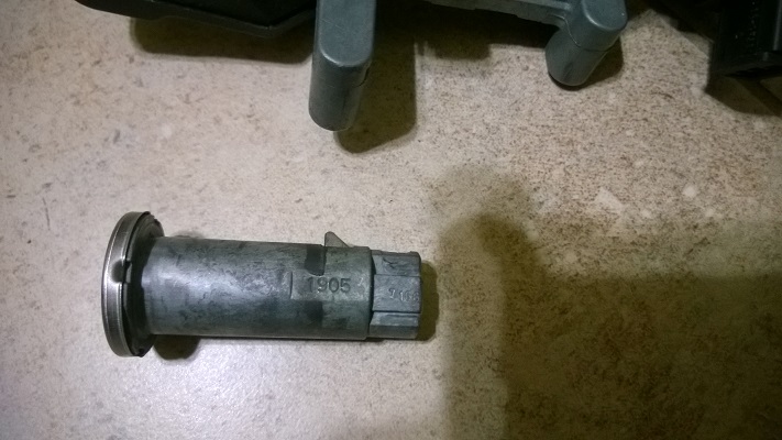

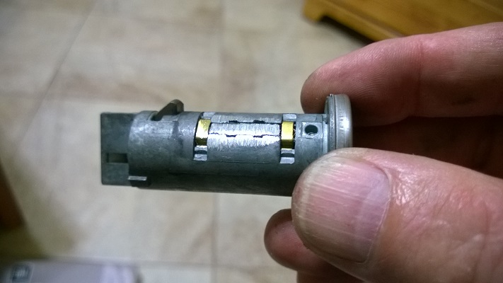

Lonny and Adam had a couple of steering column ignition switches without keys. You can buy uncut keys from multiple places. The car can be programmed to accept the code in a key - but what about getting the key to mechanically turn the ignition?
There are 3 different types of cylinders. The one shown in the pictures is called the "first design".
In looking through the service manual there is a description of how to remove the tumbler from the lock. The tumbler has a code on it that I imagine to be the mechanical key code.
To remove the tumbler I put a blank key in the switch and turned the key to run (up against the start spring). Then I put a pick into the hole in the switch casing nearest the key and pressed it down. There is a spring pawl on the tumbler itself that you are pressing down. The tumbler then pops right out.
After reading the instructions on how to key a cylinder the new cylinder is keyed with a final step of crimping some clips - essentially having to buy a new cylinder.
If you would just like to get your car running with a lost key you can grind off the little bar on the side of the tumbler cylinder essentially making any key work mechanically (even a screwdriver). The car will not start unless you program the key.
Sorry Lonny and Adam, you now have a universal steering column lock!!!

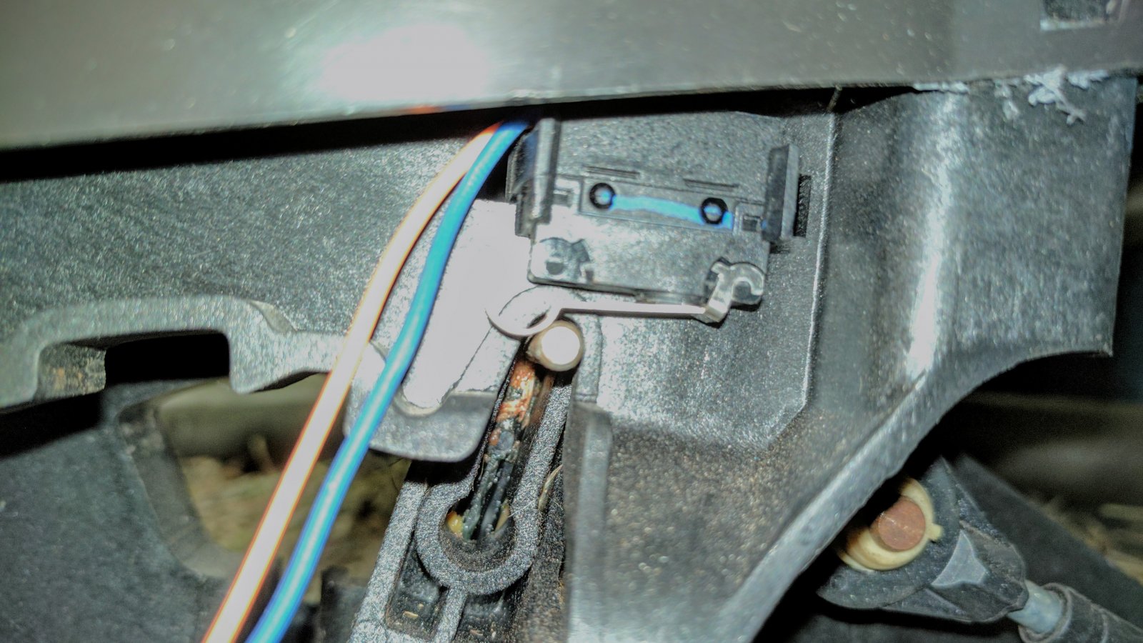

It is strange that you have to manually unlock the ignition switch to remove the key. That should happen automatically when the gear selector is in park and the button is released. Is there any chance the custom shifter knob you've got isn't letting the button come up enough to trigger the limit switch on the passenger side of the shifter?
If the switch is being triggered properly, check the black wire that goes to the car to see if it is grounded.

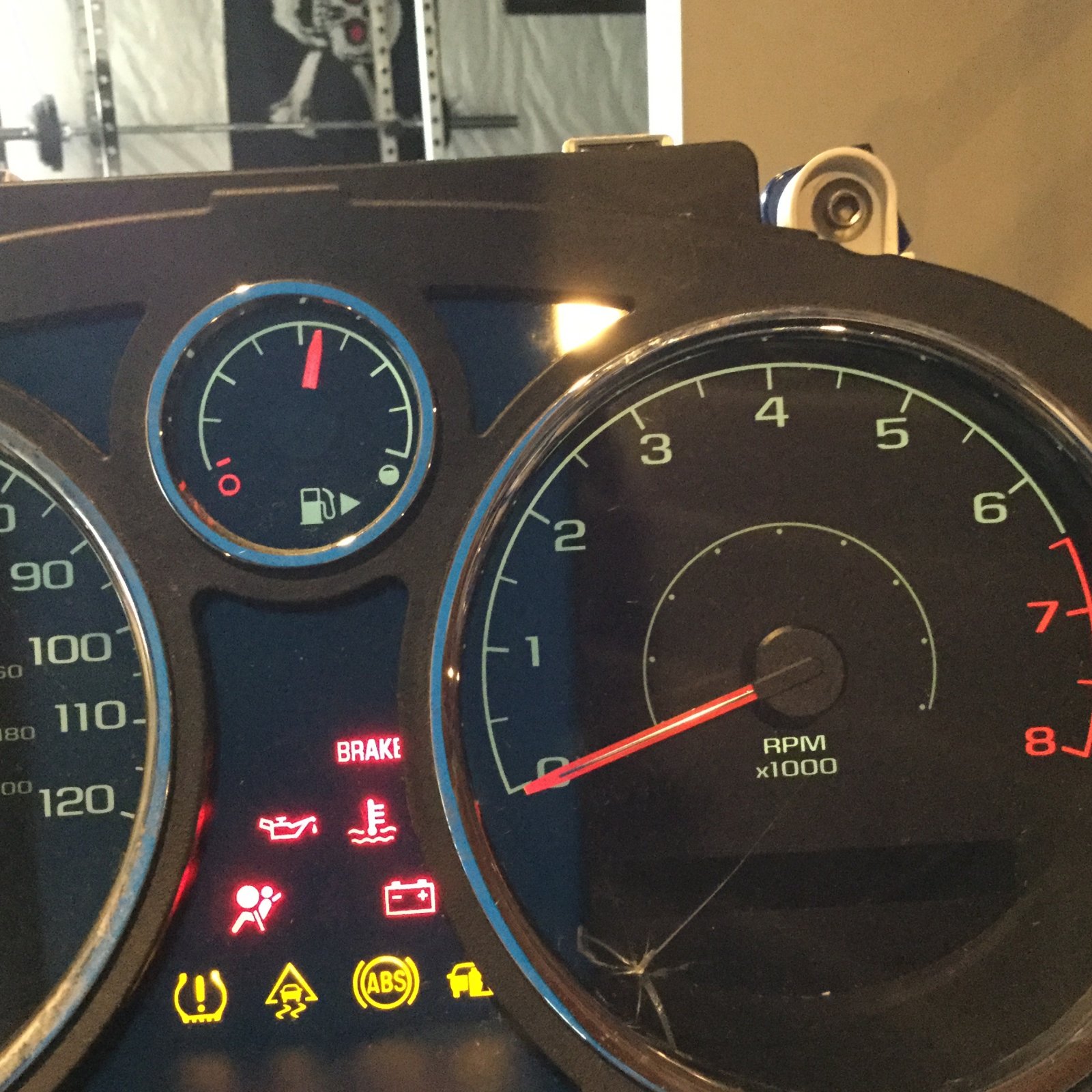

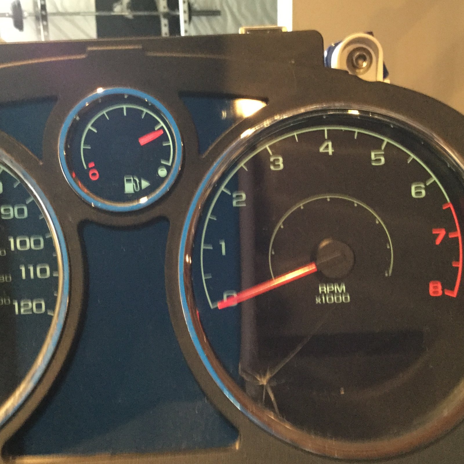

Send us an image of which lights are on when the key is in the run position and another while the key is held in the start position.
We will try to recreate it here.

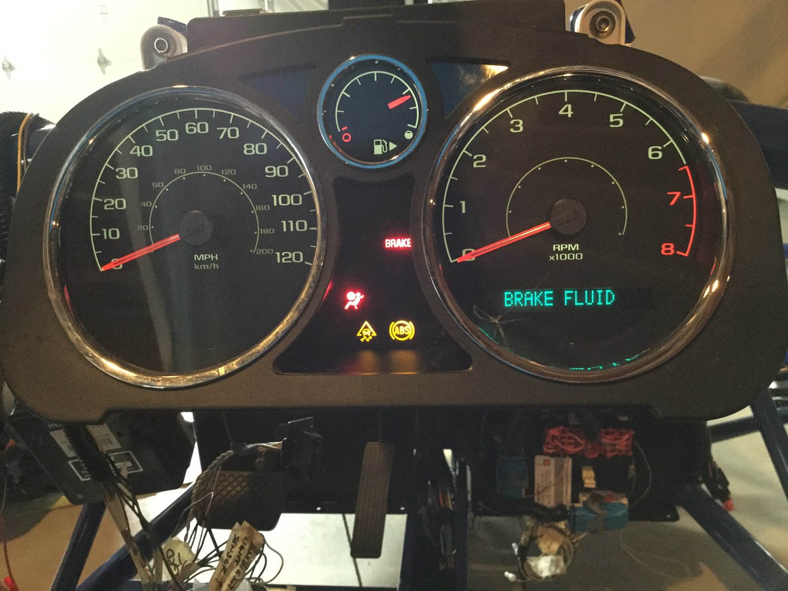

BAR-AIR
Initial key two clicks to the right (these are the indicators for about 3 seconds).
After about 3 seconds these are the remaining indications
This is with the key held in the start position.

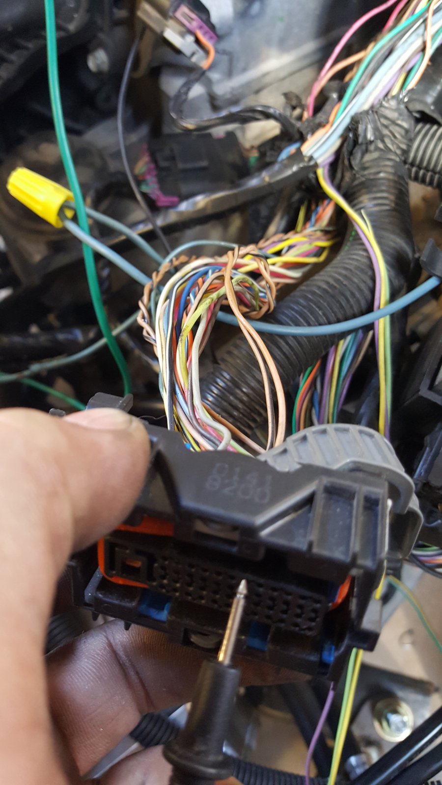

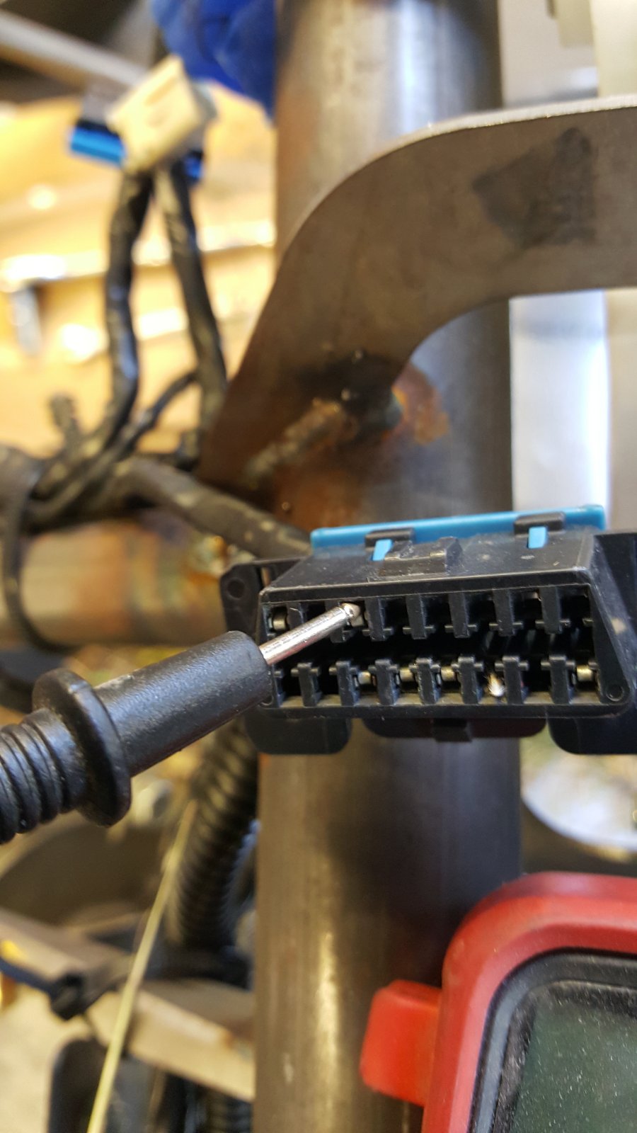

Several components of a Cobalt need to be able to share information with each other and also allow a tech to interface with these components.
GM daisy chained a data wire in and out of many components on a Cobalt. On a Goblin it starts with the OBDII and then continues to the power steering, BCM, ECM and TCM.
Though not necessarily in that order.
Some of the components we remove may break the chain such as the onstar, ABS brakes and air bags.
The pair of wires will always be twisted and usually one solid tan and one tan with a black stripe. Sometimes they may be brown and brown with a white stripe like the ones going in and back out of the power steering.

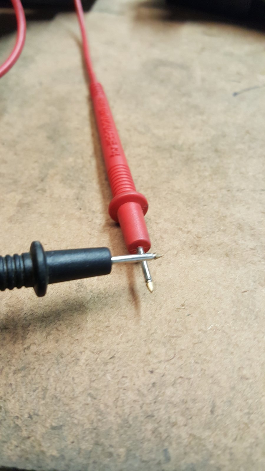

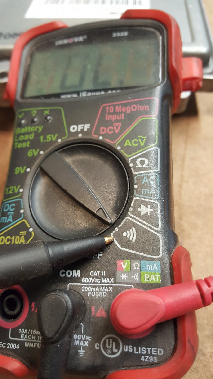

To check for continuity you will need a multimeter.
Set your multimeter on continuity test.
If your on the correct setting when you touch the two leads together you should hear a beep.
Disconnect the ground terminal on your battery.
Now with some help find the solid tan data wire on the back oh the OBDII plug and touch one of the probes in contact with the wire and hold it.
Now find the solid tan wire inside of the TCM plug and make contact with it with the other multimeter lead. It should beep indicating continuity.
Do this for ECM, BCM and the power steering making note of any that don't beep.
Some of the components have to be plugged up two allow data to continue on, like the power steering. It has to be pluged up for data to continue to the next system.
You need to do this test for the tan wire with a black stripe also.

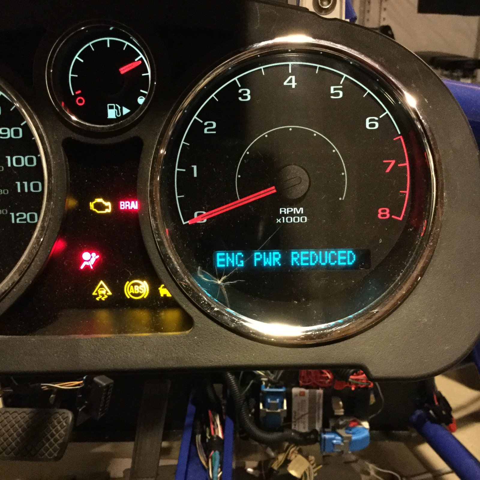

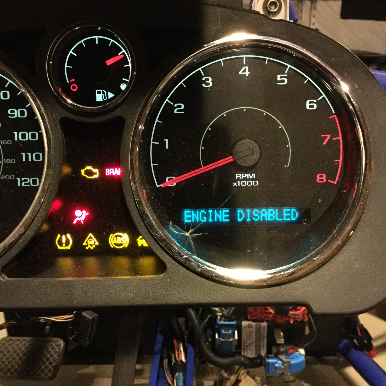

Finally had time to run that continuity test it was wired correctly. Still no start.... installed the second set of computers from another 2008 with automatic and then was showing security codes "ENG PWR REDUCED" & "ENGINE DISABLED ". Butterfly moves with gas pedal but no fuel pump. I'm not sure if you can swap the computers from car to car even if they are the same year. Or if I need to swap the ignition switch also?
