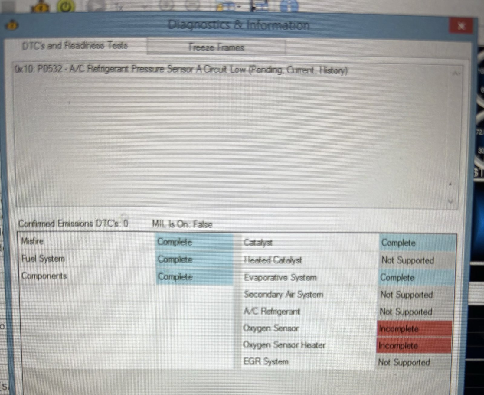

I did a quick log at idle and sent to tuner. He said no O2 function to use GM or NTK sensor and check fuse. If my AF gauge is correct it’s hitting 7.

Thank you, screenshot attached.

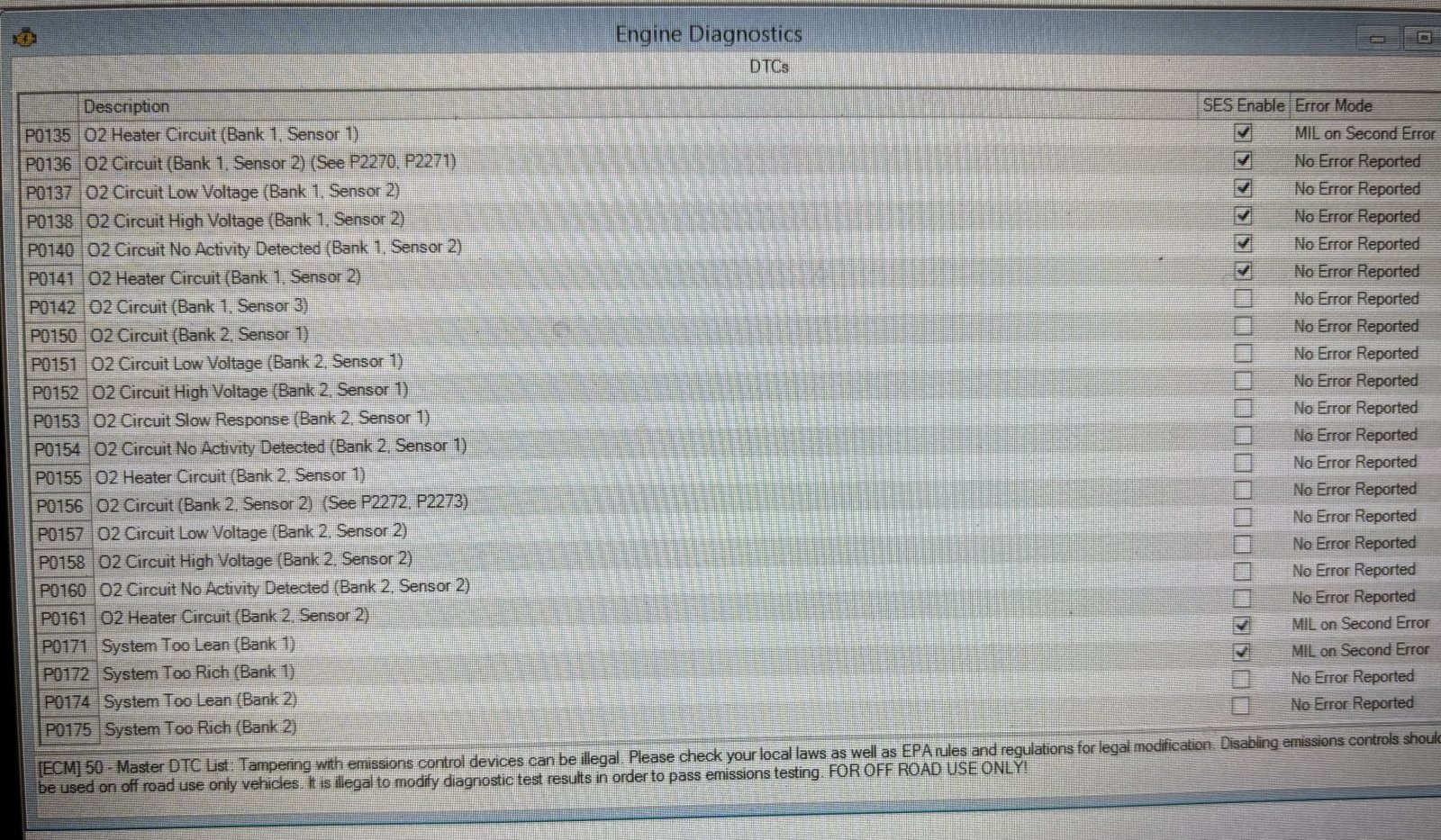

Are the dtc's for the o2 sensor turned off in the tune?
Not really much to work with here so far to trouble shoot. Have you confirmed it is plugged in? Have you confirmed continuity from the sensor to the ECM?

Not sure, I will ask.

Tuner didn’t mention either of those things not working, I will ask.

If the tuner is not seeing O2 function then my first guess would not be misconfiguration in the tune, unless the wideband is wired (or not wired) into the ECM in a way where the tuner can't find it.
