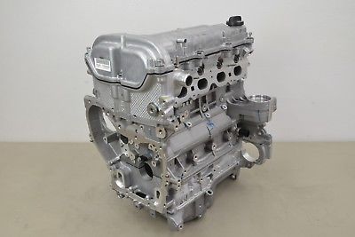

So in comes a deal that I could not refuse... a brand new Ecotec 2.4L VVT (2012) for sale without the rods,pistons and valves. So here I am going to try and do my first Turbocharged Ecotec engine build... (seeing that I’m not going to be the last of us doing this I’ll try to use this post as a DOs and DON’Ts for a N/A engine converted to a turbocharged high HP engine). This is my first attempt so I really could use sound advice and knowledge from other builder with more experience in turbo builds.
So let me begin with what I have and then we can go from there.
New 2.4L VVT Ecotec....

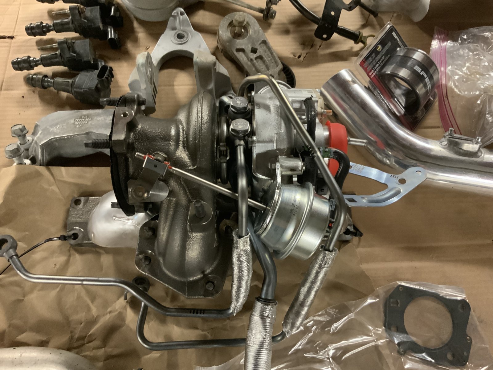

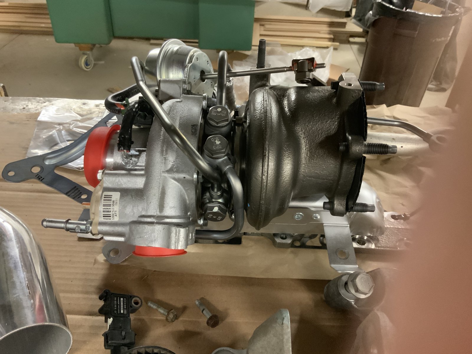

11) New BorgWarner / GM turbocharger ( 2.0 Ecotec LNF) new takeoff....

I do have questions with regards to the Turbocharger installation the physical bolting it to the turbocharger exhaust manifold is simple. Now comes the plumbing oil and coolant lines.

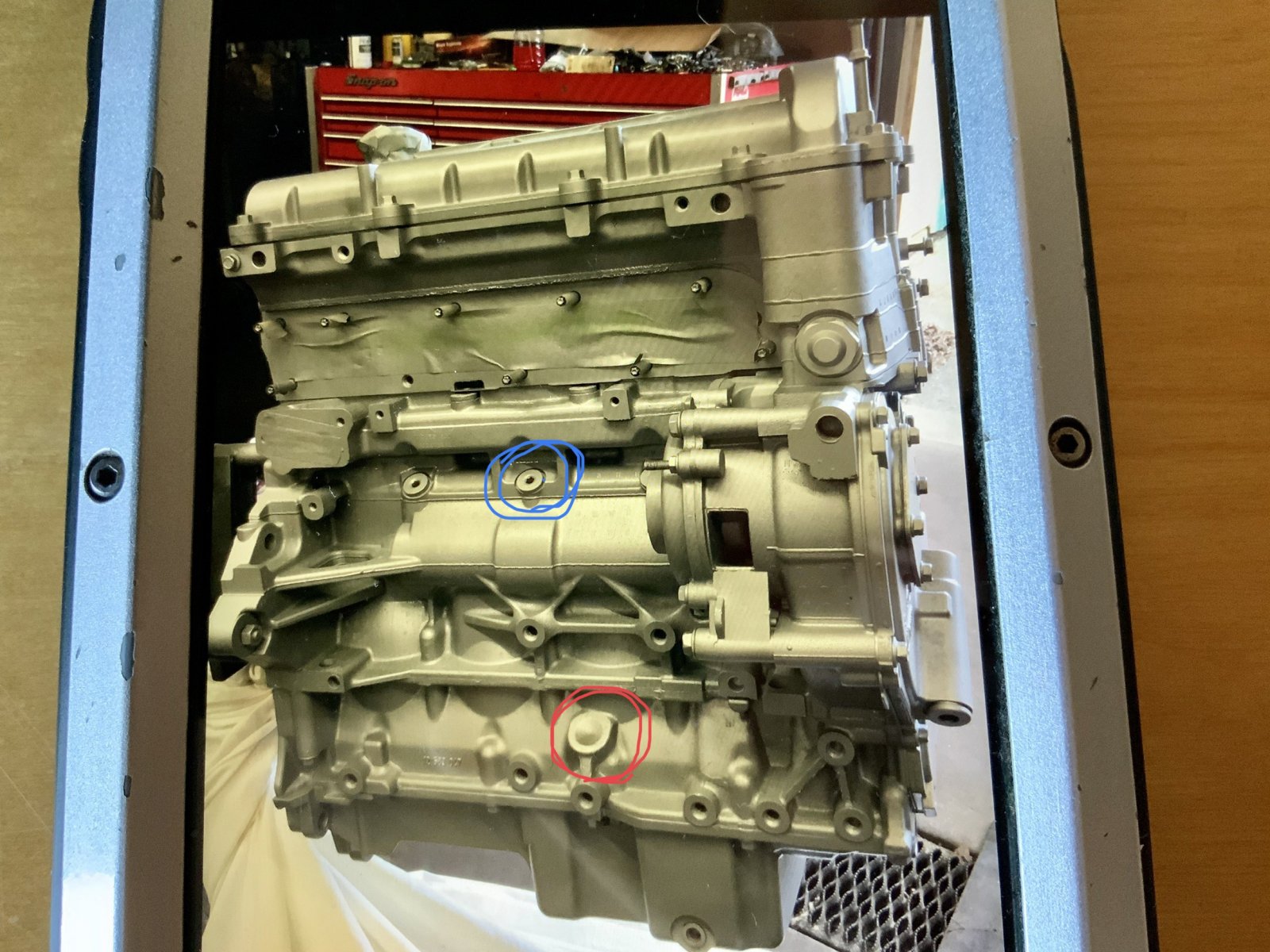

OIL LINES:

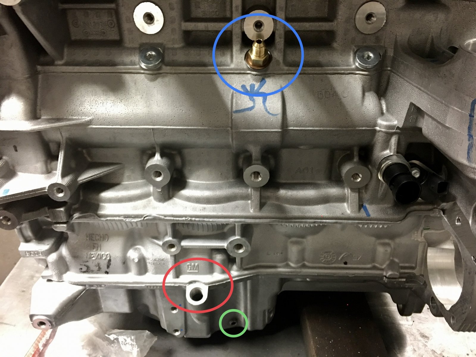

The feed line can be attached by removing one of the engine plugs in the block at the neutral shaft area of the block replace the plug with a AN fitting or a banjo bolt style fitting to connect the oil line to.
- so question here is if the neutral balance shafts are deleted per the delete shaft kit is oil still being pumped through that area???
- I have also read to use a 2mm restrictor of that fitting to cut down on smoke at start up from oil and the turbocharger???
The oil needs to go back into the oil pan... oil return line placement... so do you drill the block similar to the factory turbocharger engine location OR do you drill and add a threaded bung into the oil pan itself. (Better or worse)...
COOLANT LINES:
A couple of options... the easy end is at the thermostat housing drilling and tapping the housing or just simply replacing with a turbocharged housing with the fitting already there.
The engine end is a different story...

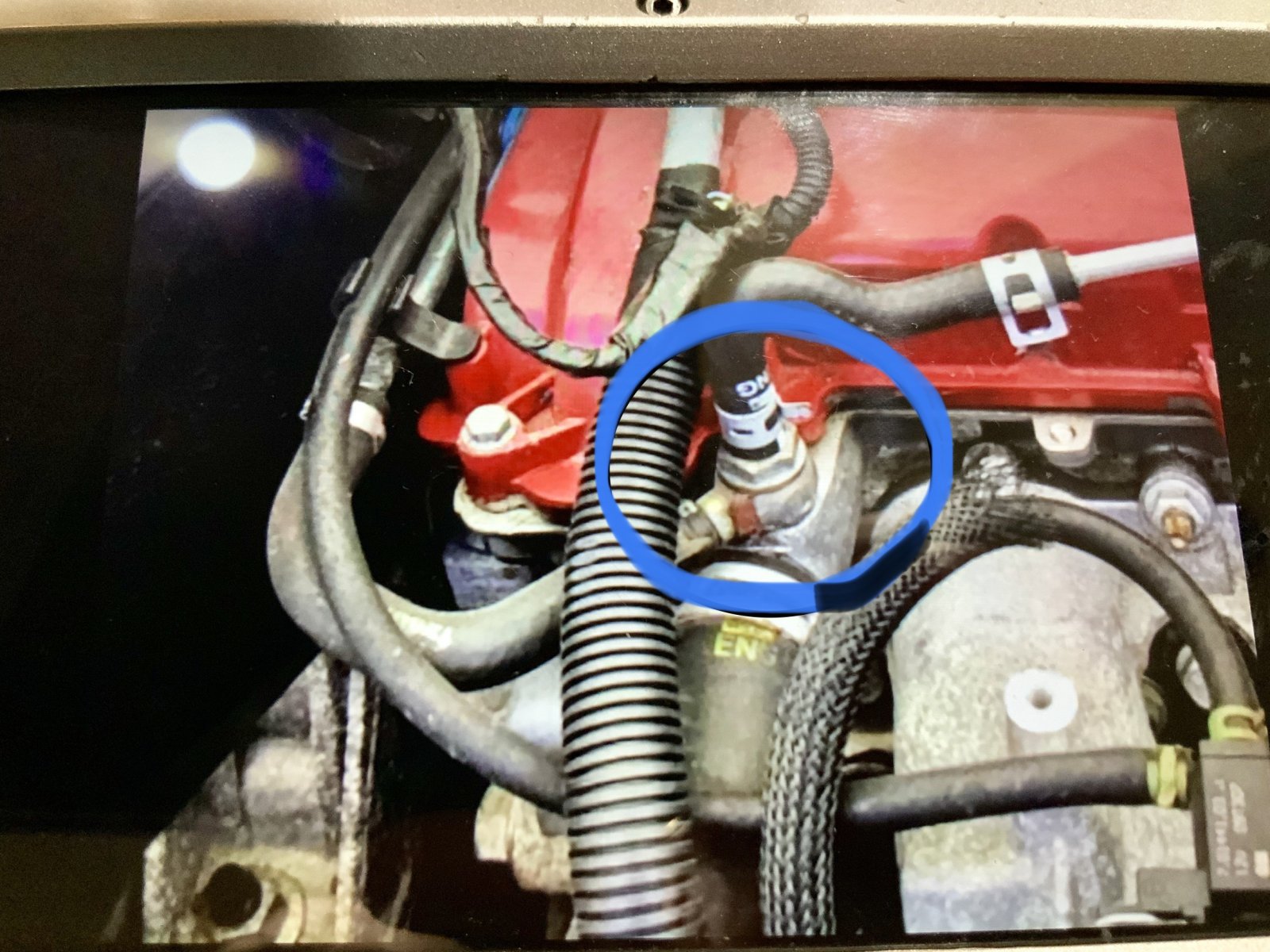

The photo shows the area that the stock turbocharged engine coolant line bolts up to the engine. First problem is that I don’t think there is enough room to drill and tab that into a 12mm banjo style connector. And also what do you do about the restricted coolant fitting that runs to the coolant pressure tank. ( there are tapped banjo style fittings that the coolant line and the restricted barb can be connected to ) problem is size.
Second option: (don’t know if this is even a viable alternative)
What is the coolant temperature through out an engine system. IE the temperature difference between the two stock mounting locations above...
If the temperature differences is minimum can you use the heater core lines on the the thermostat housing as your feed and return lines. Simply remove hard lines tap the housing (1/2 NPT) add 1/2 NPT with 3/8” barbs and connect them directly to the turbocharger coolant lines...
Yes. Bushings should be included with the delete kit to go in the bearing journals to maintain oil pressure.
The area I circled is the OEM oil drain location. Pull the pan and drilling it out is the best option.
IIRC you will need to swap to the LNF thremostat housing and coolant crossover for the OEM turbo to fit.

BAR-AIR
Good Afternoon,
Just to clarify... I’m planning to upgrade the turbocharger in the future. The LNF turbocharger (OEM takeoffs) are the cheapest way I could find to get the lines and components with a better quality turbocharger. This is just a proof of concept that everything works as it should before spending a lot more money for something that may not work...
The ultimate goal is a +400HP engine with reliability....

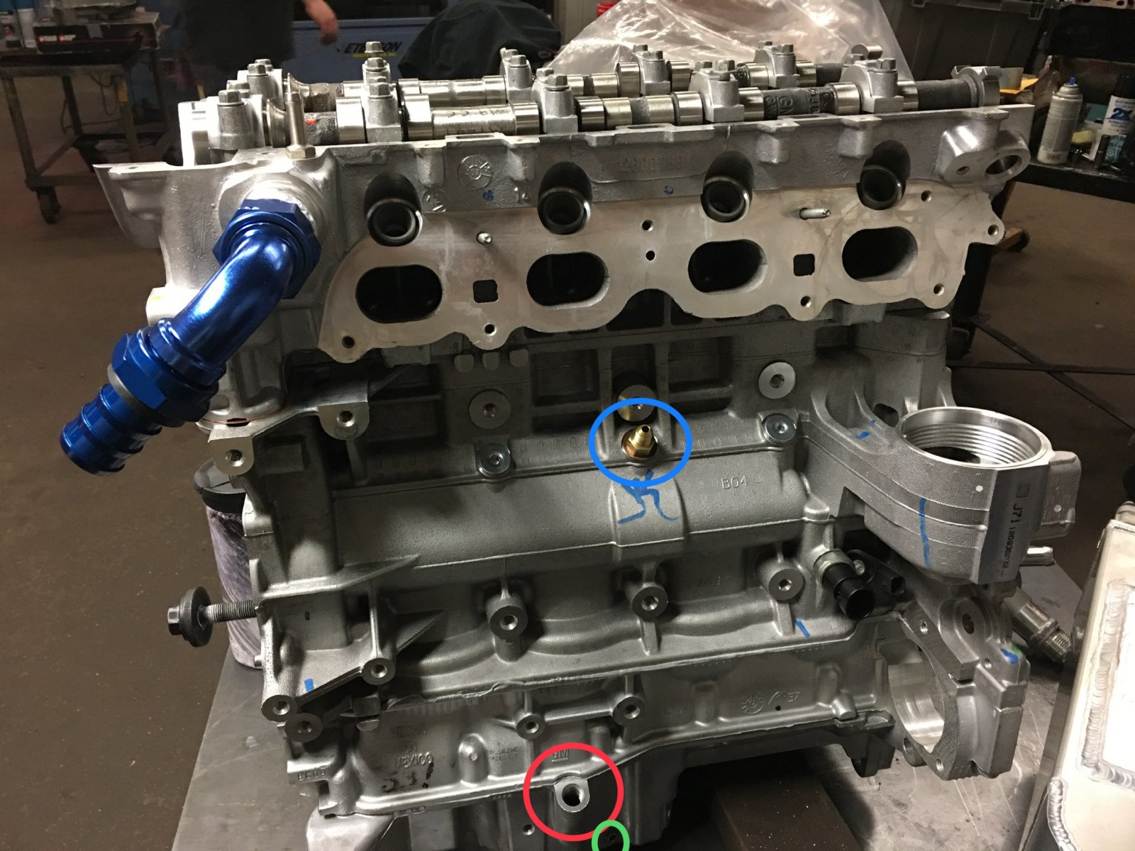

So oil lines...
Remove plug at the blue circle and replace with a barbed or AN fitting for the oil feed line....
Drill and tap at the red circle and add a barbed or AN fitting for the oil return line...
Next are the coolant lines???
NOTE: purchased a turbo coolant pipe for the additional space required for the OEM turbocharger...
THX,
Bruce

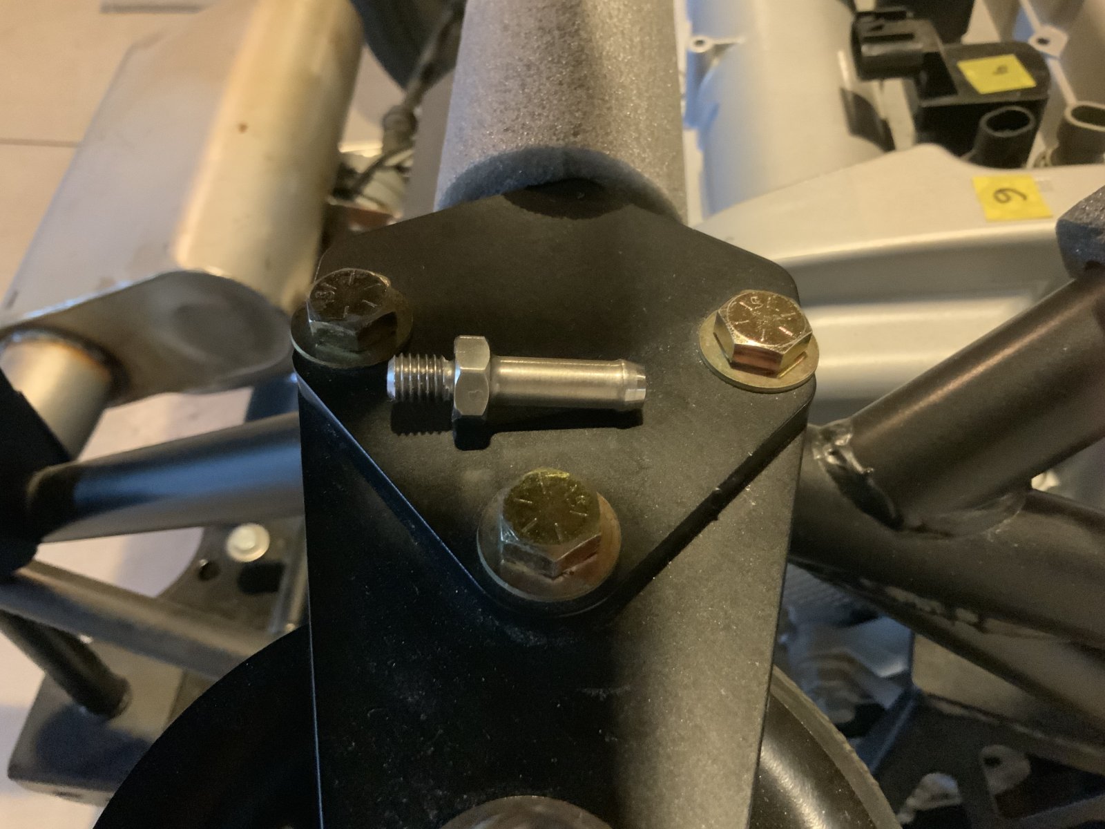

Does anyone have or know what the Tapped Banjo bolt is here. Basically it is the second coolant connection to the LNF Turbocharger - connects the turbocharger coolant line plus has the connection for the surge tank -... if it’s OEM a part number or description (or if you know where I can purchase one).
THX,

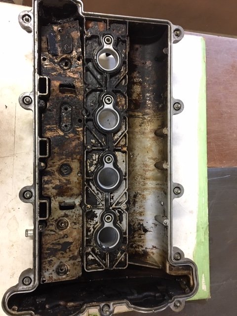

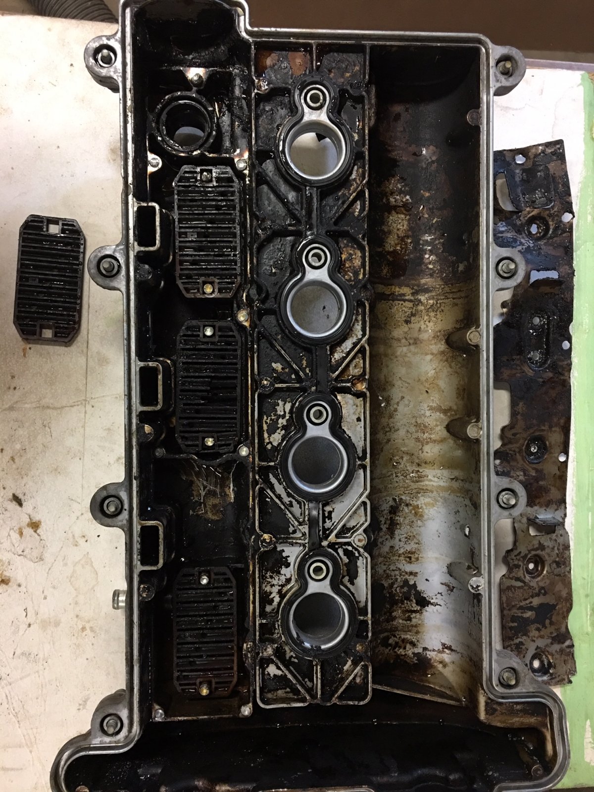

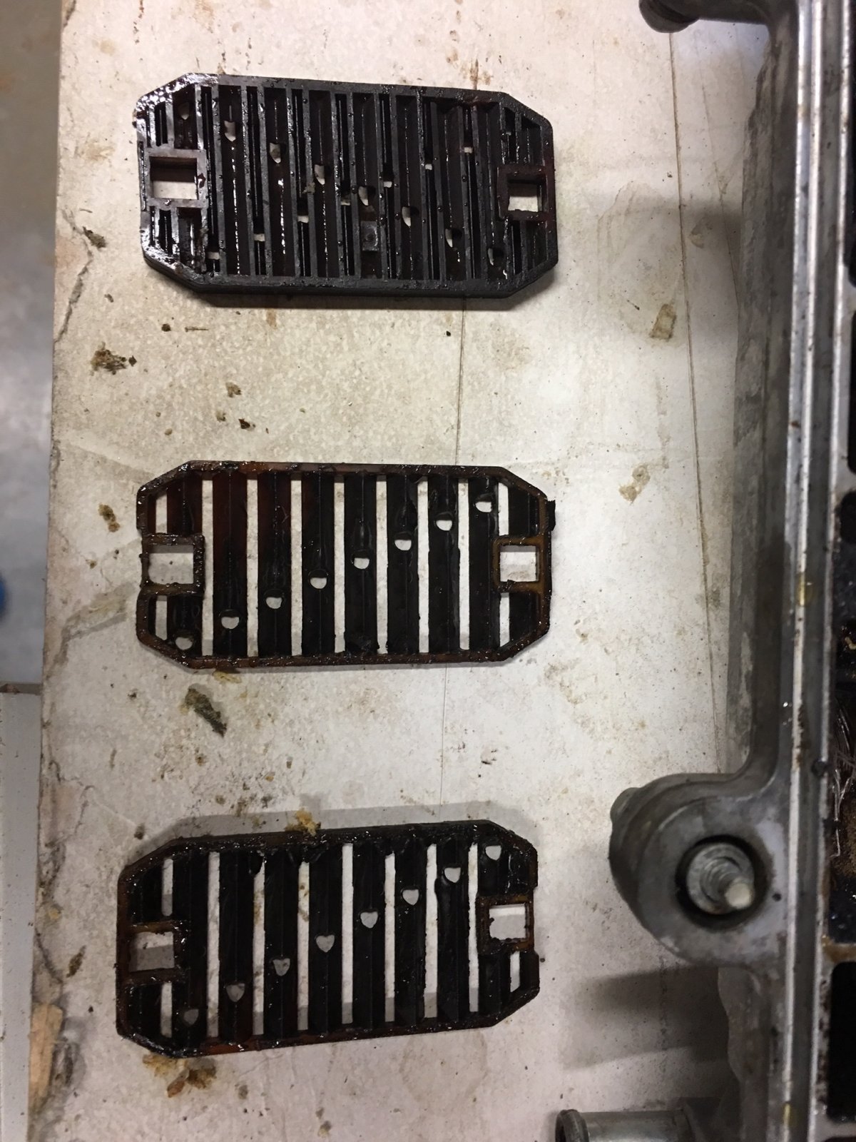

But after seeing Chris Wylie’s build I have been questioning the need for extra venting??? (Reason behind it... running a 2.2L w/ ZZPerformance supercharger and do get a small amount of oil from the rear main seal with normal driving and also get oil from the bottom of the dipstick with hard driving) Very small amount -400 miles on car and have not had to add oil [also new rear main seal and new o-rings on dipstick tube]. Both leads me to believe I’m pressurizing the case.
So with that I had an old Ecotec valve cover and wanted to see the best place to add venting. The intake side has a splash guard (cover plate) riveted into the cover.
Underside with the cover plate.
Underside with the cover plate removed. You can now see three separate areas each having a series of plastic wafers.
The wafers themselves are stacked together.

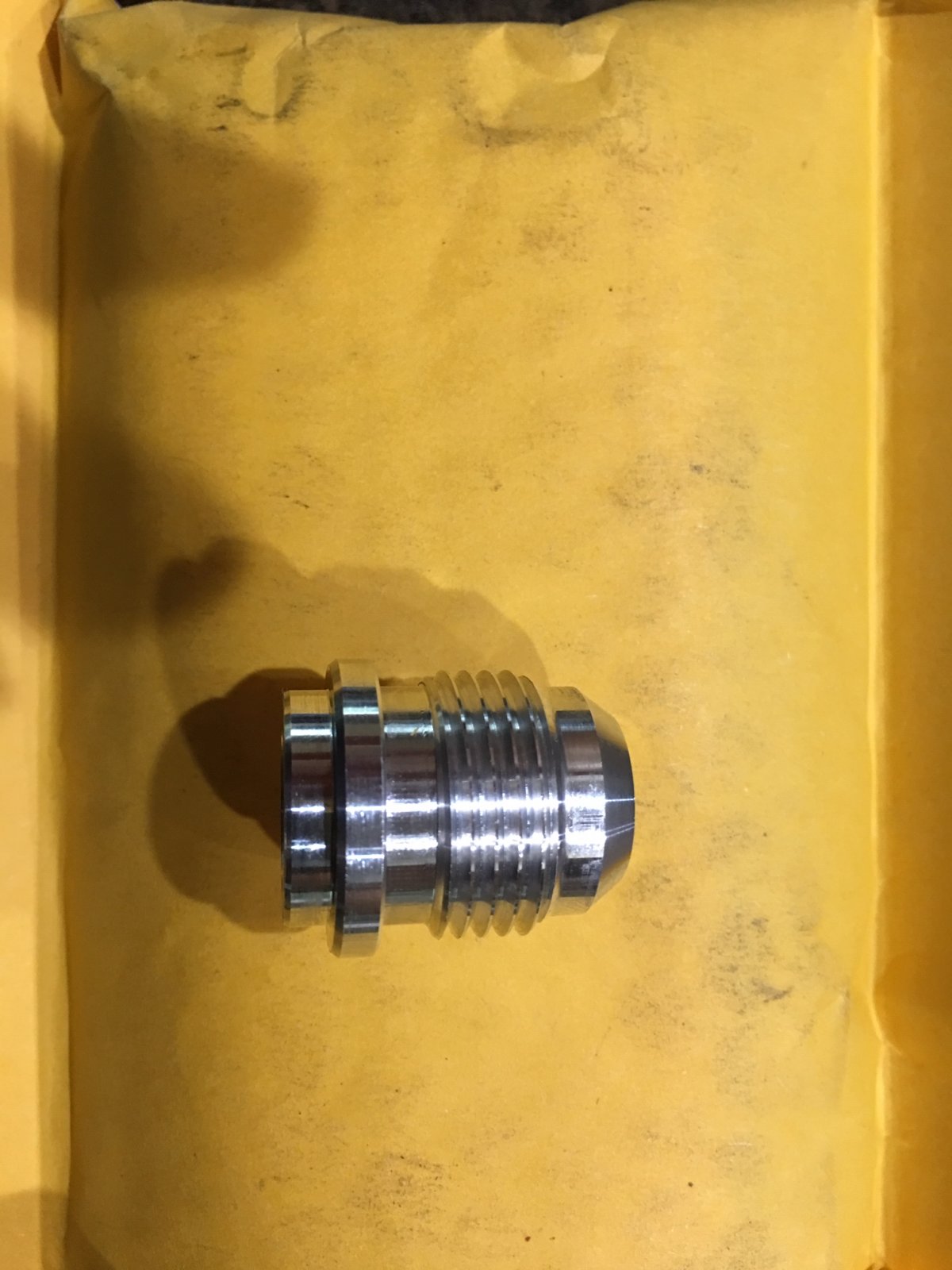

So the question becomes if I were to do it like Chris’s I would take 10AN weld in bungs (pictured above) and weld them into the valve cover exhaust or intake side (or both). Seeing the splash guard is permanently attached issue with drilling and welding into that area?
Looking for input....

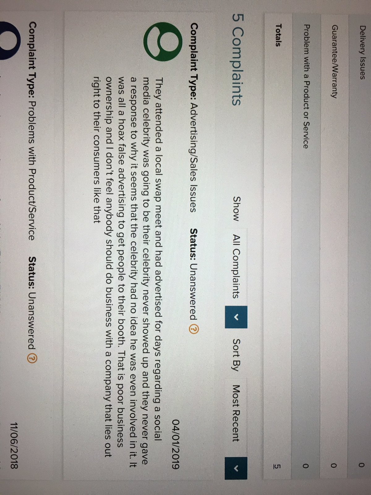

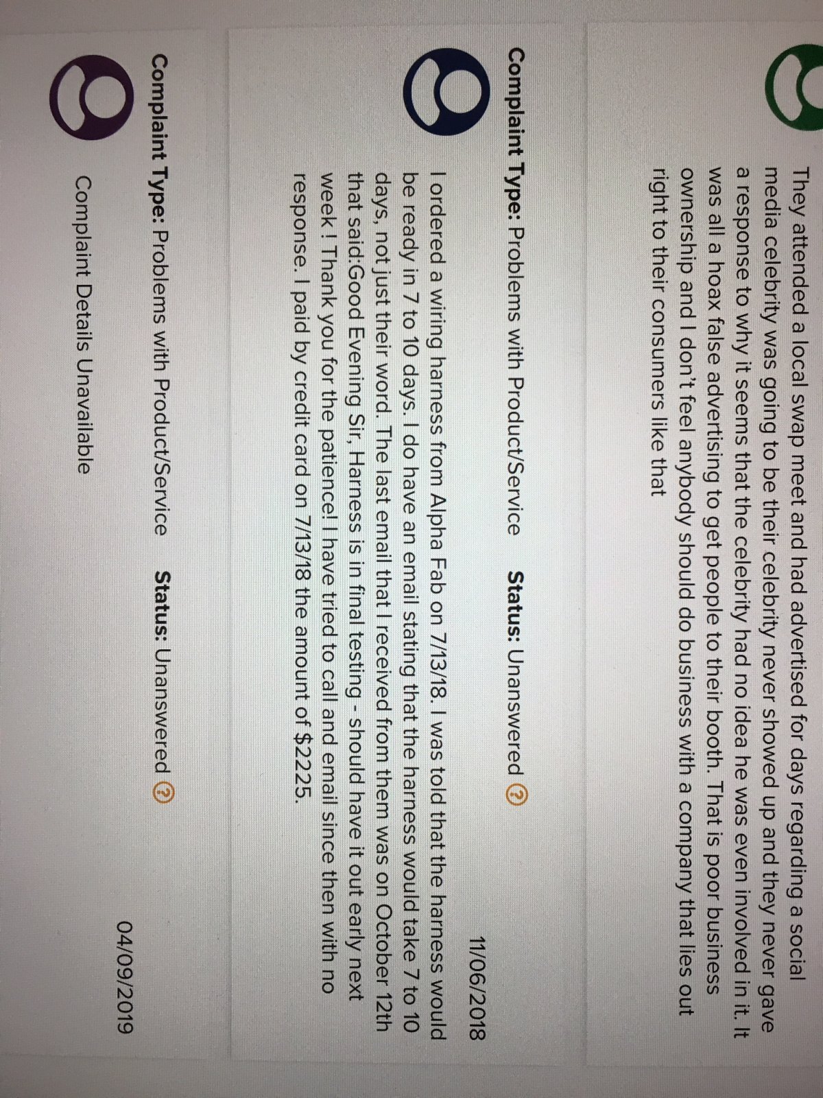

I do want to give a SCAM ALERT !!!!!! to the builders....
I have been flighting with ALPHA FAB INDUSTRIES over the stand alone wiring harness for Nate’s car. (That sucks in itself get one of your kids really excited about a build and then have it sidelined to deal with this). Harness payed for in full over a year and a half ago. So basically they have our money the computers for Nate’s car and won’t even return a phone call, text or email. Much less deliver what was promised. Started looking at the BBB (Better Business Bureau). 5 complaint just this year over the same things (attachments). You can also look them up for additional complaints on the Cobalt SS Forums...
Shaun McColley (owner)
Stephen Walton (manager)
1101 SB Chavez Dr.
Flint, Michigan 48503
Racewinningholdings.com
1 (810) 893-6265 or (734) 604-0452
These guys have a great web site and talk a great line (of sh*t) but can’t or won’t back it up.
Take a look at the attachments...
Hopefully nobody else has to get screwed by them...
Bruce

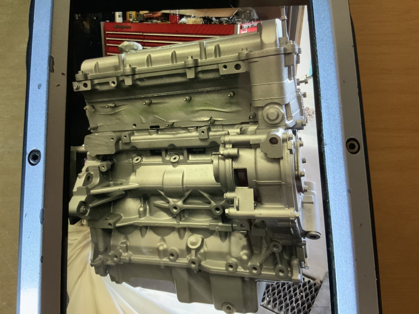

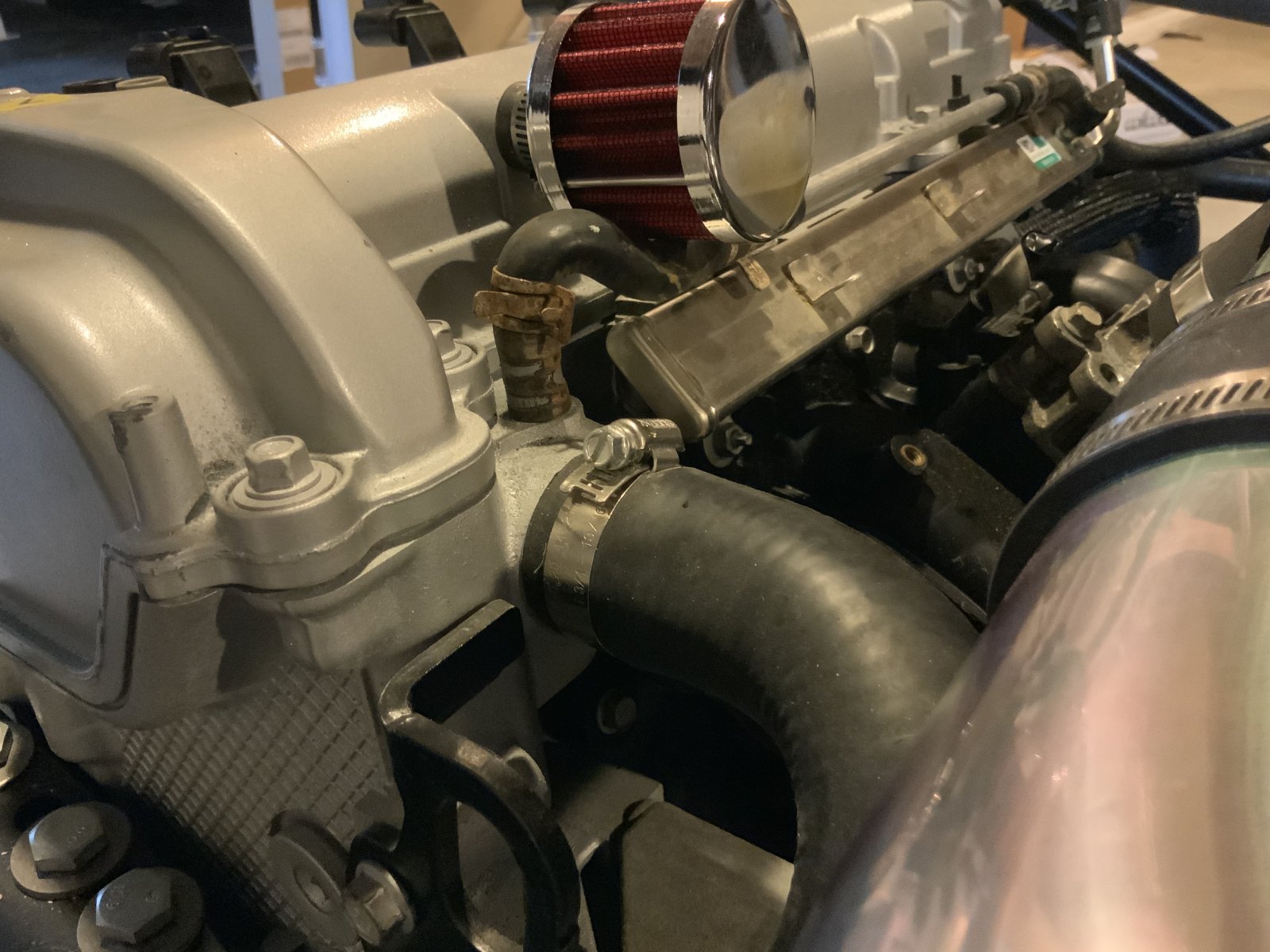

Finally have had some time to start to assembling the completely forged 2.4L Ecotec. Should be a monster when complete...

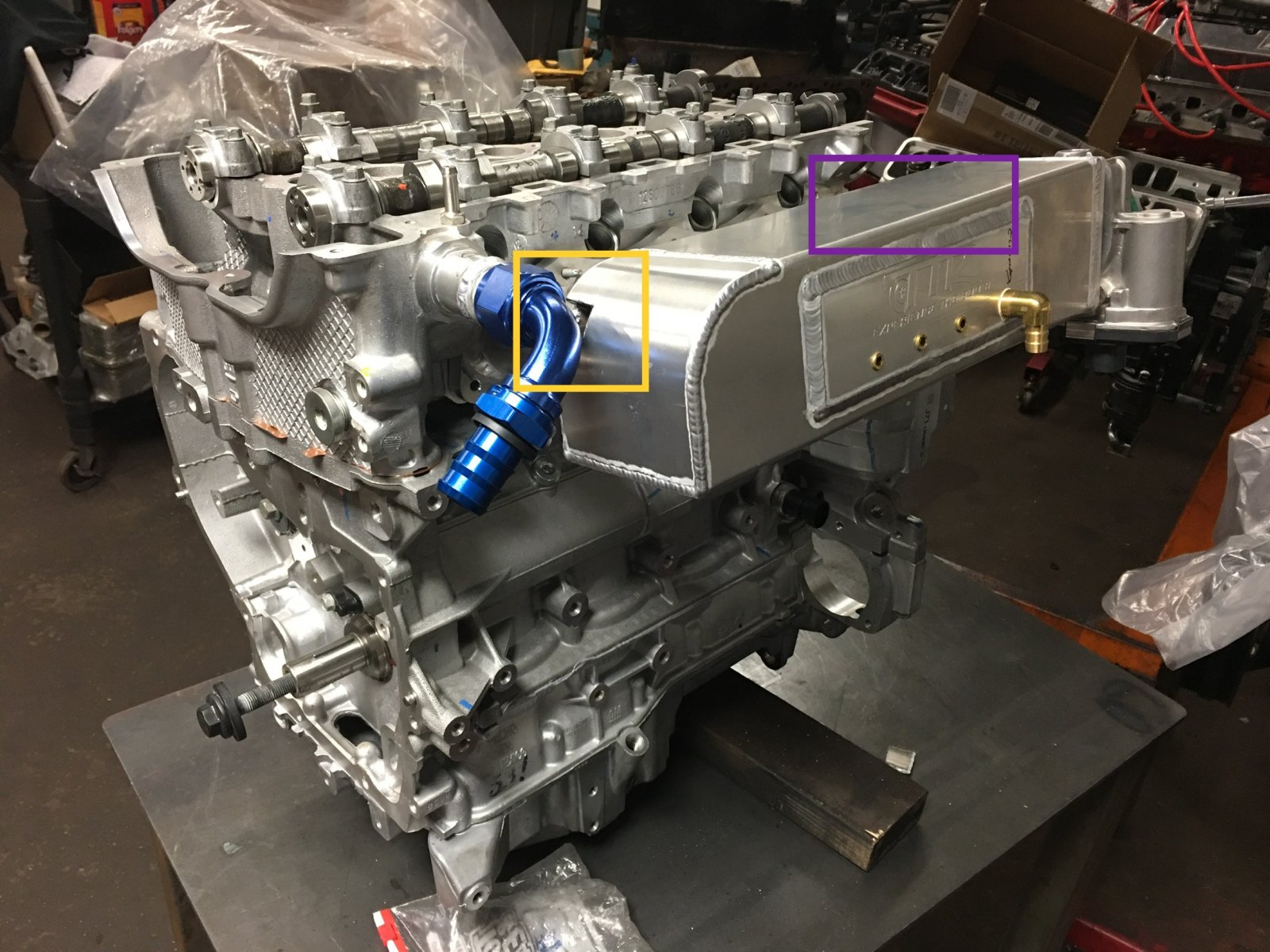

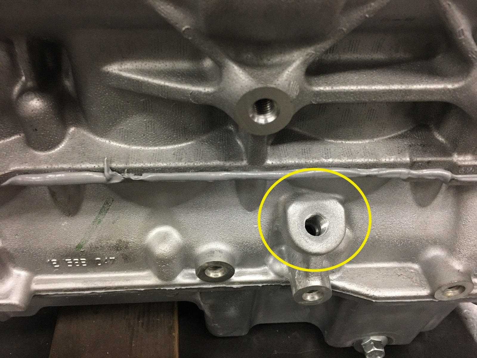

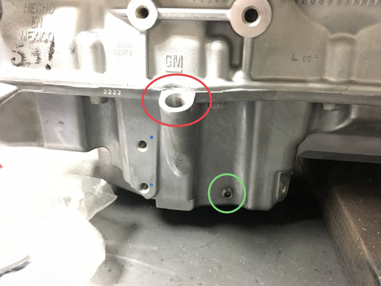

I’m going with AN fittings with as much as I can (I really liked the way Ken did his car). So welded in AN16’s into the radiator lines but did have some interference with the Turbo Tech intake manifold (yellow box). Also need to drill and tap the area next to the AN fitting on the radiator line for the coolant line going to the turThe manifold didn’t come with a mount for the MAP sensor either (purple box) could run it off one of the plugs but seeing I need to weld the corner anyway we’ll also weld in a mounting block for the MAP sensor.
The blue circle will be for the pressure oil line going to the turbocharger.
NOTE: just realized this oil pressure line fitting should be on the other side of the engine under the coolant tube...
Still not sure if I’m going to another one of those four pressure fitting to run my oil pressure gauge. (Going with a electric VDO gauge package - oil pressure, temp, coolant temp, amps and tach) or drilling and tapping the block over by the oil filter. Red circle is the drilled and tapped for a aftermarket oil dip stick tube ( so that it can be much shorter and won’t have the issues of leaking Green circle is tapped for the oil temp sensor.
Yellow circle is for the oil return line from the turbocharger....
So it’s on it way from a pile of parts into an actual engine...
THX,
Bruce
JSATX
That all looks good! Personally I ran a T off the turbo oil fitting for the oil pressure sender, that way your gauge is “protecting” both the engine and the turbo which frequently can cost about the same haha.
