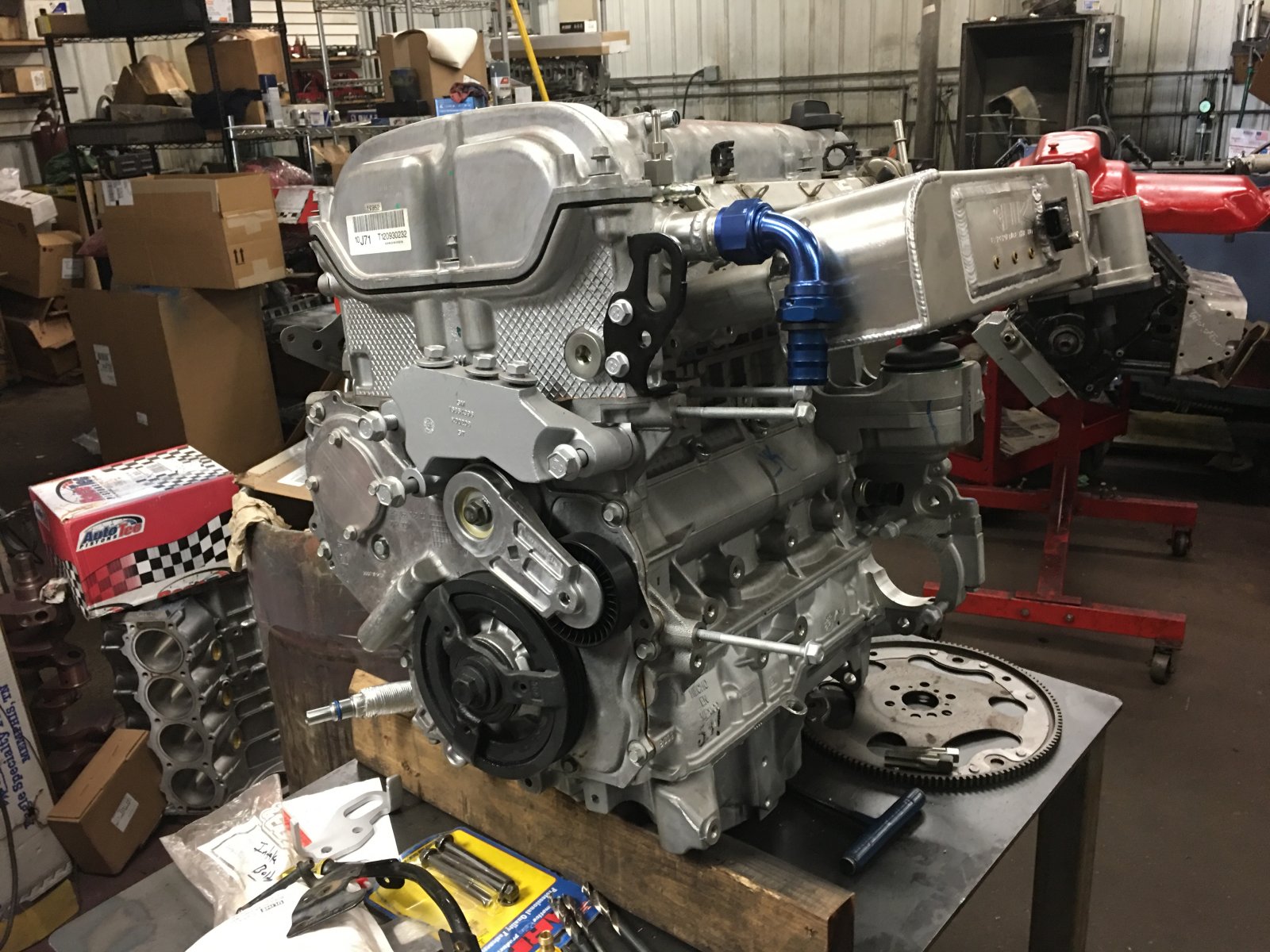

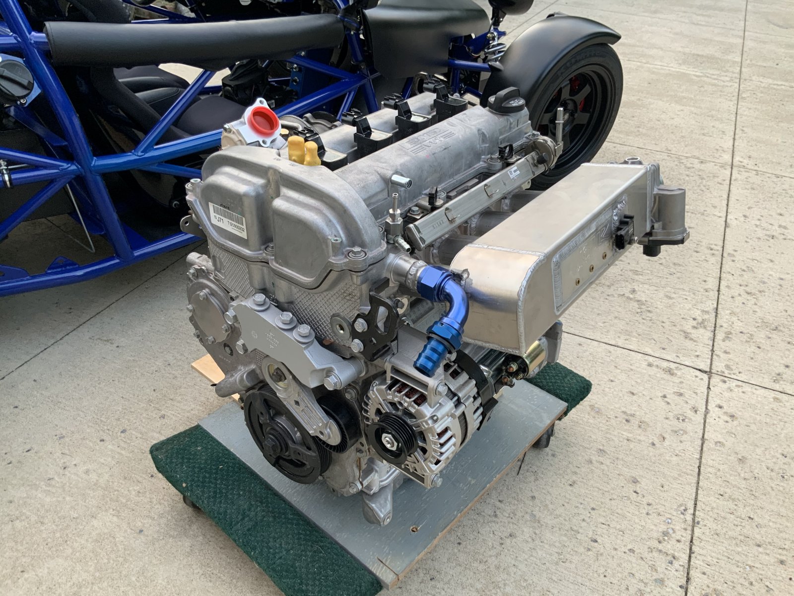

BAR-AIR

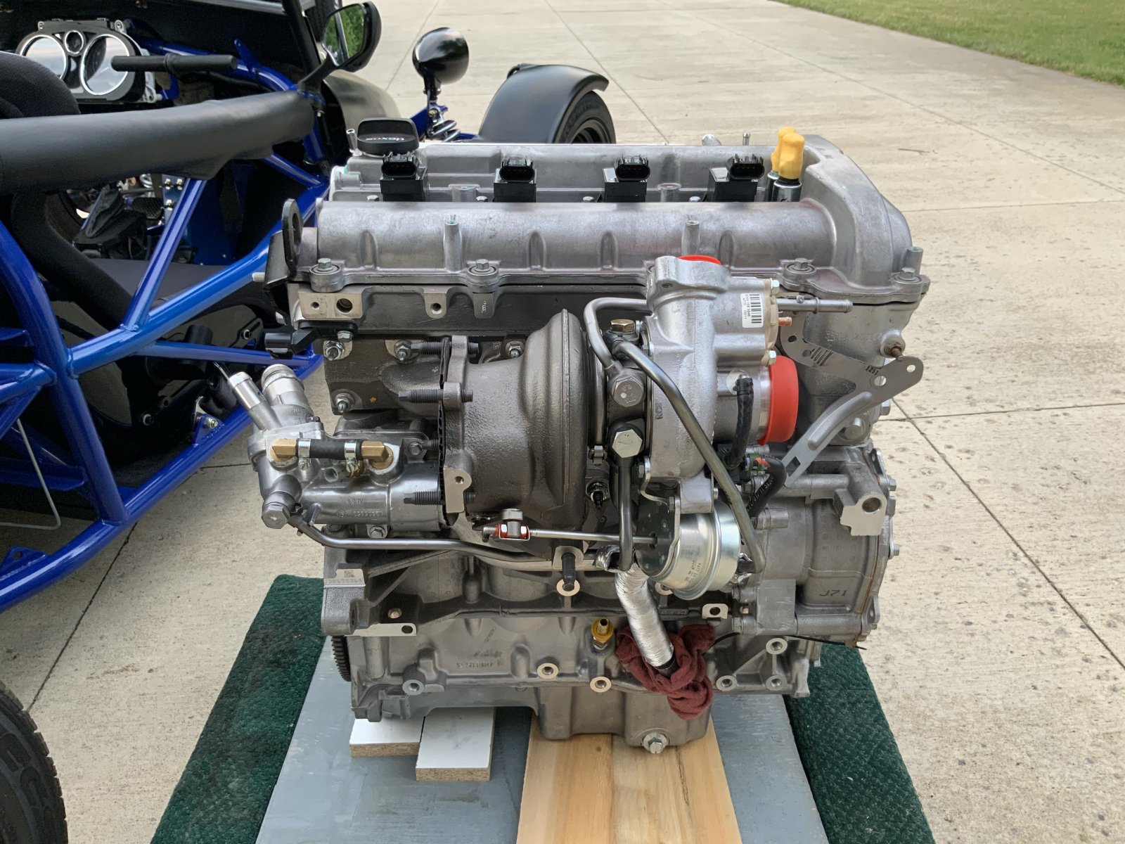

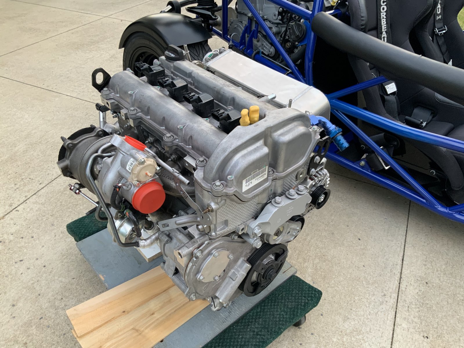

Good Evening,

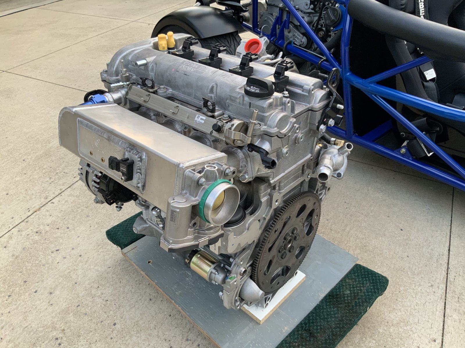

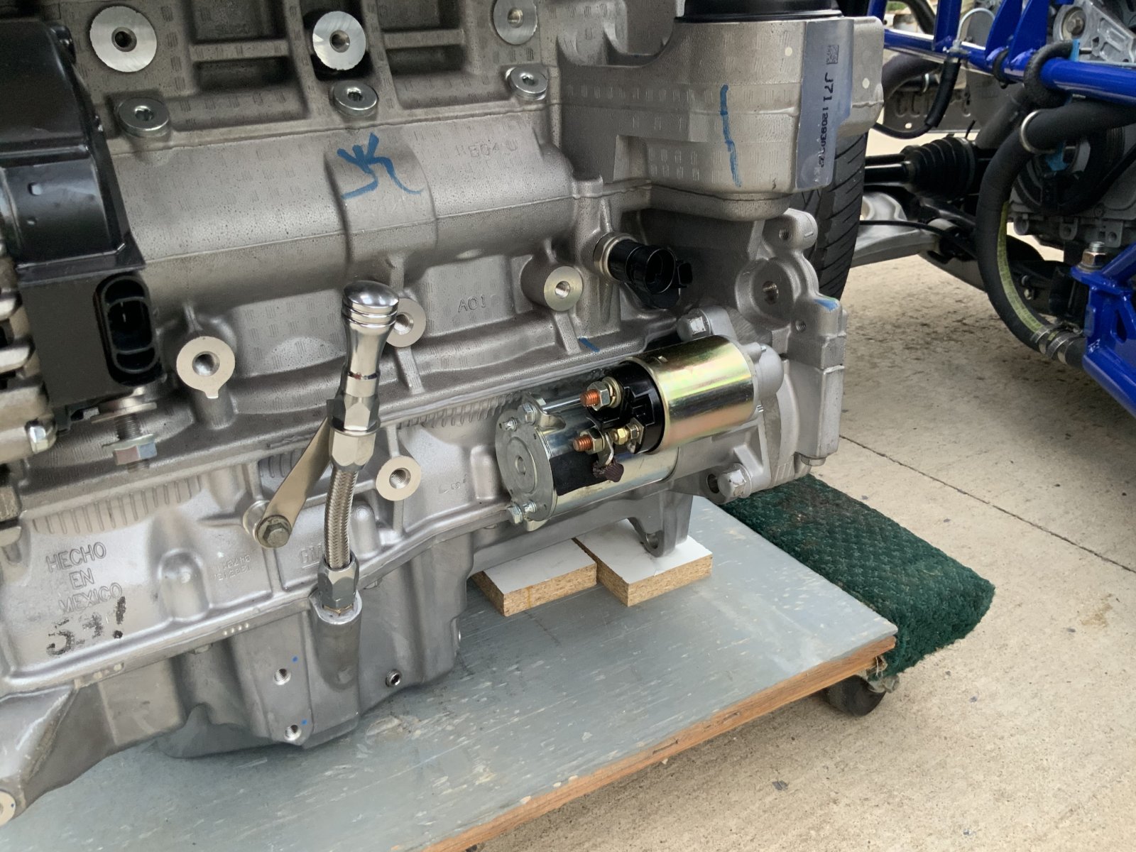

Just finishing up the turbocharged 2.4 (and YES I do have it for SALE in the classifieds - it’s a lot of HP for a Goblin it should be well over 450 mark)...

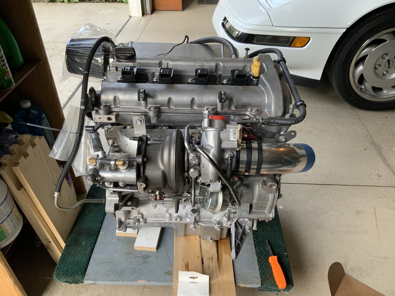

So here are some updated photos....

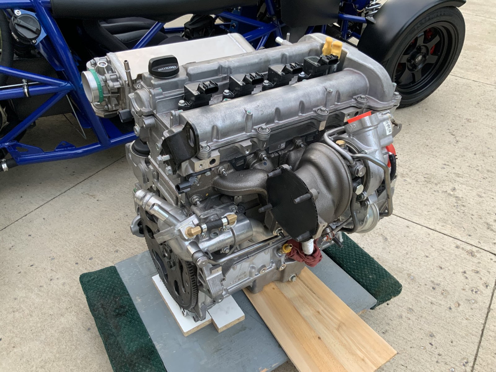

AN fittings for the radiator lines...
Thought some of you would like the new threaded in oil dipstick....

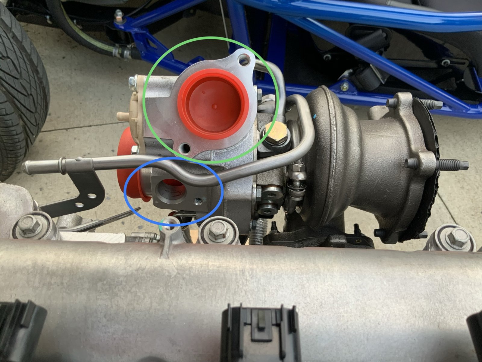

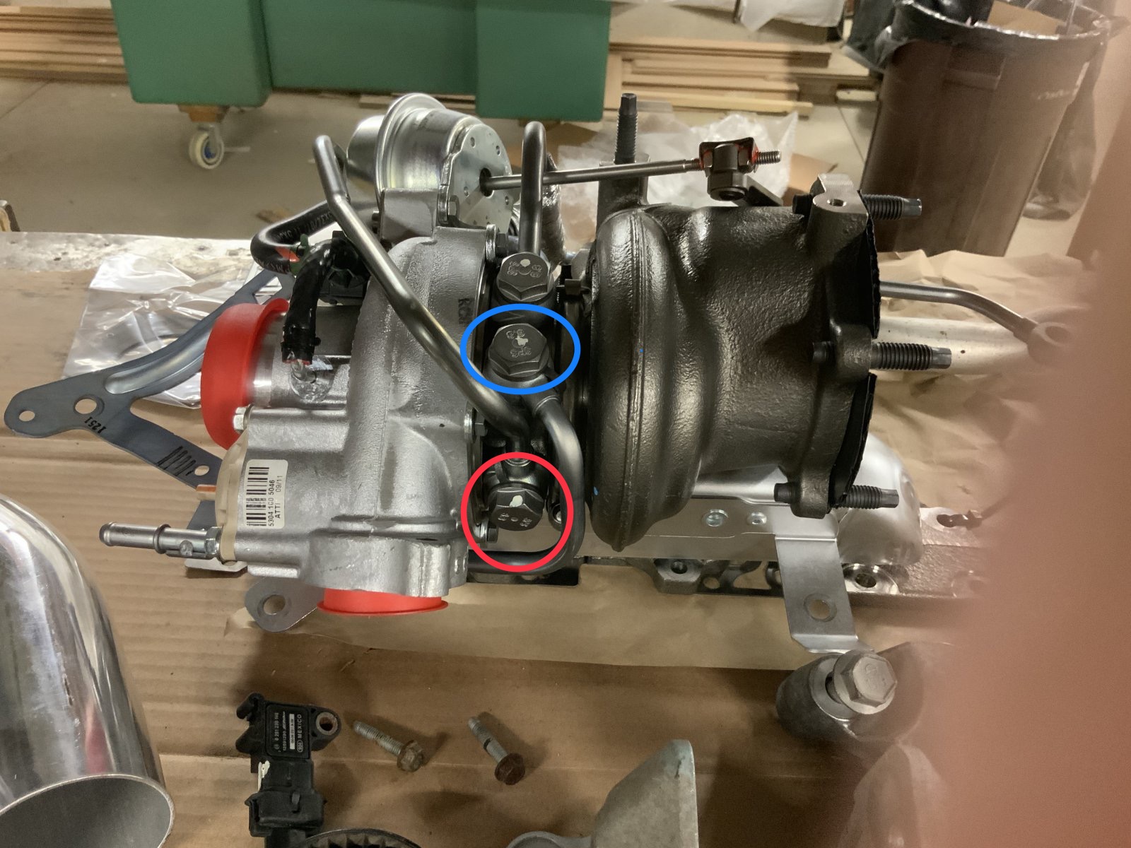

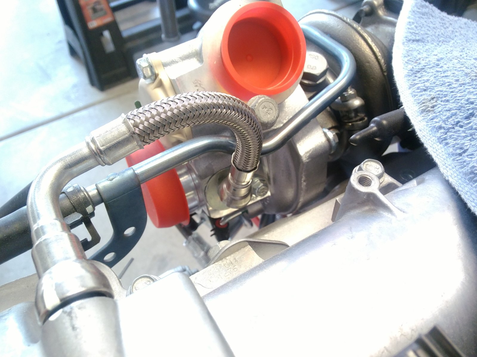

Did have a couple of questions with regards to the BorgWarner turbocharger I have a green circle and a blue circle would anyone have photos of the connectors that attach to each of those....
THX,
Bruce
Bruce here's a photo of the intake side port. Has a plate that bolts into the single hole with a stainless braid hose that goes to the valve cover. Assume this will supply constant vacuum to the engine internals.
BTW, that is where a catch can should located to keep oil mist out of the turbo impeller and further along into the intercooler.

BAR-AIR
Good Afternoon,

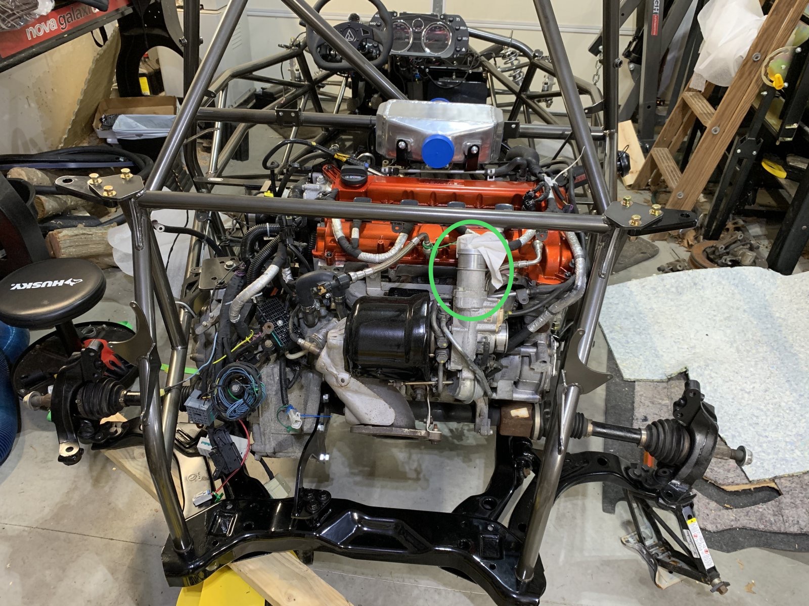

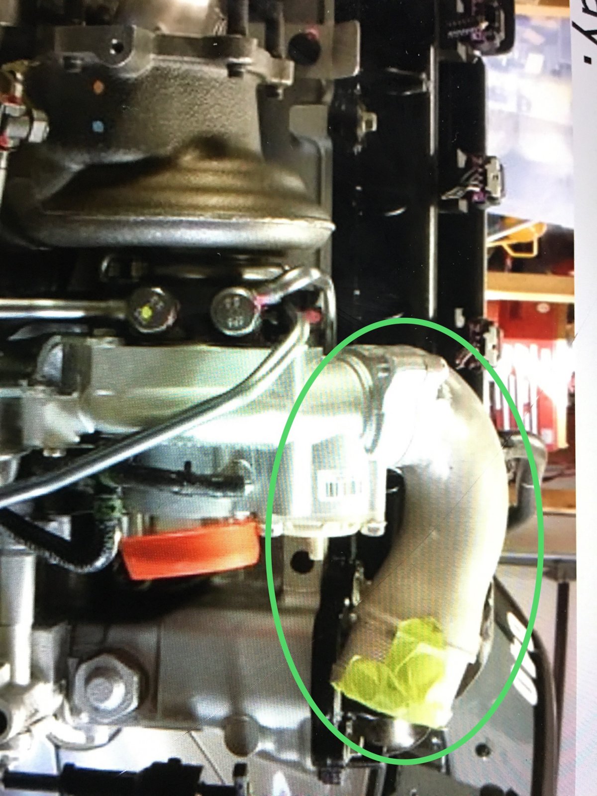

Any kind of part number on the connector? Have you had it off to see the back side of the connector ( wondering if I can just machine a flat plate with a AN6 fitting then run AN lines to a catch can then into the valve cover ). How about the other (green) circled connector that should be going to the throttle body though the intercooler so there should be a bolt in connector with either a place to connect the rubber (silicon) hoses or a VEE band for hard lines. Correct? Anyone doing one of these conversions is going to need these parts would have though them readily available but can’t seem to find them anywhere....
THX,
Bruce
Bruce the photo is from my new crate engine, which I don't plan to disassemble any time soon. Sorry, no visible part numbers.
The outlet in your last photo may be a Skyline/Solstice pipe?

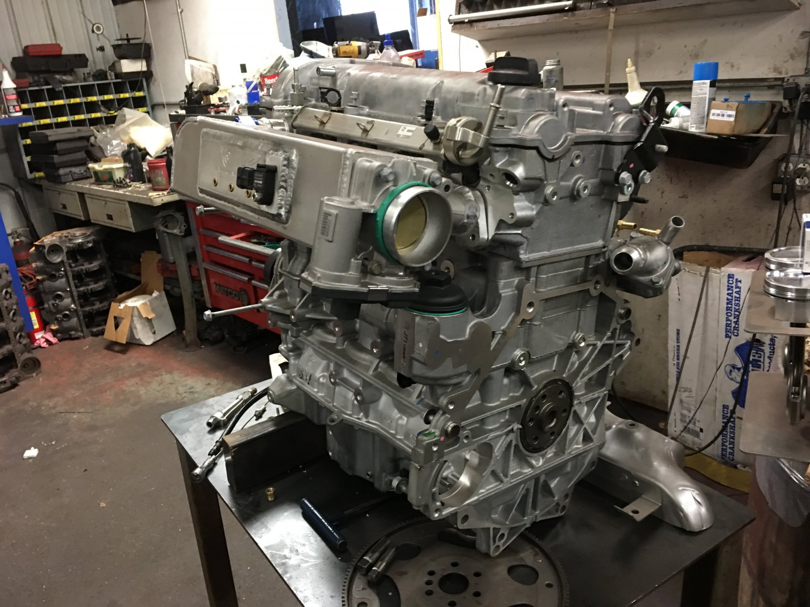

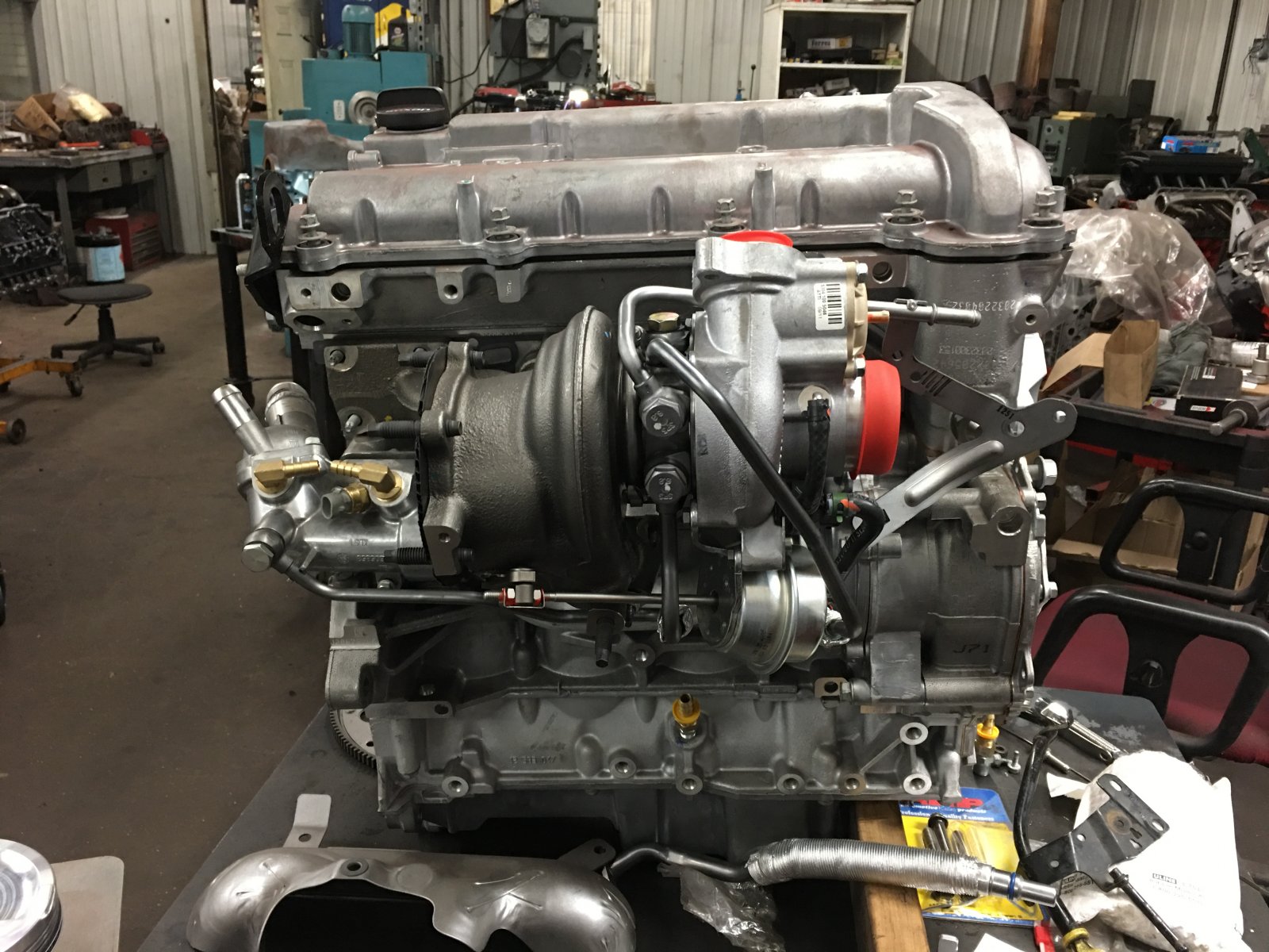

Found this picture on “MisterDave’s” build log... anyone have any information on what that part is (turbo charger output) for the OEM turbocharger... everyone I have seen doesn’t have it connected to the actual turbocharger...
THX,
Bruce

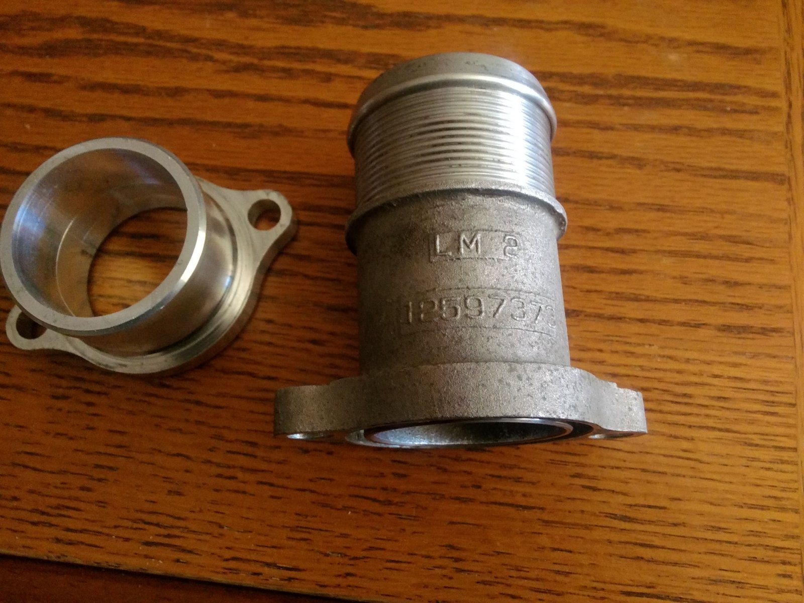

These are the turbo outlet pieces I have. Left one is the DF supplied and the right one is from donor LNF engine (2008). The PN on the GM piece is 12597373. Also has 'LM 2' on the casting.

You wouldn’t be interested in selling the LNF one would you? Have a call into Adam to see if I can buy one from them also....

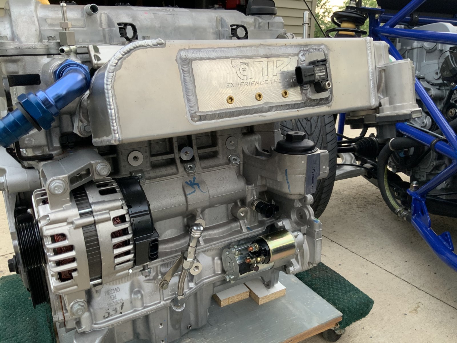

Good Evening,

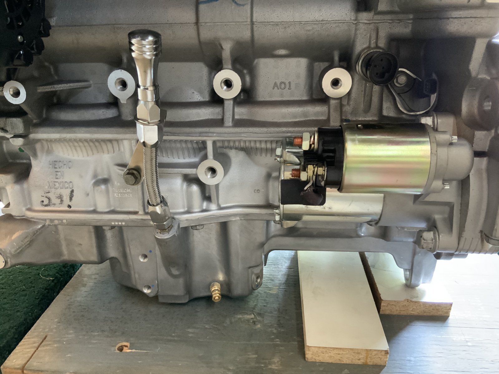

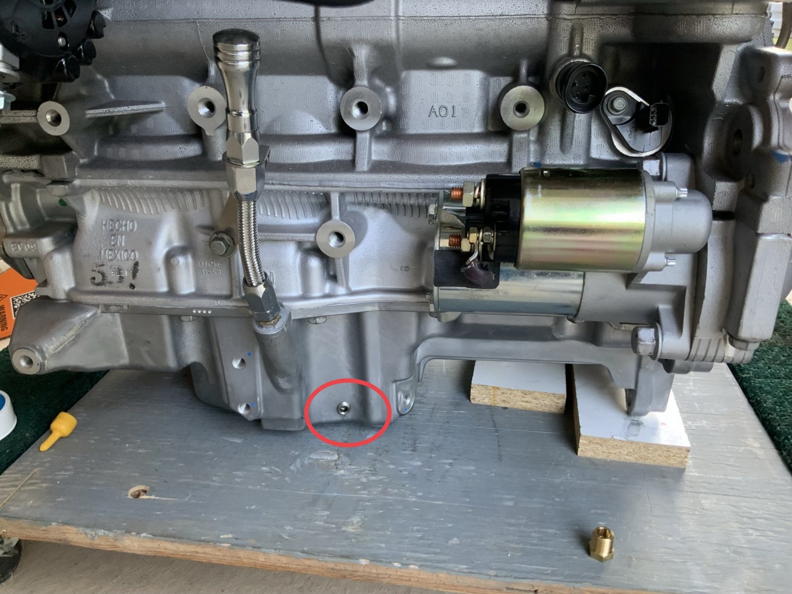

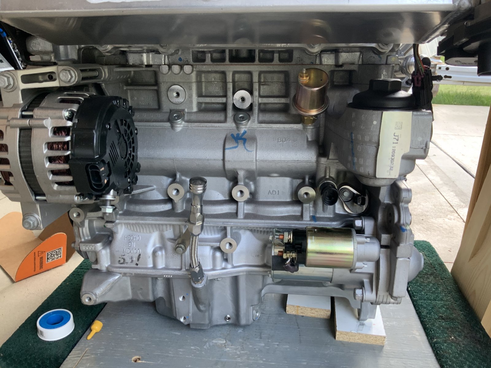

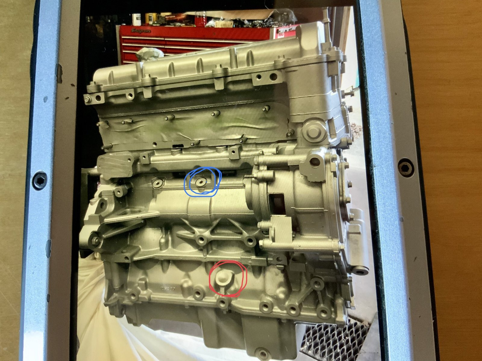

Just doing some finishing up of the engine. Installed a pressure sensor with a 12x1.75 to 1/8 NPT adapter. I also wanted to add a temp sensor but have not been able to find a deep enough adapter (temp probe bottoms out in a normal adapter). If I was smarter would have drill and tapped the oil pan for it when I had it apart...
So you can see the pressure sensor bulb to the left of the oil filter...
Question does anyone happen to know if the plug circled in red is a 1/8 NPT thread (plug uses a 3/16” Allen wrench). It looks really close of coarse I have the engine full of break in oil (actually pressurized the system just to oil everything and check for leaks). If someone knows it would save me draining the system just to try the temp probe....
THX,
Bruce
BAR-AIR
Good Afternoon,
Bit the bullet and drained the oil... Auto meter oil temp prob threaded right in to that plug in the oil pan. (So either it actually is a 1/8NPT or the brass prob adjusted to a metric tread size that’s nearly the same size???).
