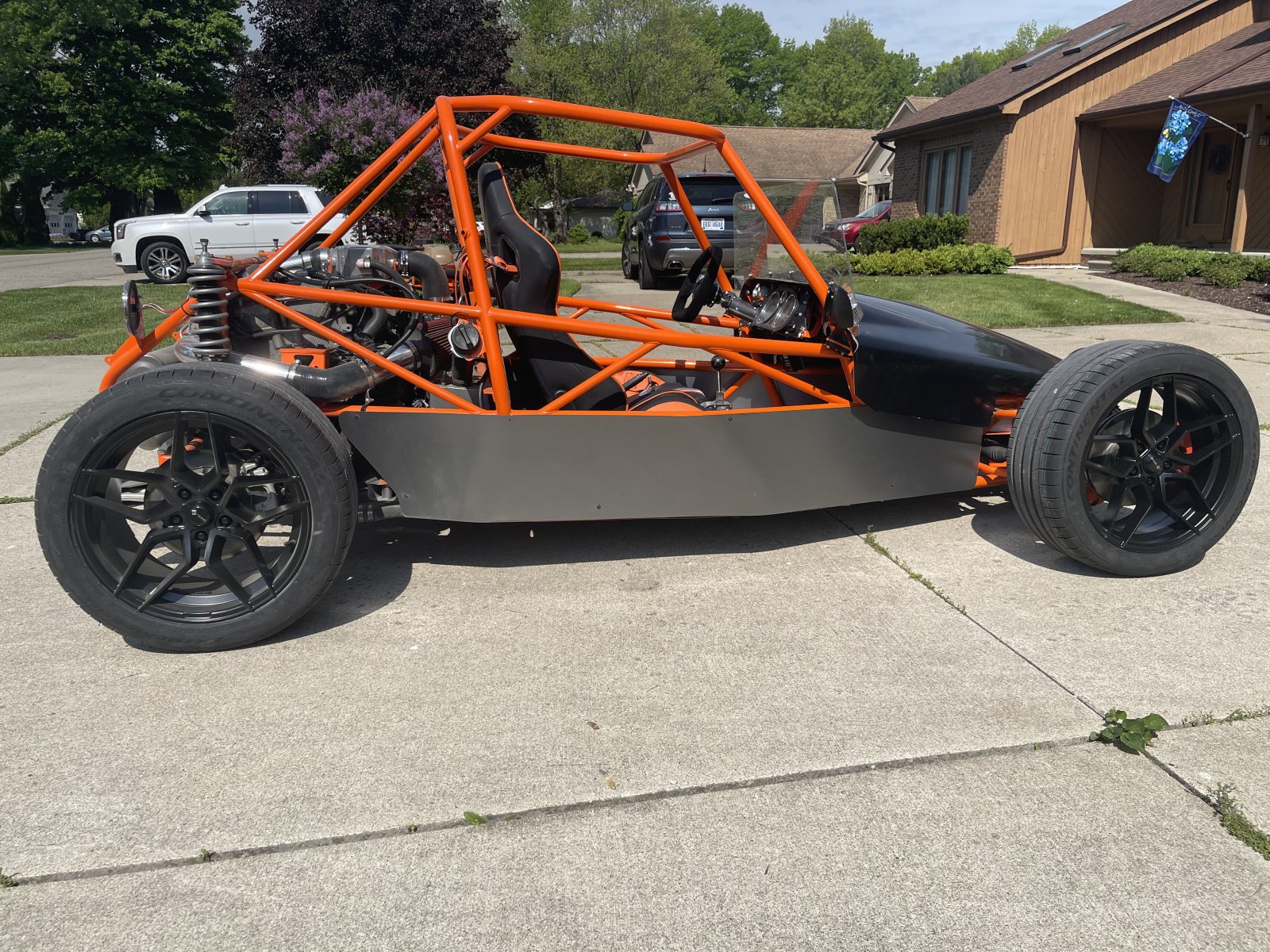

Aluminum roof panel fabbed up from a 'repurposed' road sign.

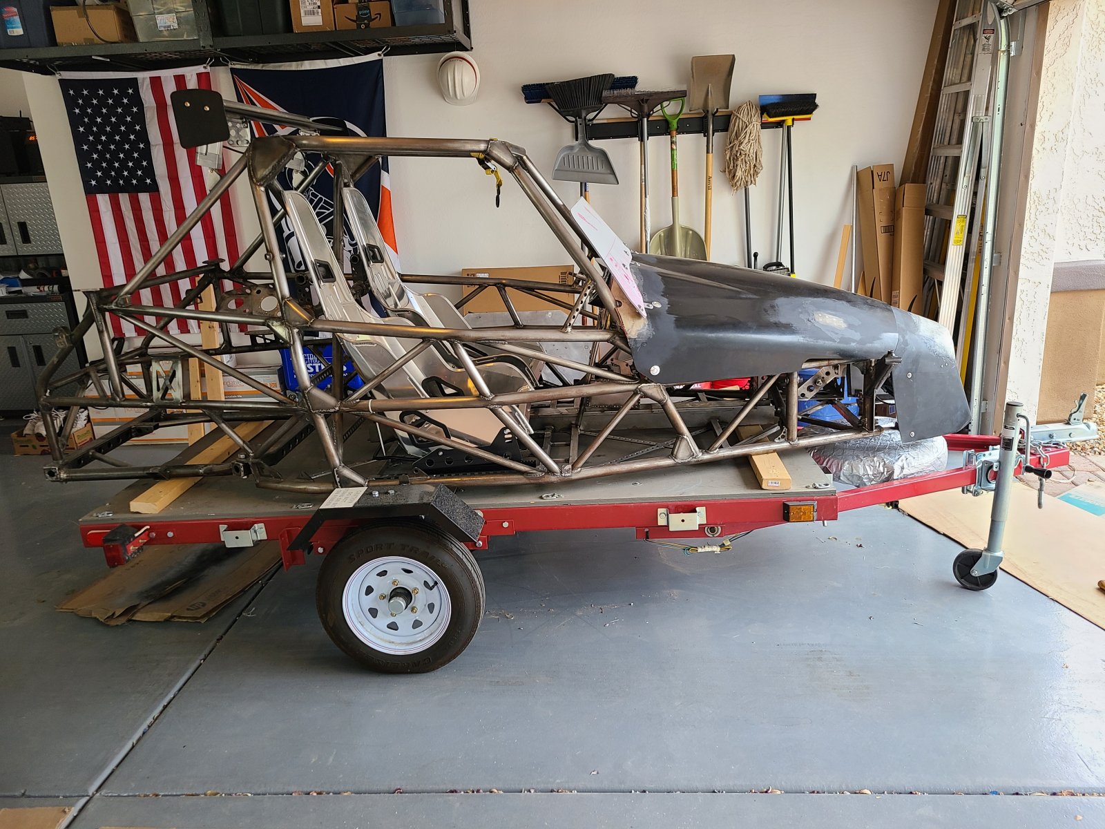

Guess I'd better update my build log, its been a while, and I have accomplished a few things. I completed the anti-dive geometry changes to the front suspension by moving the forwardmost UCA and LCA mounts - upper raised 3/4 inch and lower dropped 1/2 inch. This changes the instant center of the...dfkitcar.com

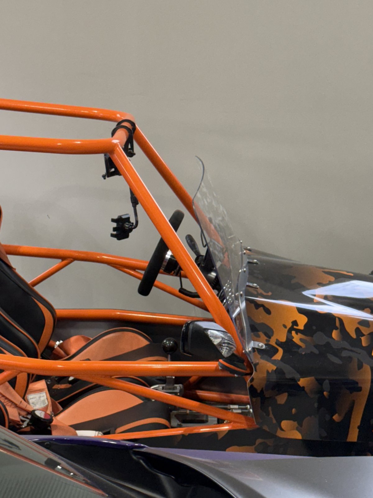

Windshield layback to be parallel with the A- pillar bars.
The bottom windshield bracket must be bent into an arc, recontoured on the bottom edge, mount tabs rebent and new mounting holes drilled into the hood.
Lol, i like the road sign idea, thats clever. I was thinking of going with something that i could remove, but having something solid like that actually does sound like a good idea after all. And ill be doing that with my windshield, that looks excellent. Much more natural looking.
