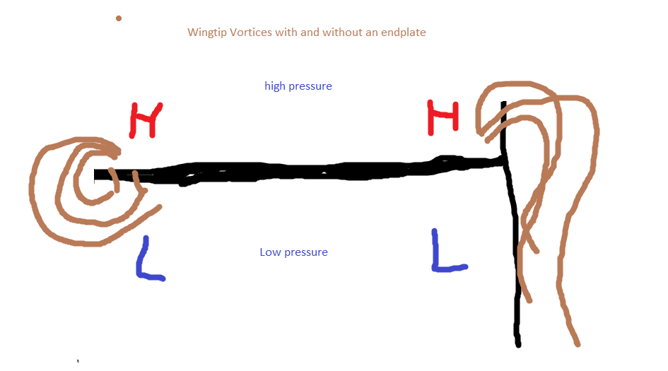

Aero engineer here, so here's my opinion on endplates. Larger endplates themselves do not create downforce, however, they can reduce Drag and make a wing more efficient/stable
Drag is comprised of two types: parasitic (air interacting with the object) and induced (byproduct of lift). You can therefore reduce drag by making the surface smoother to reduce parasitic drag, or by reducing wing-tip vortices with an endplate. By reducing the vortices affect on the lower surface of the wing, it becomes more efficient, ergo "more" downforce and less induced drag. Here's a crude drawing to help visualize.
In short, differing pressure on either sides of a wing come crashing together at a wing's edge. Endplates mitigate the harsh collision and make wings more efficient.

Aero engineer here, so here's my opinion on endplates...
