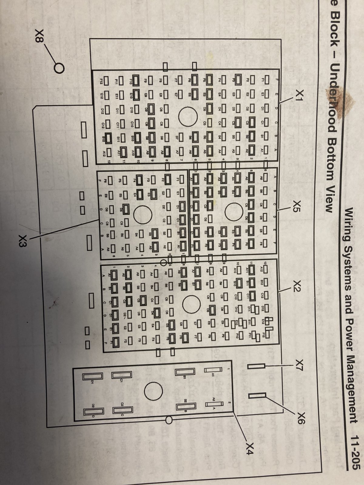

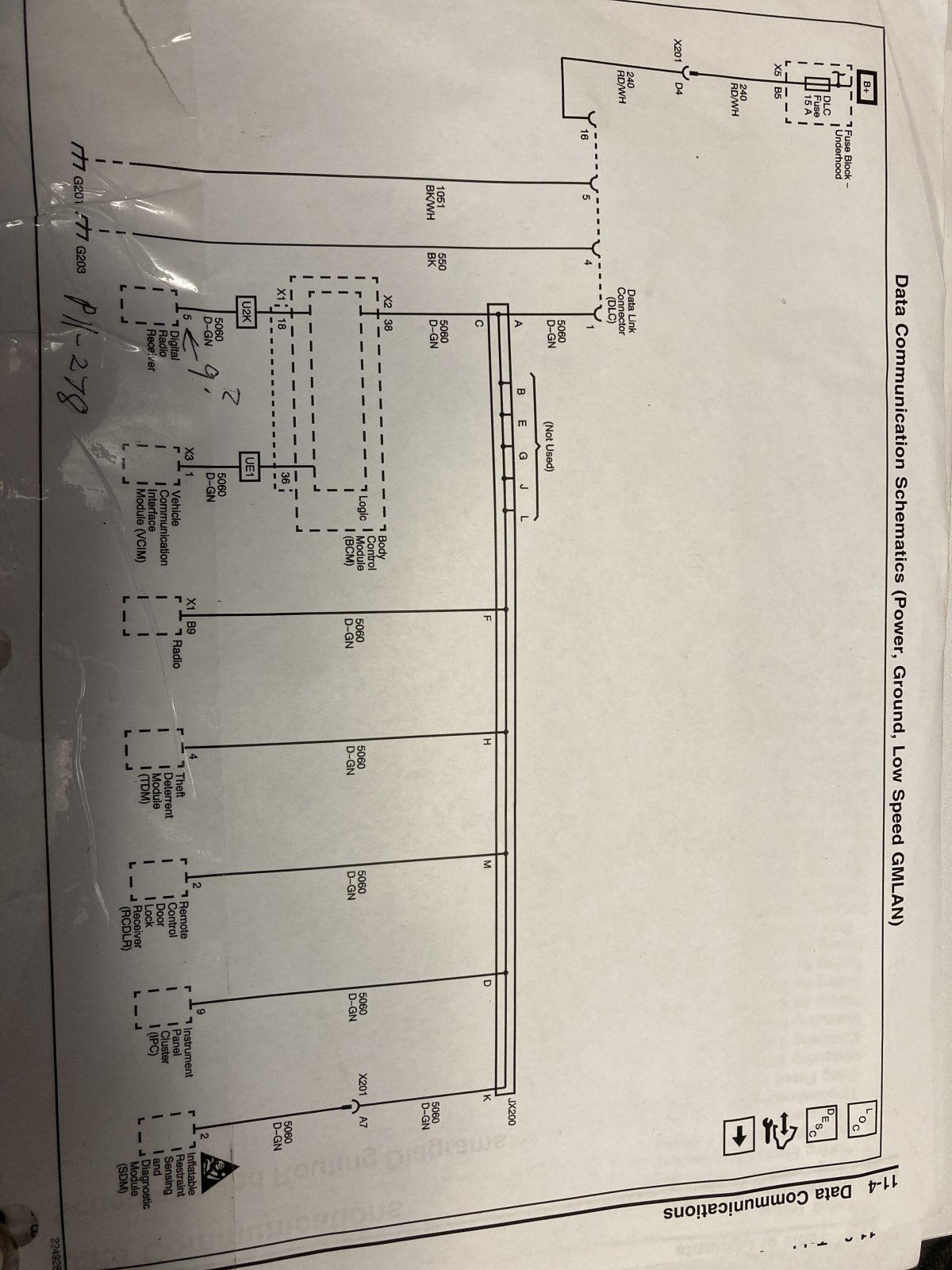

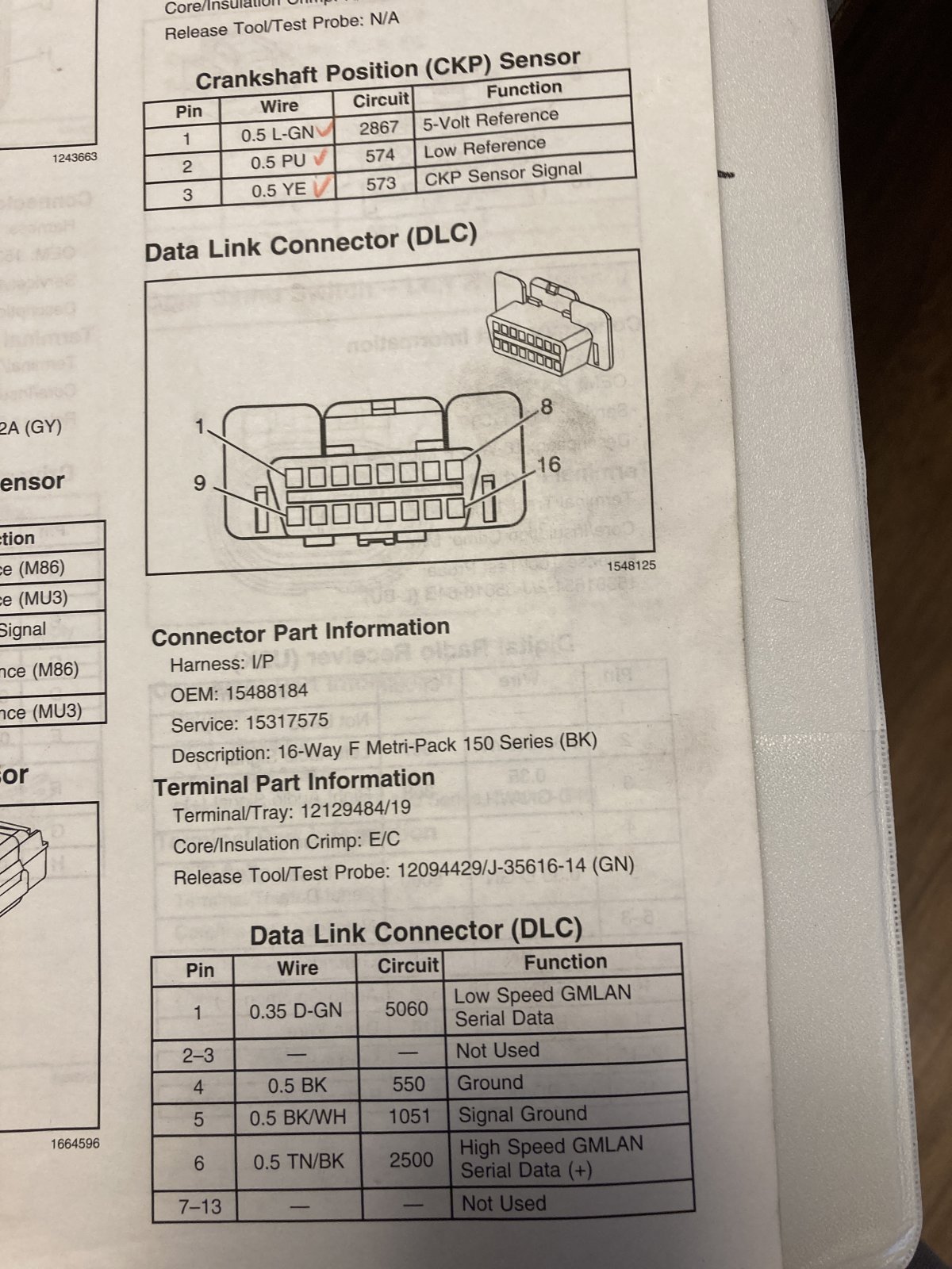

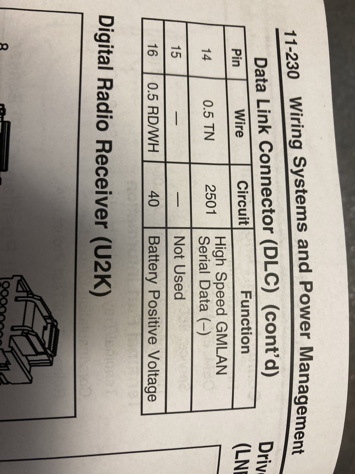

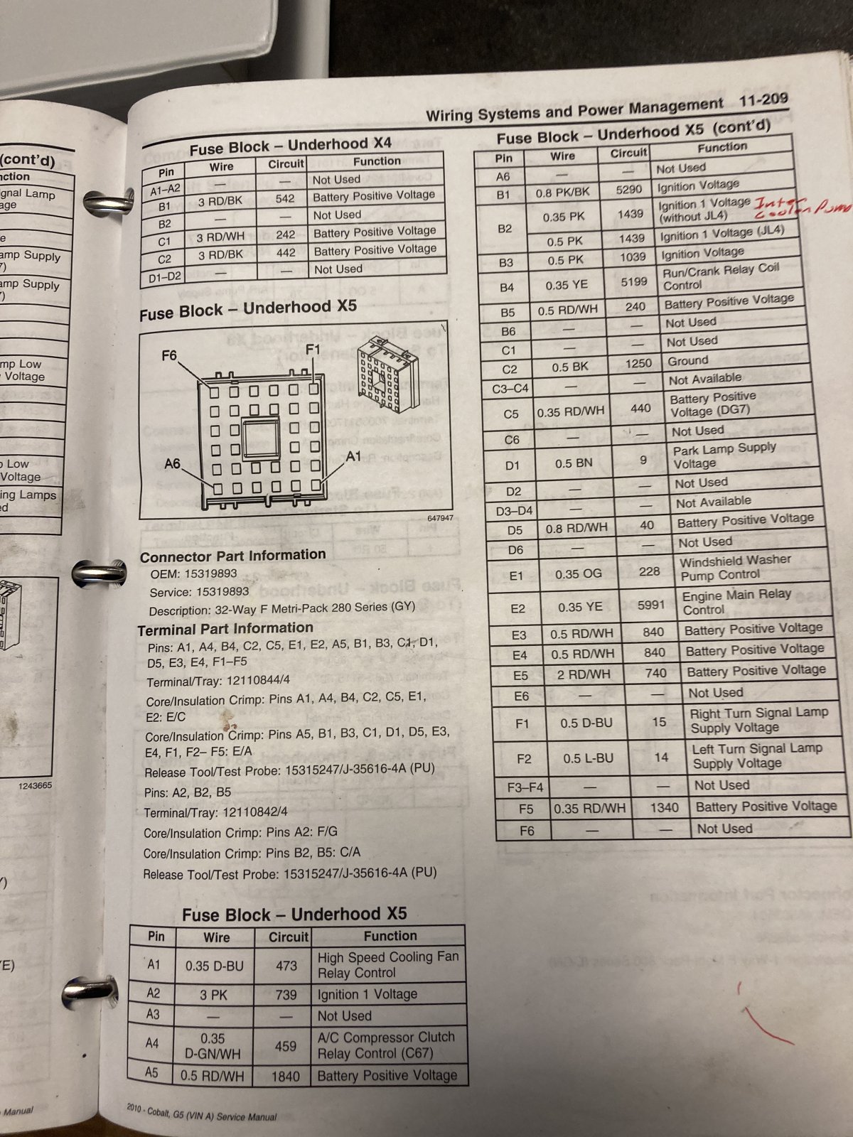

I am lost an need some help. Finishing the 2nd to last video in the harness series and went to extend the ODB2 power but must have cut the wrong wire in video 4. I am thinking the ODB2 power is coming from the dark gray multiplug but not sure. I am looking to find out if it is and what the pin location is so I can double check and add back in if I made a mistake. Appreciate the help!

Thanks, really appreciate the support! Dumb question. How do I know which pin it came from or does it not necessarily matter and I need to re-attached to a pin that has power? Also how do I confirm which plug it was originally in?
Power is red/white on DLC/OBD2 plug and ties to X5-B5 at the fuse box with a sub harness X201-D4 (sub harness I'm pretty sure was thinned out). If you don't have the red/white wire left in the DLC I can get you the end view of that connector this evening.
The power can come from any fused source. It typically isn't on a switched circuit (it's full time hot).
