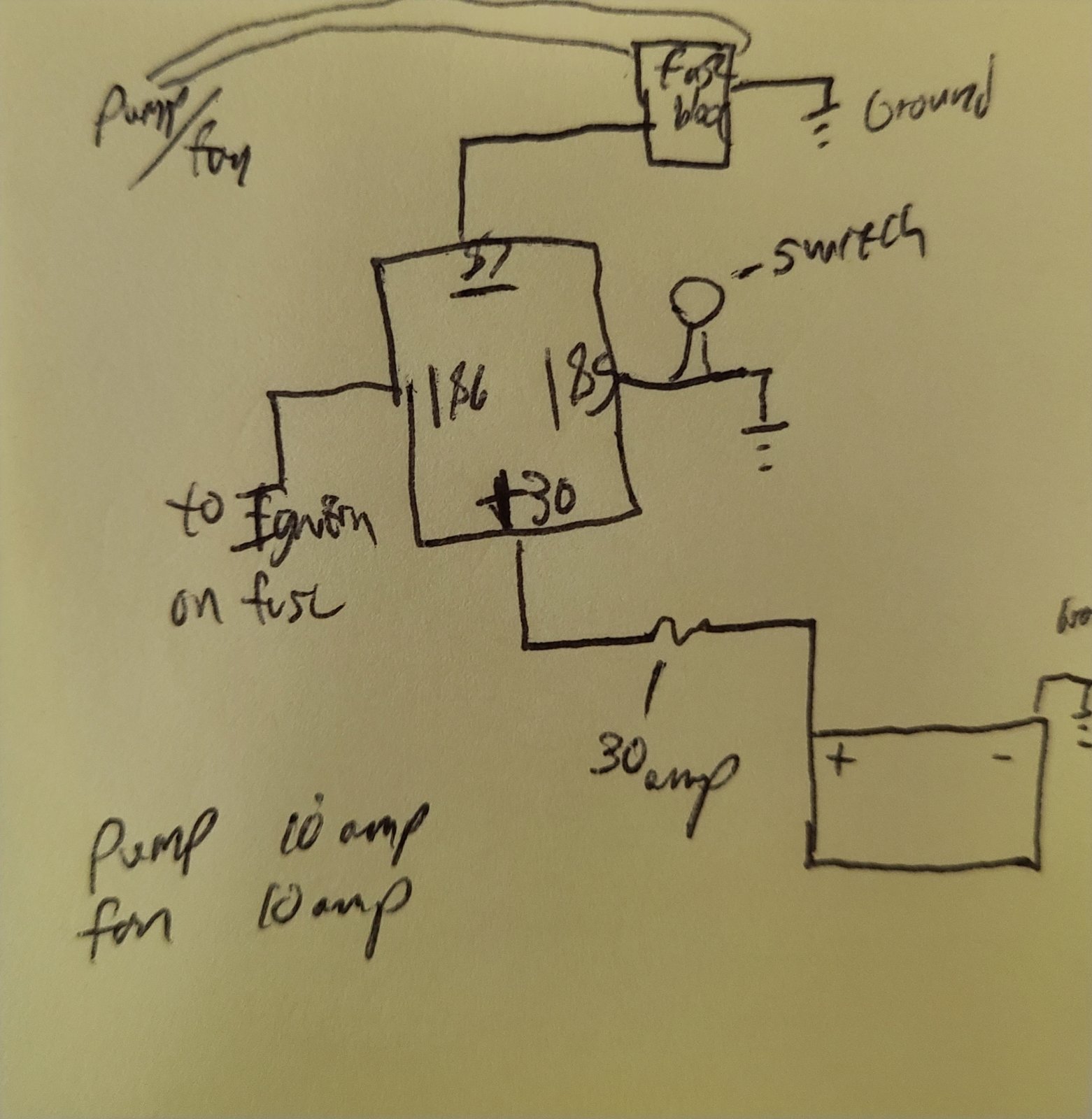

8awg wire coming off the battery with an in line 40amp fuse into a 40amp relay to pin 30, 86 to ignition power, 87 to the fuse block, 85 to a switch on the dash that then grounds to the knee area ground post.
I'll then add 10amp fuse at the block 16awg double wire to go from the fuse block to the IC pump which draws 6amps.
Then another to the fan which according to the website draws a max of 6.6amps with another 10amp fuse.
I'm looking at a 300watt speaker setup as well. Adding 25 amps of power along with the 6 for the fan and 6 for the IC pump I'm pushing the 40amp relay max output. Do I then setup a second relay with an inline fuse for the speaker or add it into the fuse block?

You might want to think about whether you want any of your loads controlled by a switch, but if not, what you are proposing should work.
I guess my thought was is to have the relay control the added fuse panel and have it switched at the dash of the car. So while diagnosing issues with key ignition on I can turn off all extra key on components that aren't factory. Like the fan and ic pump. My sticky note drawing kind of sucks
I wasn’t trying to say to not put them on a switch. I didn’t pick that up on your diagram. I would recommend having at least the fan and pump switched.
